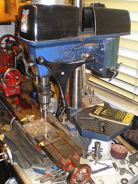

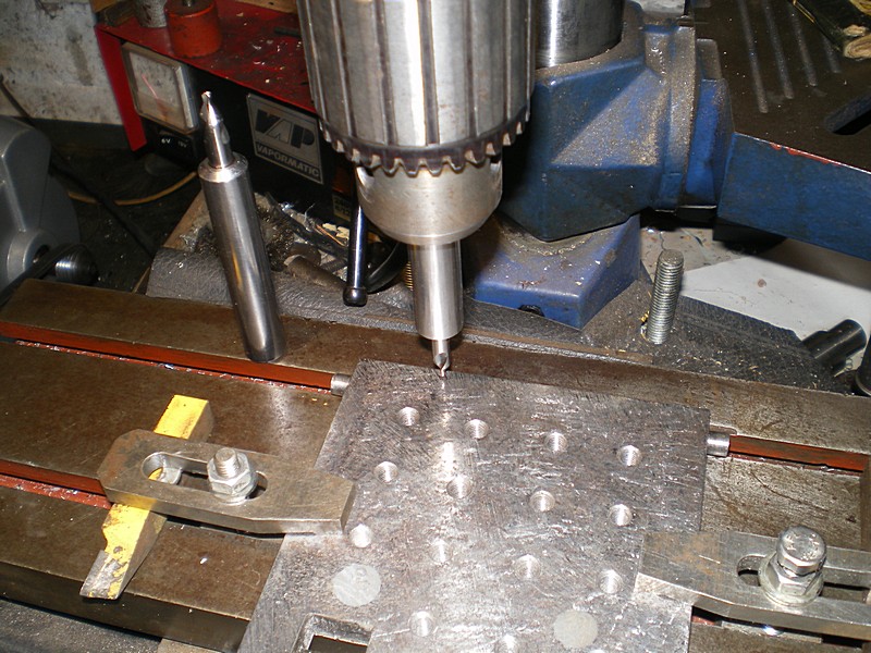

    I have a home made X Y table from part of a small mill on my bench drill which I use for coordinate drilling.
    One problem is a limited quill travel of 50 mm and switching from a centre drill to a twist drill takes up nearly all the travel and moving the drill head loses the datums.
    The answer is to make an extension for the centre drill to match the length of my edge finder and the length of the average twist drill. Made two for different sizes rather than a double ended one and rather than use grub screws I have simply used Threadlock which is easily removed with heat.

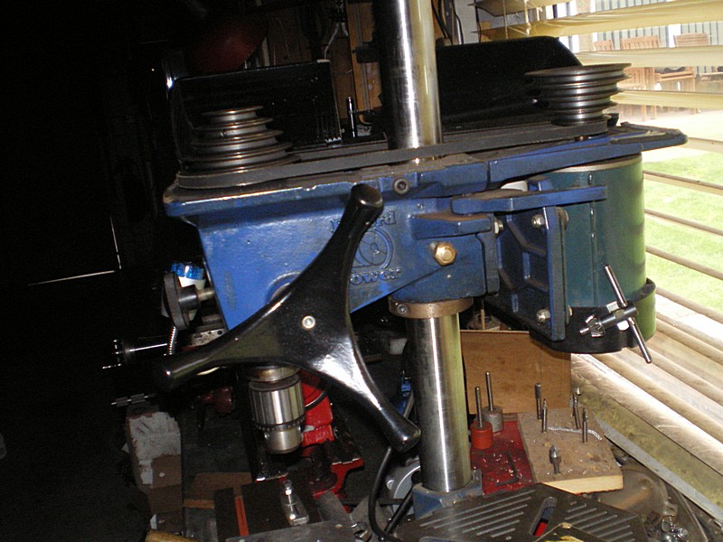

    The bench drill has been modified to enable the head to be lowered on the column to within range of the job in hand.

    Interesting idea. I am really interested in how you modified the drill press to lower the head. Could you say a few words about that? I was thinking of modifying one of my little presses that way.

    Quote Originally Posted by JoeH View Post
    Hi JoeH,
    Very simple to do on my press as the only thing I needed modify was the belt guard by cutting away a portion to allow it to still flip for a speed change.
    I have made a security column stop collar which is vital for a controlled decent and the column is now a solid one to replace the flimsy thin walled tube of the original.
    There is little point in doing all this unless one is using an XY table which is why I have not posted the mods as everyone seems to have a mill these days.
    Hope that helps.
    I have replaced the clamping set screw for a bolt for easier access
    Hi JoeH,
    There is little point in doing all this unless one is using an XY table which is why I have not posted the mods as everyone seems to have a mill these days. I have replaced the clamping set screw for a bolt for easier access.Centre drill extension-imgp0026.jpg

    Thanks. My purpose is a little bit strange. I want to lower the head so I can use it kind of like a mag drill without the magnet. Still thinking of ways to hold everything down.

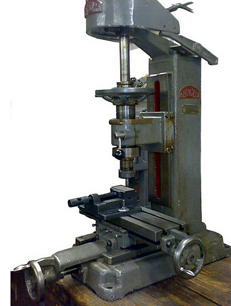

    The 14 x 4 inch mill table was from a Portmac Redman mill in the style of a mini jig borer made in the UK and the X axis was part of the base casting which I did not have, I would have loved to obtain the whole machine.
    The slides are of square section so are made square to each other, I made an X axis from an alloy plate with brass bearing surfaces and various bits to form a slide, as this is only used for positioning it has proved up to the job.
