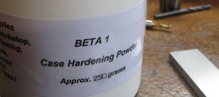

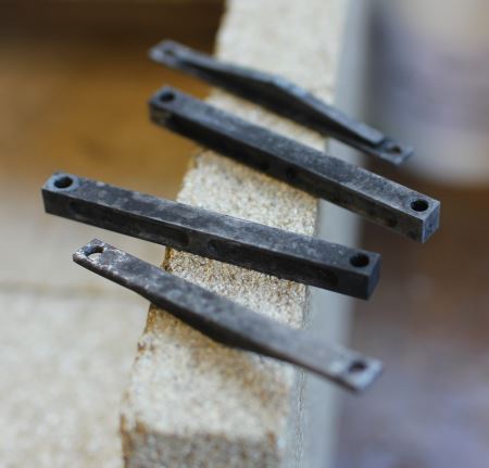

    Just thought I would start a thread on this subject to see if I could find any better options:
    I'm currently using this compound from EKP tools:
    More details and a review here: Case Hardening Compound – glue-it.com
    What other options are there for case hardening?

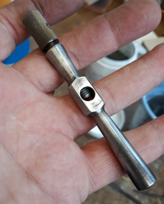

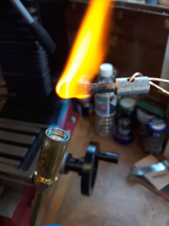

    Have been using this case hardening to harden the end of a replacement bolt for a small antique LAL tap wrench and it has worked really well
    The reward of repairing something that is so well designed is wonderful:
