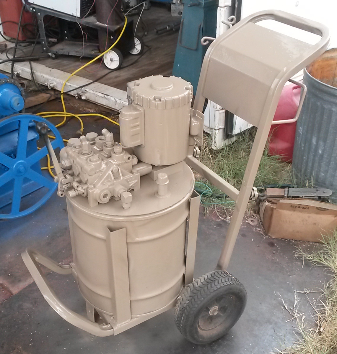

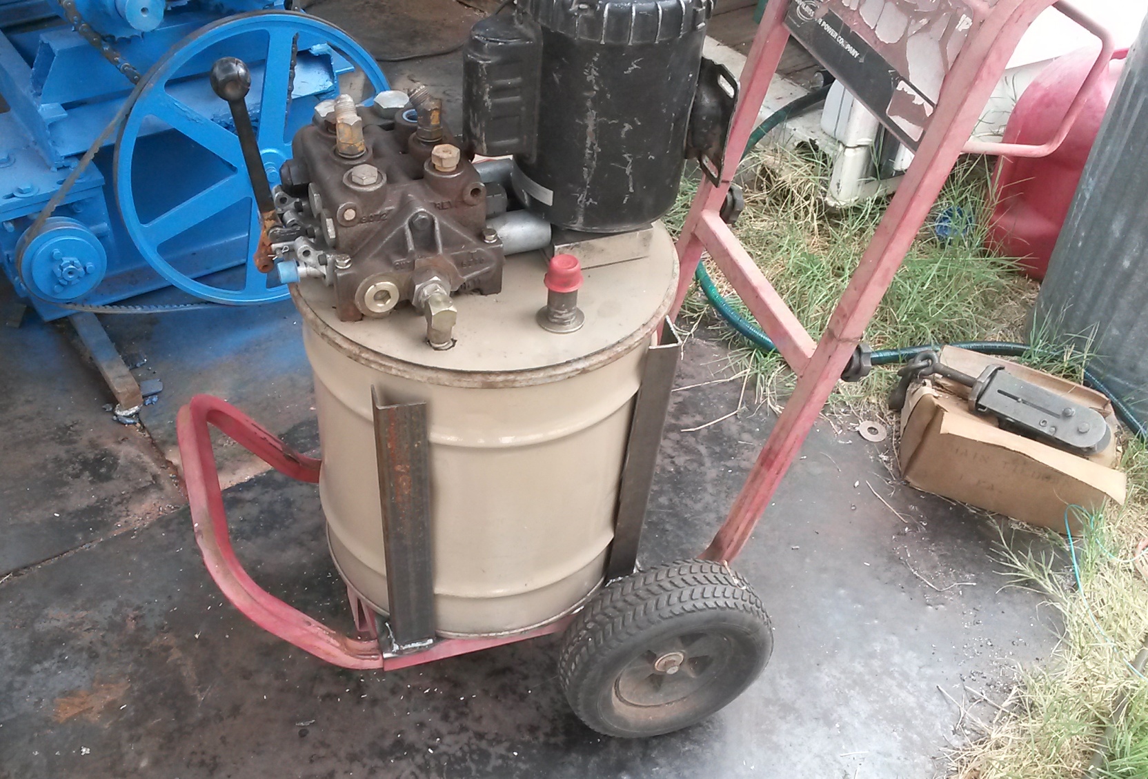

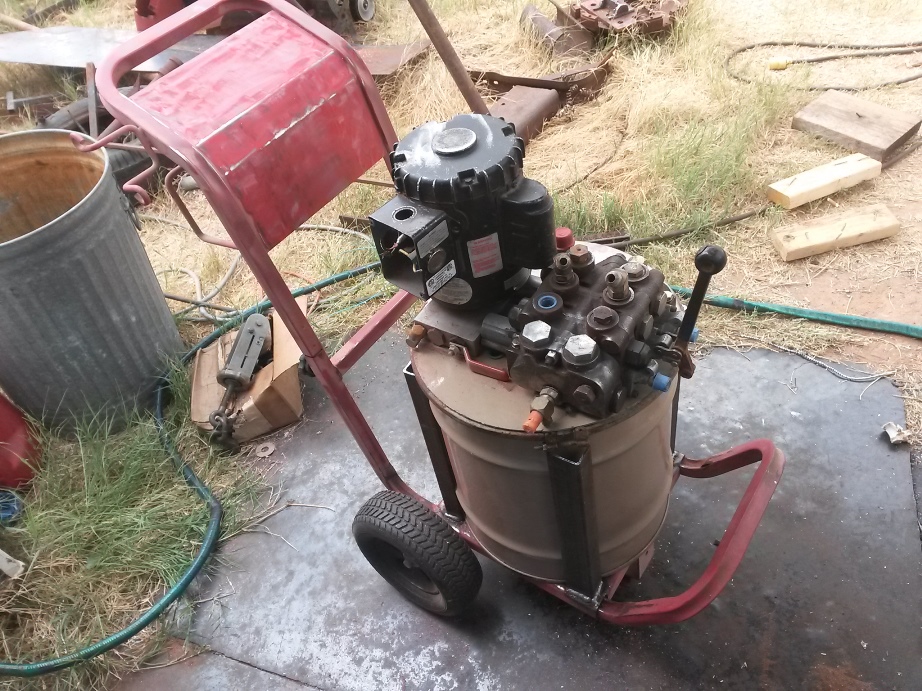

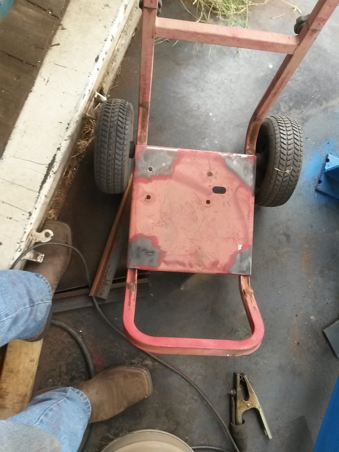

    While digging around in 1 of my sheds I uncovered an old Pressure washer cart
    This gave me the idea to mount my power unit on it because the size looked to be perfect

    It started out as a power unit that hung from the post of your average 10 to 15 ton 4 post automotive truck lift with a 6 to 8 gallon plastic tank only I had installed it on a elevator that I made for some close friends up on Vashon Island WA. after nearly 20 years of use the coupling between the pump and the motor went bad rather than take a chance on finding a machine shop willing to make a new coupling we replaced the whole thing with a new unit. So I brought the old one home with me tossed it in my someday pile
    3Hp hydraulic power unit
