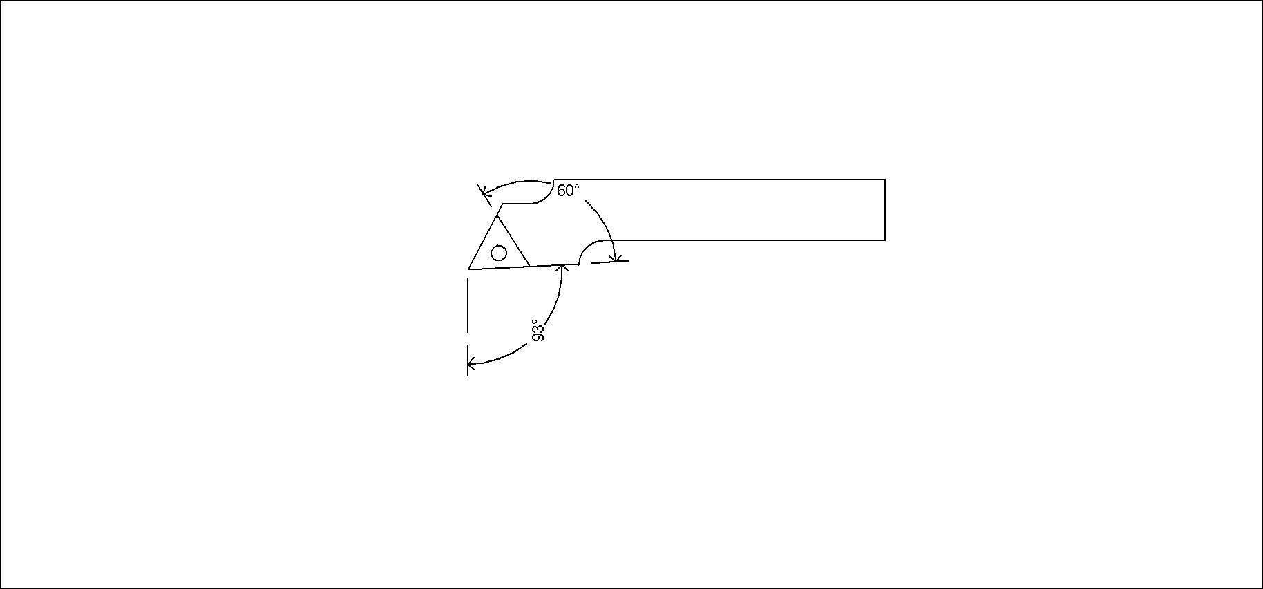

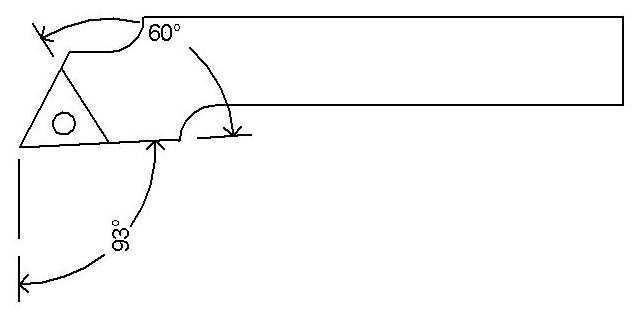

    Thanks for the compliment PJs
    your right the inserts have a 7° clearance angle built into them, that was not modified, instead of the inserts face or edge being parallel with the shank the inserts point is inverted 3° towards the chuck, Hope this photo clears things up for you.

    Quote Originally Posted by rossbotics View Post
    Perfectly clear...I get it now, Doh! Thanks Doug for taking the time to clear it up.

    I like this idea of an offset in the chip holder shank; even more that tip is oriented CCW 3° to face off, especially to shoulders. I can't offer any explanation why this isn't apparent in commercially made holders. Like Doug, I'm not a devotee of Carbide. They certainly have their place, but are not my go-to choice.
