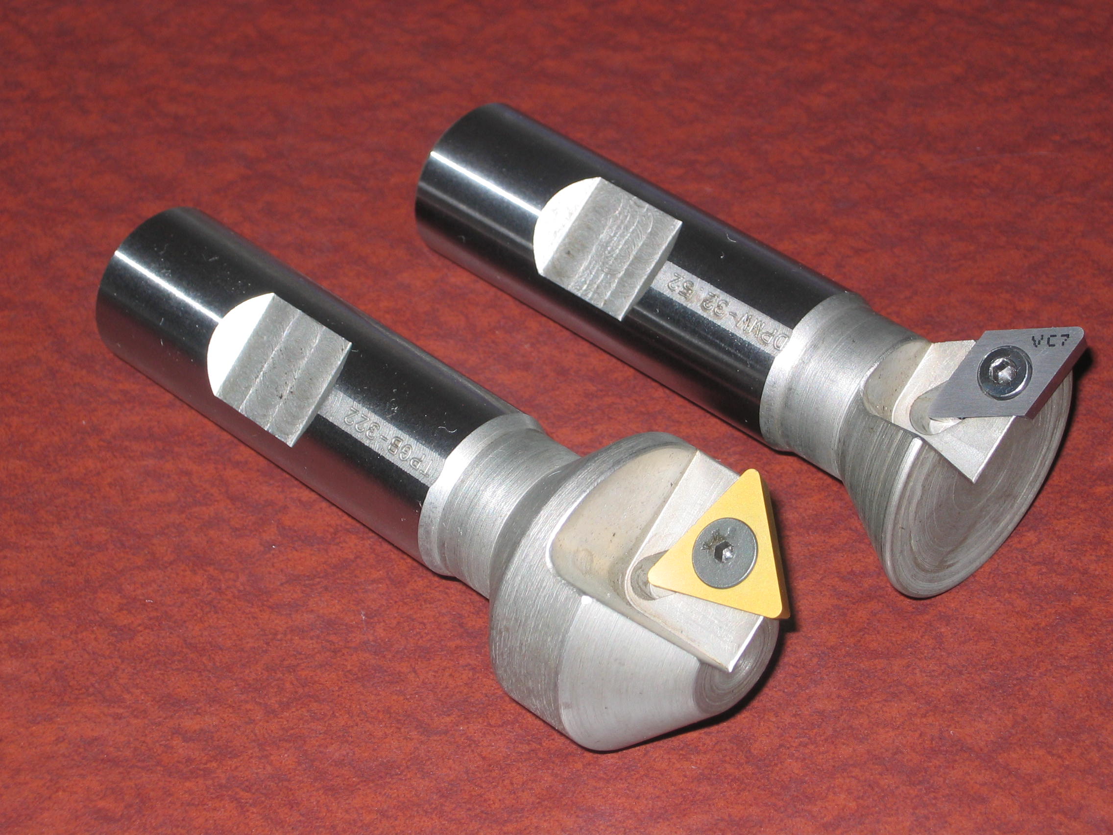

    A while ago I had a job requiring several dovetails to be cut in some lathe tool holders I was making. The material was 4140 pre hardened steel. Rather than buying a cutter I decided to make one and while I was at it I also made a chamfering cutter to break all the corners on the tool holders. They worked out great. I also engraved the carbide insert cutter number on the shanks for future reference. The cutters were hardened and shanks ground.

    Engraving the carbide insert cutter number on the shanks for future reference is an excellent suggestion.
    Thank you for showing your work. Regards, Paul Jones

    I agree with that statement more than anyone can imagine.
    there are a lot of cutters which are so similar in size or shape knowing which one the tool was made for can save a lot of headaches latter on.

    Great work and I have to agree with others stamping the insert type and size is golden. That saves a bunch of head scratching a year or two from now.

    The school of hard knocks is the best teacher. My memory is short so I engraved the number so I could never forget.
