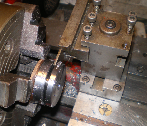

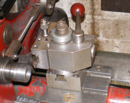

    Quote Originally Posted by Daturat100r View Post
    Make yourself a rear toolpost.Transformed my myfords ability to part off
    I've been thinking about it. But I don't need to part off 12L14 very often, so I have yet to start designing one. Hmm. I wonder if I could do something that would allow me to remove my AXA100 QC post and swap it to a rear location, then put it back up front when finished parting. I'll have to look into that.

    I see you have a T slotted slide so you could make something like this.
    Or a dedicated part off holder which you can leave in place while making parts.
    This has cured all my parting problems although you have a fairly light lathe which is a consideration, mine is a 9 inch SB.
Name:	Screen Shot 09-08-17 at 06.06 PM.PNG
Name:	Screen Shot 09-08-17 at 06.09 PM.PNG
    Unfortunately it's not so easy for my old Grayson as the cross slide won't travel beyond its central position relative to the bed when feeding in. I've already been thinking about making a sturdy base that extended out the back to give me enough room for other jobs and a parting post is another good excuse to need one
