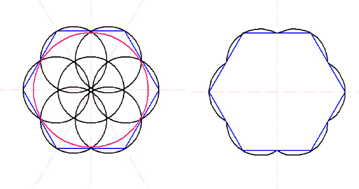

    I just had an idea while reading your thread. Next time you need to put a hex key into a hole, what if you milled a circle hole pattern of 6 small holes of an appropriate size positioned to just clear the points on the hex key? The milling passes outward from the center toward each point would then also clear out the center of that pattern to fit the hex key down into the pattern. I believe it would prevent the hex key from slipping, and not require any special tooling to make it work. Left image is the pattern of holes milled away. Right image is what you have left, with the hex key in it.
    This example I did in CAD is for a 3/8 hex key hole, and the holes to mill away would require a 7/32" or perhaps a 5mm end mill. I don't think the holes could be done with a drill, unfortunately, because of the major amount of overlap.

    metalmuncher what you are talking about is very similar to the flank drive sockets

    True! I hadn't thought of that. Rather than doing all the work of my idea, it would seem prudent to just modify a hex socket for whatever means one has in mind of turning the back end. It would be much quicker to utilize a squared off something inserted into said socket, than to mill all that material with a relatively tiny end mill.

    Quote Originally Posted by Metalmuncher View Post
    Neat!
    I will have to have to give that a try once my mill is up and running.
    Thanks metalmuncher

    When I saw Rotary Broach mentioned here I looked them up, as I'd not heard of them before. Very cool! But the retail prices for the holder, the part I see you are making, are crazy expensive, especially for a tool that won't see frequent use as a hobbyist. So I am very interested in your project! I see the actual broach bits for these holders aren't too unreasonable. So if I made a holder, I could see owning a few bits.
    I was wondering how they accomplished the wobble. Your drawing explains that. Did you turn the 1/4" ball, or is that a bearing ball you bought?
