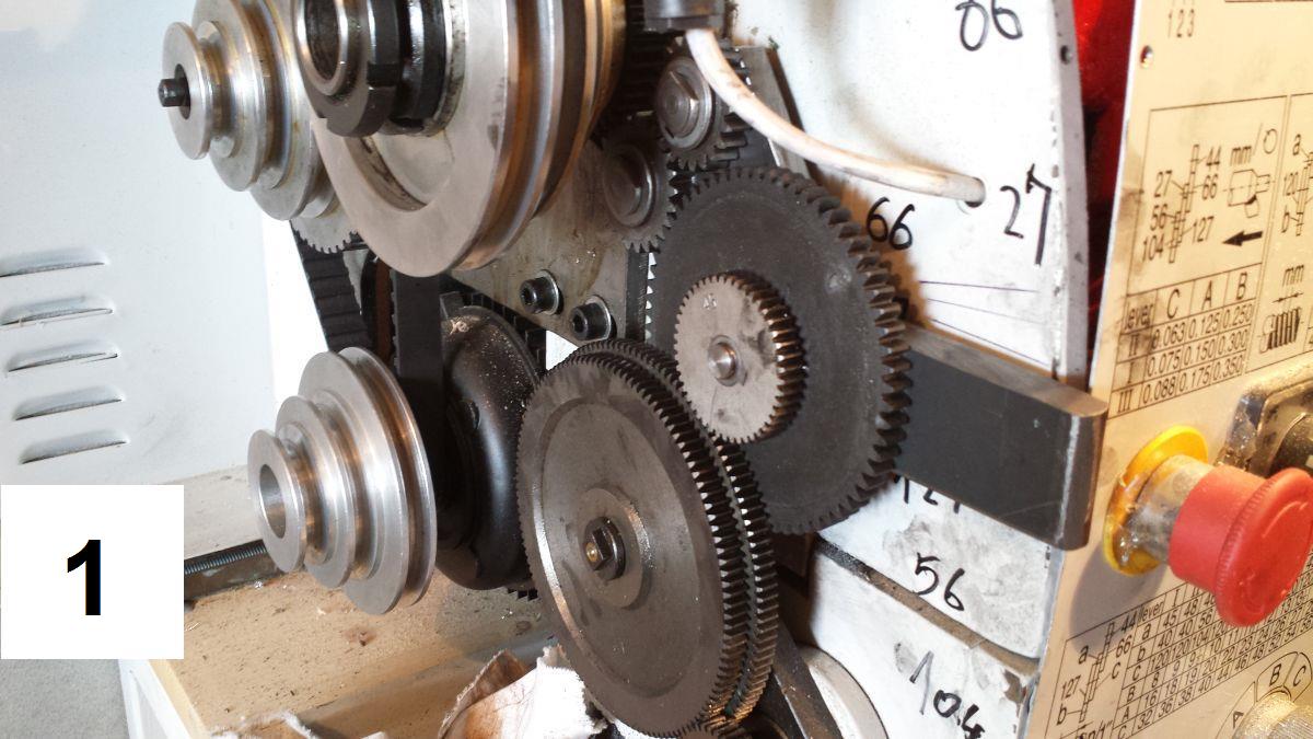

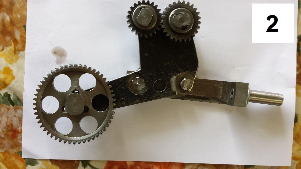

    Decided to make it with different design by using 3 gears. I don't claim that I am
    the first one who did it this way, but I couldn't find any picture of reverse tumbler
    with 3 gears in that order on the web. (picture 2)

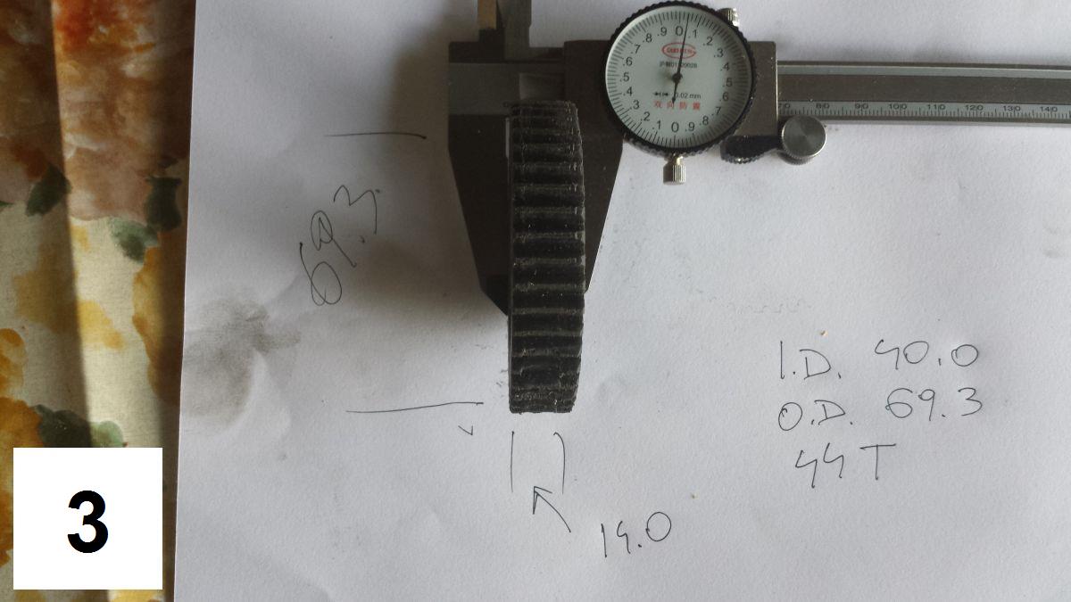

    Unfortunately big gear got stuck and damaged nylon 44 teeth gear. (picture 3)

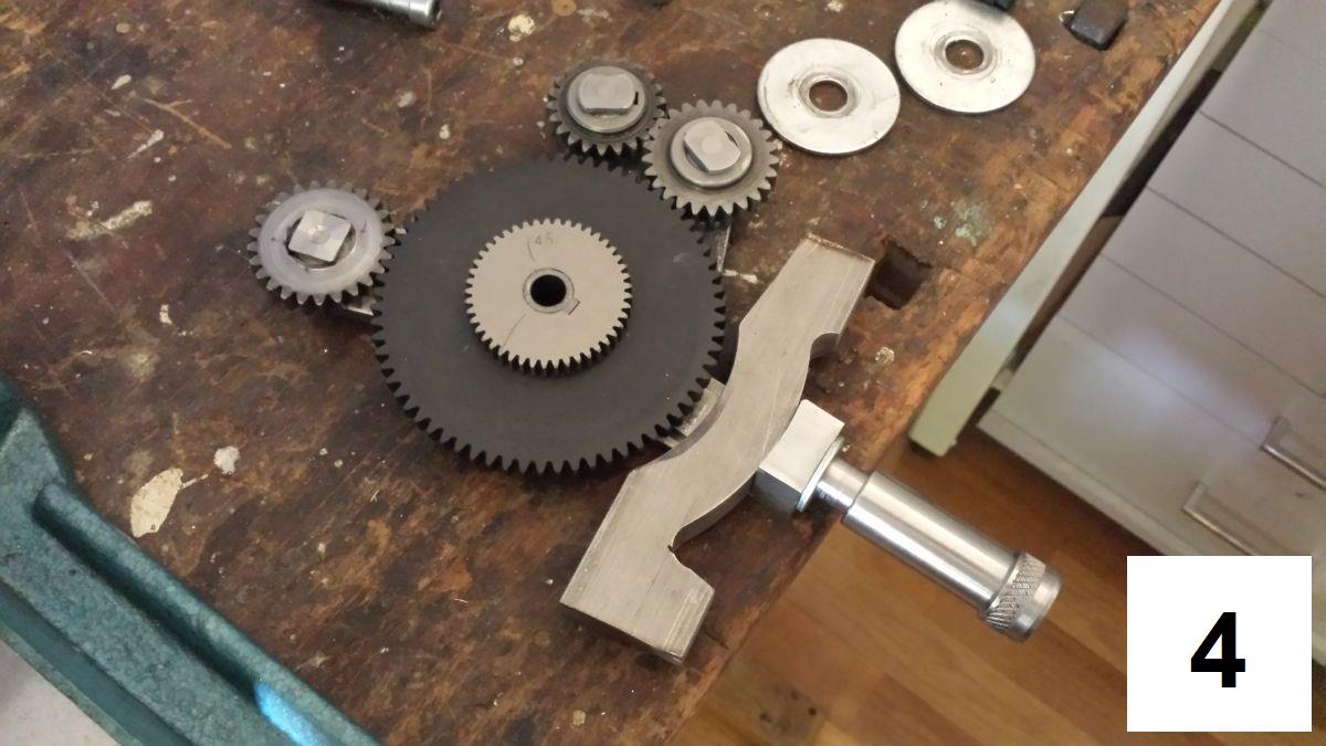

    Managed to complete job in third attempt, by using 3 smaller gears from scrapped
    motorcycle gearboxes. And it works even with damaged 44 teeth gear (picture 4)

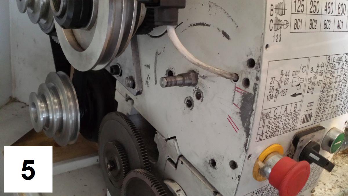

    Needles to say that lathe plate looks like Swiss cheese after 3 attempts.
    As you can see every hole is threaded to M8. And there is a nut from other side
    for every bolt installed. (picture 5)

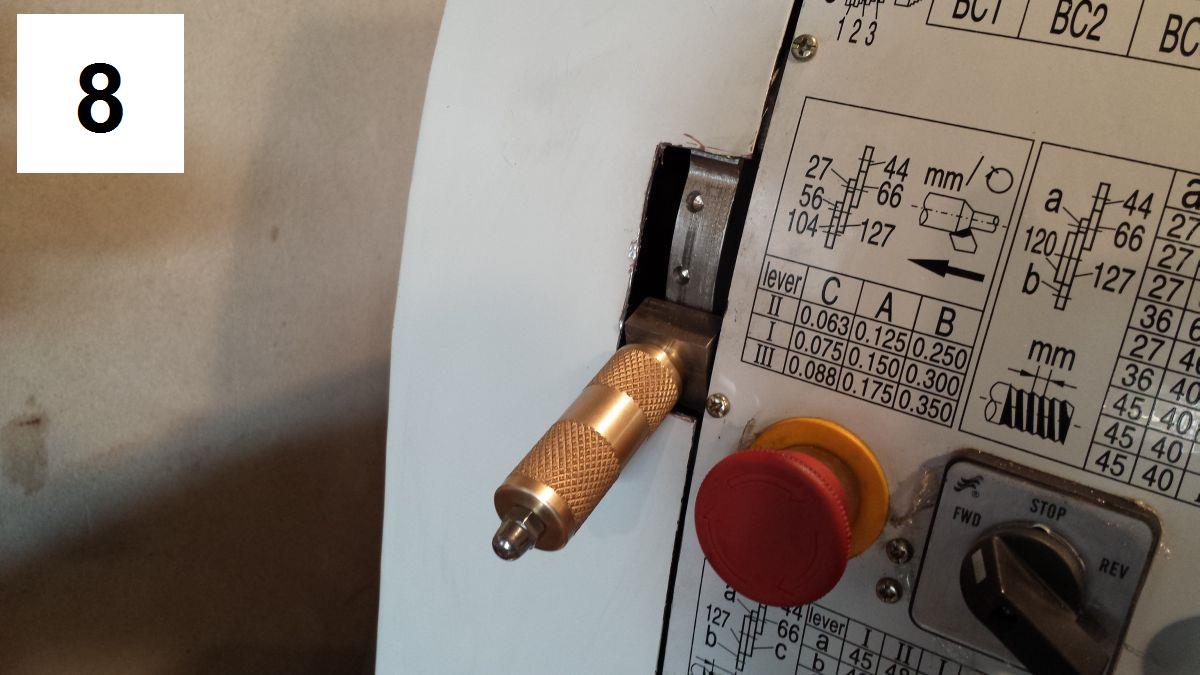

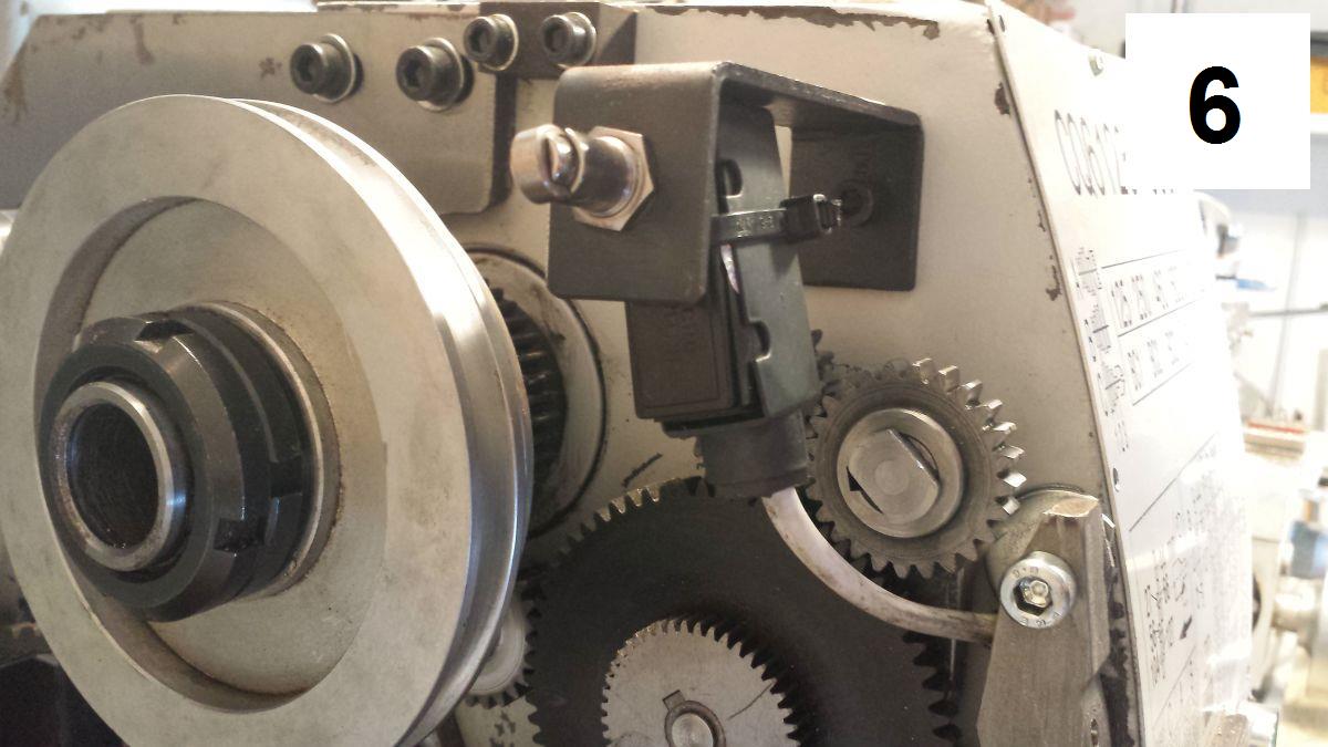

    Reverse tumbler in position (picture 6)

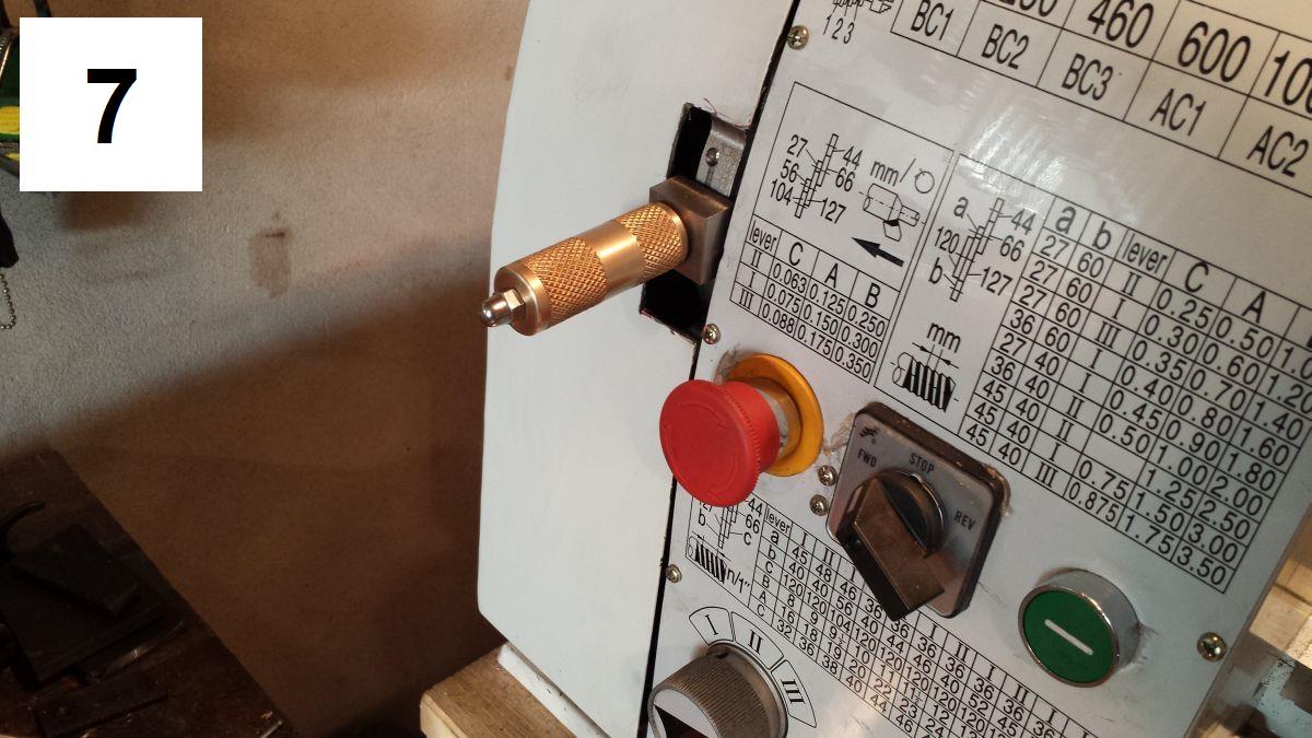

    Handle in neutral position (picture 7)
    Handle in reverse position (left hand threading) (picture 8)

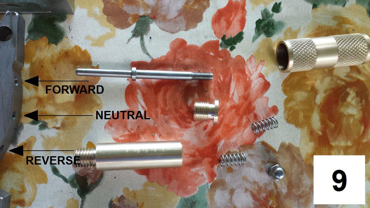

    Handle parts (brass and stainless steel)
    Observe huge spaces between positions F / N / R. (picture 9)

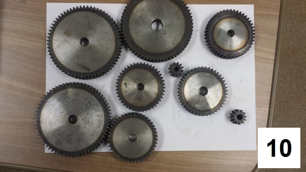

    And finaly picture of gears which I bought in China from Taobao.com.
    All these gears for less than 15 USD. 4 gears 44 teeth module 1.5 and
    3 gears 66 teeth module 1.5. Already bored 44 t gears to I.D. 40 mm
    and made 10 mm keyway and also reduced thickness of 66 t gear to 8 mm.
    2 small 12 t gears are for another project. (picture 10 )
