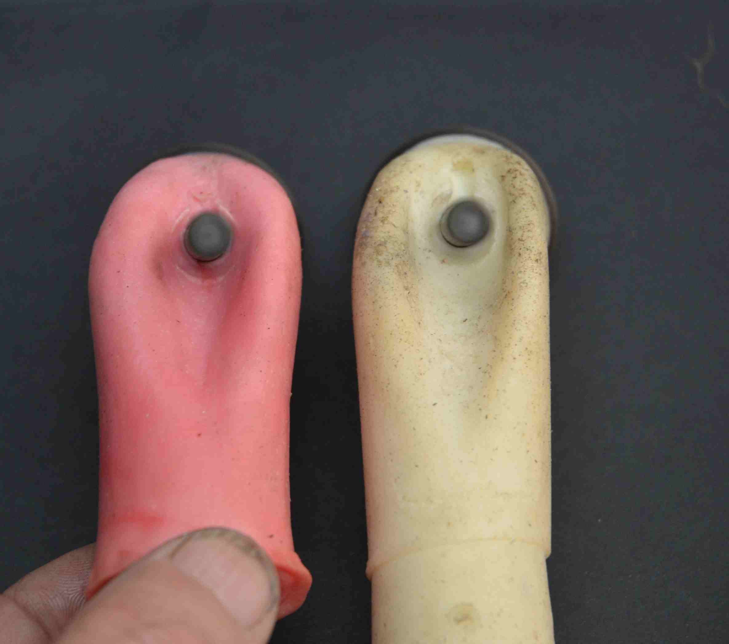

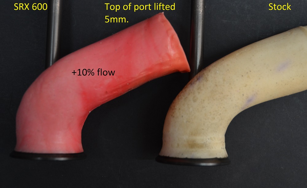

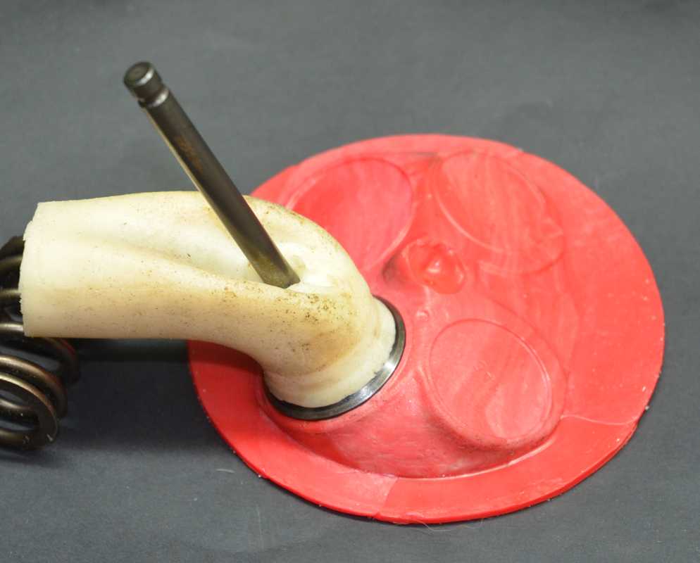

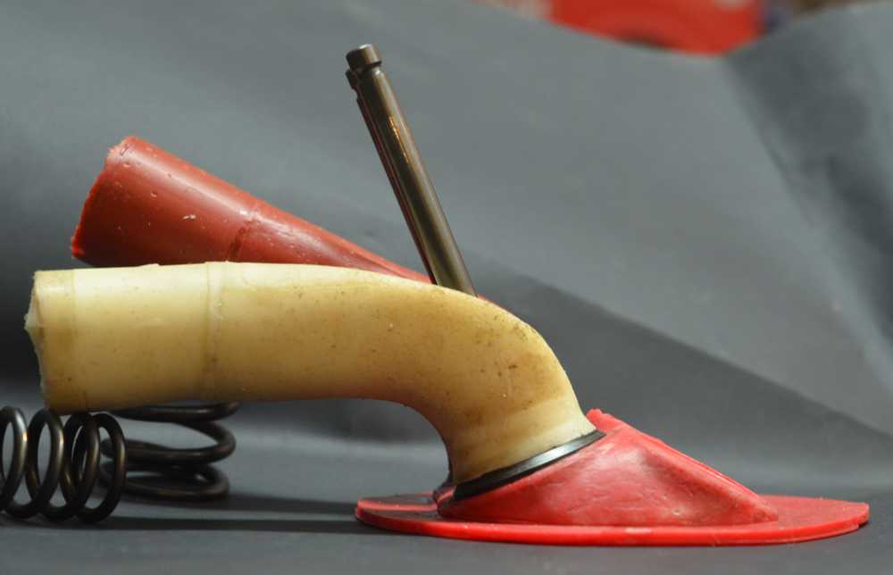

    Firstly I had to make a tool to make the plaster tool. This task requires moulding the original ports and combustion chamber of the real head, this is a non-destructive job. There are many moulding compounds that are used for this, some are a two part mix which can only be used once but I use "Vinamold" which can be re-melted and used many times. Resins like polyester and epoxy which set rigid are not suitable for this process because you need a rubbery like material so that you can extract the moulds from the ports.
    Can you make tools from plaster?-port-moulds-01.jpg Can you make tools from plaster?-port-moulds-02.jpg
    Here we have ports moulds, the pink one is from a port with small modifications which showed a 10% flow improvement over the stock port moulded in white.

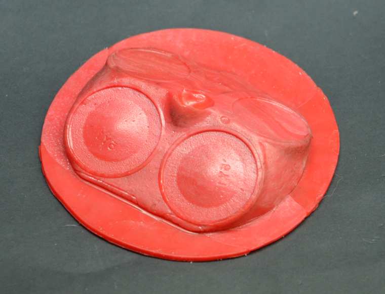

    This shows the mould of the combustion chamber.

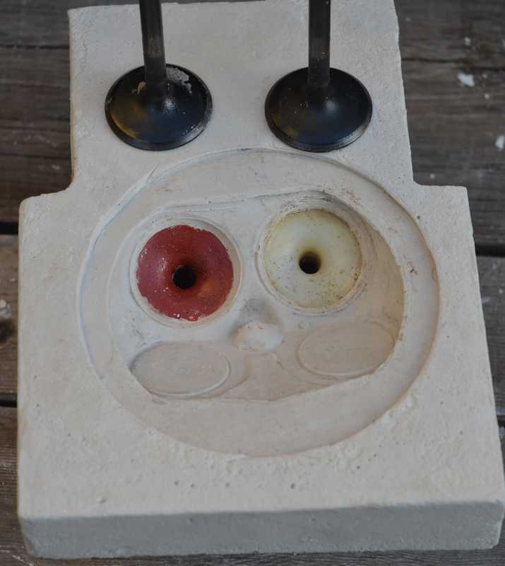

    To produce the plaster head I had to combine the port and chamber moulds as shown here.
    Can you make tools from plaster?-both-ports-02.jpg Can you make tools from plaster?-stock-port-02.jpg

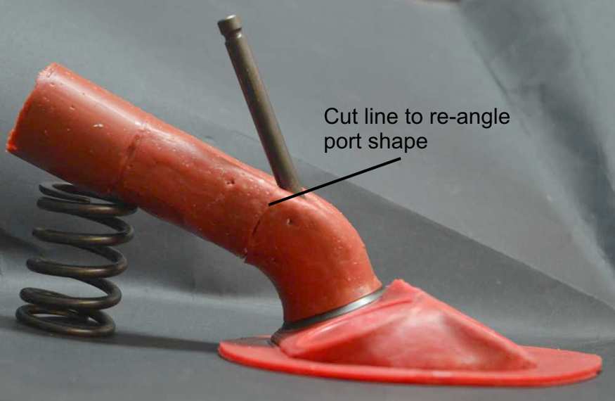

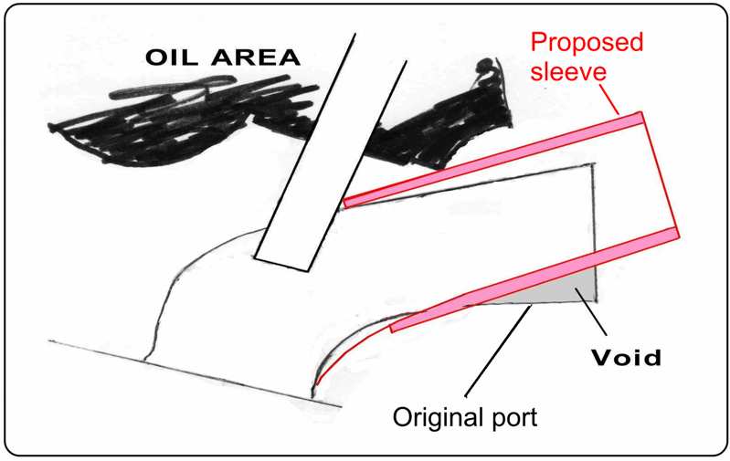

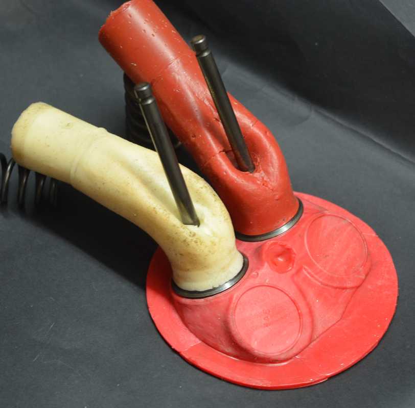

    Air flow doesn't like to turn corners and so the best way to get good flow is to aim the port as close as possible to the back side of the valve. This requires raising the port as much as possible. The practical limit to this is breaking through into the lower valve spring seat area, which contains oil. In this case there is not enough metal to raise the port to that height, so I planned to bore out a hole where there was supporting metal and insert a sleeve.
    This sketch shows the planned inserted sleeve, It can be seen how much straighter would be the flow path.
    In order to test this with my plaster tool I needed to cast the plaster with the same steep port alignment. To enable that I cut a Vee out of one of the port mouldings and glued it back with a steeper path. The other port mould was left stock which gave me a base for comparison and also a check that the plaster head gave similar flow bench numbers as the real metal head. I call that an "honesty" check.
    Can you make tools from plaster?-steepened-port-01a.jpg Can you make tools from plaster?-both-ports-01.jpg
    The first pic. shows the steepened port and the second illustrates the large change in port angle between the stock and modified ports.

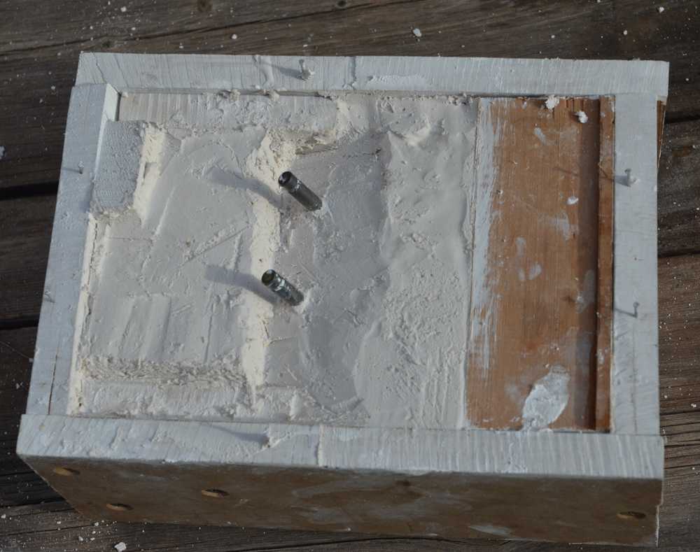

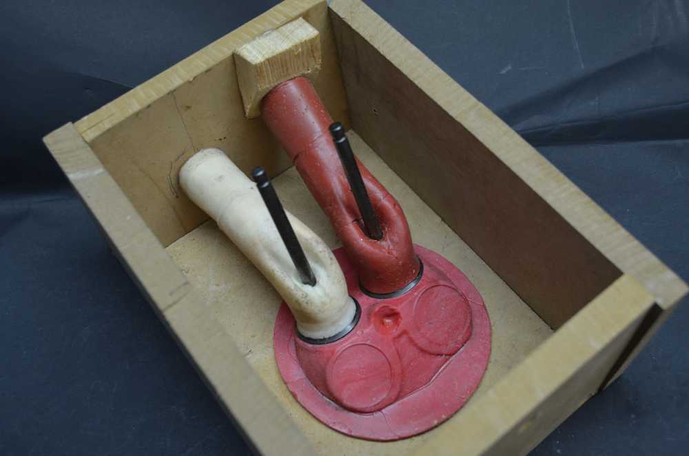

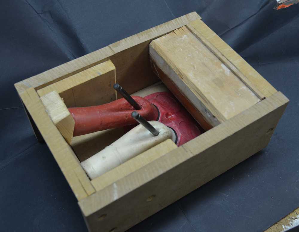

    Now was the time to mount these moulds into a box for casting the plaster.
    Can you make tools from plaster?-moulds-box-02.jpg Can you make tools from plaster?-moulds-box-03.jpg
    Ready to go.
    Can you make tools from plaster?-plastercast-01.jpg Can you make tools from plaster?-plastercast-02.jpg
    Here is shown the plaster cast, in its box and when removed.

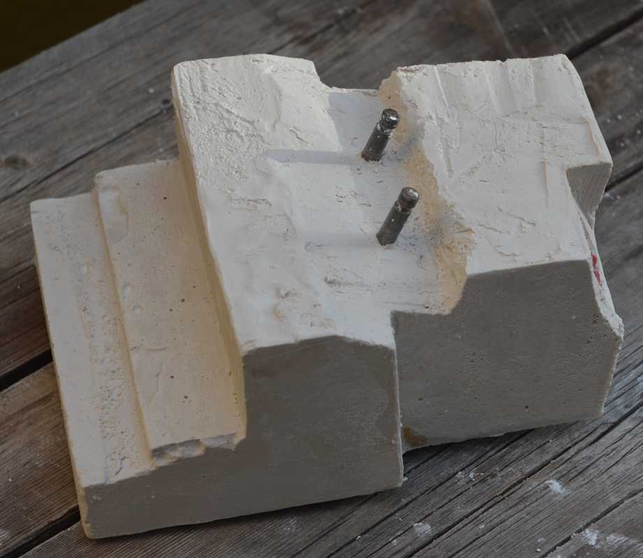

    The de-boxed plaster head awaiting the removal of the port moulds.

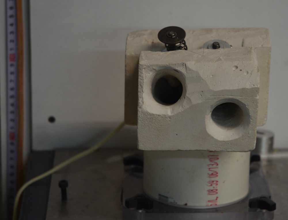

    Note the difference in the air entry height of the raised port compared to the stock one. The entry radius is to smooth the air entry and is common practice when flow testing.

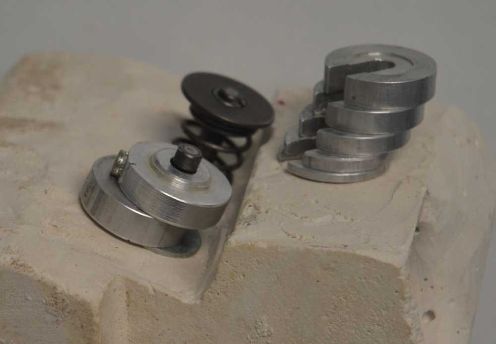

    For the flow bench tests, the valve is opened in steps of 0.050" and the flow is measured at each step and processed in my own software. I find the quickest way to do this is to place different width spacers between the base and a collar on the valve stem.
    The plaster head was tested and modified and the cycle repeated a few times until I was satisfied with the results. The results were good enough for me to proceed with machining the head.

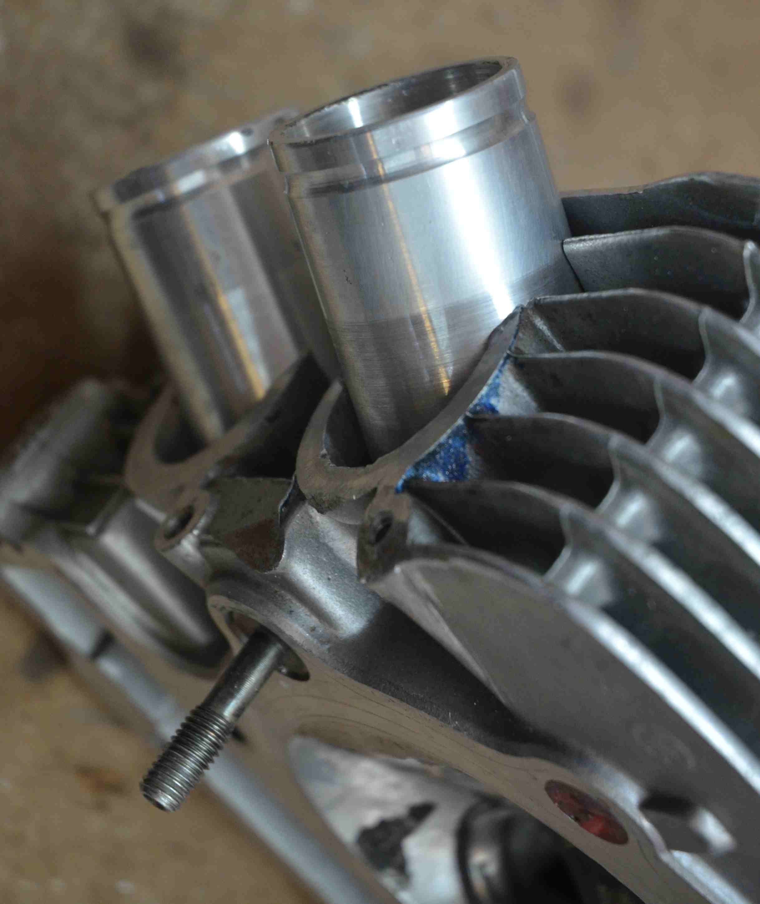

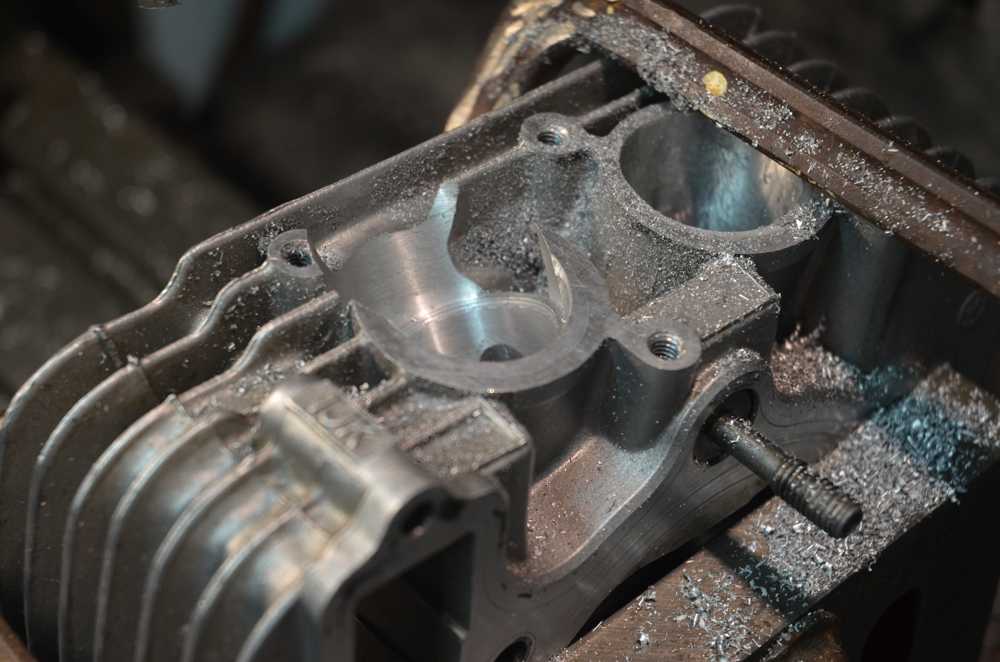

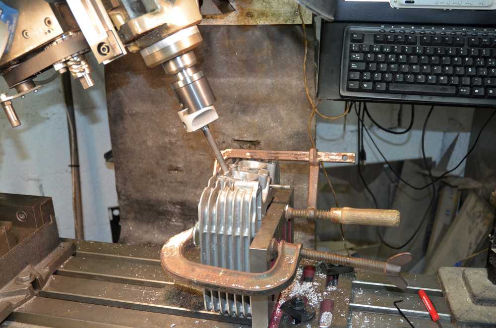

    Can you make tools from plaster?-srx-head-26.jpg Can you make tools from plaster?-srx-head-25.jpg
    Machining the port to receive the sleeve and the machined head.

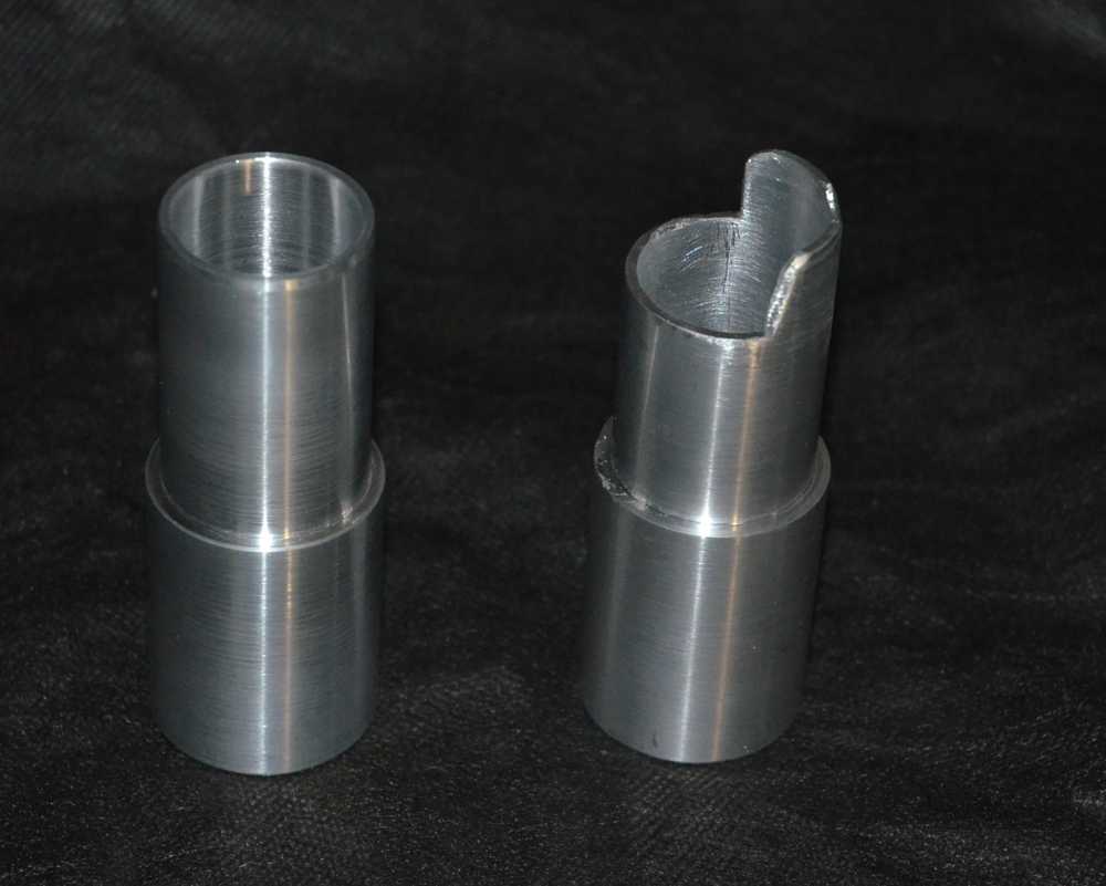

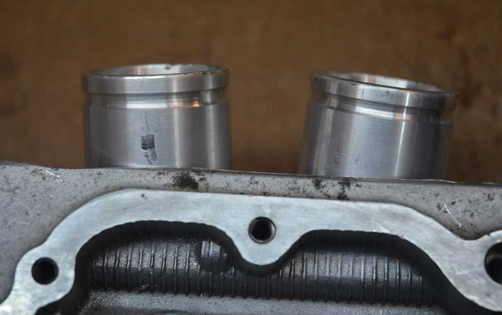

    Here are the sleeves to be shrunk into the head.
    Can you make tools from plaster?-port-inserts-02.jpg Can you make tools from plaster?-port-inserts-06.jpg
    Two views of the fitted sleeves.

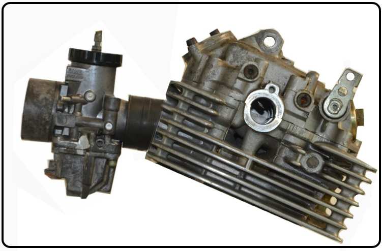

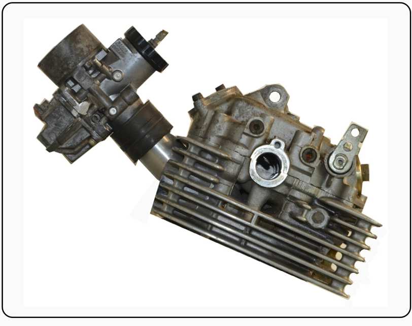

    Can you make tools from plaster?-srx-carbs-02.jpg Can you make tools from plaster?-srx-carbs.jpg
    Comparison of original head to carb orientation and the modified version. It is fairly obvious that the air has a much straighter shot with the modifications.

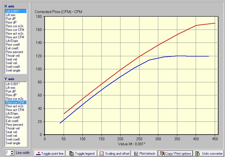

    So how did the plaster tool work out. Well if I had not made it I probably would have made the same modifications to the real head and achieved the same results. What the plaster version did was to remove the risk to the real head of getting it wrong. It allows experimentation beyond that which would be practical with the real thing. If any experiments were unsuccessful and the plaster head was changed beyond repair then it would be a simple matter to cast another.
    The following comparative "before and after graphs of the flow through a single port show the degree of success achieved, this was all achieved without enlarging the diameter of the port, which is important to keep airflow velocity high which has several beneficial effects.

    Fascinating stuff Tony, the graph result is impressive.
    A lot of tuners will keep their work to themselves to keep an edge, I like the way you share it with us.

    nice work. Skills that I can only dream about.
    One thing that I noted is that the angle of your carburetor has now changed. It was designed for a certain position. Now that you have changed that angle, the float may function differently and you may have issues with tuning the carburetor or the bowl leaking.

    Quote Originally Posted by Imabass View Post
    Way ahead of you. Have a look at https://motochassis.com/FileDump/AmalMk2.pdf
