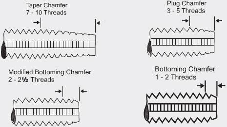

    I generally buy my taps in a 3 tap set which comes with a taper or starting tap a plug tap which has a couple of the end threads tapered and the bottoming tap which will have only the last thread slightly tapered
    . Cutting a plug or a taper tap has never been a problem for me I just use a thin cut off wheel and coolant then grind the end thread to look like a regular bottoming tap would.

    Lots of taper and plug taps have been ground into sorta bottom hole taps. I've even been a guilty party when in a bind. But when it's all said and done the shape of the end teeth can't be right if you just cut off a taper or a plug. The homemade ones always turn a little harder and break more often because the end two teeth are shaped wrong. If you have the time and money get a real bottom hole tap.

    I never throw away a broken tap.
    Name:  tap lead angle.jpg
Size:  19.8 KBCan you make bottoming taps?-tap-chamfers.jpg
