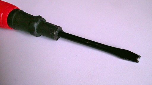

    Well to start with, the protruding D shape is not a bolt. It is, as others have already mentioned, some sort of shaft for a rotary control. And the other part with the screwdriver slots is meant to be held with one of these
    whilst turning the nut that secures it in place. And that is not a bolt either.
    Cheers Phil

    if you don't have the specific slotted screwdriver as shown by Phil. Just use a pair of needle nose pliers.

    or circlip pliers
