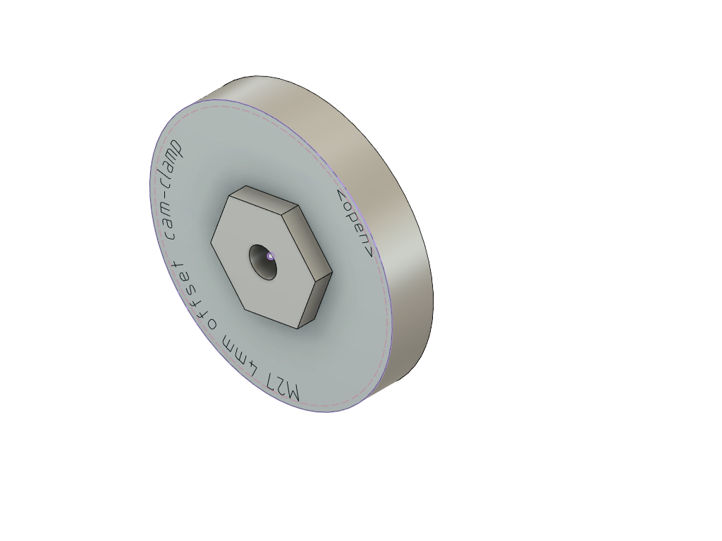

    Along with generally tring to get a handle on how to use this beast I've create, we made some cam-clamps and an mql system for the CNC. The clamps are made from 'bean-can' aluminium ( watch the vid) and operated by a spanner, so 'the handle' doesn't get in the way and you can really crank em tight. Hope it's of interest to some.
    Cam-clamps for CNC or workbentch-76e681e9-a38e-4480-994e-26da697678e1_camclampalpubv3.png
    Free CAD model of the cam-clamps is here: https://ko-fi.com/floweringelbow/
