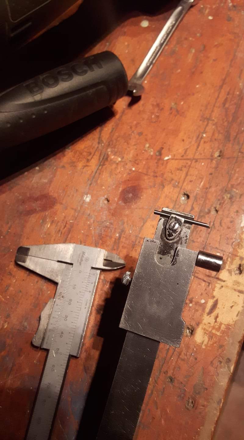

    Yep. Its a demo video.
    I have that kind of similar marking skribe... and many times i have answered to comments like " you shouldn't use caliber for marking ".
    Here those are very common tools.

    You don't need to make a hole. Grinded / filed groove on the backside and a screw with washer to hold the scriber would work as well.

    Quote Originally Posted by Tuomas View Post
    Wouldn't you then still need to tap threads into the hardened steel? At the very least, my cheap taps can't do that.
  10. #8
    Jun 2016
    Jyväskylä Finland
    832
    558
    Thanked 1,877 Times in 508 Posts
    Tuomas's Tools
    Quote Originally Posted by Masterjuggler View Post
    Yep. But its doable with quality taps. I have fixed one by making bigger hole and re-threaded it.
    Backside of my marker looks like this:
    Those marking scribes are about 10-20$ here in hw-stores, good ones. Of course there is "premium" models too.
