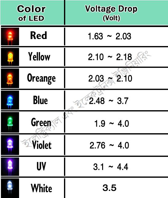

    LEDs are used often enough in home projects that it's worth a short tutorial on determining the proper resistor to be used with one.
    The breakdown voltage of an LED (Vb) varies with color. This chart shows ranges of that voltage...
    A typical supply current is I=20 ma. The required resistor can then be calculated from Ohm's law (R = V/I)
    R = (Vs - Vb)/0.02
    here Vs is the power supply voltage.
    An example will help. Suppose we have a red LED we wish to power with a 12 volt battery. From the figure, the average Vb for a red LED is 1.9 volts.
    Then:
    R = (12-1.9) / 0.02 = 10.1 * 50 = 505 ohms
    The standard series of resistors looks like..
    1– 1.2 – 1.5 – 1.8 – 2.2 – 2.7 – 3.3 – 3.9 – 4.7 – 5.6 – 6.8 – 8.2 – 10
    All of these values can be multiplied by powers of ten (1.2 – 12 – 120 - 1200, etc.).
    So the closest we can come to 505 is a 470 ohm resistor.

    The wattage, W, being dissipated in the resistor is given by...
    W = IēR = 0.02ē * 470 = 4E-4 * 470 = 0.188 watts
    The common standard power ratings of resistors are 0.25W, 0.5W, 1W, 2W, 5W, and 25W so even the smallest size can be used in this application.

    [QUOTE=mklotz;194134]LEDs are used often enough in home projects that it's worth a short tutorial on determining the proper resistor to be used with one.
    Marv,
    A bit of poking around for infrared LEDs (which I occasionally use in isolation applications) yields Vb around 1.9v.
    Bob
