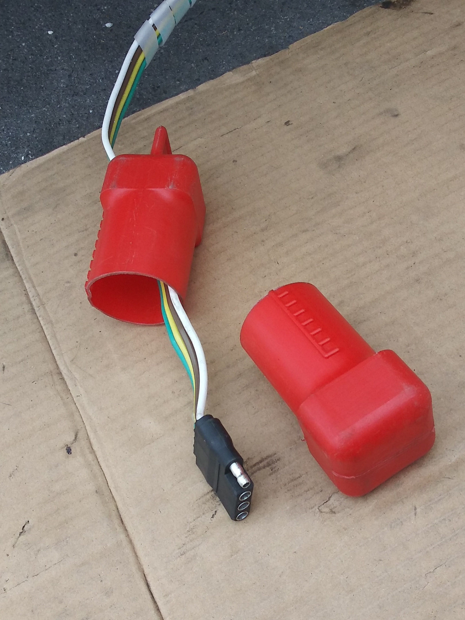

    1) Start with a 2 piece drill sleeve; [those slick packages for new cutting tools] large enough for connector attached to vehicle side
    2) Slot female side to accept 4 or 7 wire bundle.
    3) Insert free [un-spliced] end up through tube and out the slot.
    4) Retract connector inside female side and insert male; this combination resists dirt surprisingly well.

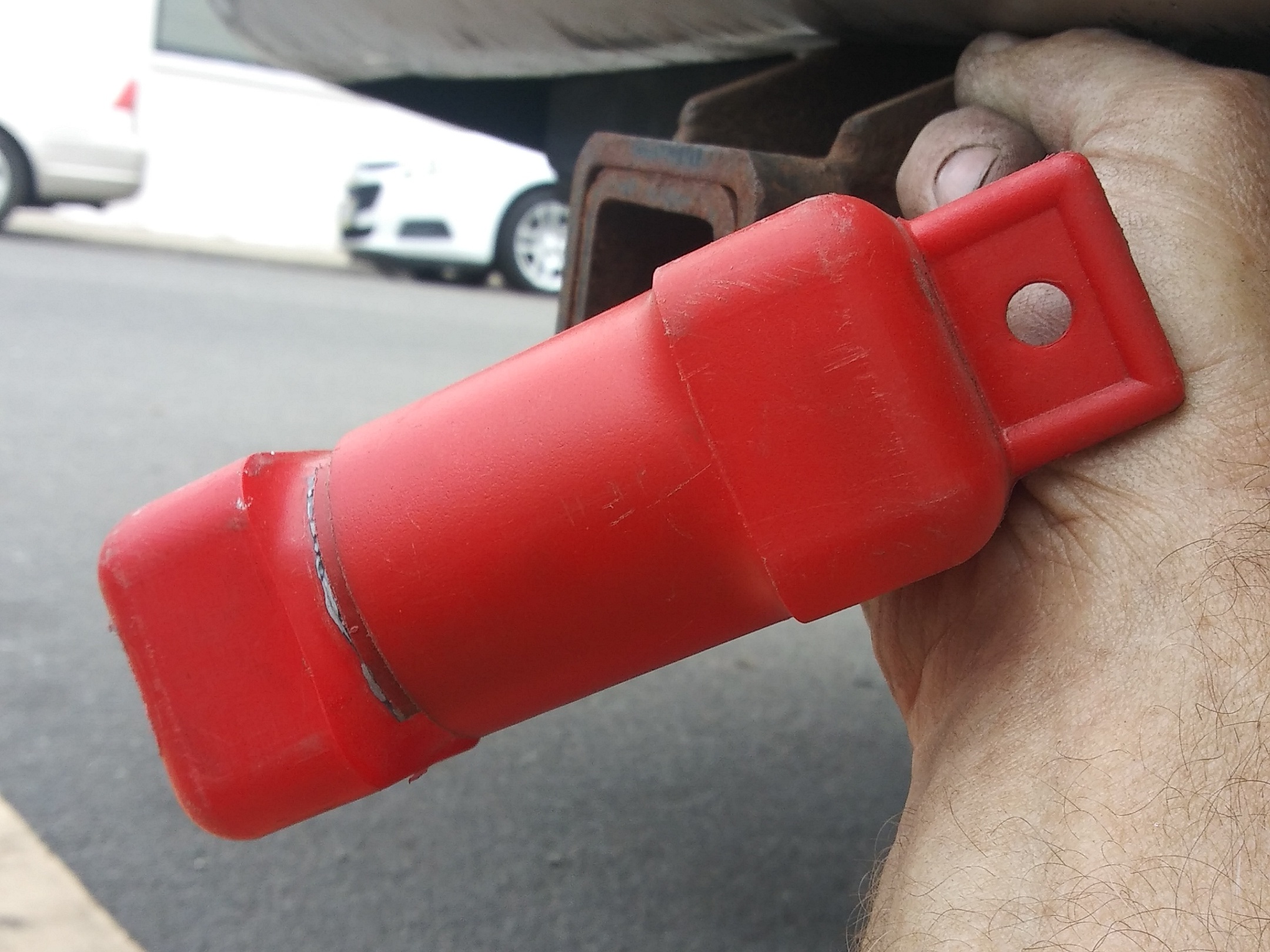

    Some tubes aren't injection molded, but roto-molded; they have some taper and fit too loosely after sectioning. So the twist lock feature can work, I bonded 1/3rd of the section removed to male side, opposite of the locking lugs. That was sufficient for them to engage.
    5) With a pair of tubes, make a duplicate male for the trailer side, handily encasing the whole shebang.
    6) The same idea works with plastic prescription containers......

    First off, what a great repurpose of a a bit of packaging material.
    Just one thought though, had you reversed the cups and used the one with the hanger hole in it you could have added a lanyard to that or hard mounted it somewhere near by then when not being capped over the connector it would not be at risk of being lost. If mounted to the tongue of the trailer this would also serve to keep the cord from hanging or dragging should the trailer be moved without being fully connected.

    Thanks guys, I appreciate it. It was as much about the idea, and obviously the little Jab.
    Frank S is right about reversing the male side, I'd puzzled that coming up with the remedy. I have a magnetic hook for female end, and felt open end down offered some water or dirt resistance. When towing, a box holds spare bulbs, keys, hitch pins etc, and now that plug cover. It's a car, so not often called upon for towing, but does well enough as option when weight isn't issue. Also near twice the mileage compared to my F150....which I didn't have yet retrieving 36" stomp shear (18" gap, even heavier!) and full Gorton 265 Cutter Grinder.
