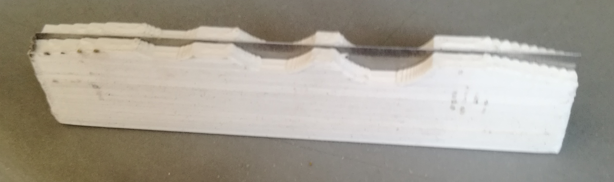

    Inspired by Rick Sparbers cablesheetstripper: https://rick.sparber.org/CableSheathStripper.pdf I designed a 3D printed version. 3 round indentations with ID 13 mm and depths of 1, 2 and 3 mm and tapers at both sides with depths of 1 and 2 mm:
    The knife is a utility break off knife blade 9 mm which is grounded to the length of the stripper. In the 3D print is a small slit which holds the knife.
