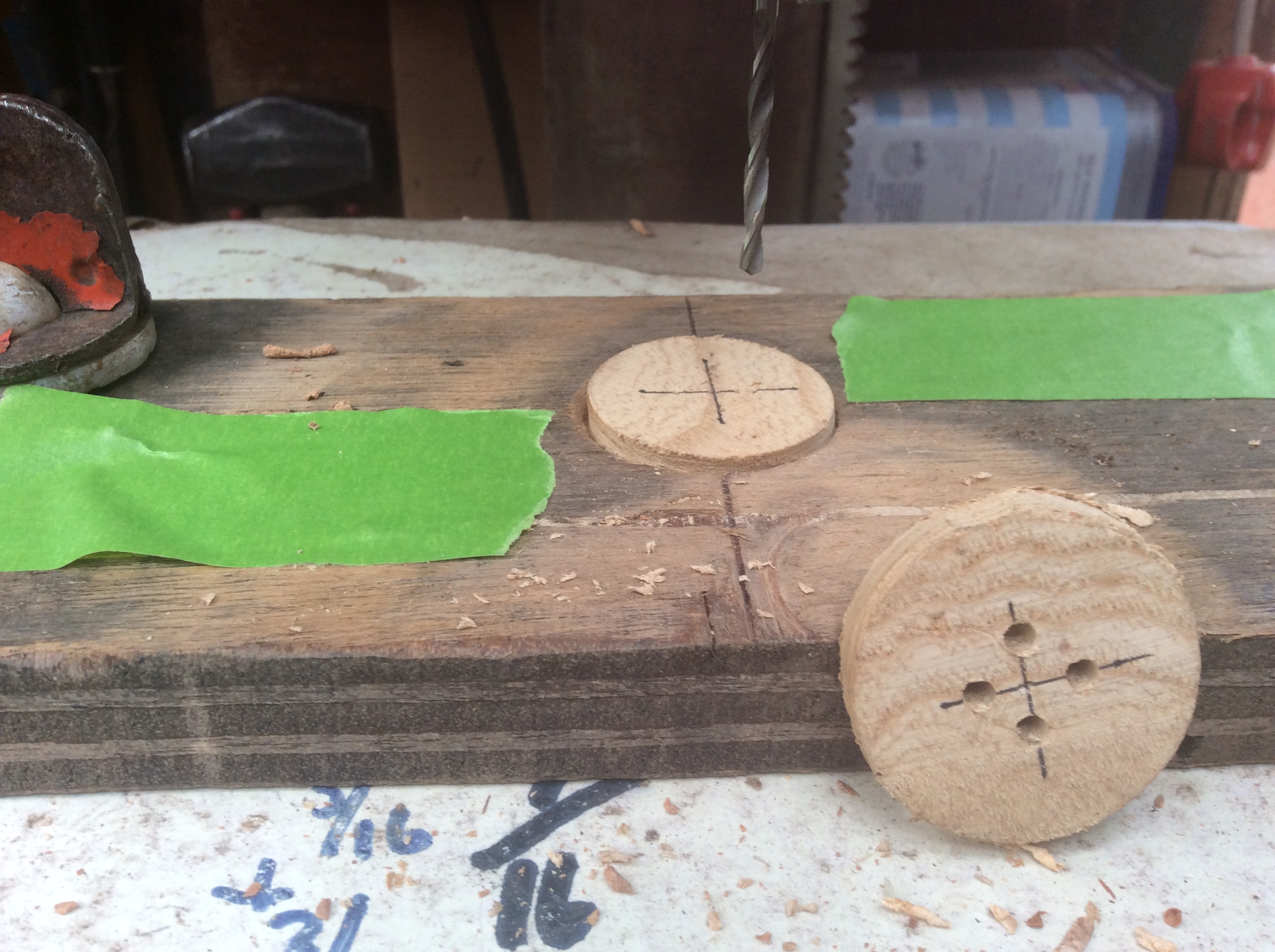

    Buttonhole drilling jig
    This simple jig achieves considerably better results compared to previous efforts. The disc is slightly off centre to the drill axis, marked as before with centrefinder, but not pricked, saving a lot of time. It rests in a hole, through the centre of which are drawn lines at right angles, so all that’s needed is to rotate the disc to drill 4 holes.
