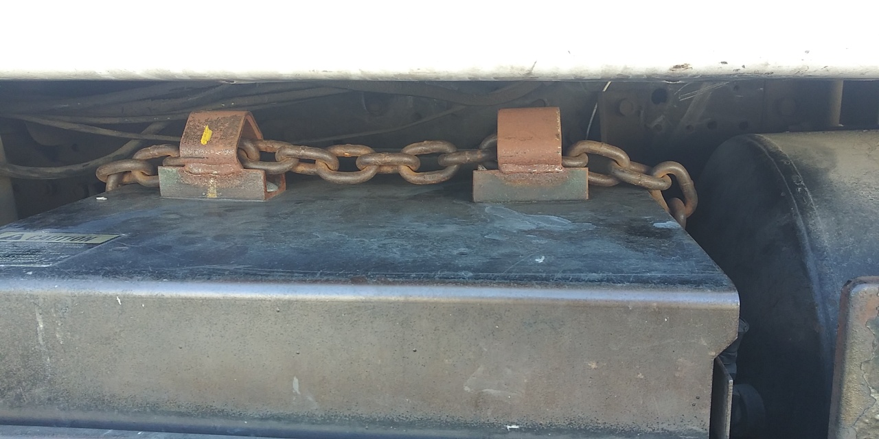

    The stock tray is under the cab, drivers side. The cover has a rubber hood clamp, where top step meets frame of first step an imposing 1/4-20 stud and nut; that's ll that stood between their couple bottles and my wallet.
    I combined two 1/2" cable clamps, a couple feet of 3/8" chain, four bits of C-channel, two bits of 3/16" square tubing, various hex and carriage bolts, and a helping of crude Yankee ingenuity.
    The dog's eye view shows added parts.
    Lower front and back have slots that slide over a stub of round stock, that with the rubber hood clamp kept it from lifting or sliding out.

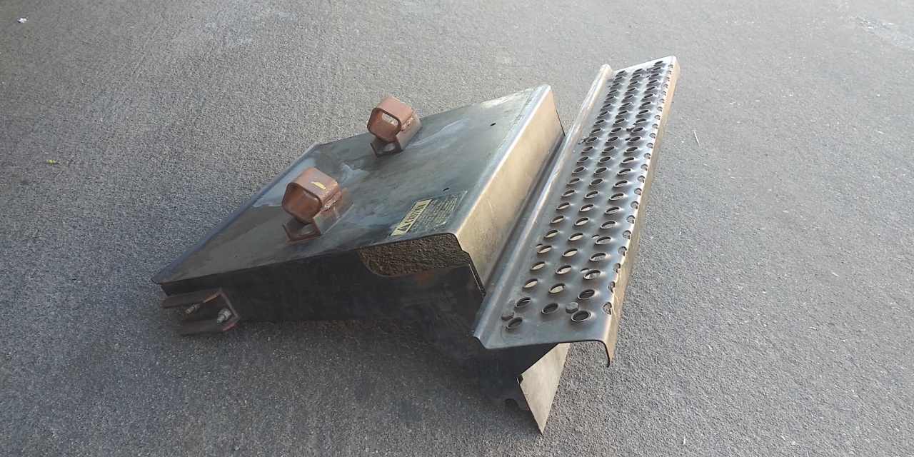

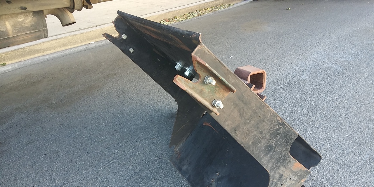

    Another shot details added material around those slots. Old slots wallered out, nearly round. Added material, not much security, but tightened up what was looseness creating a rattle.

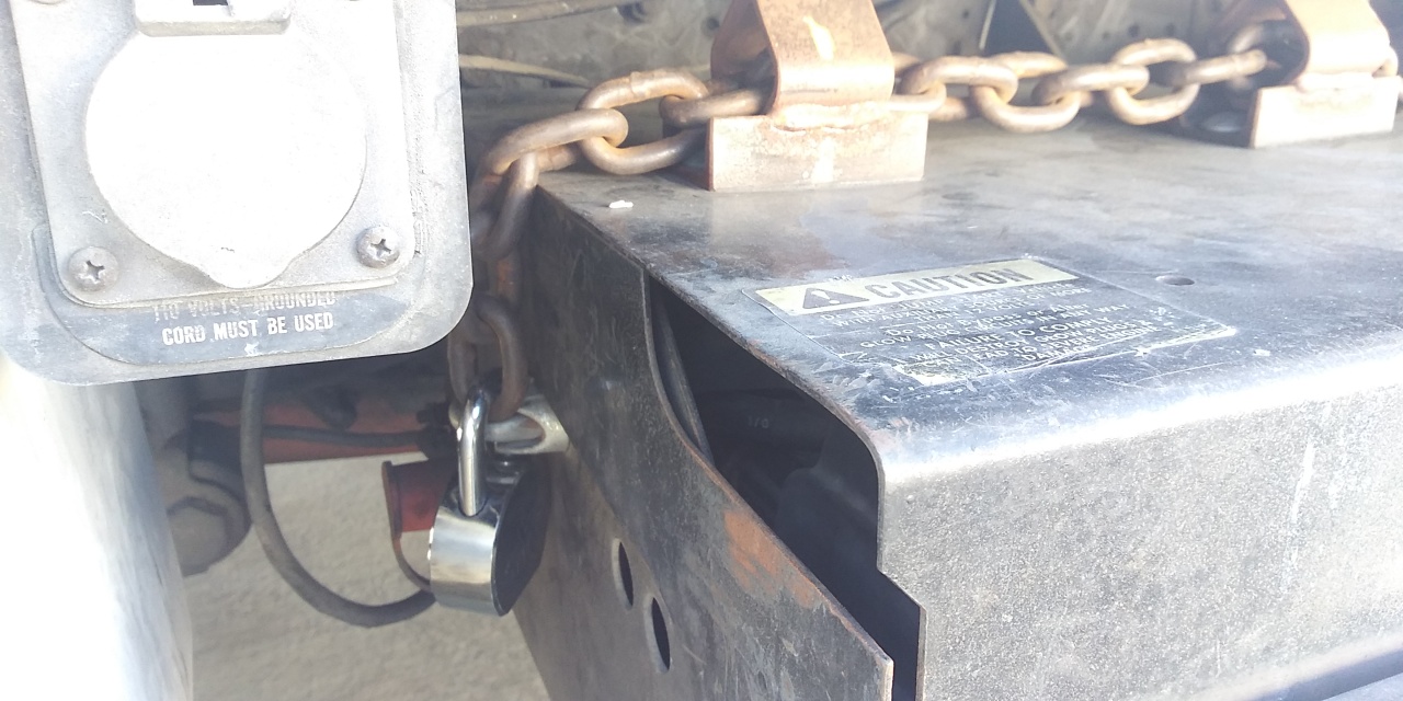

    Here, the chain is threaded over the top, secured at one end, bolted into a cable clamp. It would take a lot of cutting to get at it; time consuming and noise making. Not favorite atmosphere of a thief.
    But wait, more of.....never mind, you know the drill; box truck, saga, yaddy-yah-battery_box_4.jpg
    Here's the business end, both a large lock and last link tied to cable clamp. A little more room to work, twice the material to penetrate.
    But wait, more of.....never mind, you know the drill; box truck, saga, yaddy-yah-battery_box_3.jpg
    While the inboard side is open, that window is smaller than battery upright or laid down. Not to mention a nest of 1/0 and 2/0 stranded copper, another favorite target, out of reach.
