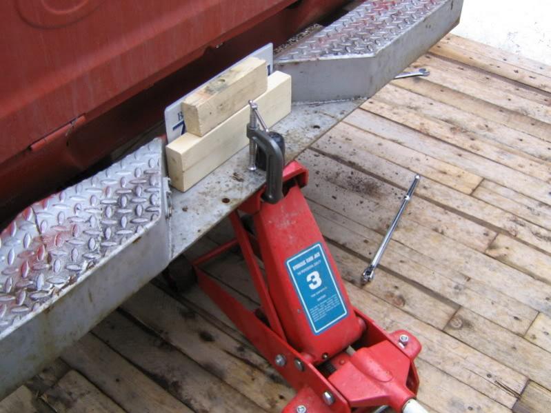

    Bumper installation aid
    By removing the swivel plate from your trolly jack and using a "C" clamp you can safely remove/install heavy bumpers on your truck.
    Attached Thumbnails Attached Thumbnails Bumper installation aid-img_1542.jpg
