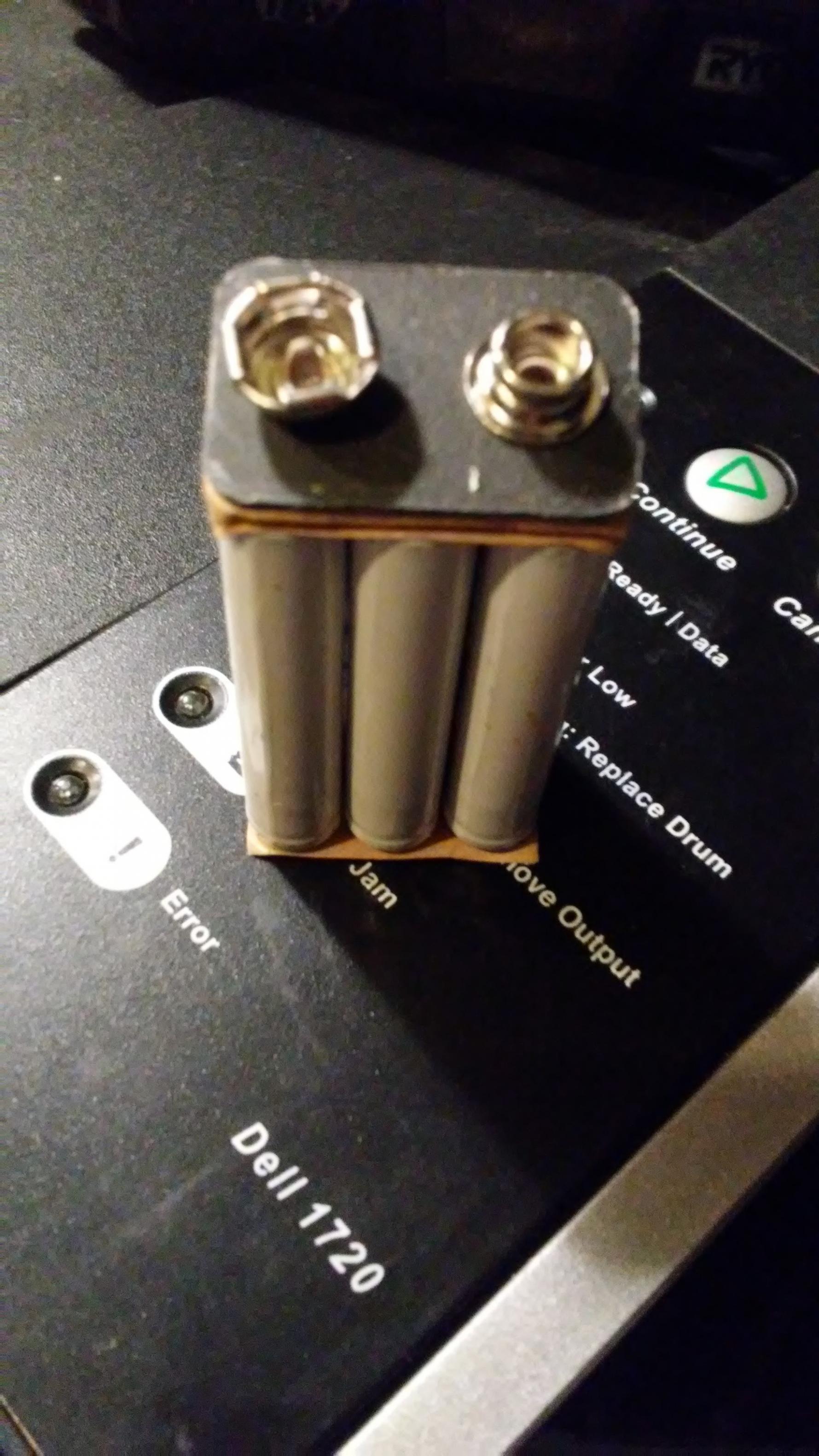

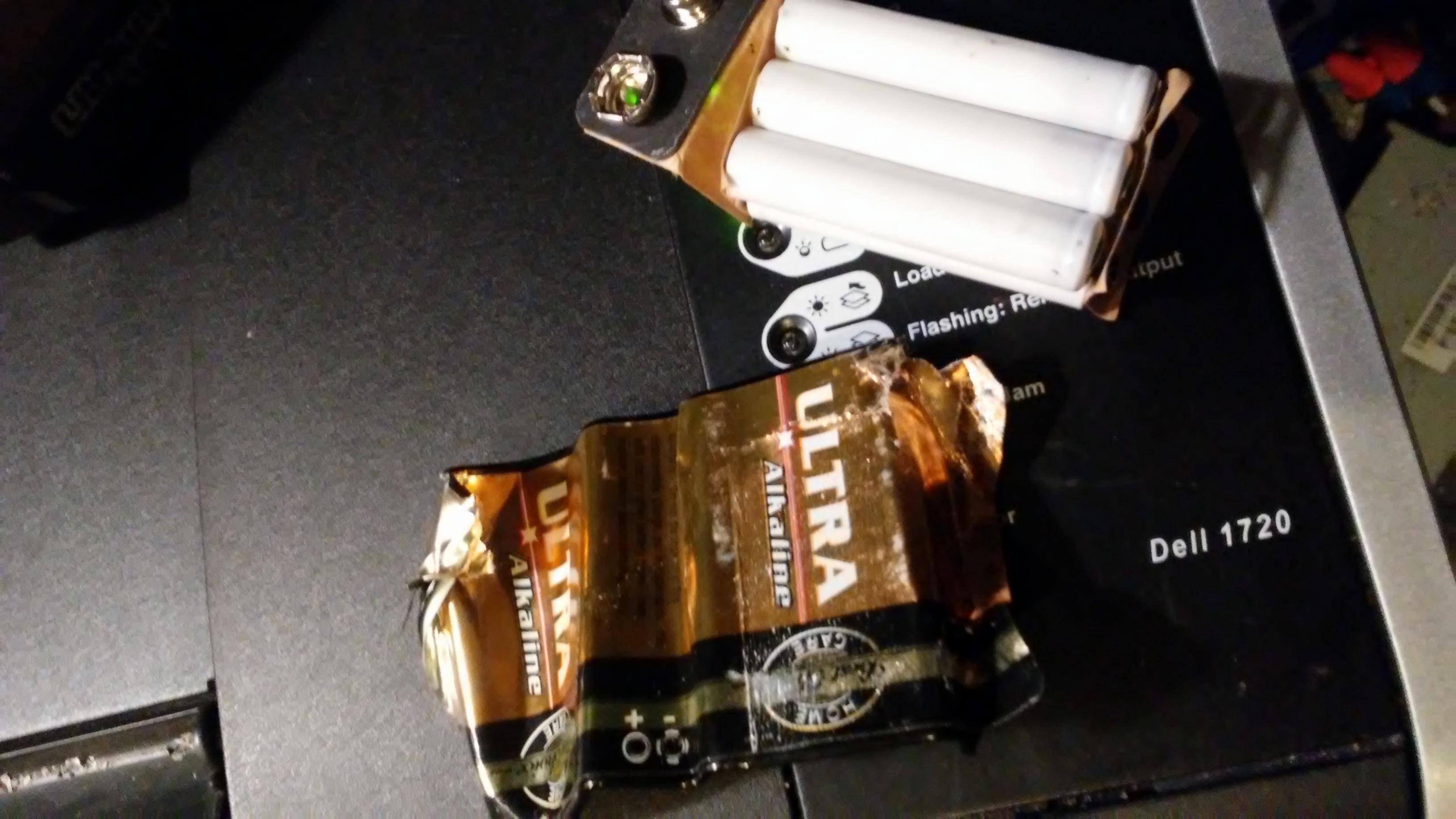

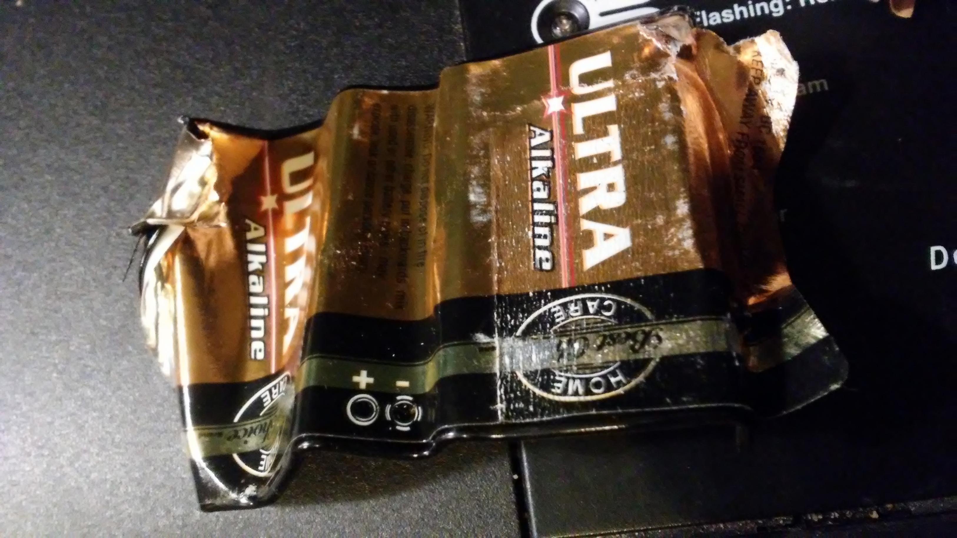

Get that old 9V and take it's cover off...
They are hardly ever made like this now, they have a newer cheaper way of making them where it it stacked in plastic casing but with this style the battery pretty much consist of AAAA batteries, 1.5V each.

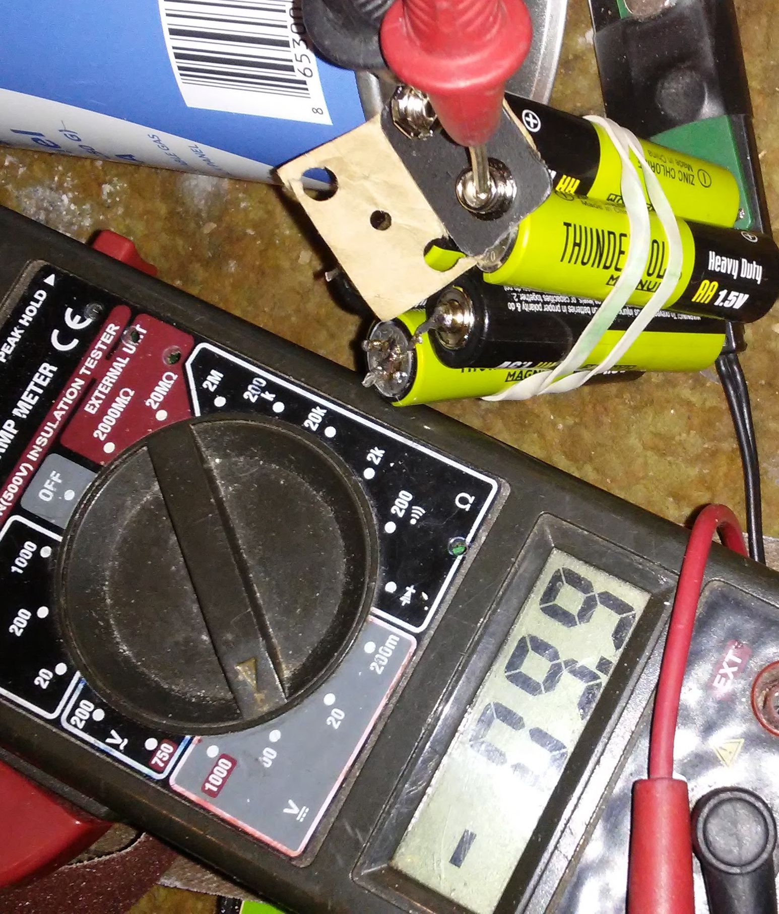

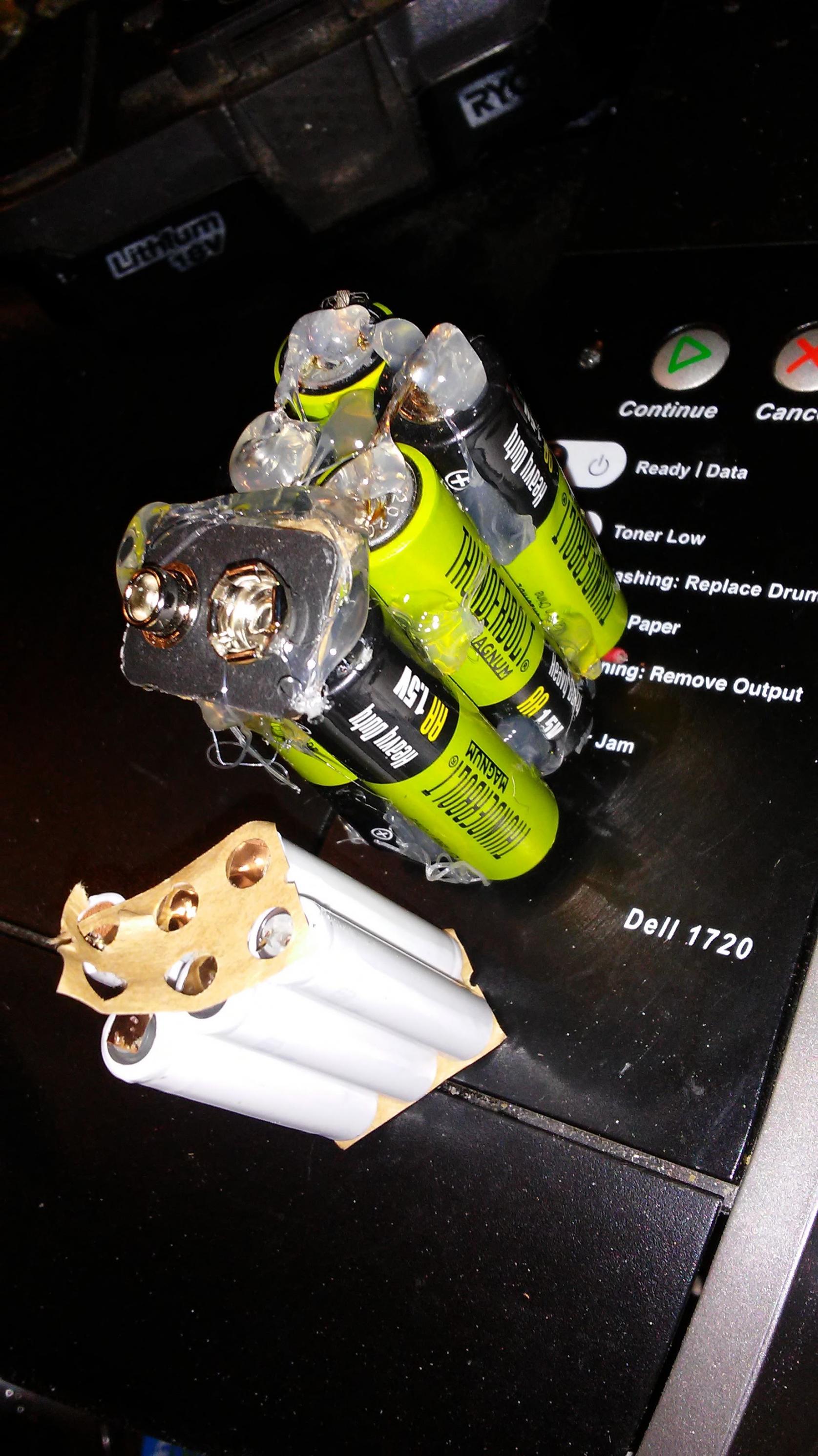

I pulled the top off of it, noting which was negative side and which was positive then I arrange my free Harbor Freight AA cells in the right directions then put a rubber-band around them.

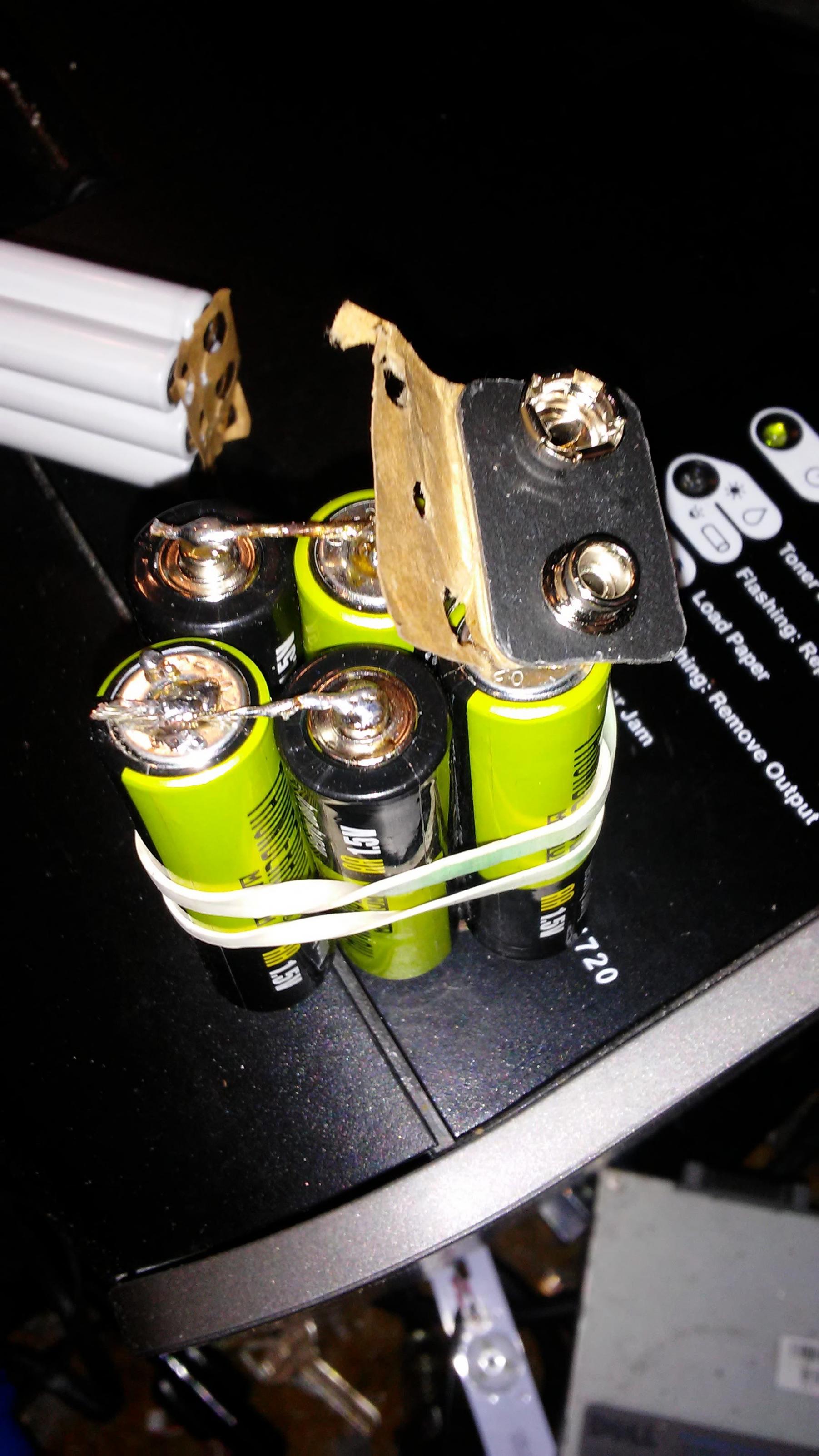

I get my trusty solder iron out and my safe goggles and tin the tips of all the batteries. I noticed 2 of the batteries had dents in the side but that's okay....
I then solder a wire going neg - to pos + so that the batteries are connected in series....
Note that I had the connector soldered on backwards here but all and all it worked...

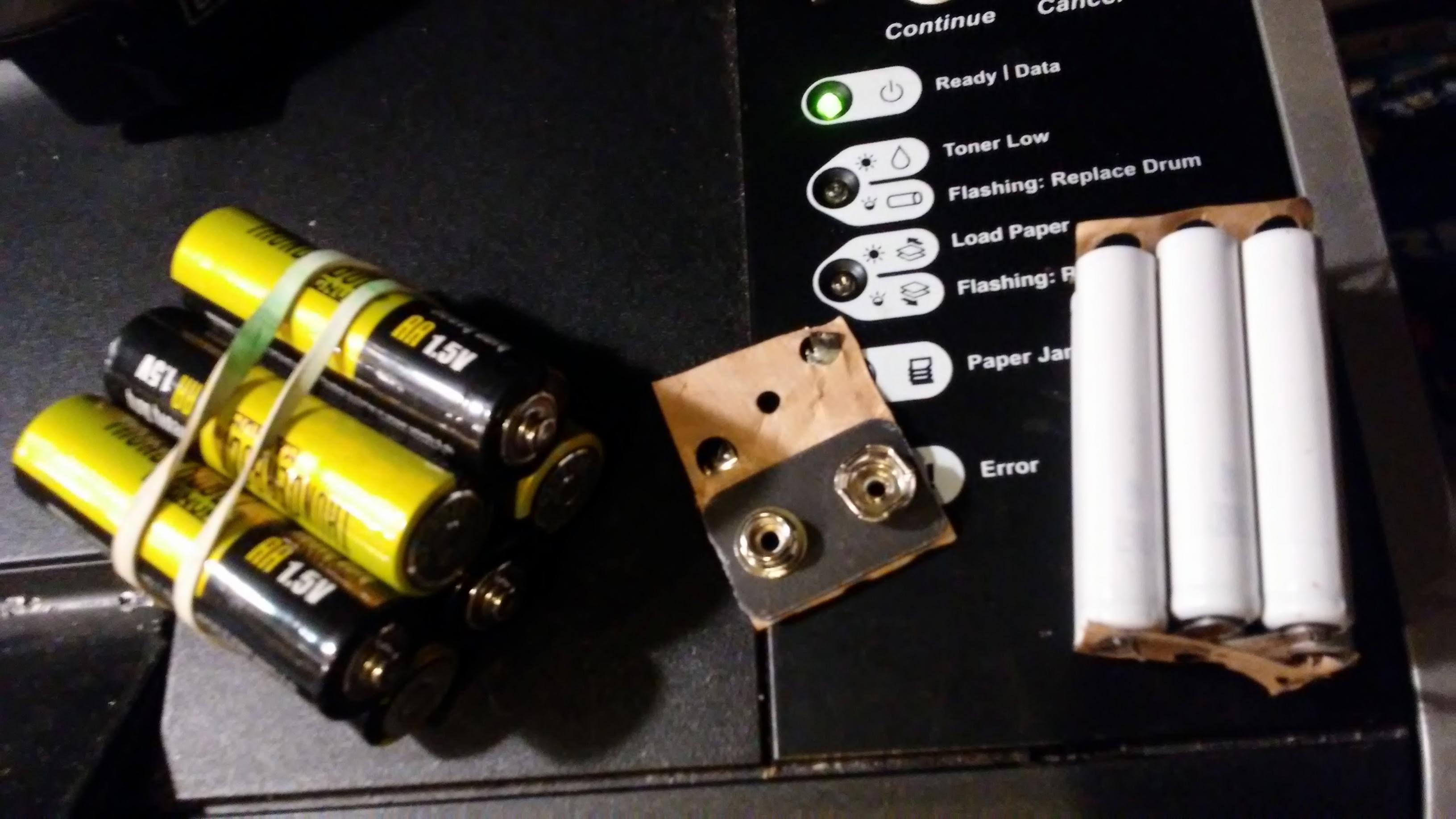

Then after all that soldering on them gotta hold them together somehow so I bust out the hot glue gun and done. Here is a little side by side to compare the sizes
