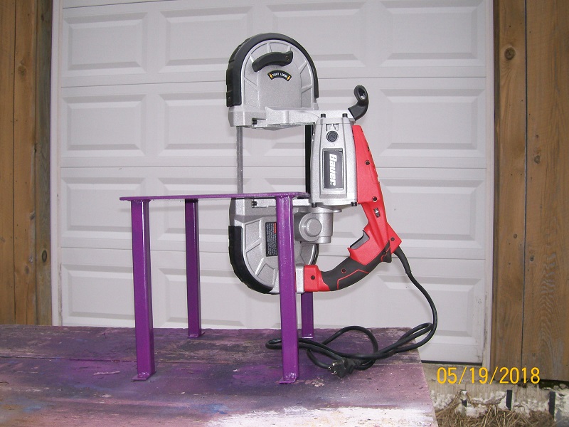

    Build a Portable Bandsaw Table (Free Plans)
    This video will show you how I built a new portable bandsaw table for my new Harbor Freight, Bauer Portable Bandsaw, stock number 63444. This table is fairly generic and not unlike so many others you’ll find on YouTube or this forum. The only big difference is I have provided FREE PLANS for this build with dimensions, so you can build one easily, without head scratching.
    There are two drawings. The first shows all the pertinent dimensions and parts as assembled, with notes. The second drawing shows the clearance notches on the table for the Bauer Portable Bandsaw, with dimensions.
    As usual with most of my designs, this configuration and dimensions used were driven by what I had on hand for materials in the shop, without having to go out and make additional purchases. I did purchase two screws locally though, as I needed longer ones to mount the saw to the table. I also needed flathead screws, so they could be countersunk. The two screws required were M5-0.8 x 20mm flatheads. They cost me a buck plus tax. The Krylon paint was purchased last year for only $1.49 from a local salvage store. The steel was left over from other projects. The bandsaw itself was purchased from a local HFT store for a hundred bucks, on sale with coupon.

    Good on you for assembling some plans to share with others.
    I picked one of these saws up almost a year ago and it has been indispensable in the shop when working with metal. My stand is a little different than yours, but similar overall as the purpose is the same. I used some angle to connect the legs together, provide something to clamp to the bench when I'm cutting and extend a bit rearward to support the saw's weight.
    Thanks for sharing!

    My saw is held to the bench by the tabs I welded to the bottom of the legs. The tabs can be clamped for temporary use in a location, or the table can be screwed or through-bolted to a bench using the holes I drilled in the tabs for a more permanent installation.
