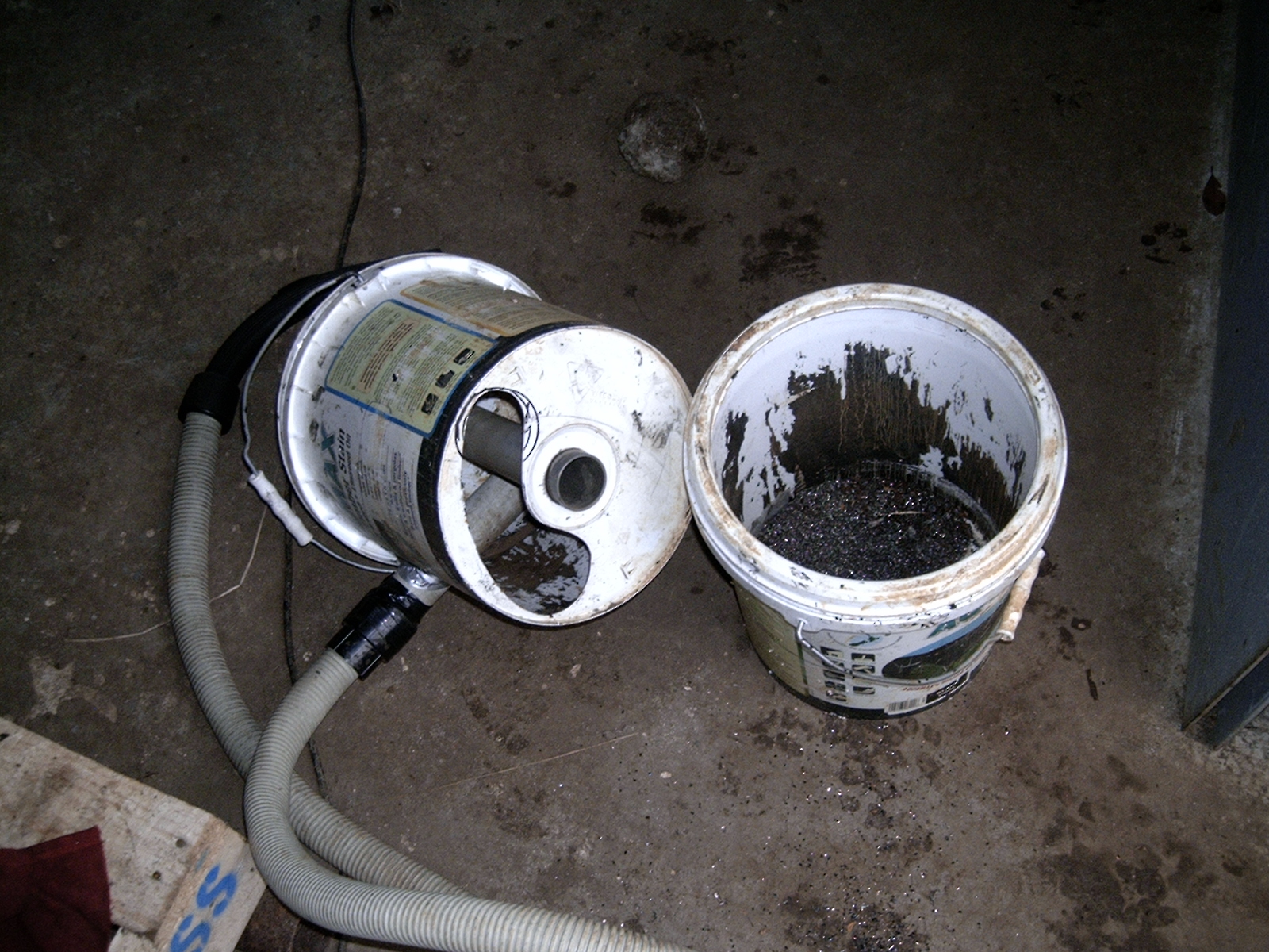

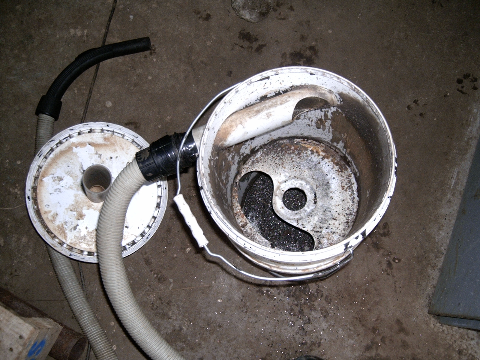

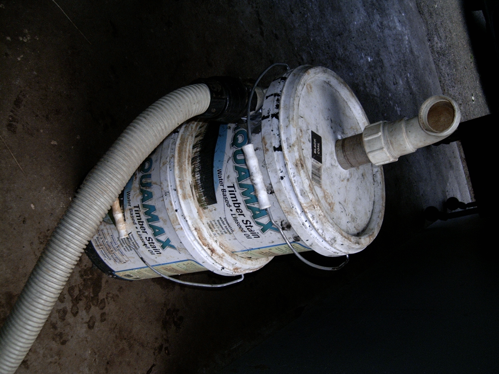

    It is called a Thein Separator and they wok very well. Shorter than a vortex cone separator and nearly as efficient. This one has been going strong for many years and also has been well used with a homemade Holy Moley:Build dust separator  more powerfull and useful-hpim0318.jpgBuild dust separator  more powerfull and useful-hpim0320.jpgBuild dust separator  more powerfull and useful-hpim0319.jpg I extended the air out tube through the top part purely for some extra rigidity no other reason. Very cheap to build and when used to dig holes I can swap out the catch bucket as they fill up.
