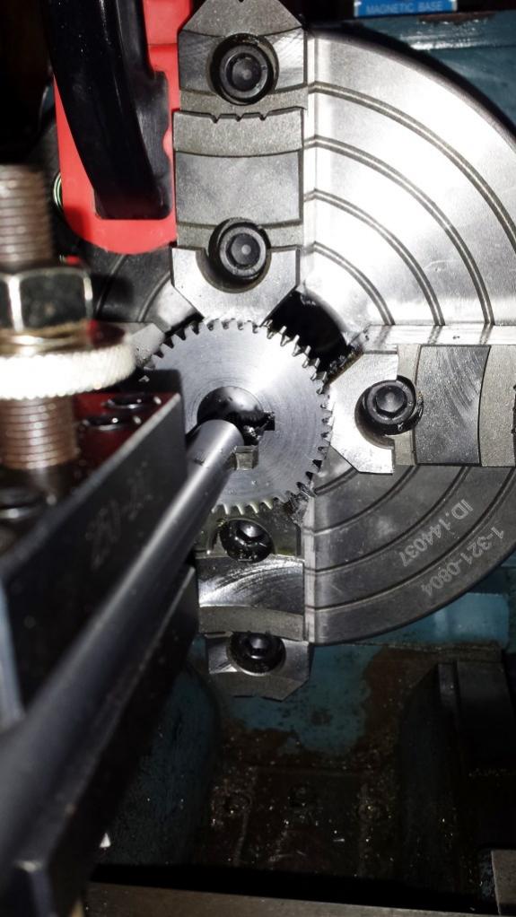

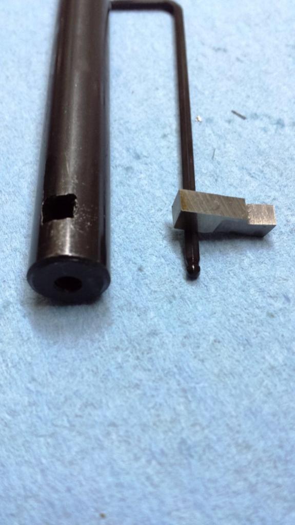

    Topslide keyway slotter
    I have never liked the idea of racking the lathe saddle back and forth to cut keyways, it puts undue wear on bed ways and over strains the rack feed parts.
    Much better to use the top slide as a ram with the saddle locked down, this is not my idea as I saw it in the Model Engineer years ago and at least one manufacturer offered this as an attachment. With a 4:1 ratio on the lever it makes light work of a keyway with the added possibility of tapered bores being keyed. I have seen gear teeth internal and external cut by this planing method but have not tried it myself.
    Parts are simple to make, all it takes is to remove the feed screw and fit a suitable forked adapter and a lever of your choice, I clean and oil the slides before and after and have noticed the slide is much smoother after having had a good workout, it does not move much in general use apart from taper turning.

    I agree with your assessment of not liking to use the lathe saddle for broaching keyways with the metal lathe. My example was for performing a 5mm keyway broaching for two my missing change gears. The method was just to get started with single point threading for Imperial threads (the missing 40T gears). Using the lathe for keyway broaching is only a temporary solution and not a long term production method. After my initial HMT article about using my 12" swing lathe for broaching the missing/replacement change gears, I now have several arbor presses and lots of various Imperial and metric broaches for doing this type of work. I plan to add a several ton hydraulic press to my set of tools to make the keyway broaching even easier and much faster.
