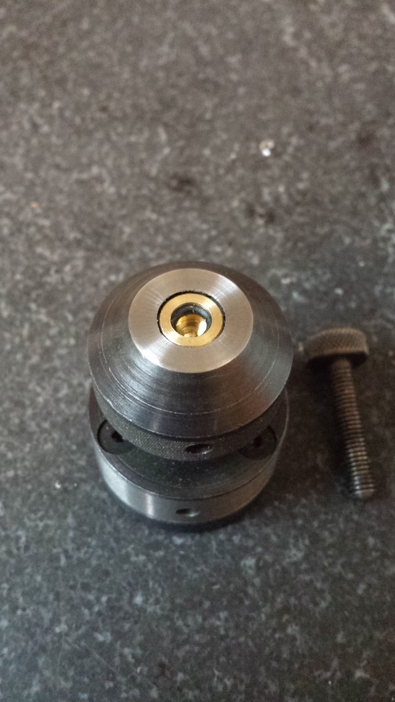

    PJs - Nice modifications for the lathe tailstock ejector rod using the Delrin. Yes, prefer the brass screws.

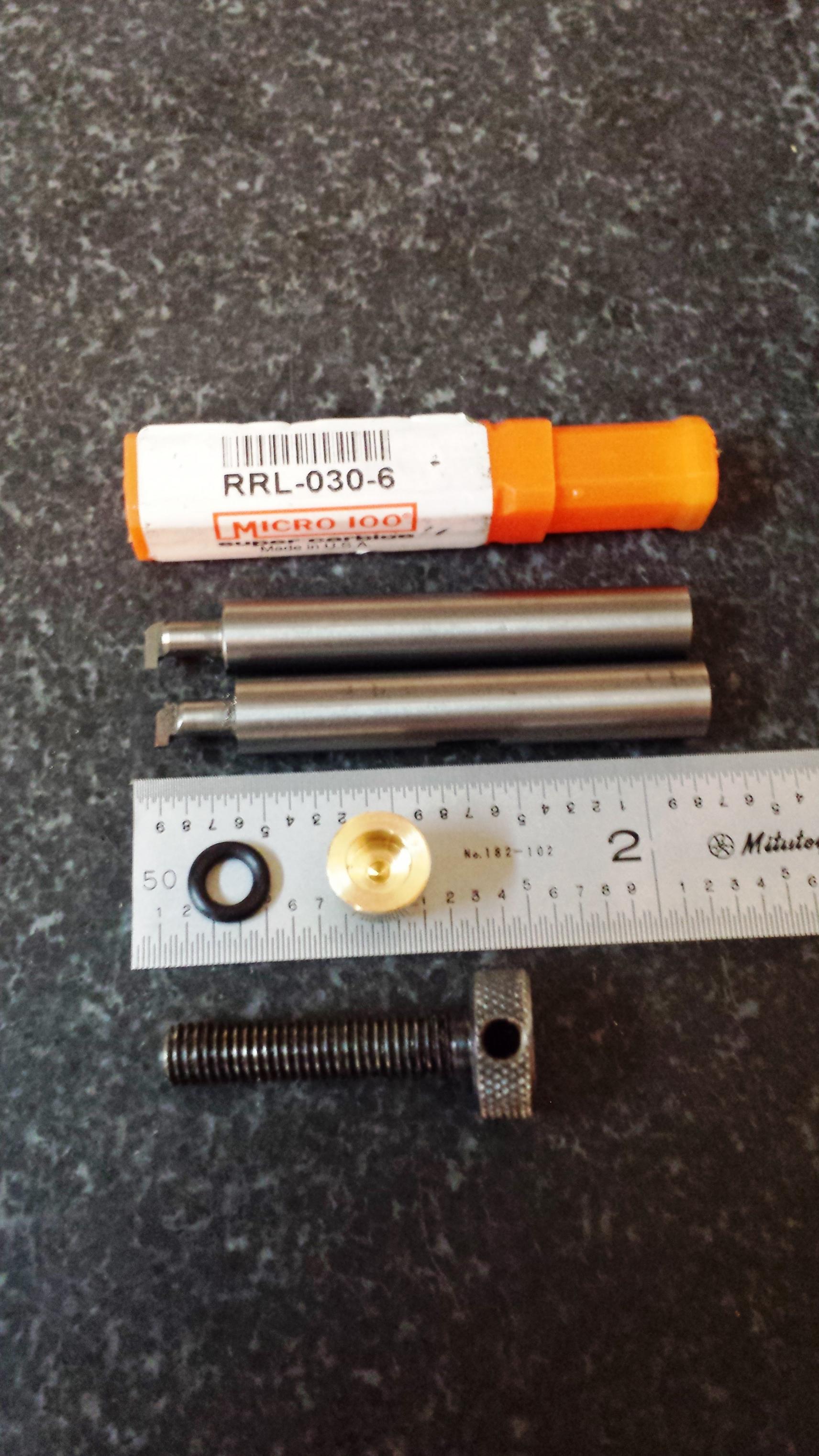

    Marv - The brass caps can (and do fall out) when setting up parts in the V-block. I will try machining a small internal O-ring groove in the bore of the brass caps as a way to hold the cap onto the screw threads. Last year I bought from eBay for $36 six of the Micro 100 solid carbide boring bars for machining very small internal grooves. Great price but I had no immediate project. Here is a photo of the groove cutting boring bars.
    Brass Clamping Screw for Starrett V-Blocks-small-boring-bars-internal-o-ring-grooves.jpg
    I will post the finished parts.

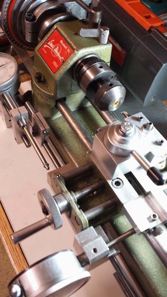

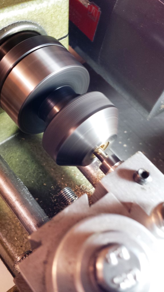

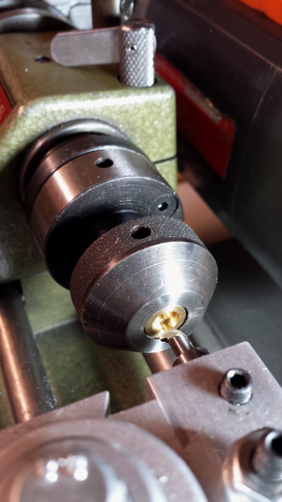

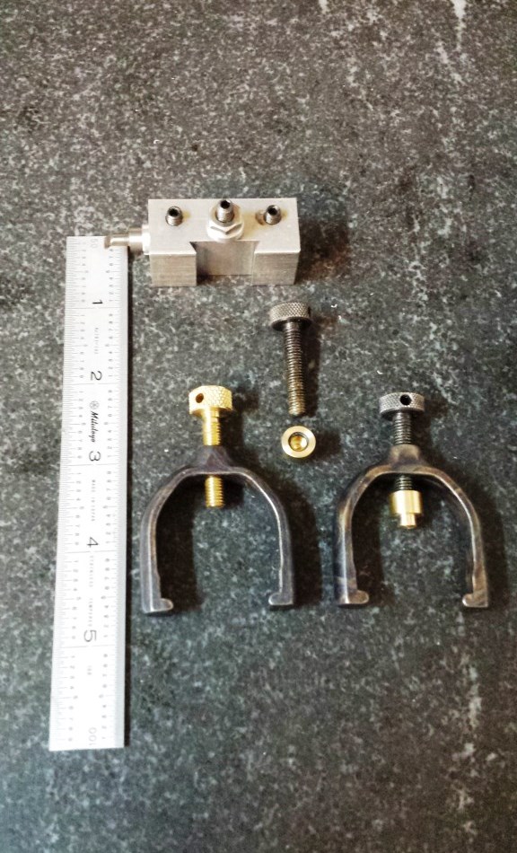

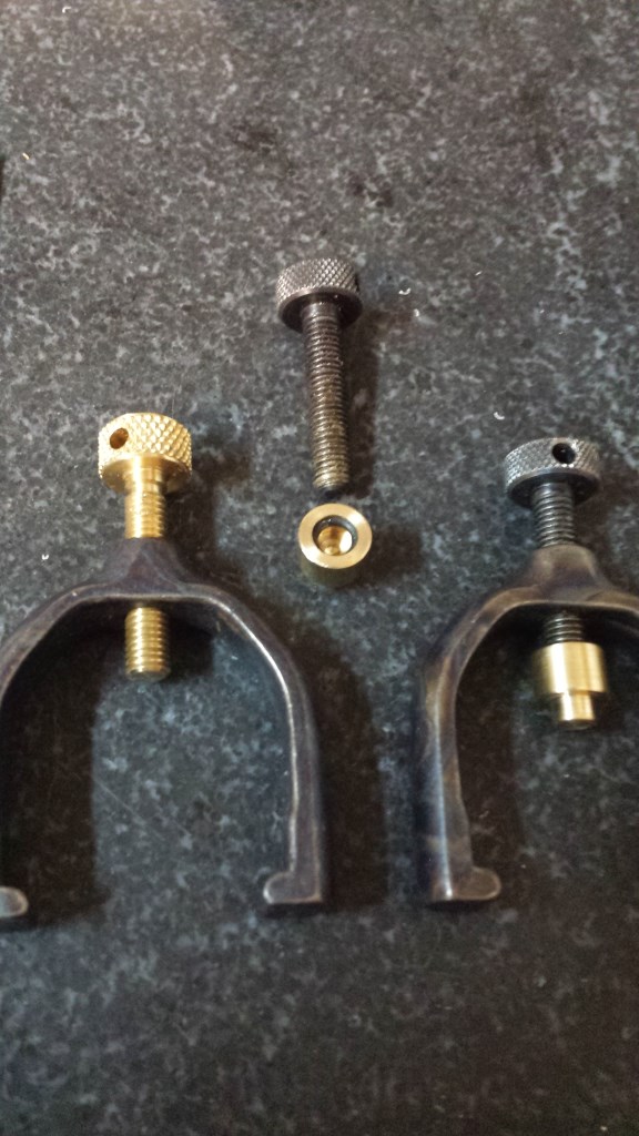

    This is my solution for holding the protective brass caps onto the steel clamping screws for the V-blocks. I used the two brass caps shown above and machined an internal O-ring groove for a small 008 Buna N rubber O-rings. The O-ring in the brass cap provides just enough snugness to hold the cap in the screw thread but is easy to put on and take off.
    I happened to have the tiny Micro 100 solid carbide boring bars for cutting small O-ring grooves and these made the job very easy. I used my modified Unimat lathe for the machining work using an old E16 collet holder to hold an ER16 0.375 ID collet. I don't recommend using ER16 collets in an E16 collet holder but it works (FYI -never use a ER16 collet holder to hold E16 collets). The O-ring in the brass cap provides just enough snugness to hold the cap in the screw thread but is easy to put on and take off.

    Nice looking caps, Paul. The O-ring was a great idea and seems to work good.
    I had never heard of E16 collets before but did a bit of research and seems they are the forerunner to ER16's that don't have the cap lock groove but similar tapers. Also found it was an option for the Unimat's and can be found on ebay sometimes. I can see why you wouldn't want to put an E in and ER holder...likely wouldn't get it out. Always great to learn something new. Thanks for sharing and the great pictures! ~PJ
