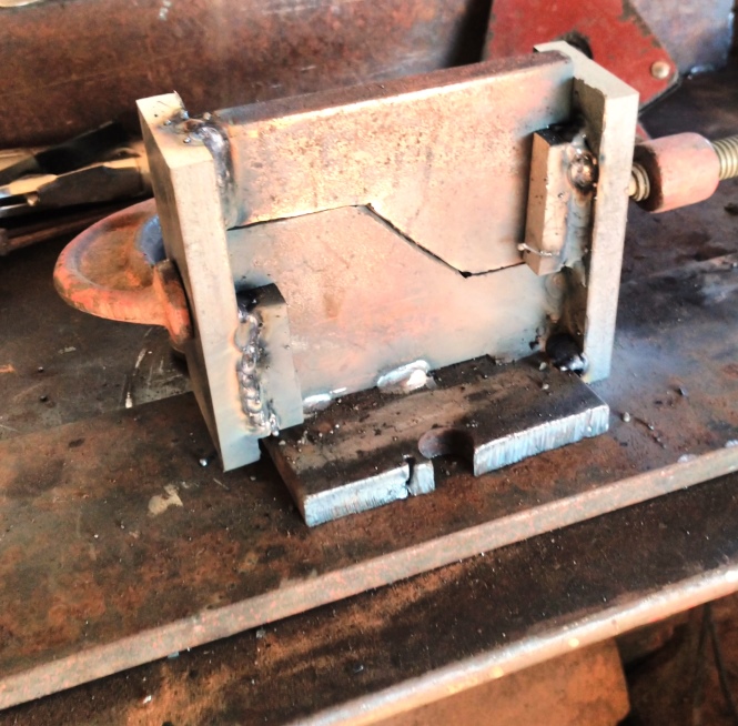

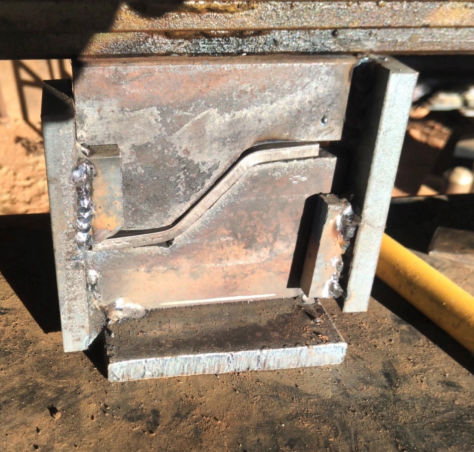

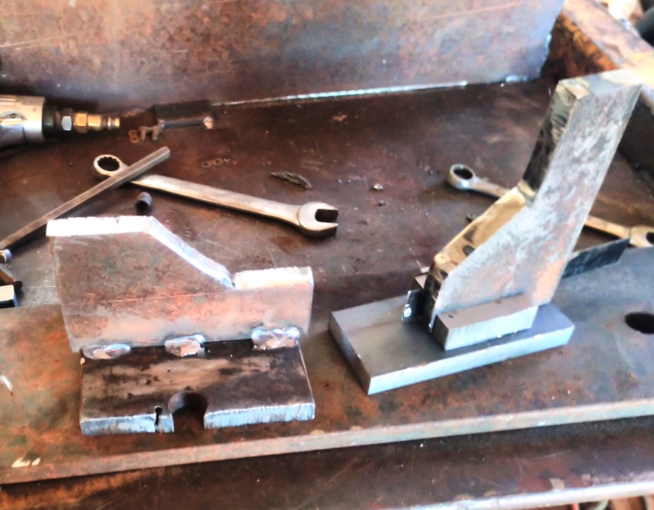

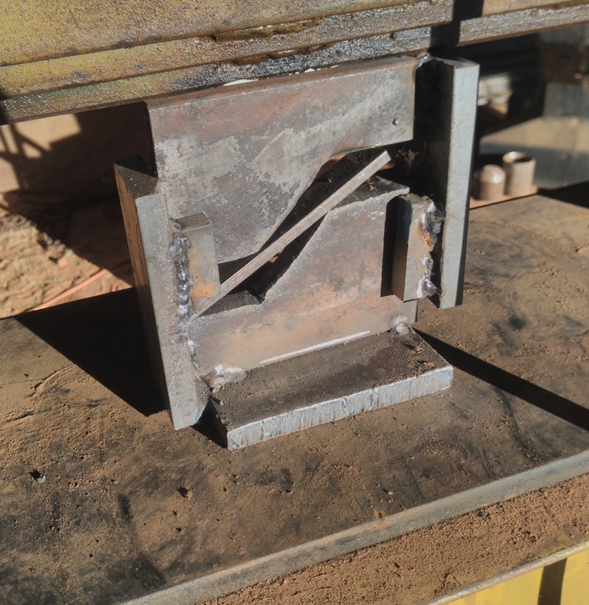

    I have a small run series of some brackets to make and they all need to be very close to identical.
    I could have used a bender for these easy enough but decided to just press them in a single operation by making a simple punch & die for my shop press

    Worth the investment, probably more consistant and quicker than a bender as well.

    Quote Originally Posted by NortonDommi View Post
    I felt that it would be on all counts.
    I made 4 brackets all turned out like soldiers in formation. When I get ready for the production run I will mount the punch and the die to the shop press and since my press is pneumatic over hydraulic it doesn't wear my arm out having to pump the handle
