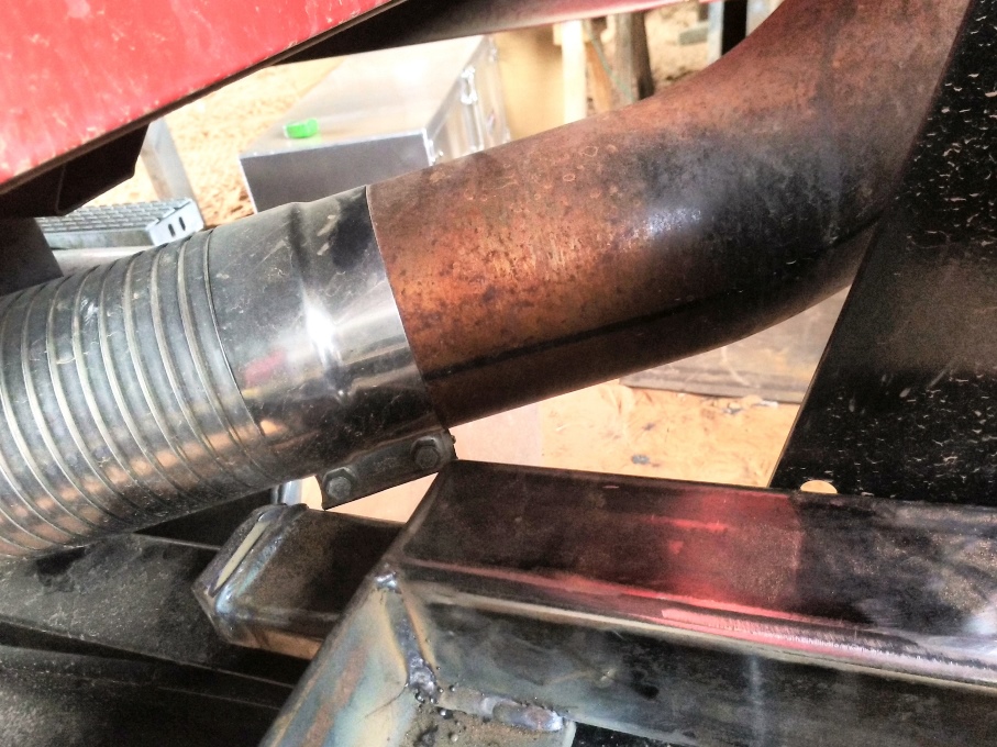

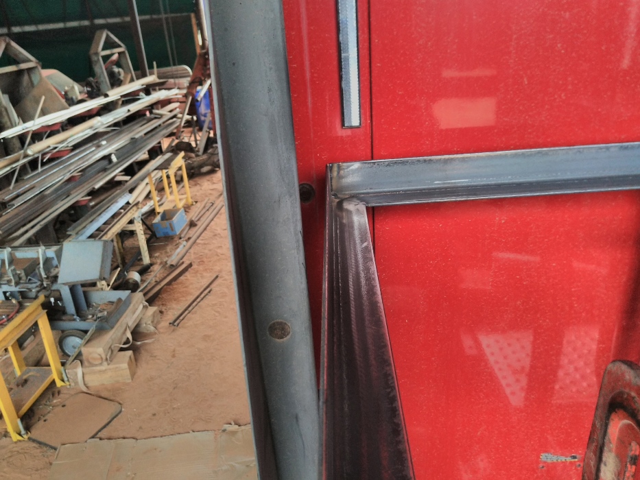

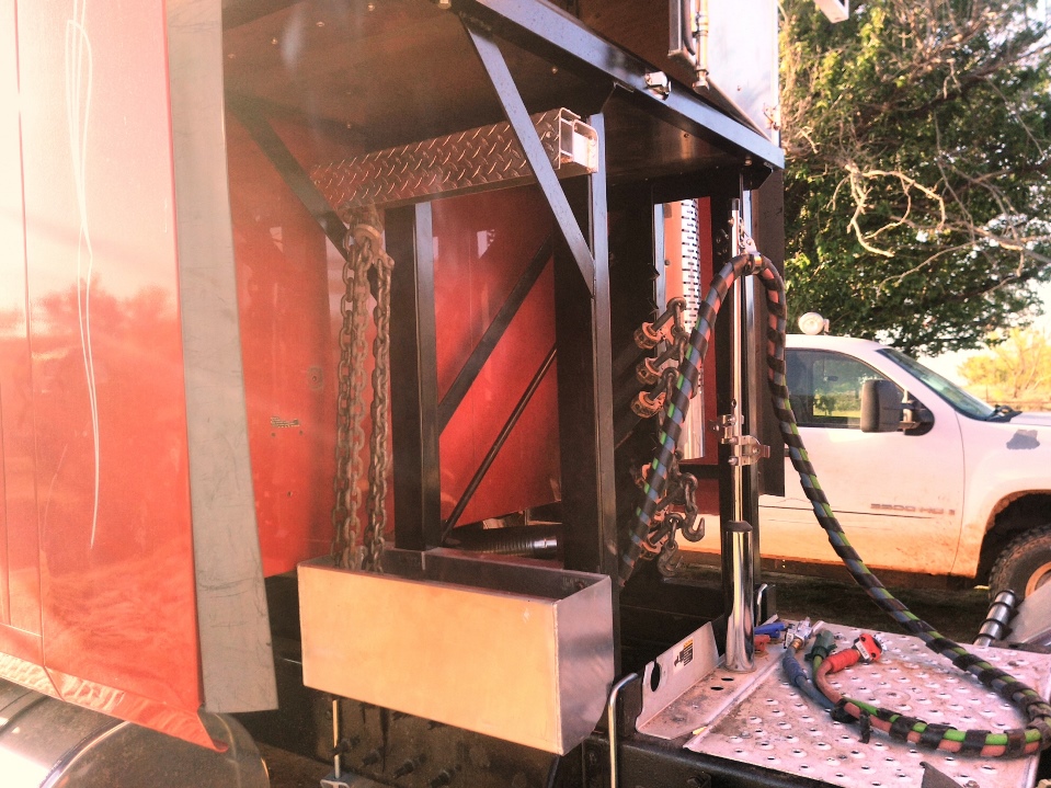

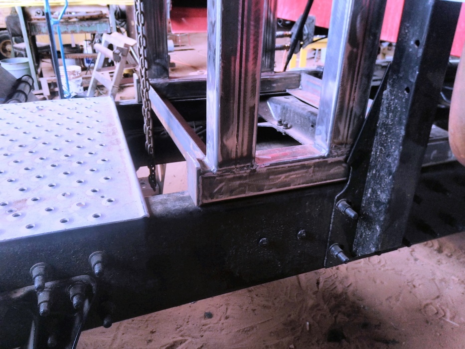

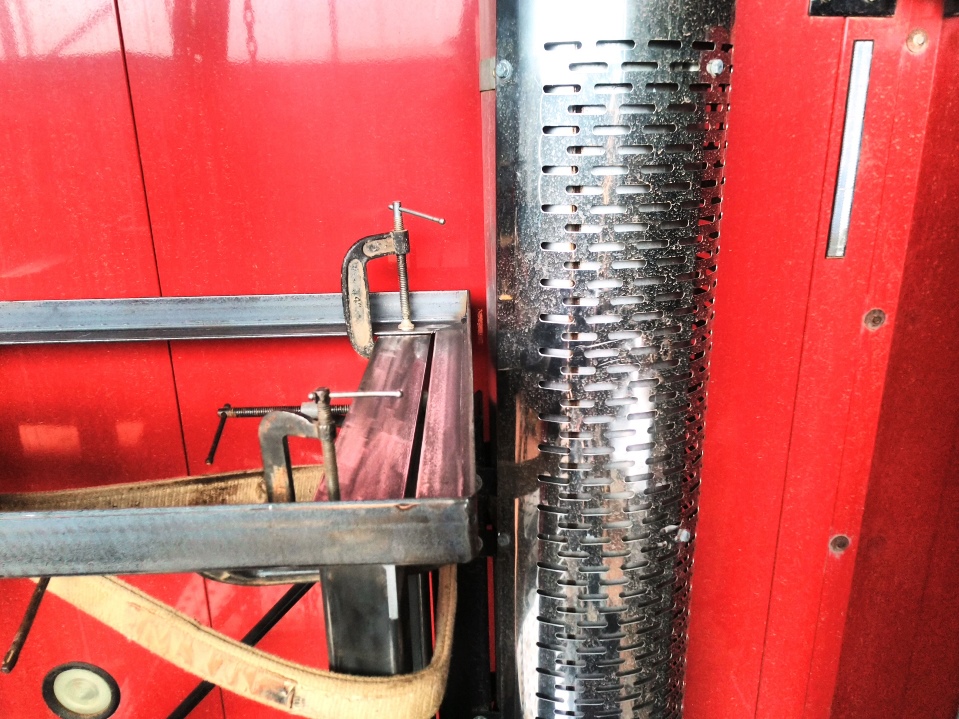

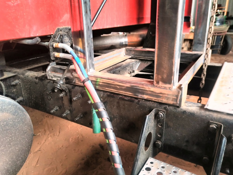

    This framework is for the 3rd addition explosives cargo box and ultimately caused the project to be more costly.
    First off it is made from square and rectangular tubing and angle iron, as opposed to a mostly angle iron framework.
    Checking for fitment and clearances before final welding
    Box mount / chain rack-img_20230330_114019bm.jpg
    Box mount / chain rack-img_20230330_114029bm.jpg
    Those hoses will have to be moved, plenty of clearance for the brace
    Box mount / chain rack-img_20230330_114054bm.jpg
    Just barely enough room may have to rotate the clamp
    Box mount / chain rack-img_20230330_114129bm.jpg
    plenty of room here, I have just the thing to fill that gap
    Box mount / chain rack-img_20230330_114136bm.jpg
    Perfect location for the chain rack and tub, told you I had something to fill the gap between the deck plate and the framework, note the pogo pole and its mount
