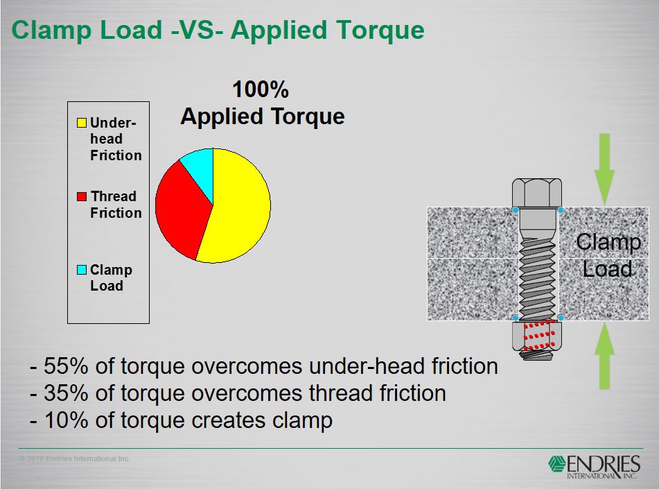

We just had a fastener guru from a supplier (Endries) come and give a presentation on threaded fasteners at work.
His take-away was that for critical applications, frictional factors were so variable in manufacturing assembly, and such a large absorber of tightening torque as measured at the bolt head, that measuring bolt stretch is really the only way to get a precise look at fastener clamping load. Luckily, few of our applications are that critical!

Check these three slides from that presentation out - the first shows just how little of applied torque actually goes into stretching the bolt - remember, a bolt is a spring that has to be stretched to work.

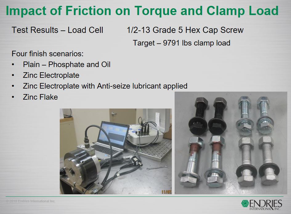

Second slide shows the components of a 4-lubricant comparison

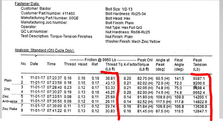

Third slide shows the huge variation between applied torque (first red-marked column) and the tension generated in the bolt (second red-marked column) - only variable was the lubricant or lack thereof.
