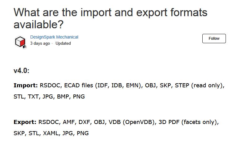

    Here's what DesignSpark Mechanical 4.0 can do. Maybe it might work for you. It's free and easy to use.

    Quote Originally Posted by Crusty View Post

    Thanks for the tip Crusty, it is a program I was not aware of, I have downloaded it and will try it soon.

    Just read and follow the built in tutorials to start and you'll be surprised by how easy it is to use. Of course if you want more functions there's packages of increased capabilities for it that you can buy which are pricey.
    To highlight the "pricey" options, the only way, apparently, to work with ".step" files is to get one of those add-on modules. Thanks, though, for the suggestion, I think it's something my Dad is able to use for his shop, as he generates a lot of PDF files for his stuff.

    I thought you just wanted to convert the files to another file format and it works for that, though in somewhat limited fashion. I didn't have any luck translating to a pdf file (likely a 3d to 2d issue) but translating to jpg files did work and I was able to manually add dimensioning before the export.
    It's at least an easy to use package which might be enough for some folks.
