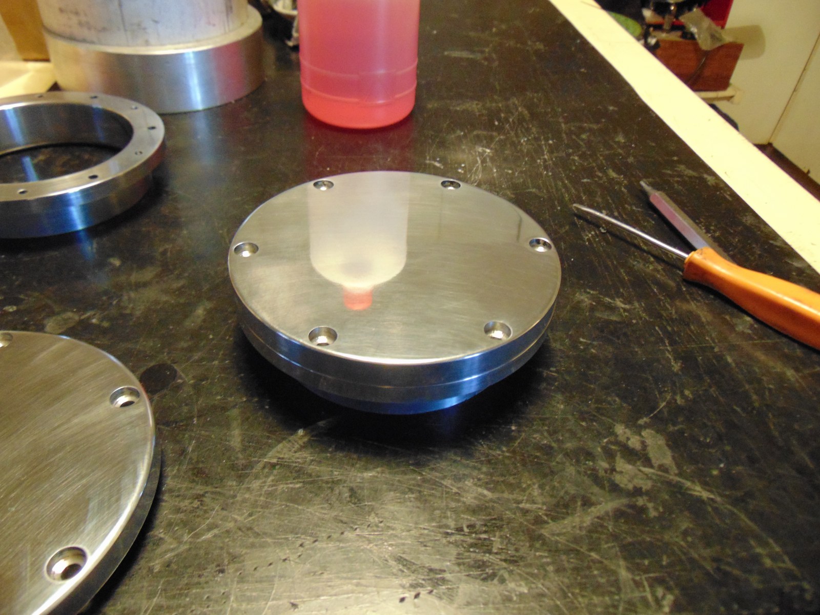

    Hi all!
    Someone here has ever tried blueing stainless screws? I know it's a common clockmaker pratice.
    Few days ago I did the seasoning of a iron cooking pan, with fine salt first and then oil till smoke. I'm not completely satisfied about the result, that's why I'm searching for info.
    I found this video on YouTube, it seems that the brass chips help to keep temperature constant. Do you think salt would work also?
    I read that for A304 the blue color should be 540°C. Should it necessary to fix the color with oil at smoking temp?
    Ps: I build this custom reflex port for my new Crystal 10 ( Lii audio) speaker

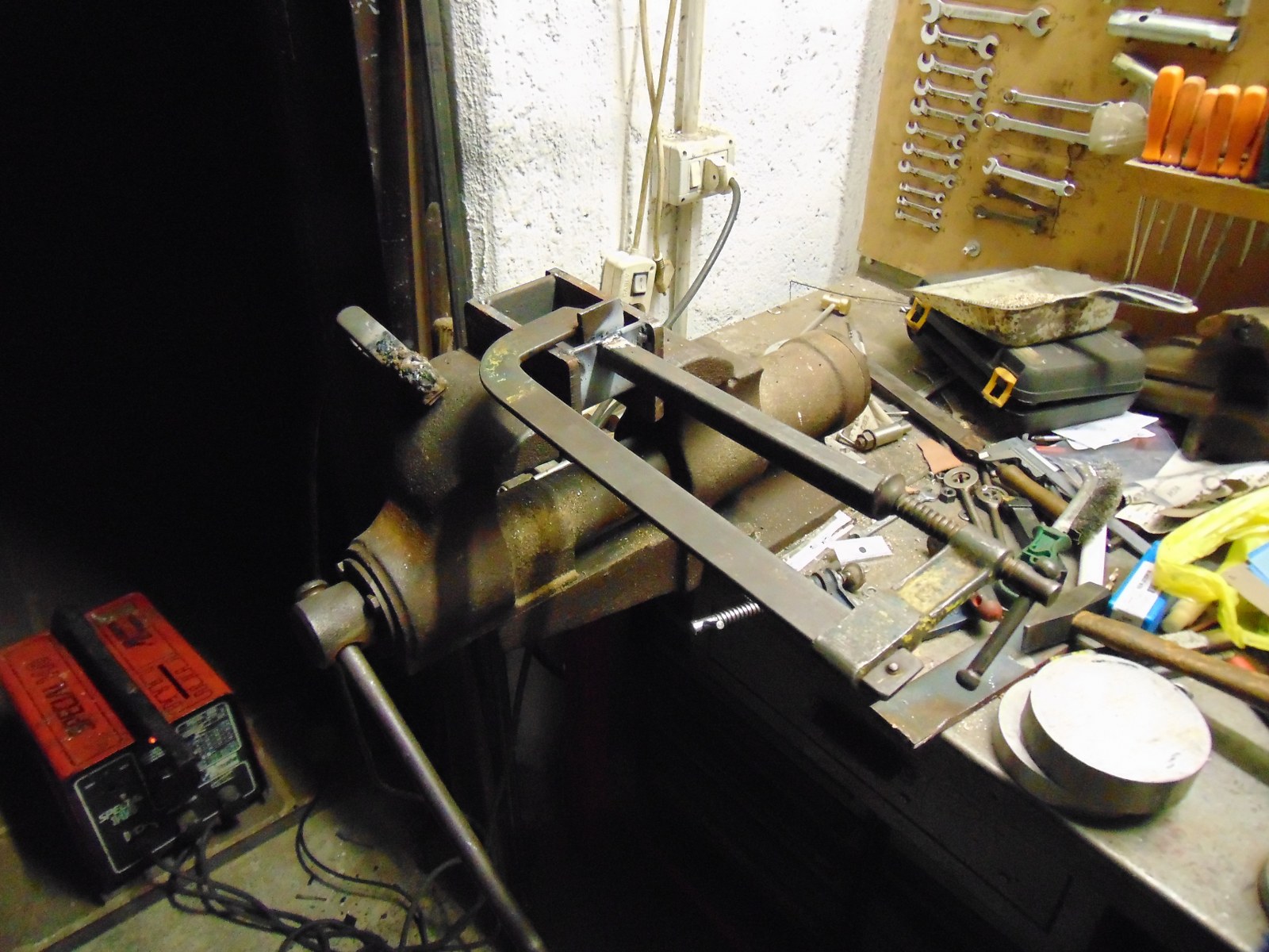

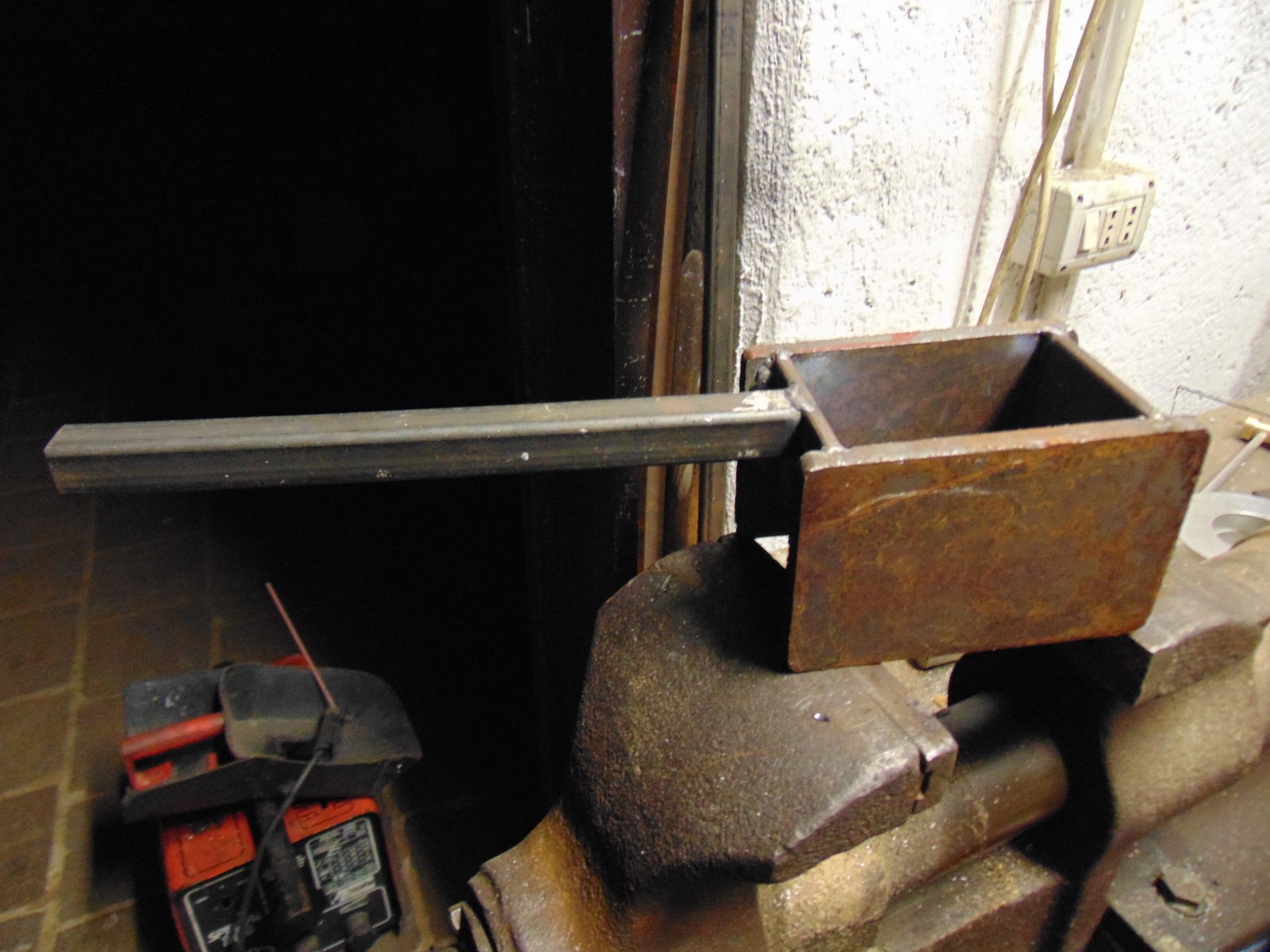

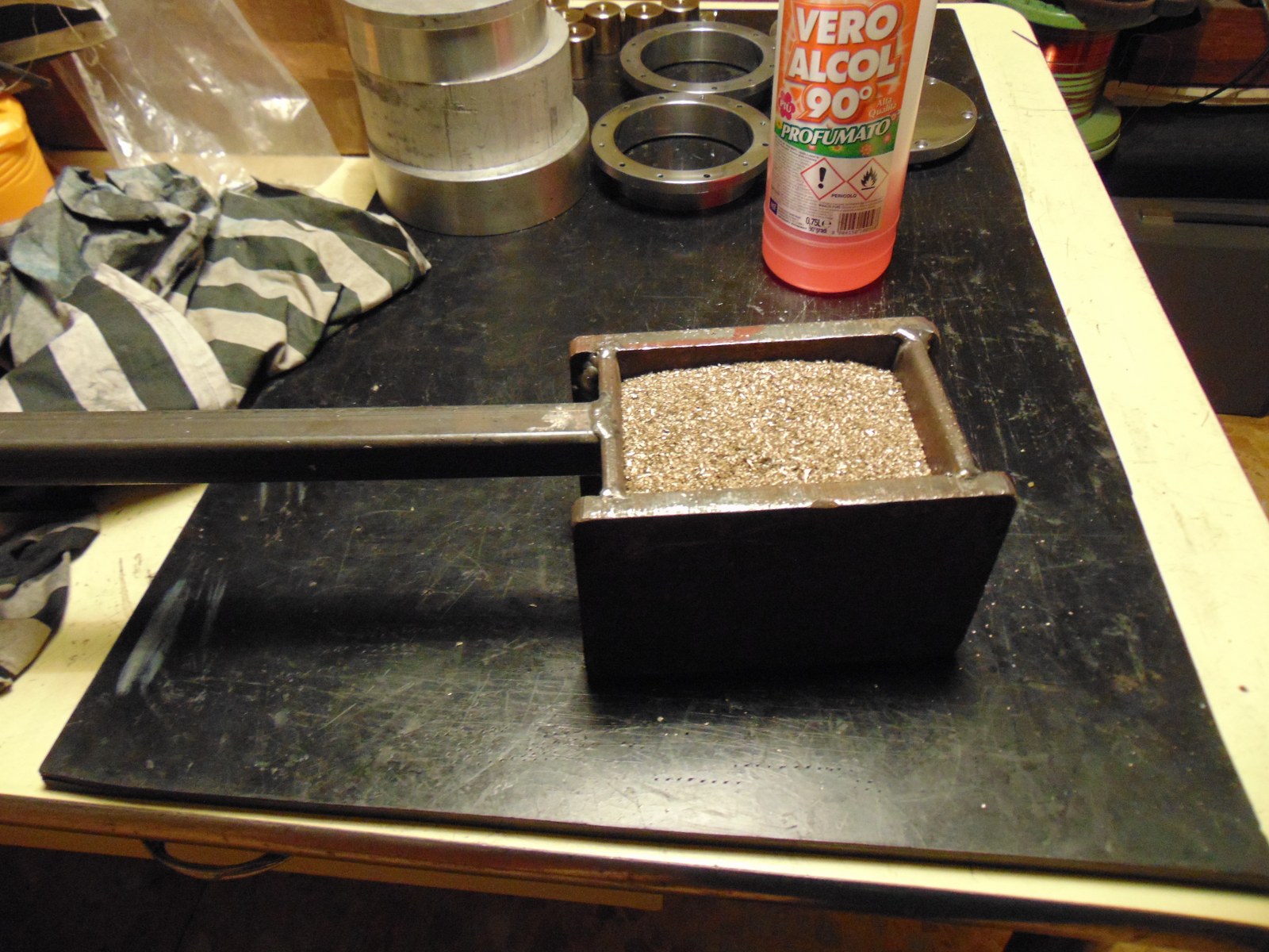

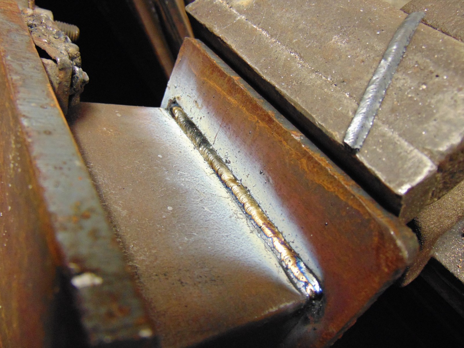

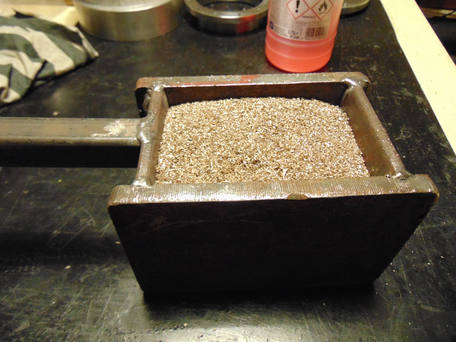

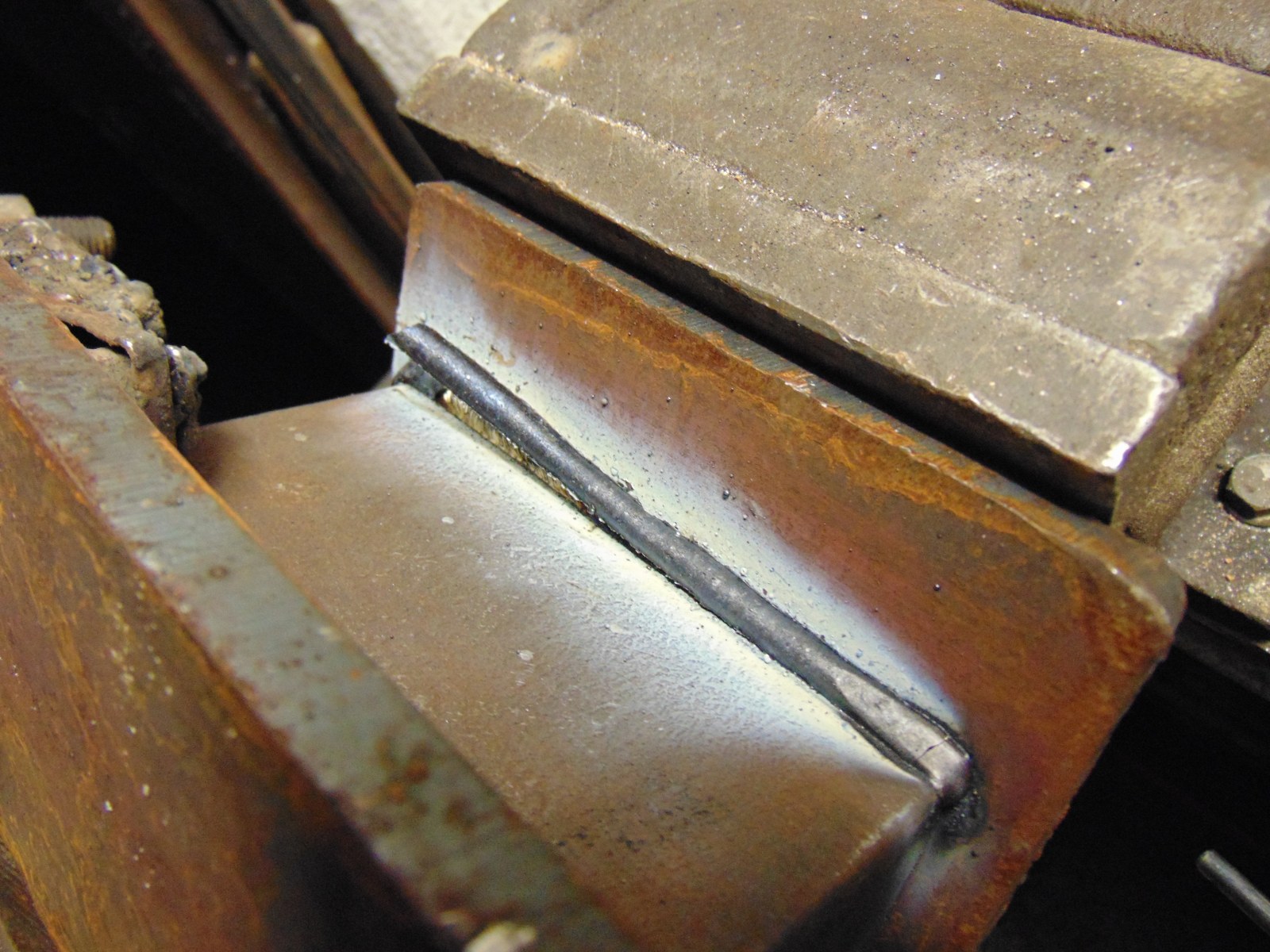

    I just build a tool in order to try blueing the screws.
    I used thick iron scraps, stick welded as pan. Not nice to see, but heavy. The purpose is to keep the heat and distribute in a good way to the brass chips inside.
    I will try blueing Tomorrow!
