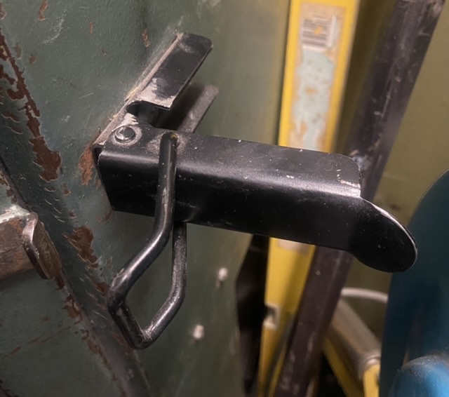

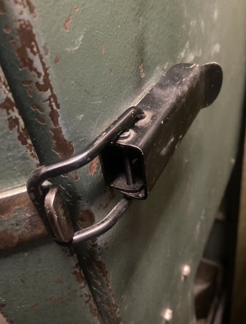

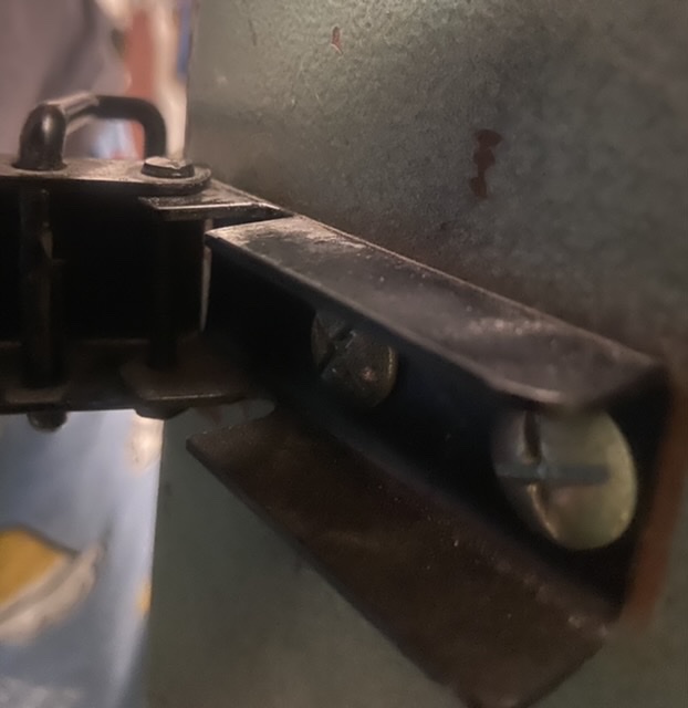

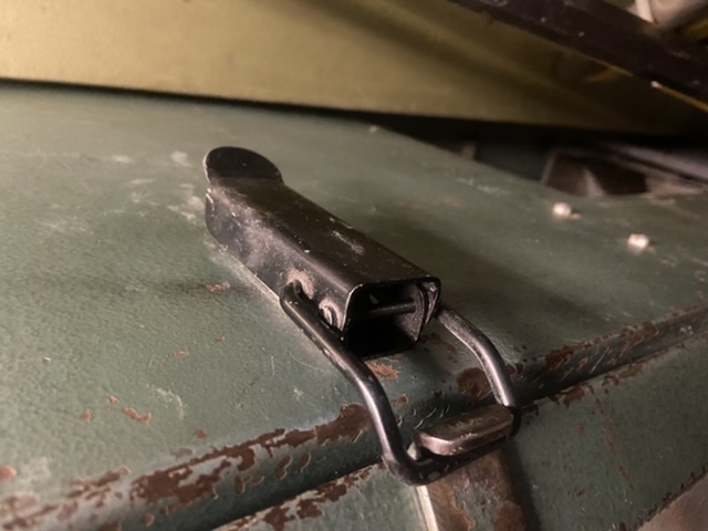

    I had to replace the locking latch on my blast cabinet door again!
    The previous one was so badly worn it just kept falling apart and when you could get it to work it had to be in a certain position to hold the door closed so it wouldn’t fall apart. A real pain in the ….. This time it was just a bit sloppy and didn’t create a good seal around the door seal.
    The new latch was made from sheet metal and round stock as before. Which was simply folded in to two channels so one would fit inside the other and then cut and shaped. The hinge pin was a simple turning job. The latch was bent around a piece of flat stock with radius filled on the corners to aid bending of the round stock. Once complete it was held in position and the holding bolt holes transferred and drilled. A coat of spray paint and the job was finished. I don’t know why I put off doing this job. The door closes first time every time now.
    From the photos it is clear to see why this part wears as it gets covered in the abrasive medium as can be seen by the paint already being removed. This latch is just over a week old and already showing signs on wear. The cabinet does get a lot of use and has had a new perforated internal shelf
    Blast cabinet door latch-1b0e55ce-de6d-4e67-873e-59d4366381b2.jpegNew latch locking door
    Blast cabinet door latch-81b7b876-fdfb-40b6-8058-ed93f4c9cb50.jpegLatch in the released position as can be seen paint is already being removed through operation of the latch.
    Blast cabinet door latch-552ad3d4-9e07-43c9-a04c-70530f73799d.jpegPhoto shows machine screws holding latch to cabinet.
    I will be looking around the workshop for other annoying things that get on my nerves every time I go to use it. This was one of those jobs I should have done a longtime ago before it totally gave up, which would have saved a lot of swearing every time I went to use it. The cabinet is a pleasure to use again rather than a frustrating piece of kit.
    This is the second one I have made maybe I should have made a spare.
