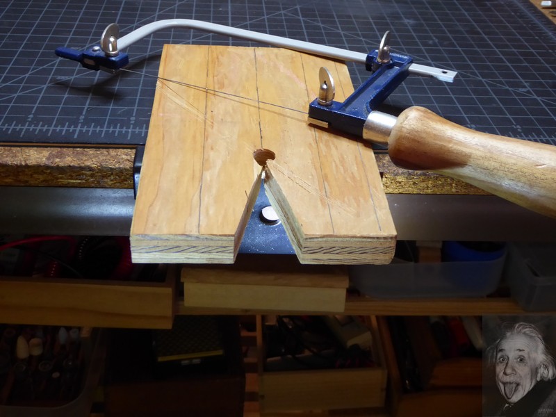

    I mentioned adding a birdsmouth to it but never got around to doing so. Later I reconsidered and decided that a stand-alone birdsmouth would be a better tool so this thread is about making that.
    There are undoubtedly a few out there who don't know what a birdsmouth is so I'll explain briefly. It's a tool to assist in sawing out intricate patterns and piercings with a fret saw or a jeweler's saw in the case of metal parts. Basically, it's little more than a wooden plank with a slot or slots that can take many forms although the traditional is a narrow triangular slot which looks a bit like a bird's open mouth/bill, hence the name. The saw blade is set to cut on the pull stroke* and is used vertically through the slot with the work held on the plank. In some cases the plank is attached to a frame held in the bench vise to raise the plank to a more comfortable working position; often it attaches directly to the work table (my case) so it can be used by a seated sawyer.
    I used 5/8" plywood for my plank with a traditional birdsmouth. In use it must be right in the center front of the worktable so it needs to be removable when not in use. I had some steel C-channel that just spans the thickness of my indoor worktable and the expendable fiberboard protector on it. This was drilled and tapped for two 3/8-16 setscrews to provide a clamping action. Conventional screws won't work here because if they project one can catch his legs/knees on them. Tightened down, the setscrews hardly project so they're the correct choice. I don't want fasteners projecting through the top of the plank so the channel was epoxied to the bottom of the plank. There's no appreciable strain on the joint so these joints should outlast me.
    Clamped in place, the C-channel raises the bottom of the plank by the channel's thickness, 1/8", so, to prevent flopping, a piece of 1/8" aluminum scrap was epoxied to the rear of the plank.
    Here's a picture of the birdsmouth in place, ready to work...

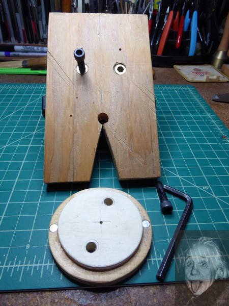

    While my birdsmouth lacks the appearance of a bench pin and its 5/8" plywood doesn't appear to be very flexible, it has turned out to be a very useful tool in the four years since I posted about its construction. However, any tool can be improved and that's what I'll discuss here.

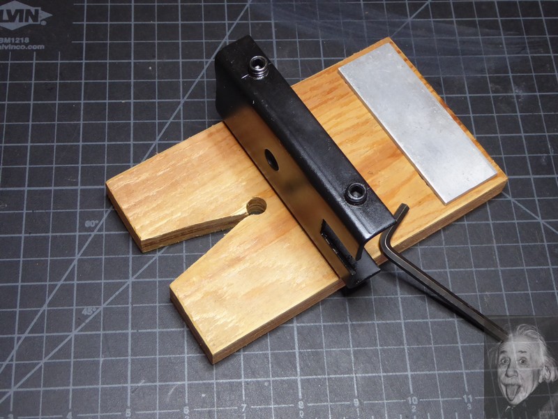

    On a number of uses I discovered that my left hand tired holding the work in place while I sawed. Clearly some form of hold down clamp would be very helpful. When I built my finger plate...
    More versatile finger plate
    I standardized on 1/4-20 threads and made up a variety of clamps (pictured in the thread) to work with that thread. Obviously, if the birdsmouth had those threads I could make use of the finger plate clamps. Amazon supplied ...
    https://www.amazon.com/gp/product/B0...e?ie=UTF8&th=1
    some handy threaded inserts that were easy to install in the birdsmouth.
    One simply drills an appropriate size hole into the wood and then screws the insert into the hole using an Allen wrench in the hex section at the top of the insert.

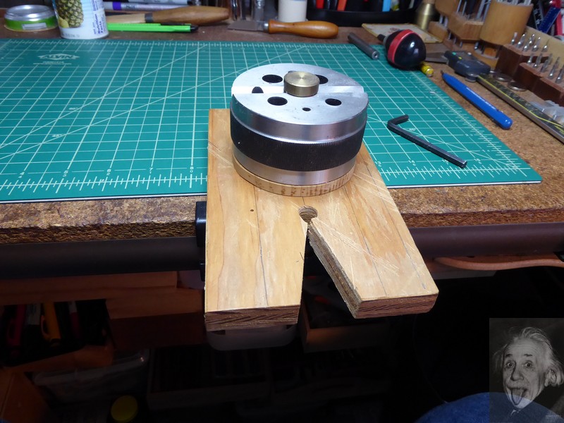

    My steel bench block is another handy tool. It can slide easily though if any side force is applied. Being round, it's difficult to clamp securely in my work table vise. I decided that, now that the birdsmouth had threads, I would use it as a means of securing the block from sliding. To that end, I made a circle of plywood with a diameter equal to that of the block OD. Centered on this is another wooden circle with a diameter equal to the block ID. Small magnets fitted into the lower block prevent the block from slipping off. You can see this wooden cake in front of the birdsmouth in the above picture.
    Now it's just a matter of drilling holes in the cake to match the spacing of the thread inserts; add a few machine screws and Bob's your mother's brother. The final result is shown below.
