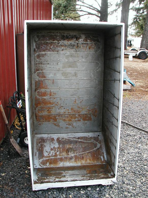

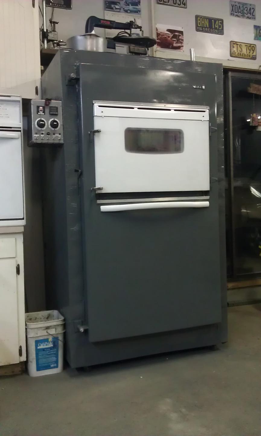

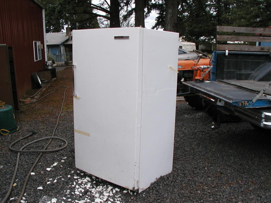

My oven was created out of a worn out upright freezer. A lot of people told me not to do it, and in hind sight it would have been easier to build from scratch, but being cheap and liking a challenge, I didn't listen.

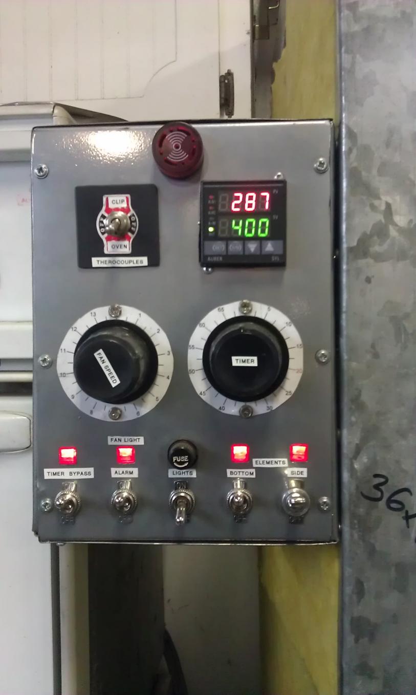

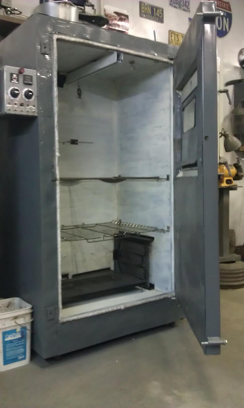

The oven uses three elements. I used insulation that I scavenged from old suspended ceiling panels, metal studs, and a lot of scavenged parts. Over all I would save I probably have $250 in the oven at the most. It ain't pretty, but works pretty well.
