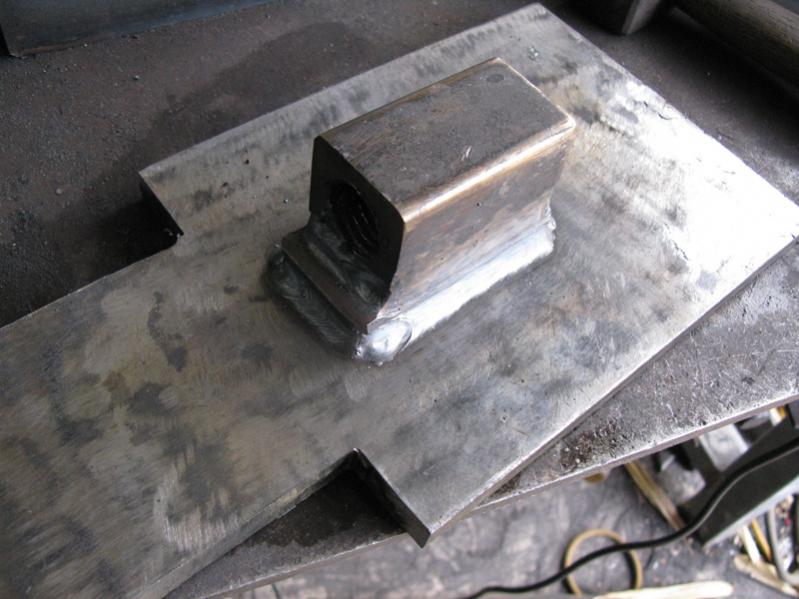

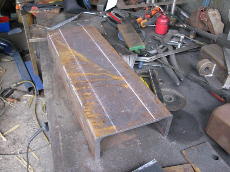

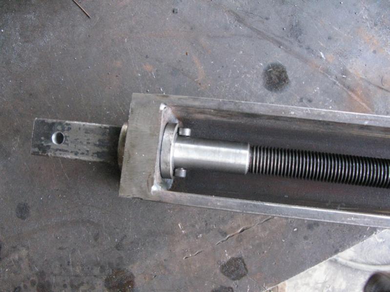

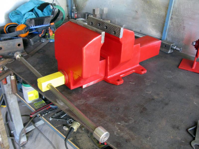

    This is the second bench vice I made out of scrap I had lying arround in the shed. Used a heavy channel cut in half, then topped with a 10mm plate, pieces of 8-16mm flat plate welded together for the body and a screw turned from a section of trailer axle, opening width is about 30cm. Nut also made from some square axle steel. Handle from 19mm stainless rod.

    Thanks Ed.! I've added your Bench Vise to our Vises category, as well as to your builder page: Ed.'s Homemade Tools. Your receipt:

    amazing vise!
    It sure looks like a high quality cast steel vise to me. Excellent work!
    Congratulations on a very fine project.
