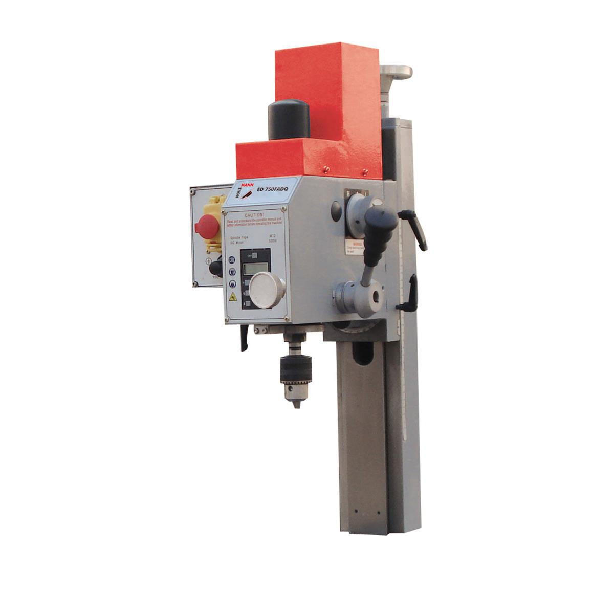

I have a milling head that goes above my lathe bed, it's a Chinese build from the "BF20" family.
I put here the various names I am aware of, it could help someone thanks to the magic of Mr Google ...
Mine is labeled WMD16V, but what I ordered from Holzmann was ED750FADQ.
The most frequent name for this machine is BF20 and from Grizzly it is G0704.
It looks like that :

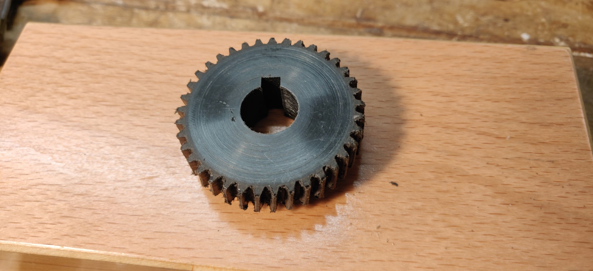

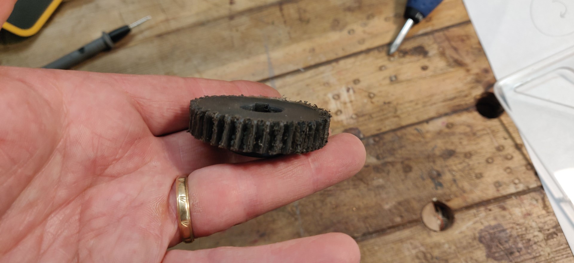

Here is the part, it's the famous Gear # 209 (lot's of people have the same issue on the internet)
The Gear 209 is under the motor support plate :
As you can see, for a fuse, it's quite blown ...

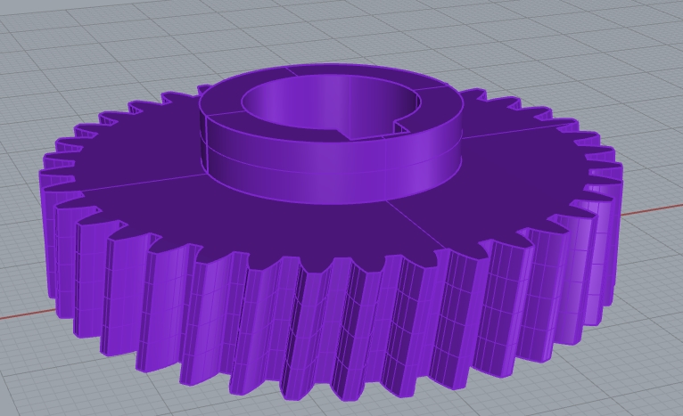

After some research and measurement, I established the spec of the gear.
It's a 9° helix gear, module 1.25 37 teeth.

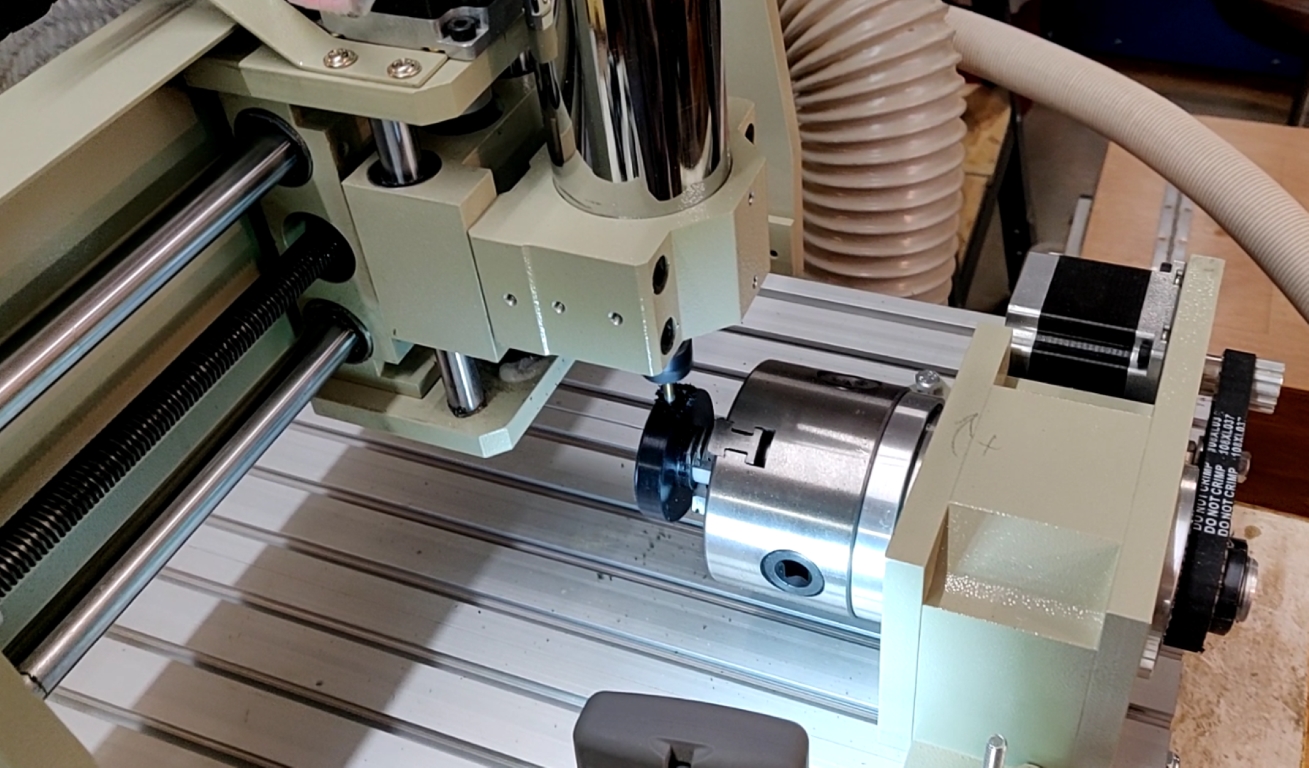

That will be my latest toy which is a nice little desktop CNC I have just adopted in the shop.

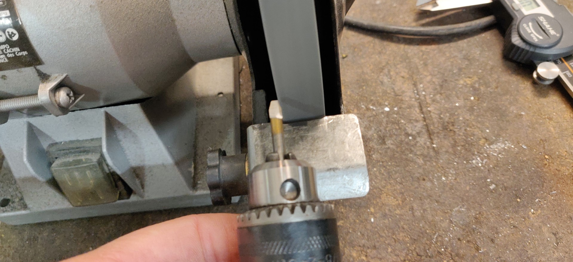

So with the cnc, I will grind a kind of shape tool which will be actually a D bit from a broken 4mm drill shank.
The idea is to use the 4th axis of the CNC and cut vertically the teeth on a bias.

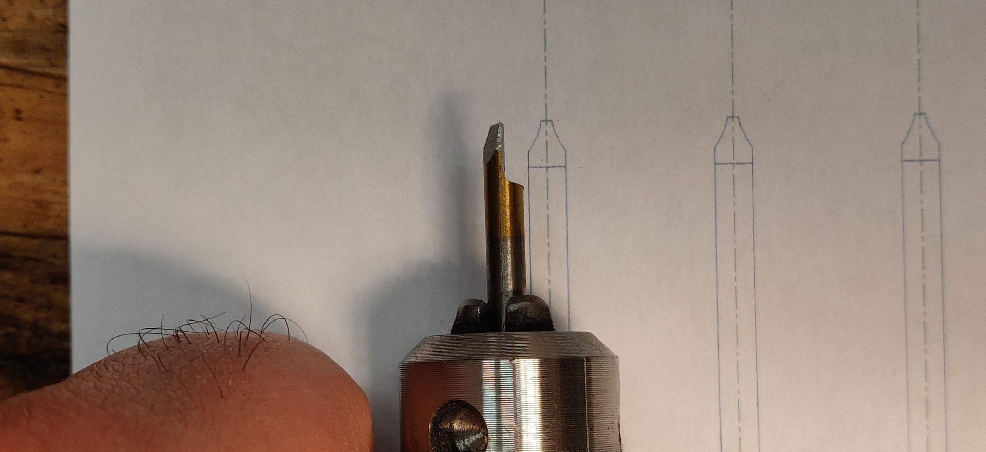

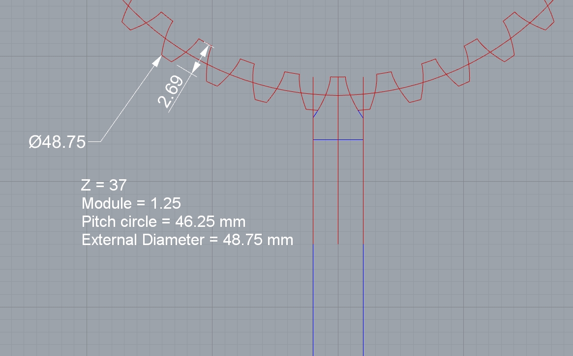

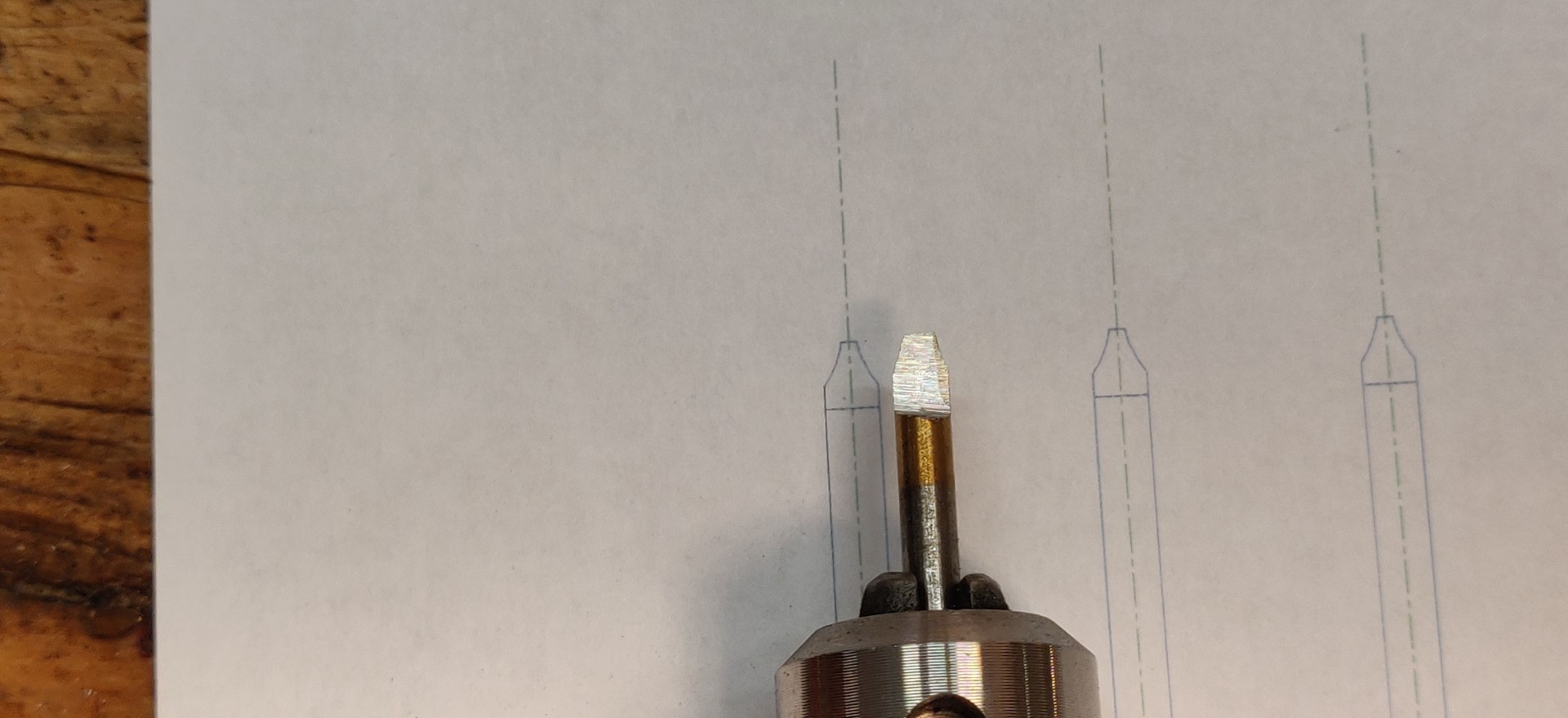

From the 3D model above I have sketched just for fun, I made a 2D drawing, extracting the exact shape between two teeth.
That will be the profile for my D bit.

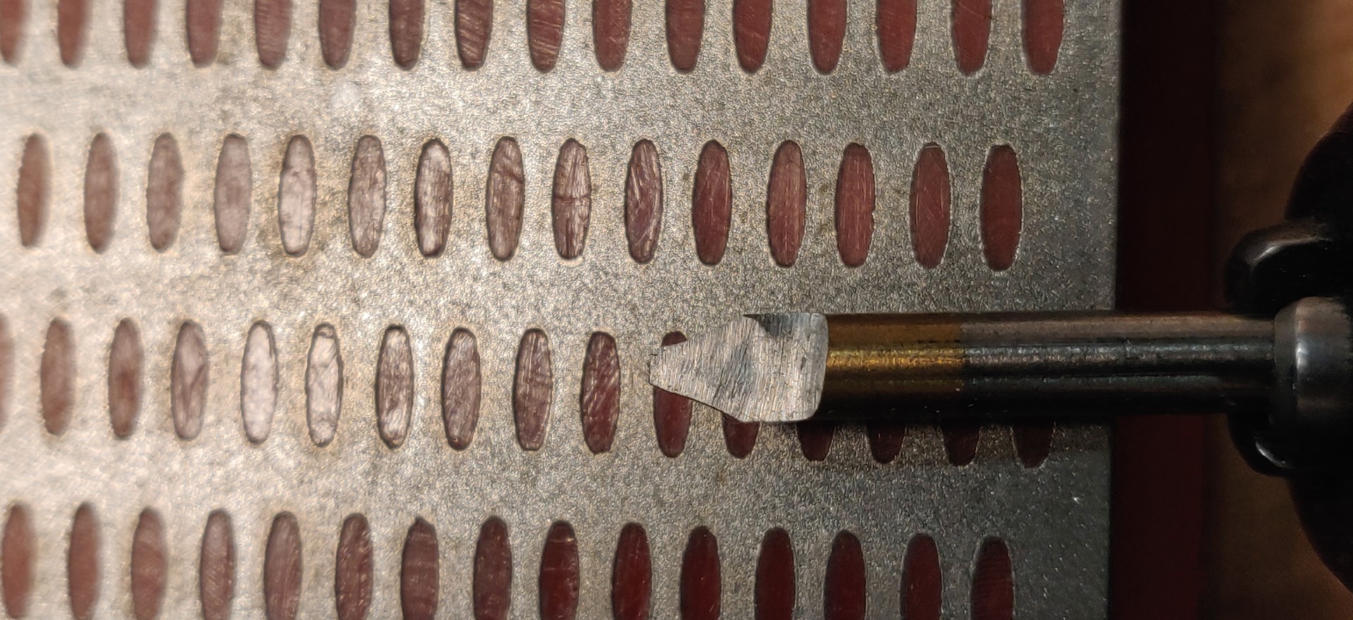

I start by rough grinding by hand the profile of the D bit, so that the CNC will do only a finishing pass.
Checking the rough profile with the drawing.

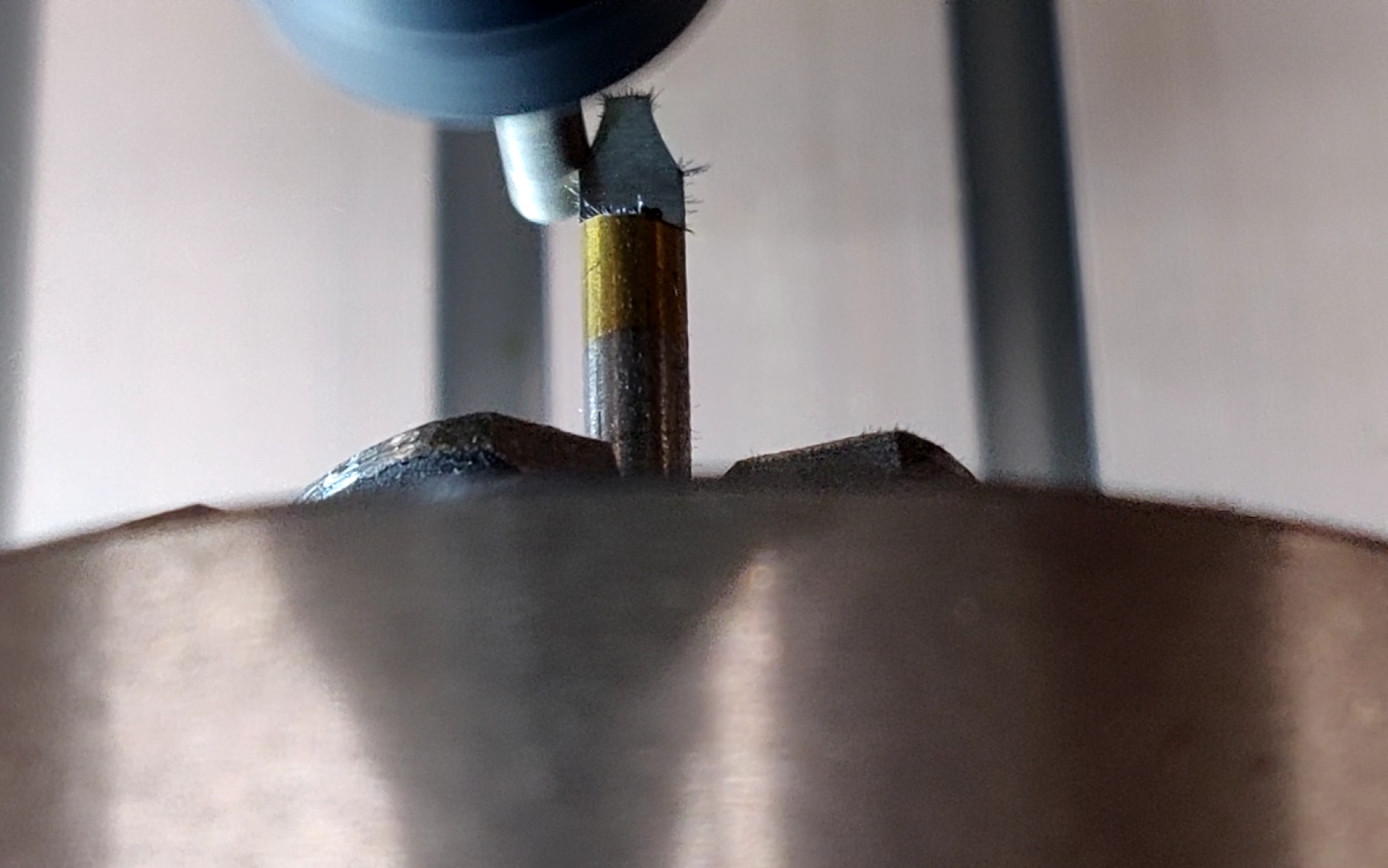

After computing the tool path from the 2D CAD drawing, the CNC does perfectly the job.
The bit used is a 1/8" diamond grinding bit. The D bit is hold in the 4th axis' chuck, but it doesn't move.
A little pass on the diamond stone to remove the burr

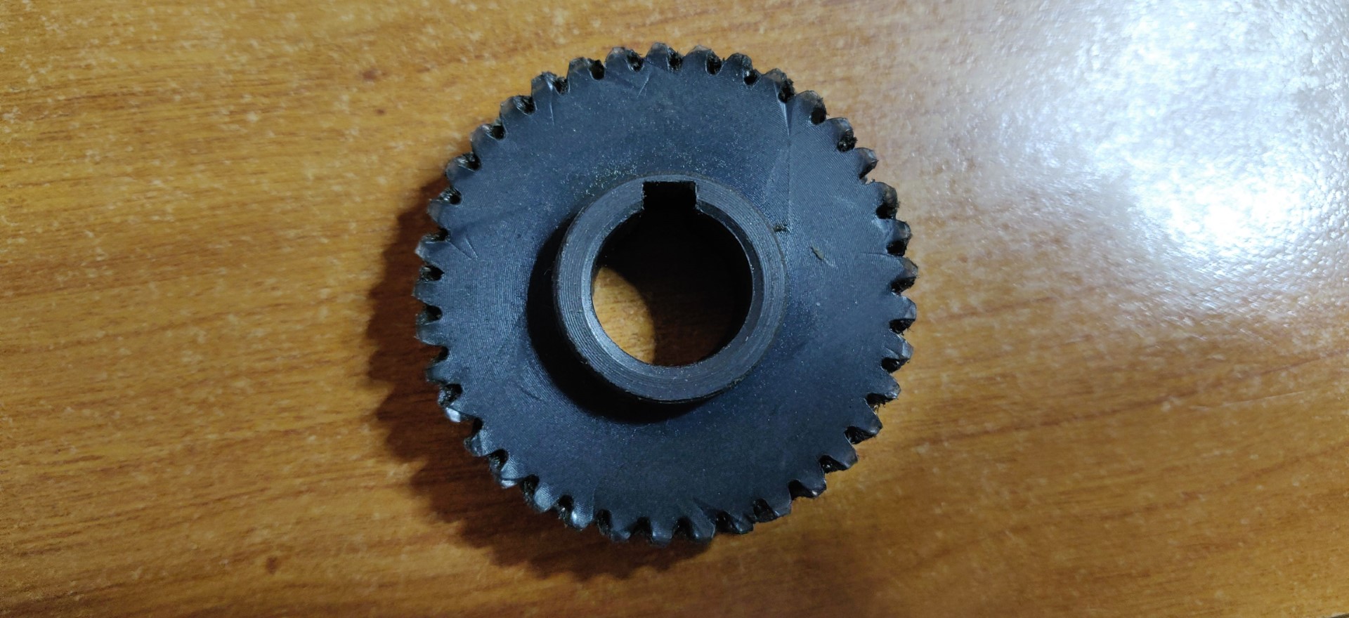

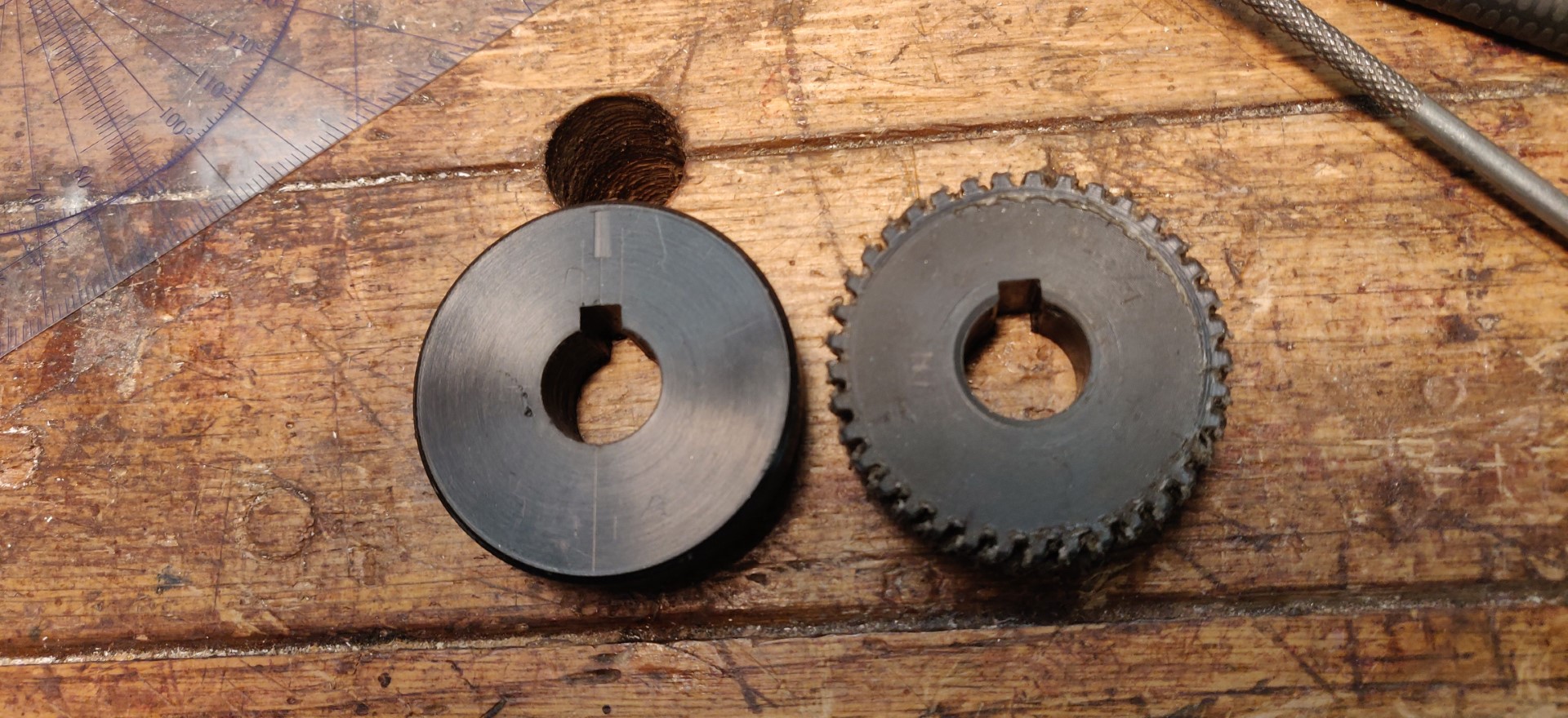

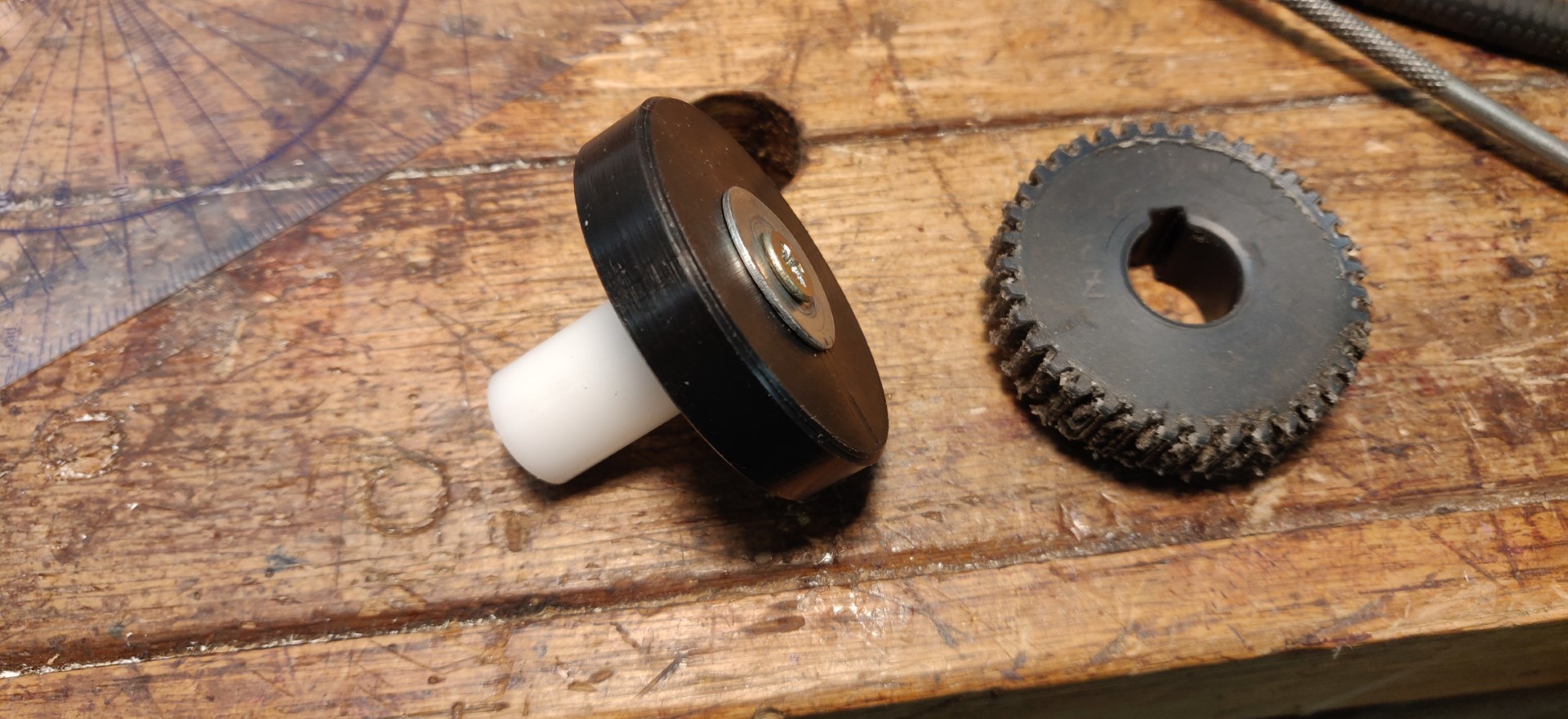

Then I prepared a blank for the new gear. It's turned on the lathe out of POM-C.
The key way is also cut on the lathe simply using the carriage.
I gave it a temporary shaft just to hold it in the chuck.

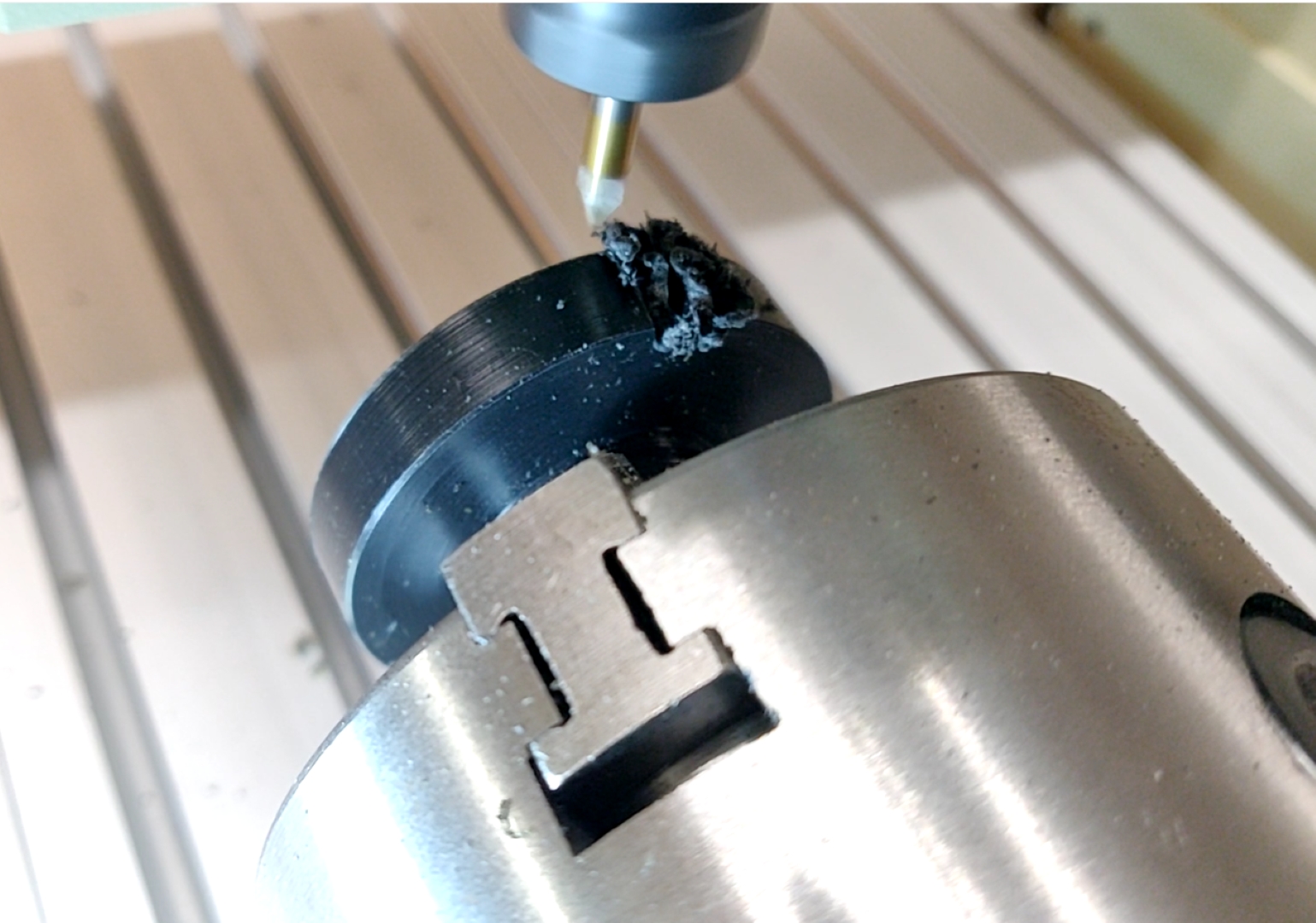

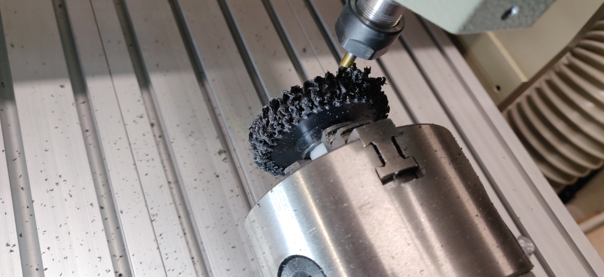

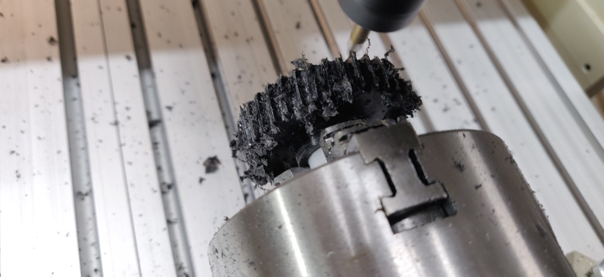

And I computed the G-code for cutting this part using the 4th axis to index the 37 teeth.

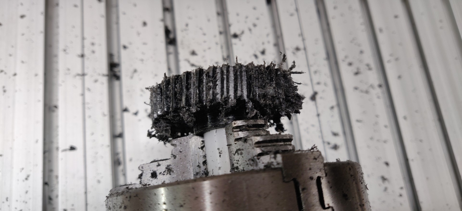

But this acetal material is nightmare to cut with a single tooth cutter and it leaves a mega burr.
The first rotation (3 passes per tooth) yields this nice black flower ...
So I modified a bit my program to enlarge the travel on each tooth and had to play and replay it several times ...
And I obtain this ugly thing ...

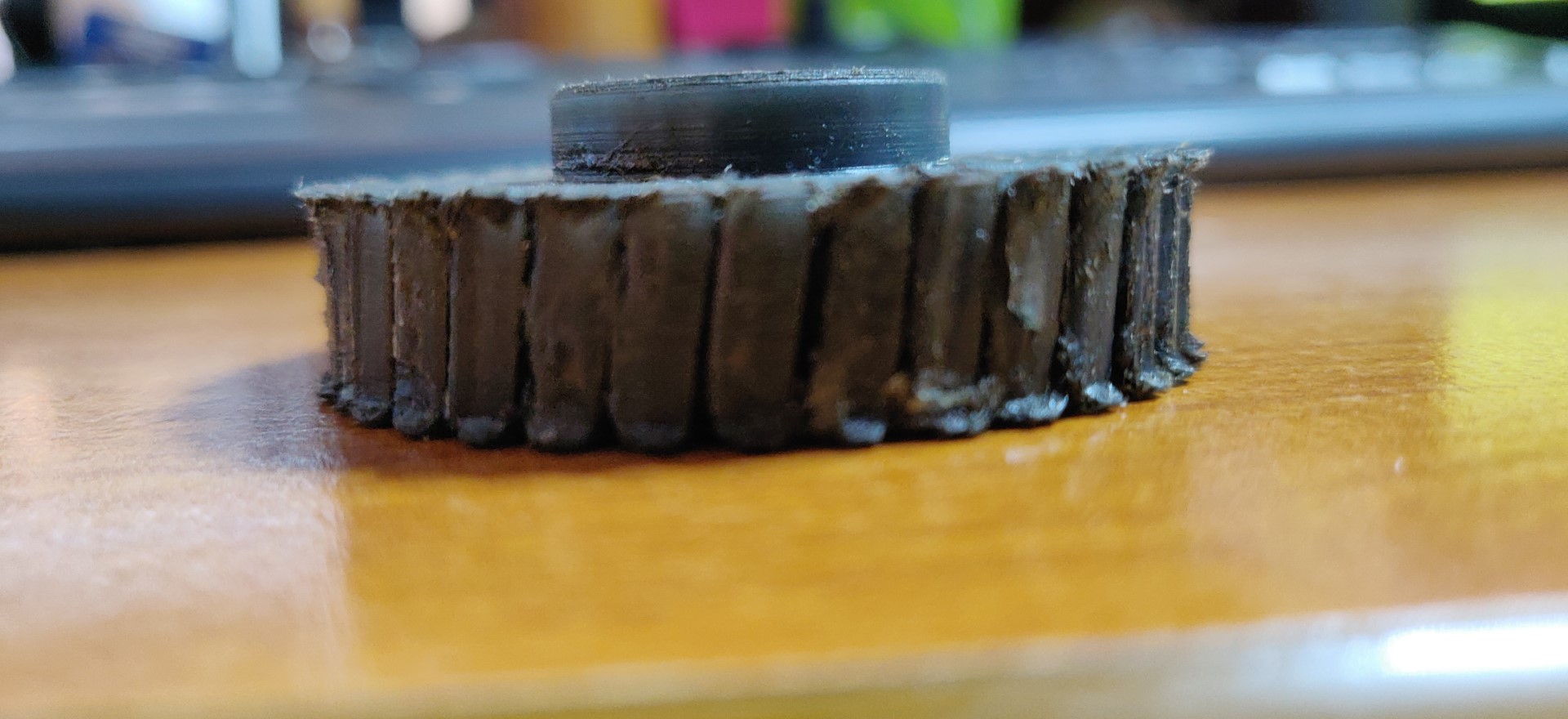

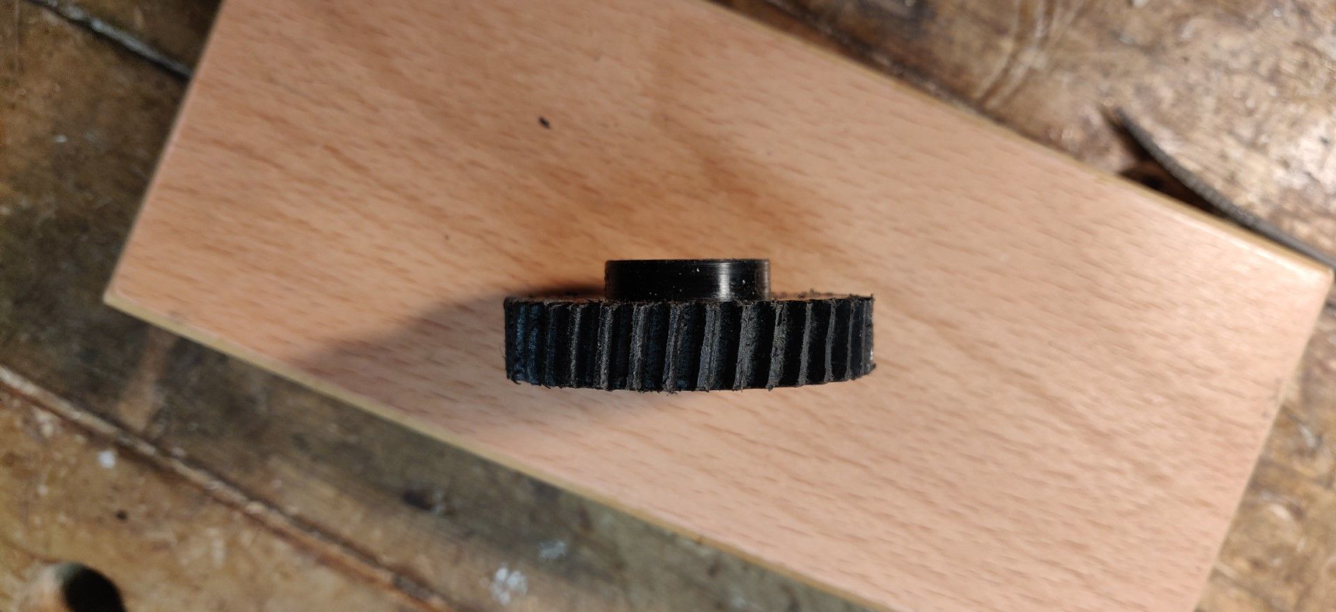

After much much time spent scraping and cleaning up each tooth, I decided it was good enough and here is the final product.
This is far from being a piece of art, but it turns out it works !!
