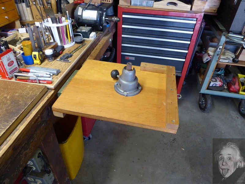

    Nevertheless, I occasionally work on a larger project that taxes that small work area. Mostly, the project will fit in the work area but the tools in use don't have a place to lie.
    The bench has both a metal working vise and a traditional woodworker's vise for those very rare occasions when I work with the brown stuff. I also have a beefy bench hook that I made many years ago...
    So, for bigger projects, I clamp the bench hook in the woodworking vise to form a sturdy cantilever mini shelf by my right hand, a perfect place to lay tools not in use at the moment.
    The hook can also be used in that position with certain accessories that bolt to the T-nuts installed on its underside.
    Or the accessory can be left in place and the hook simply flipped over and reclamped to provide an unobstructed shelf area.
