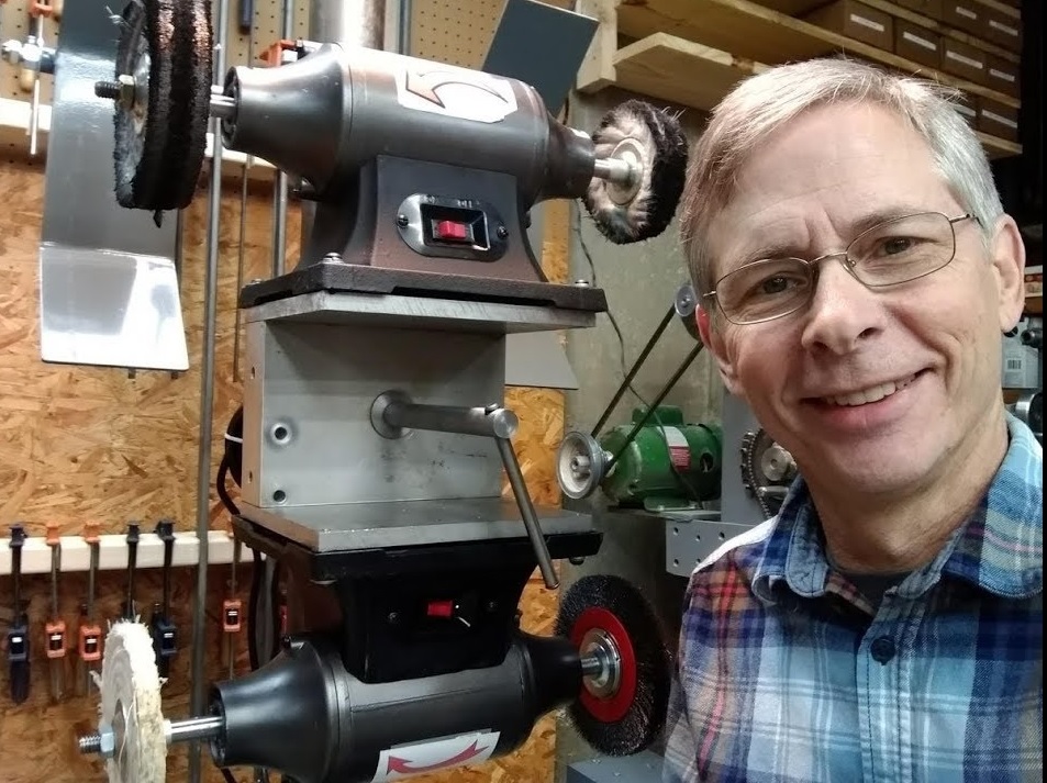

    Bench Grinder, Wire Brush and Buffer Stand. All-In-One Quick Change!
    Here's a great way to save space is you need a bench grinder, wire brush and or buffer. I made mine from an old drill press column but you could easily use any piece of square tubing, channel or I-beam welded to a base... or even set in concrete. Thank for watching!

    Good thinking! Looks great too!
    Thank you for sharing it.
