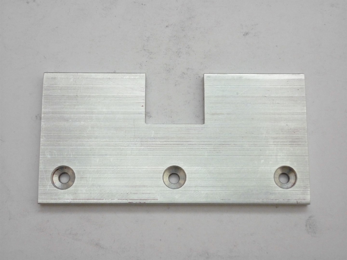

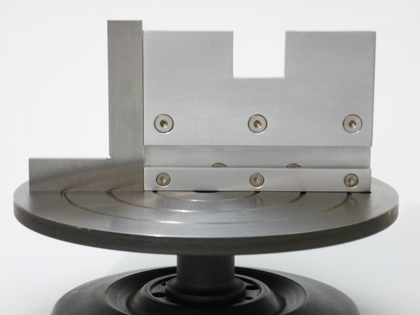

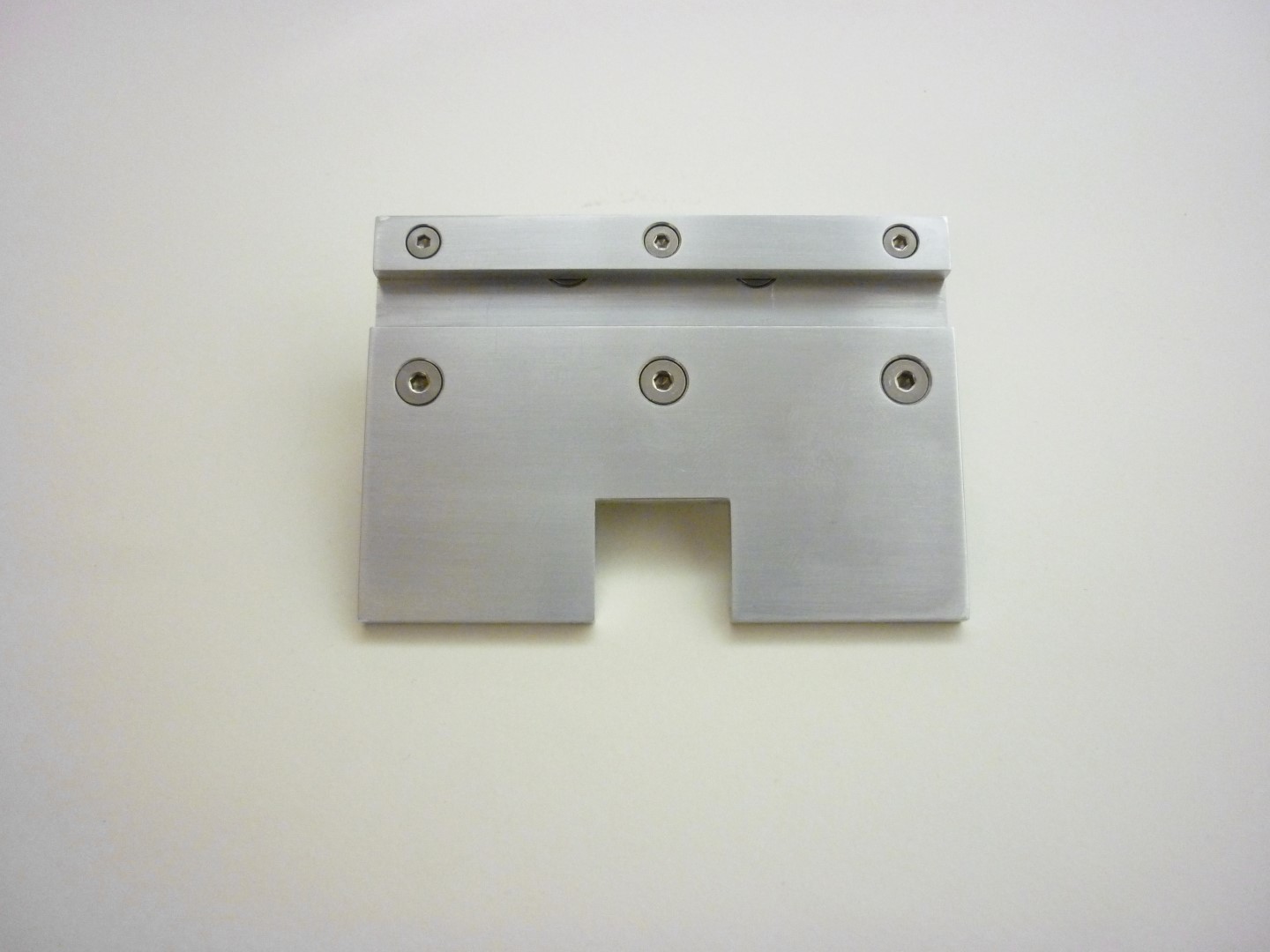

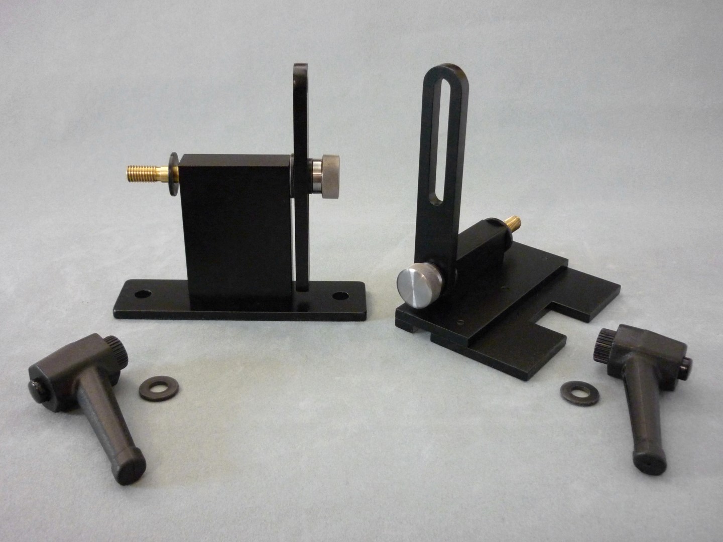

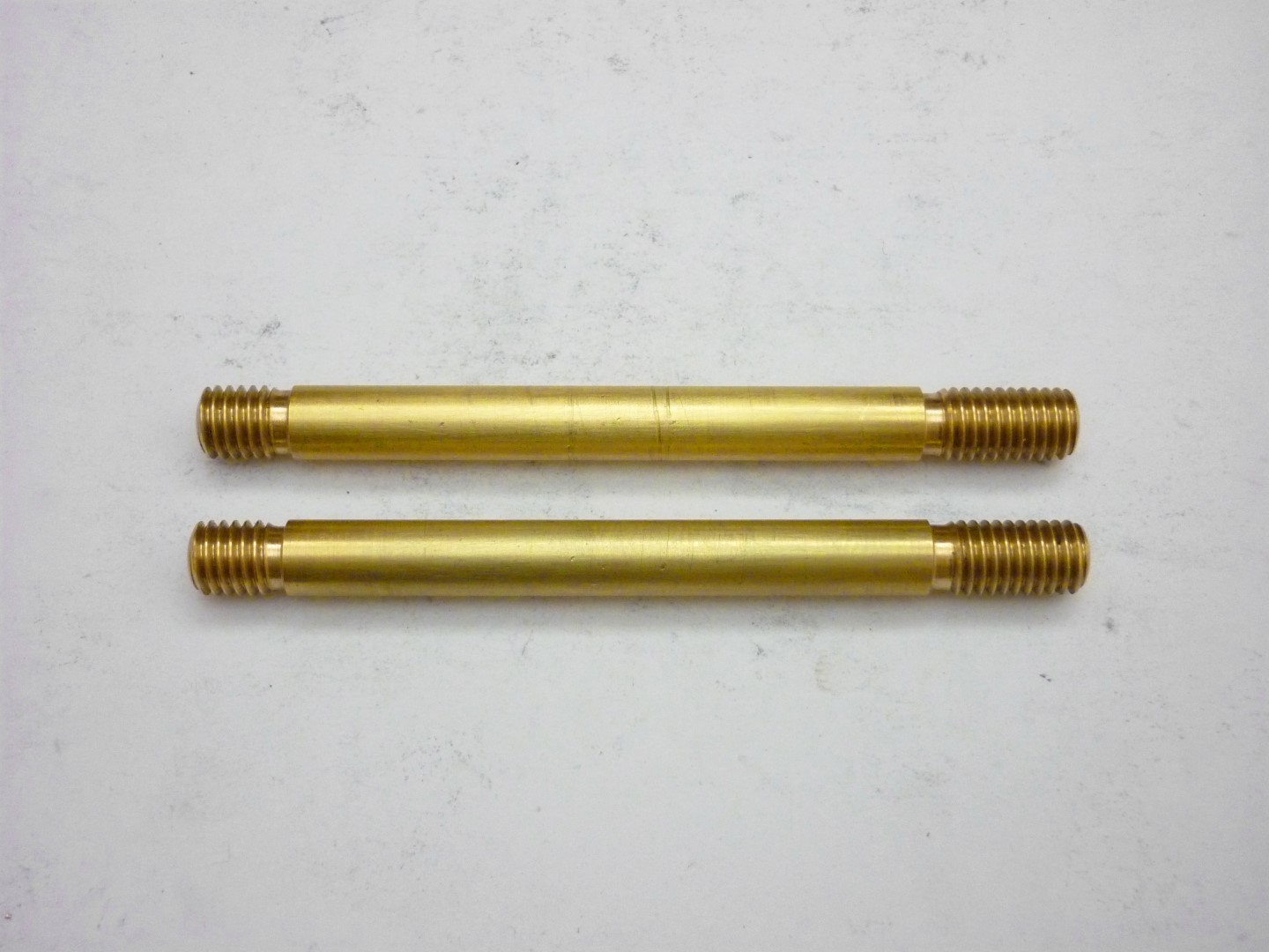

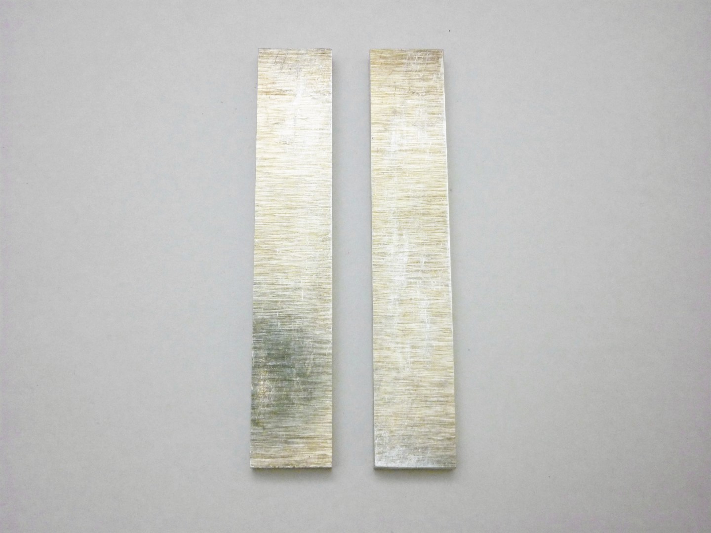

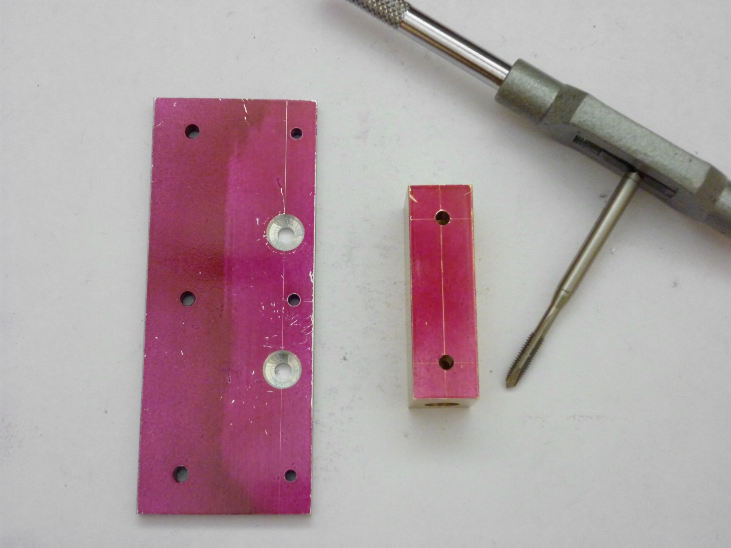

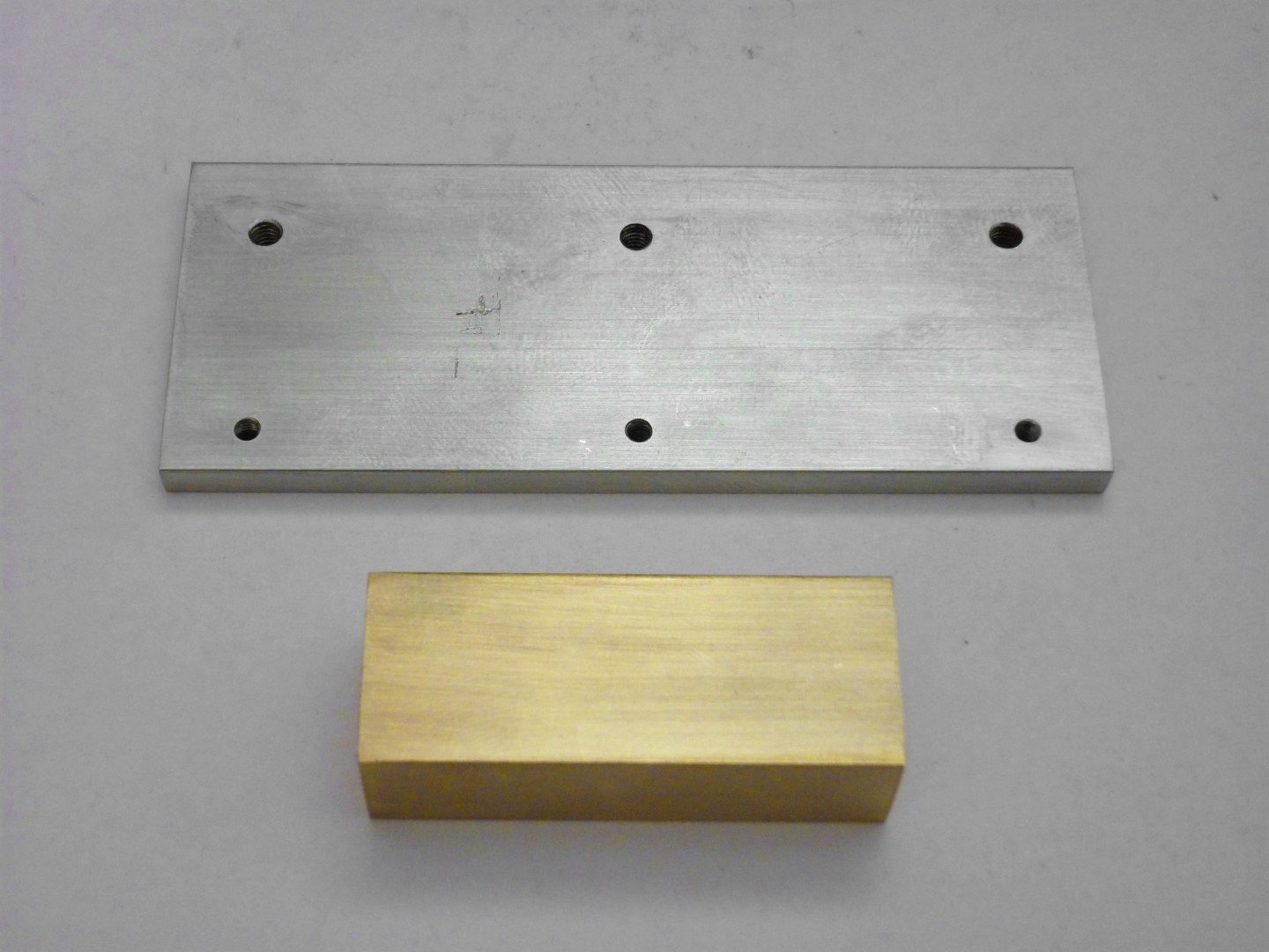

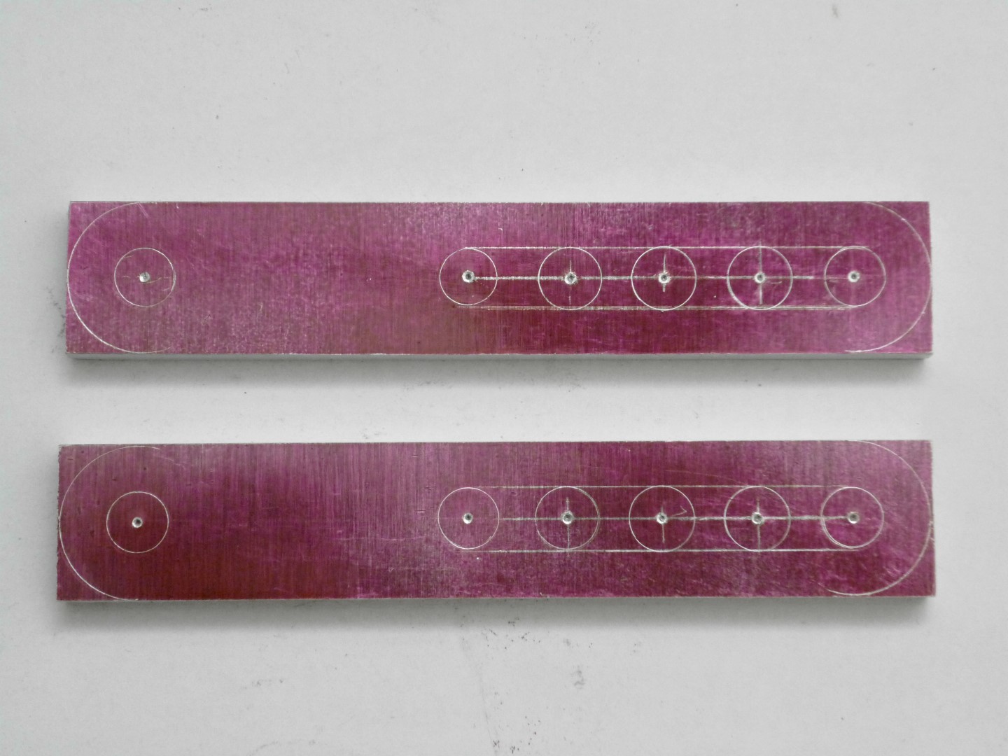

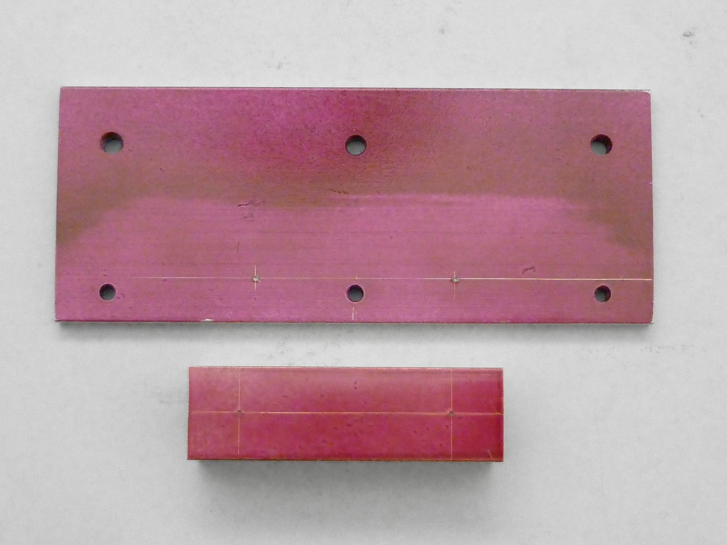

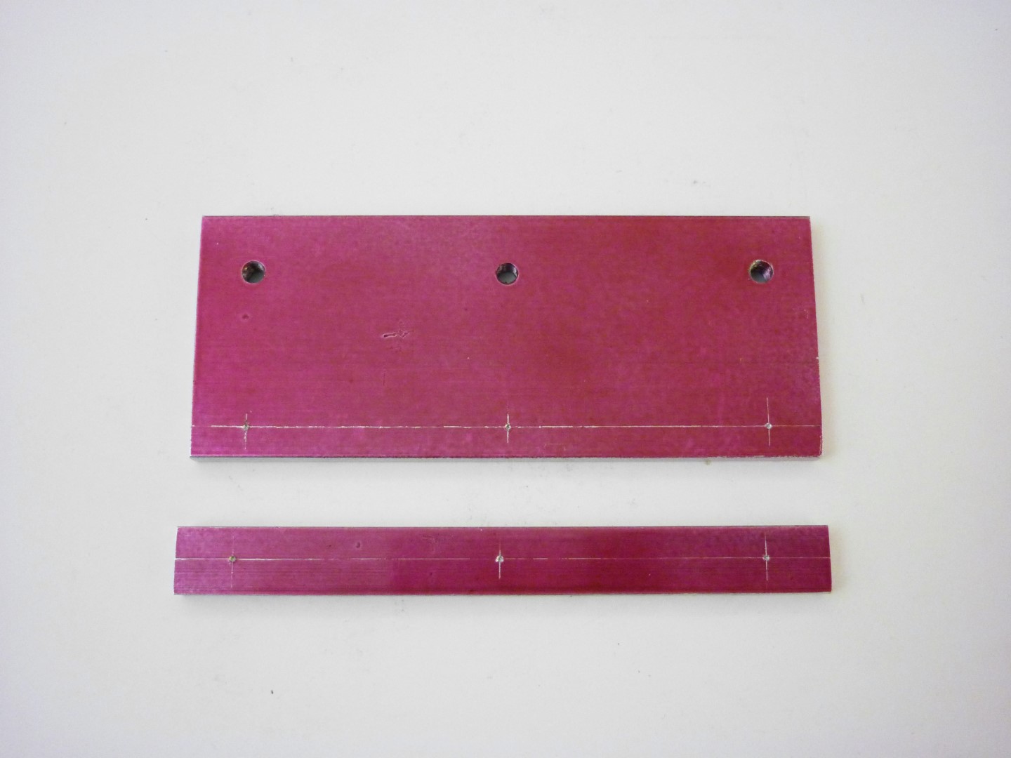

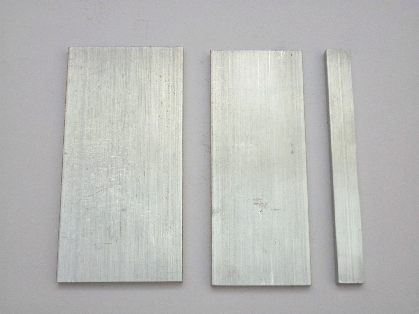

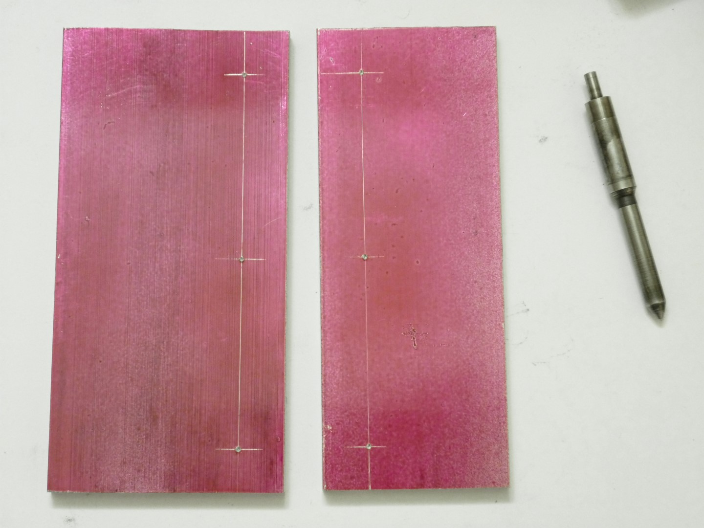

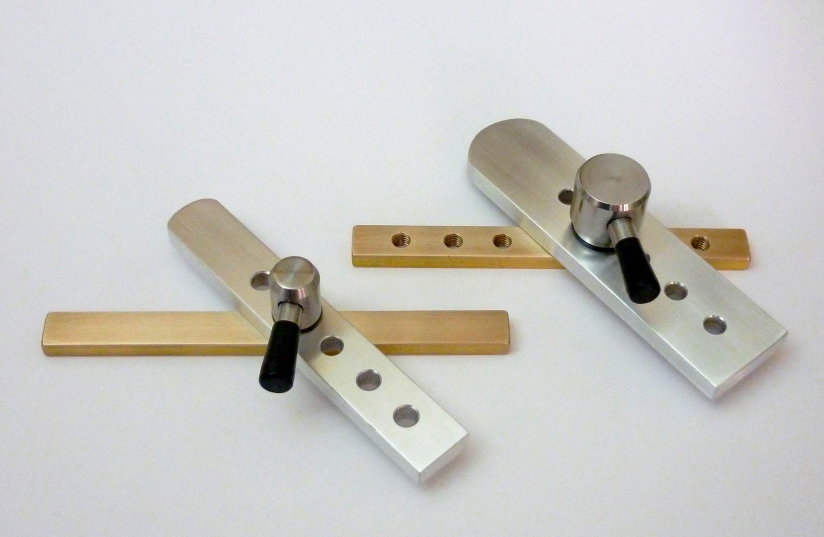

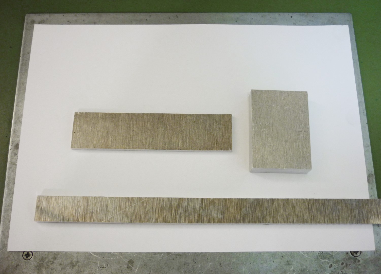

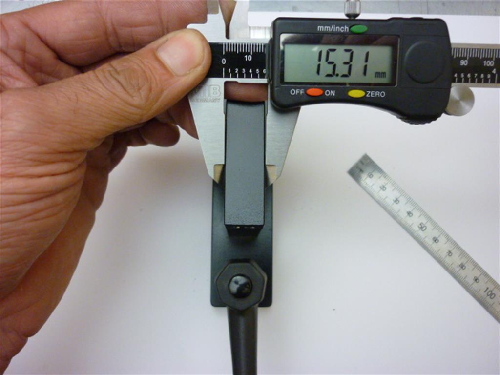

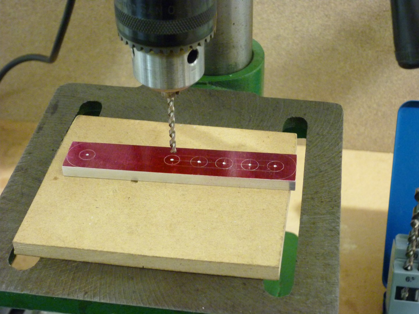

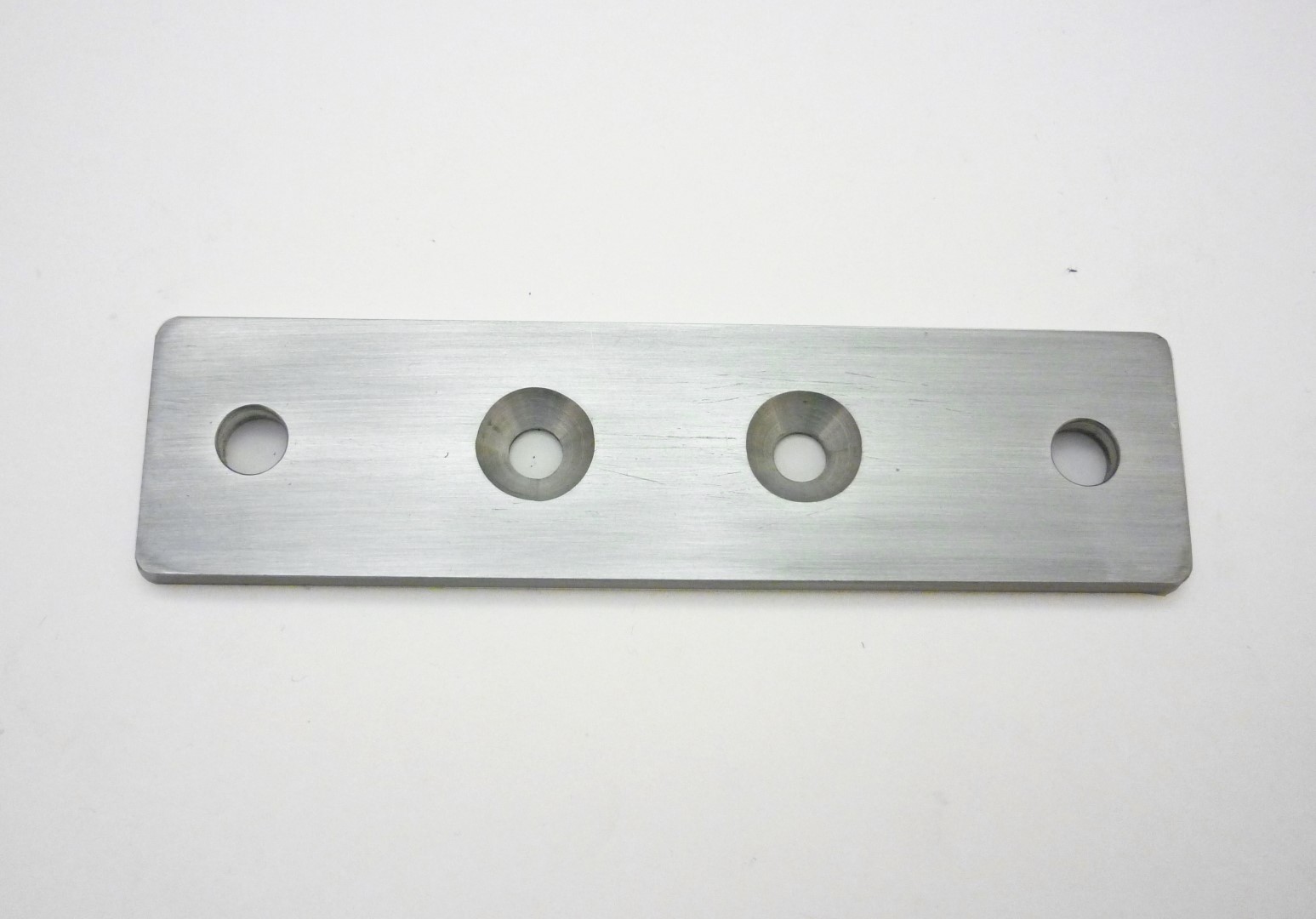

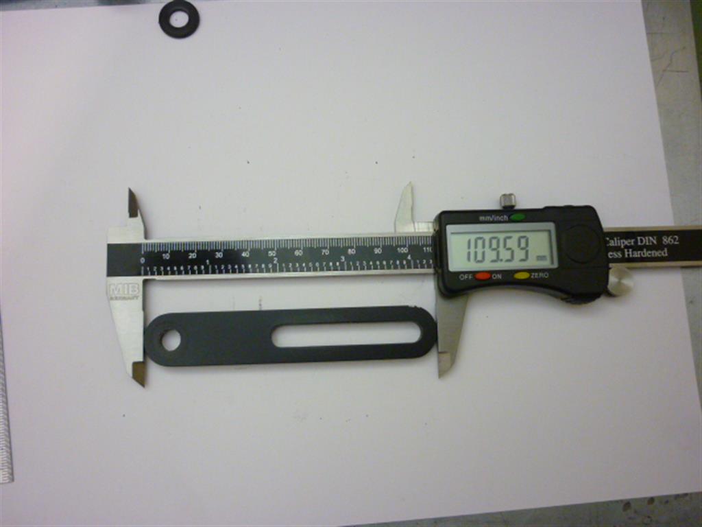

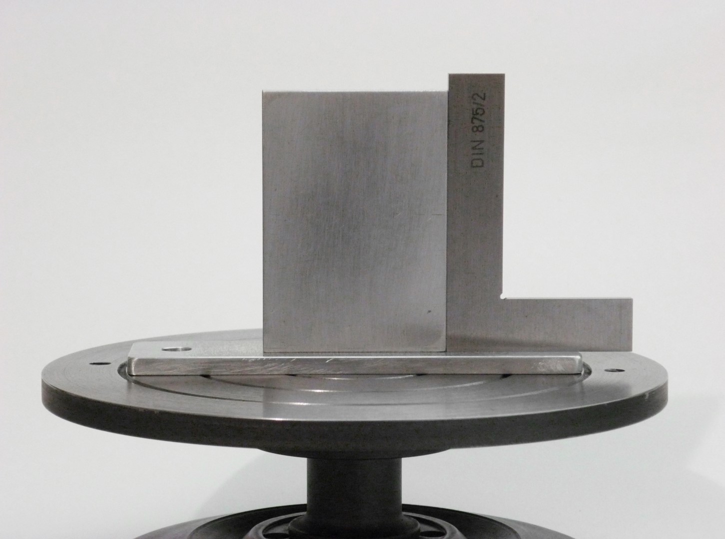

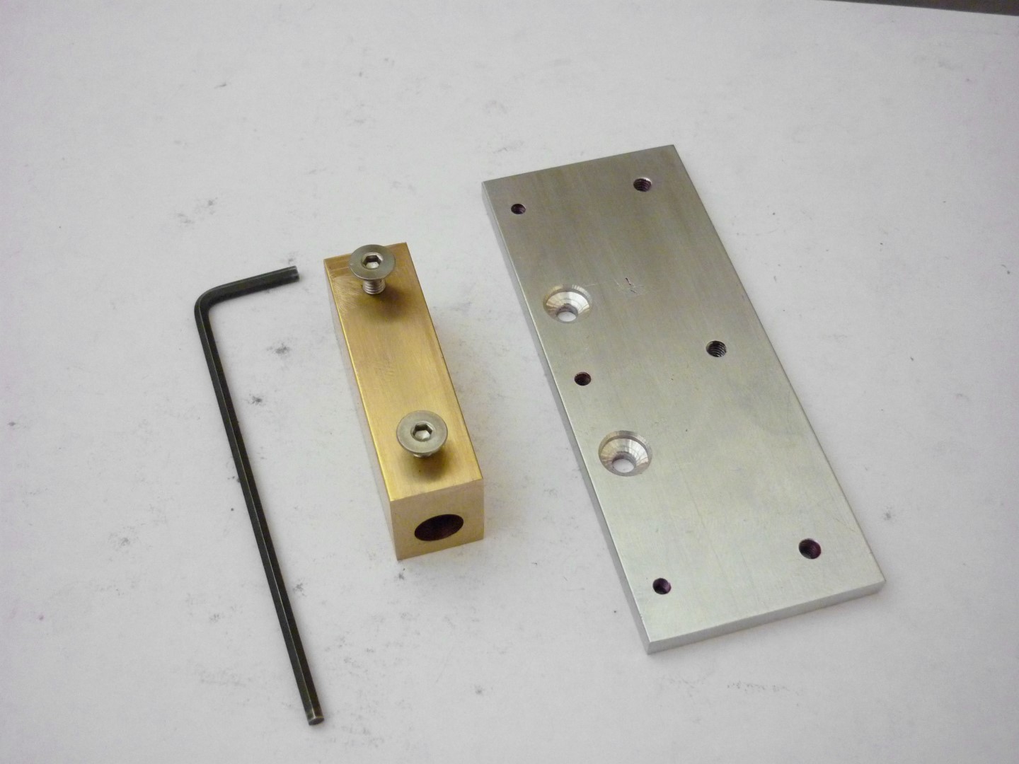

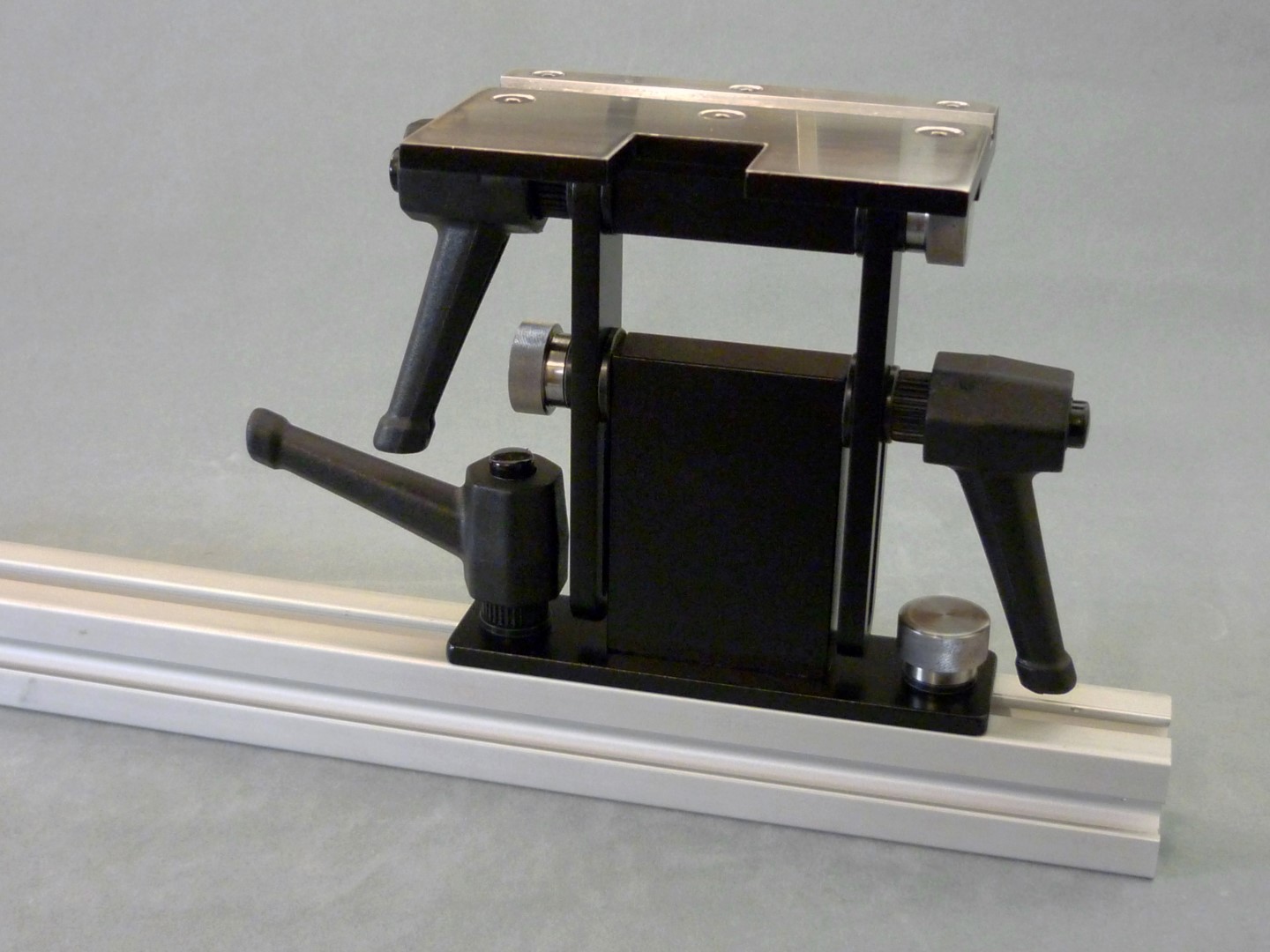

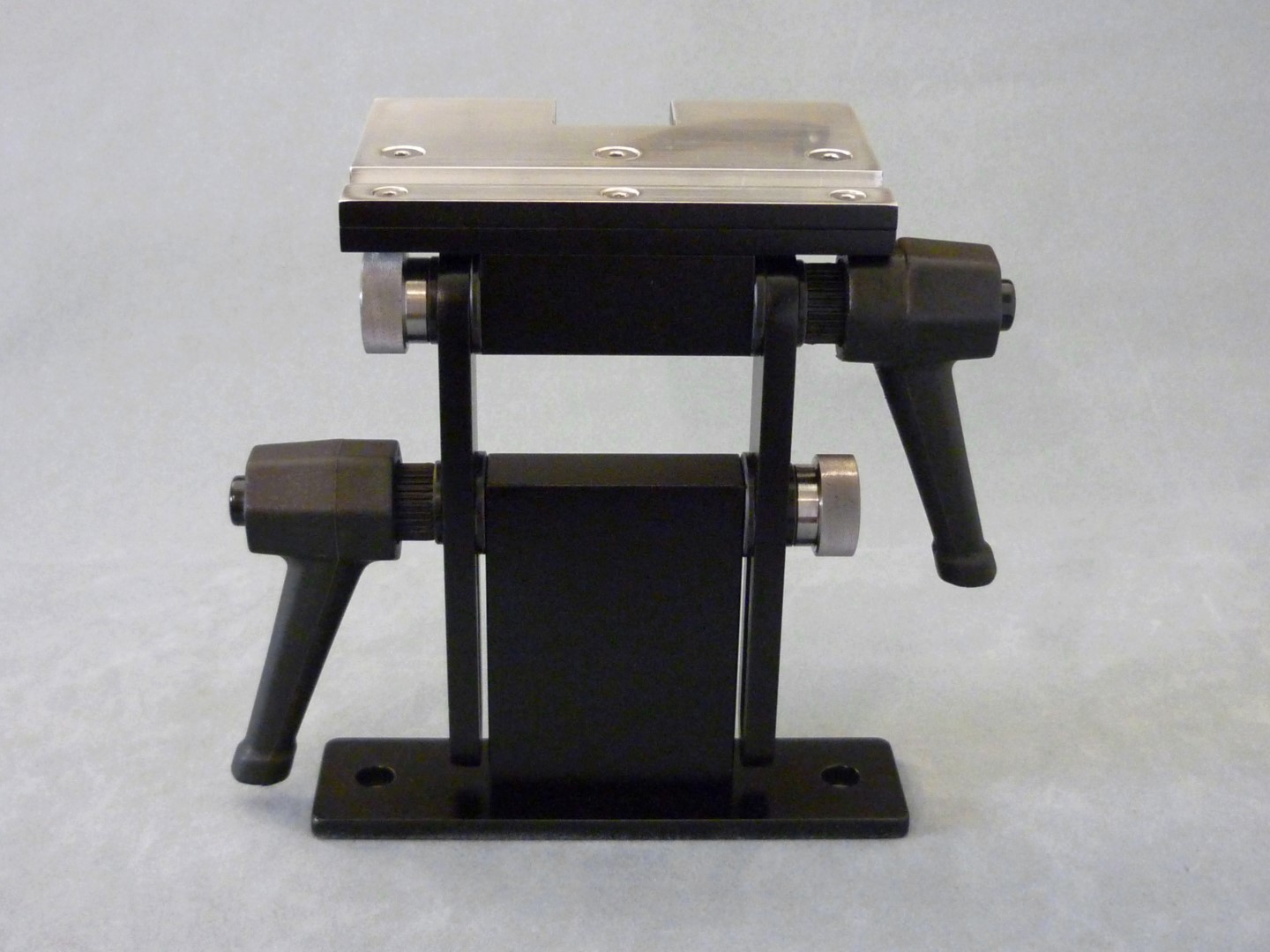

    Hello to everyone,

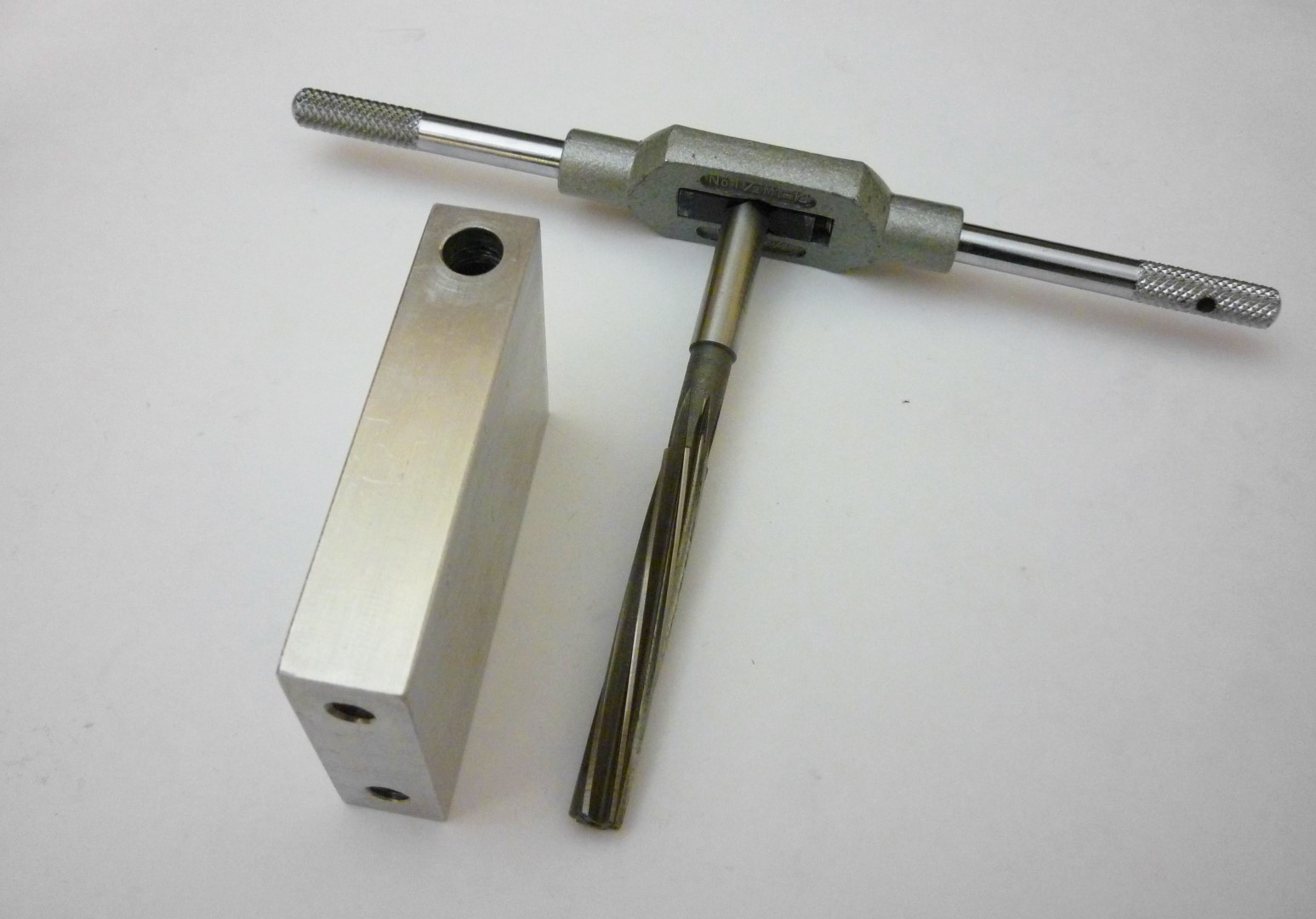

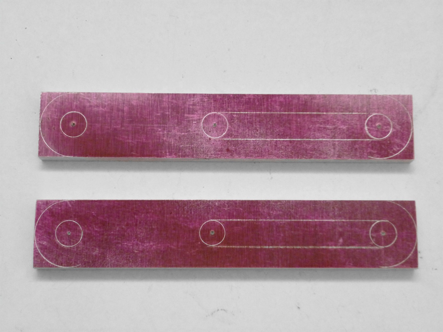

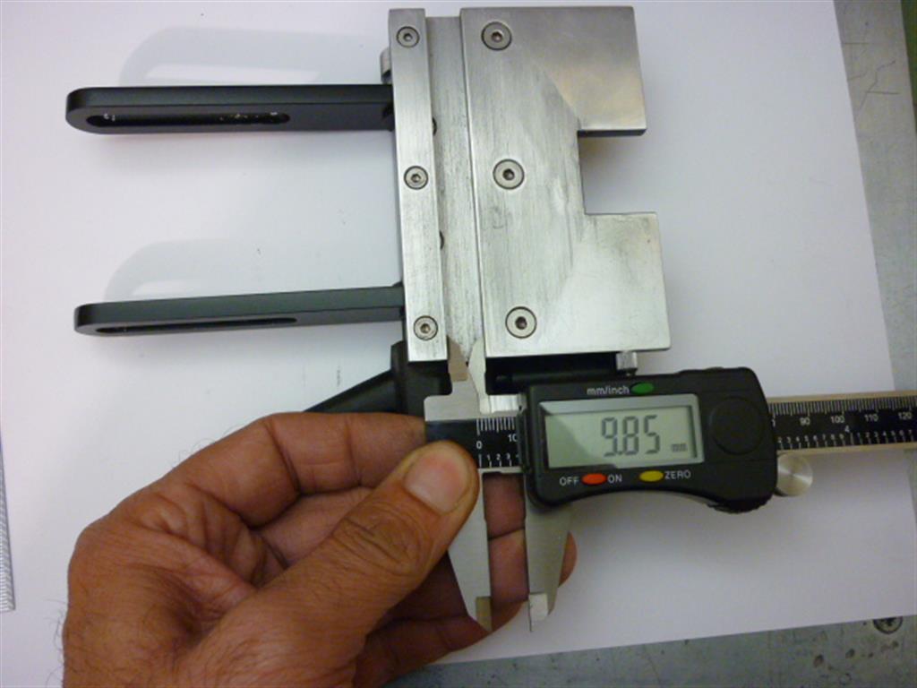

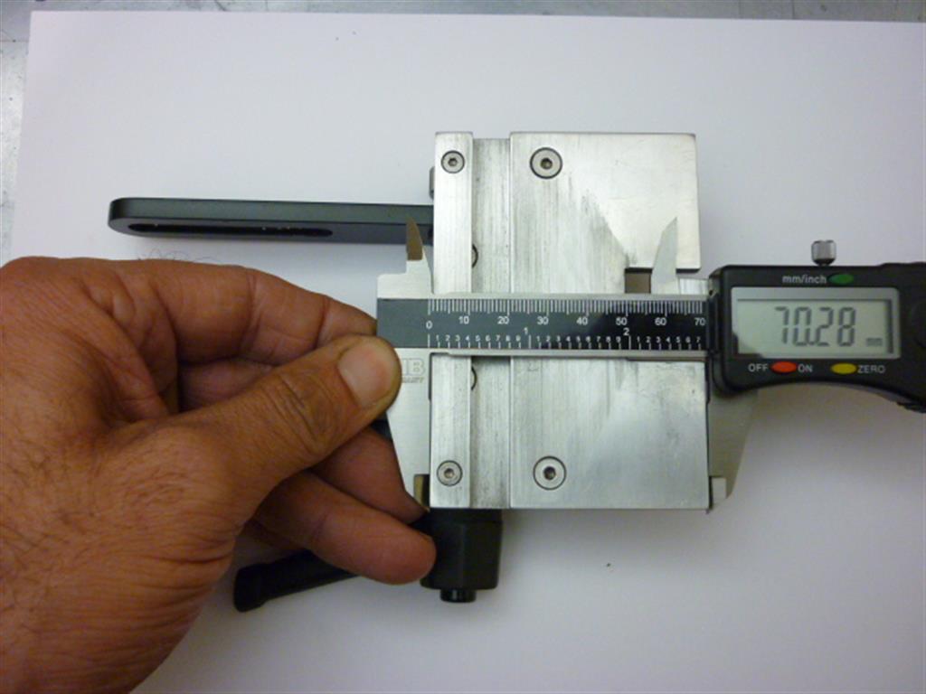

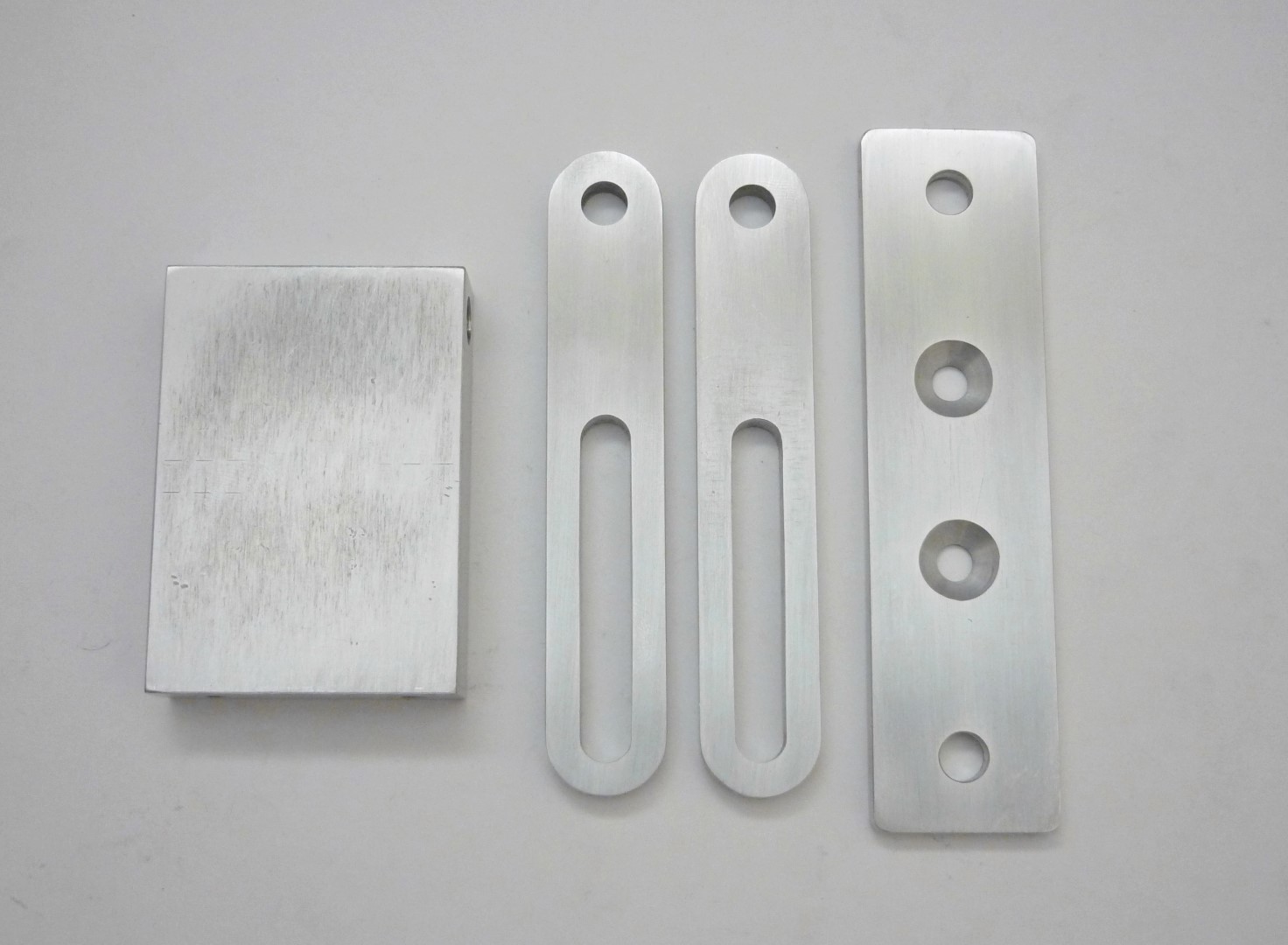

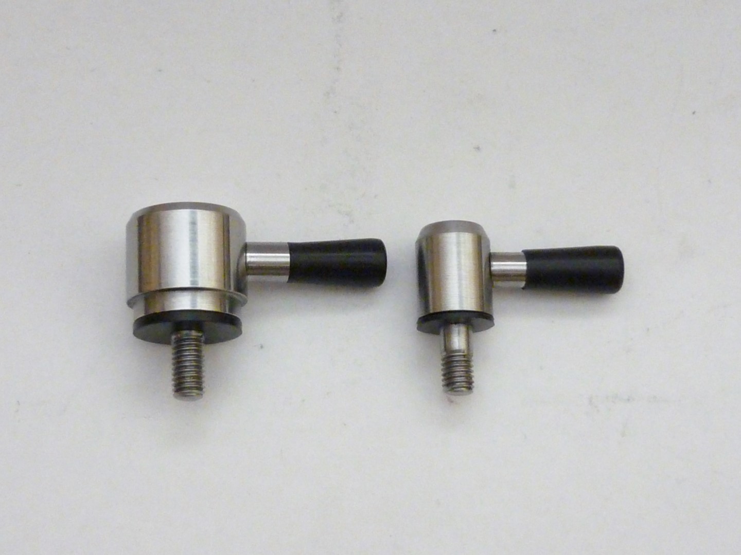

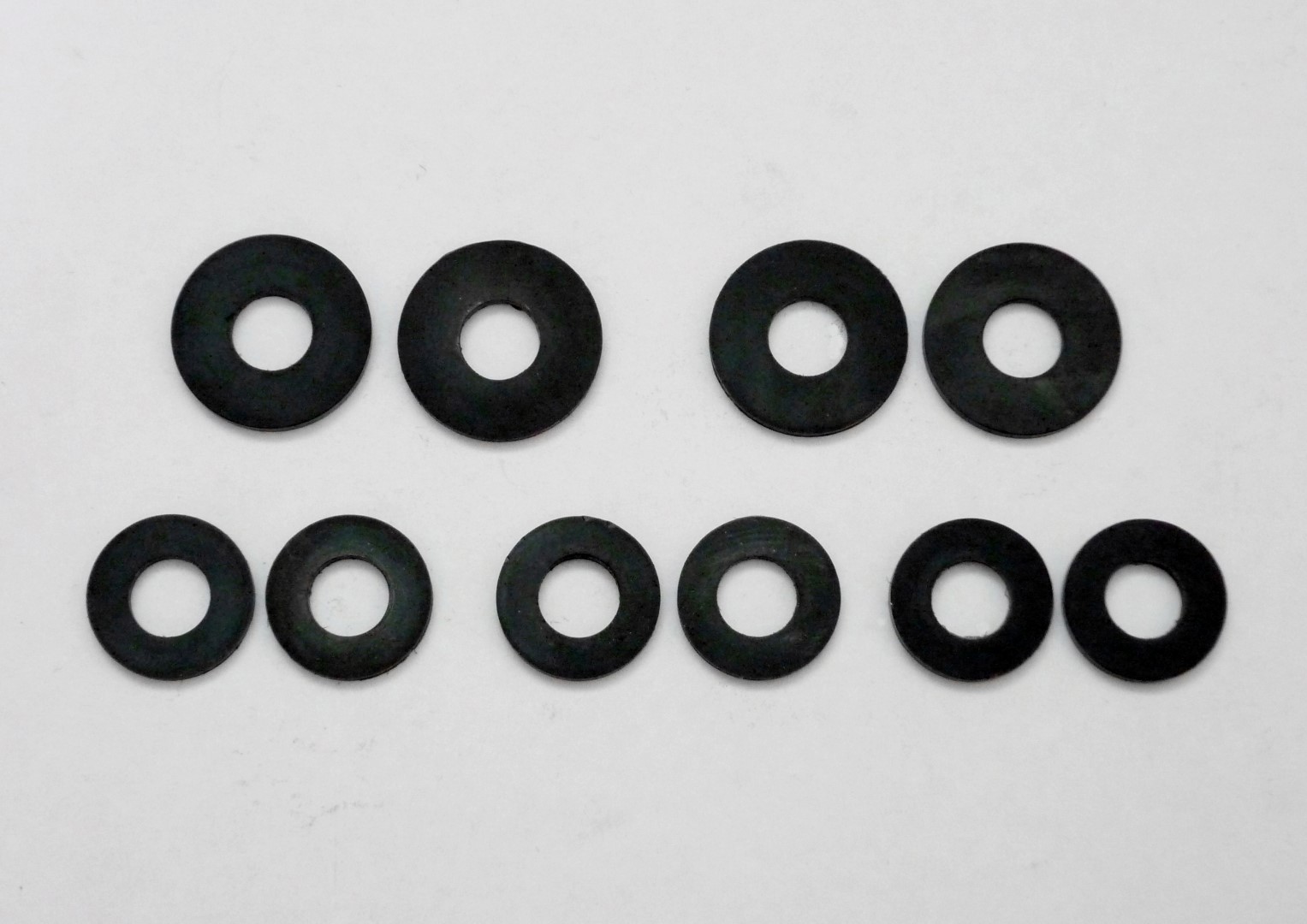

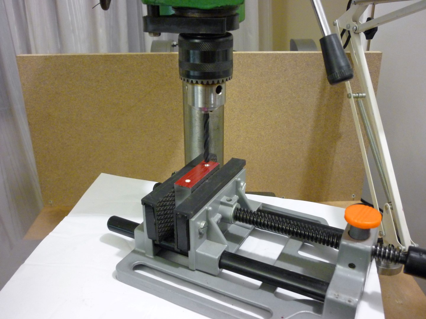

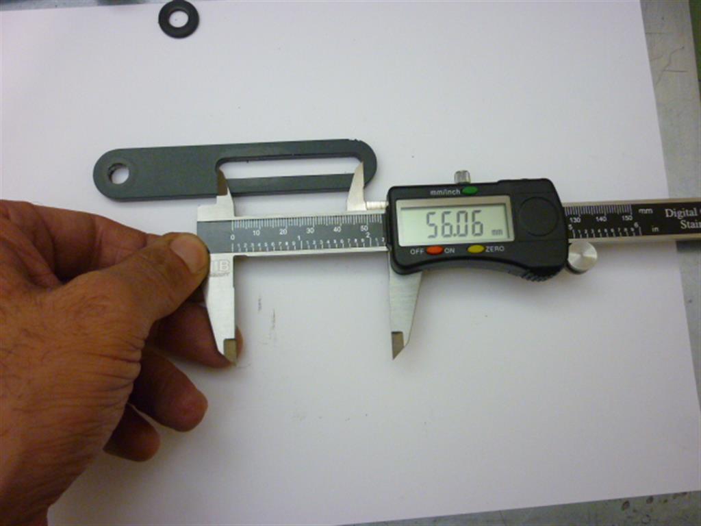

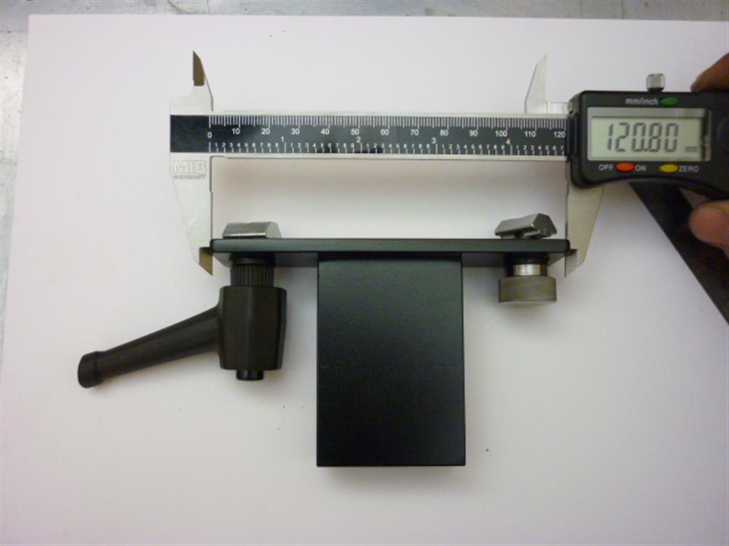

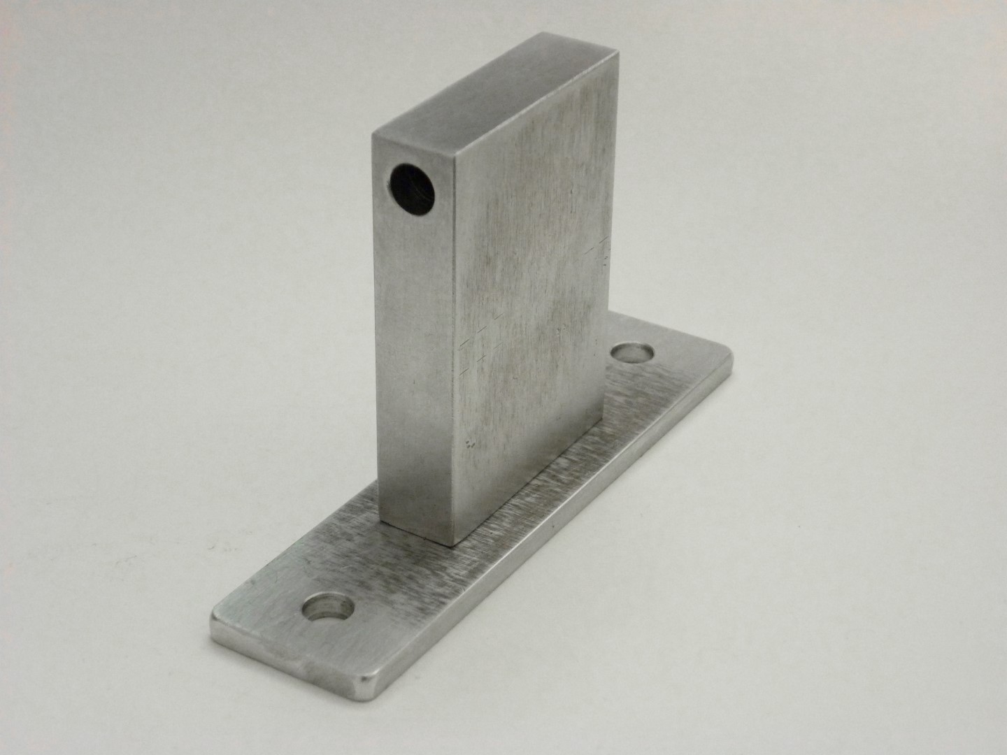

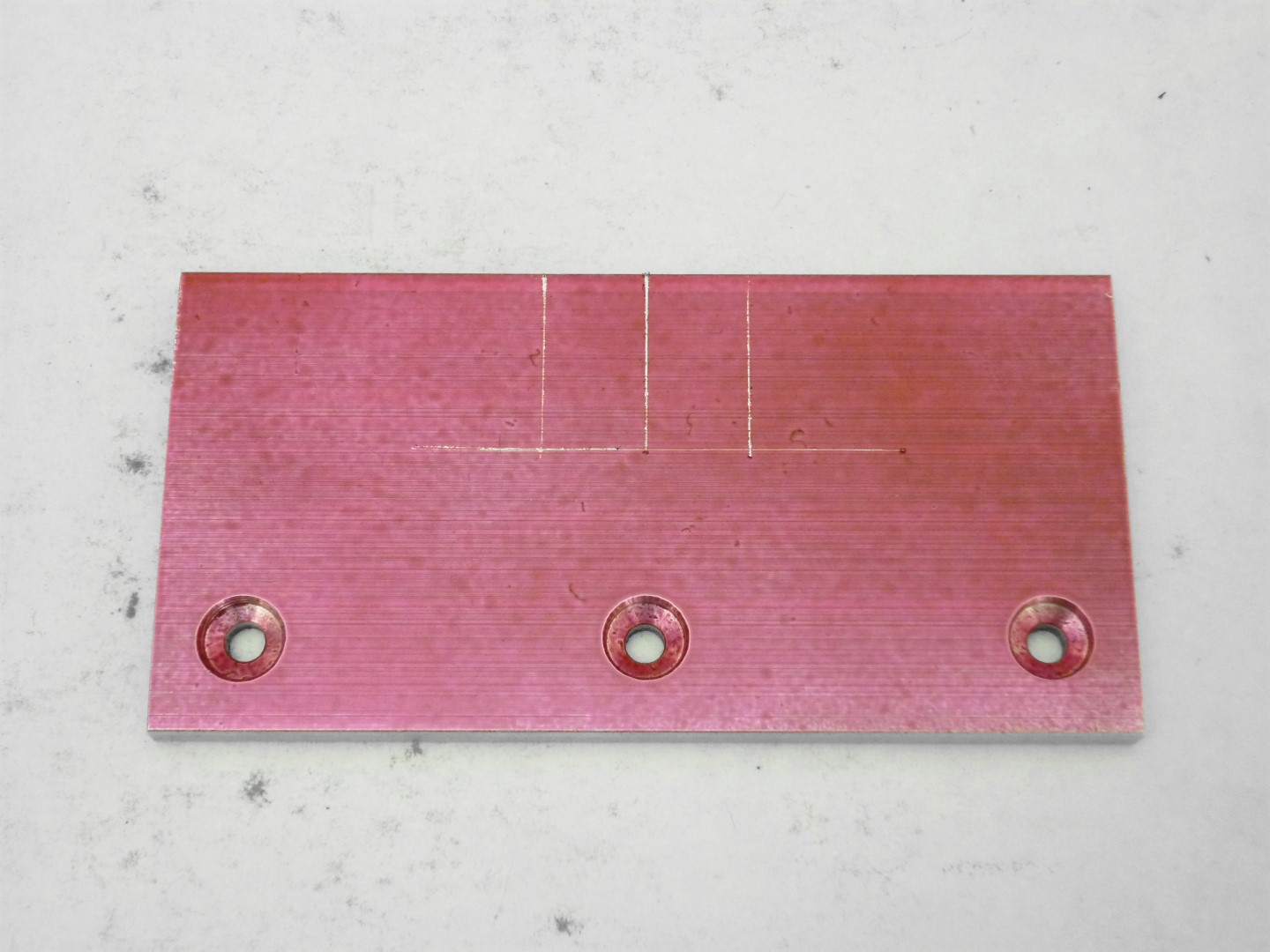

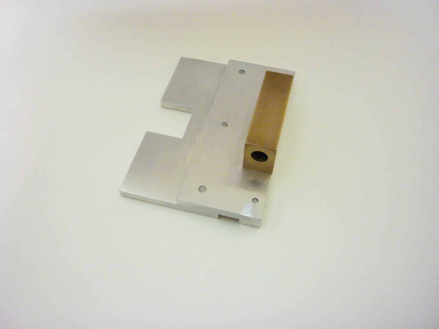

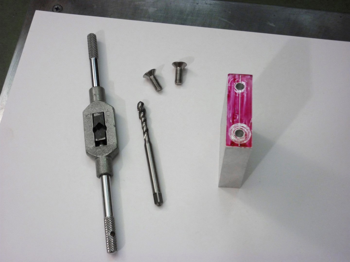

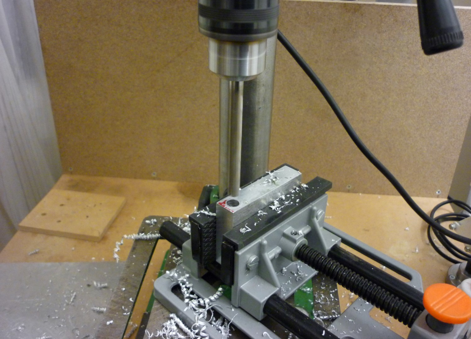

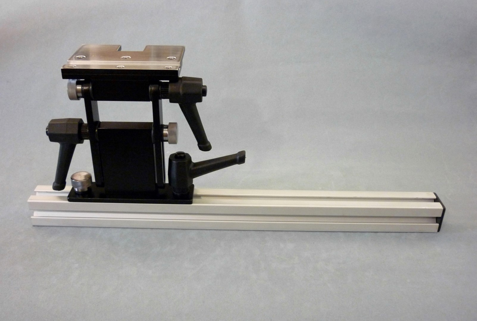

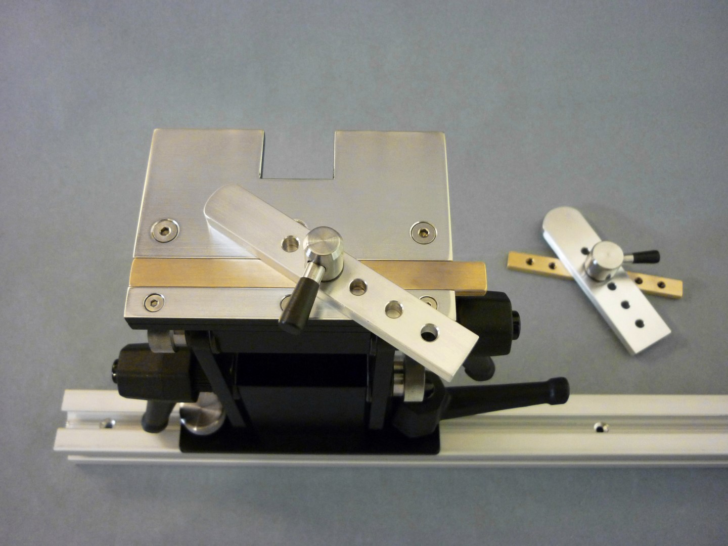

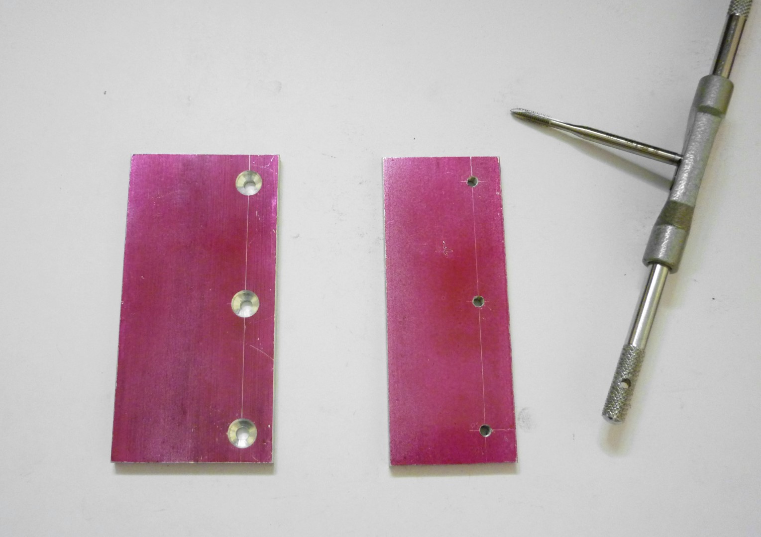

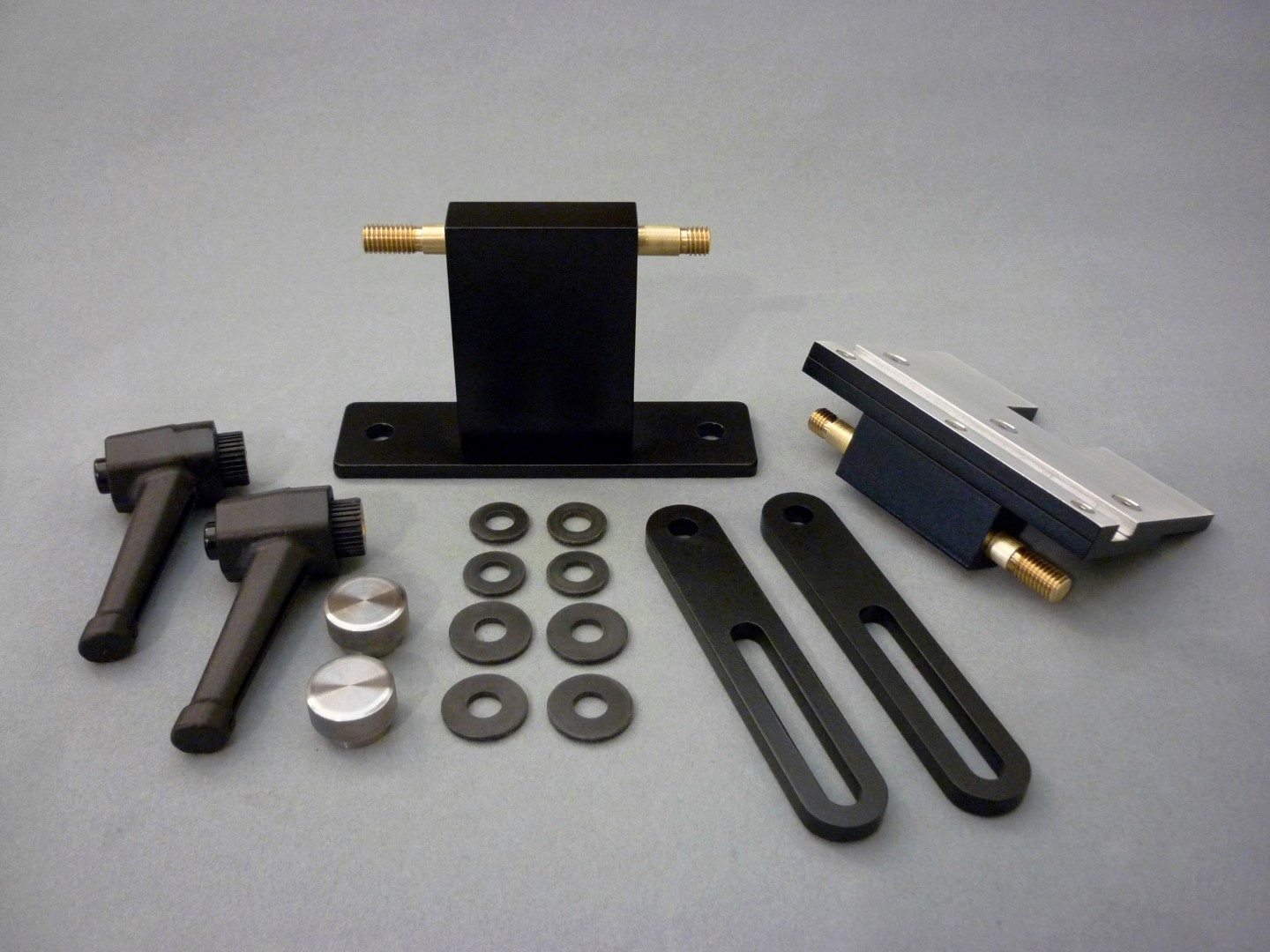

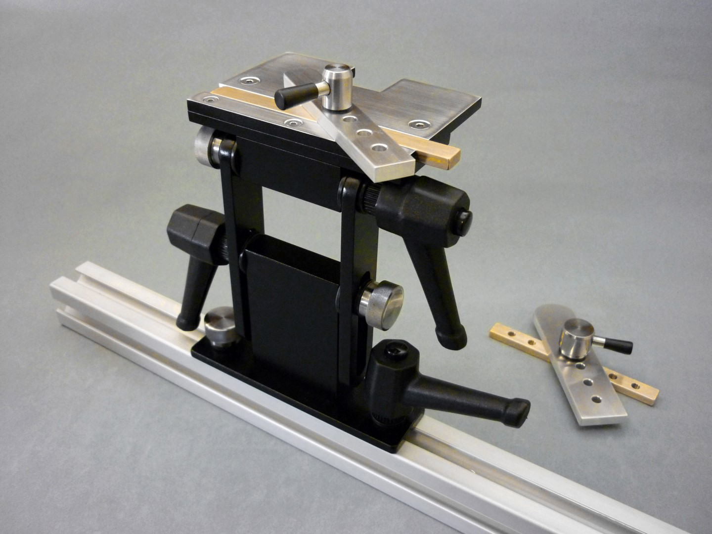

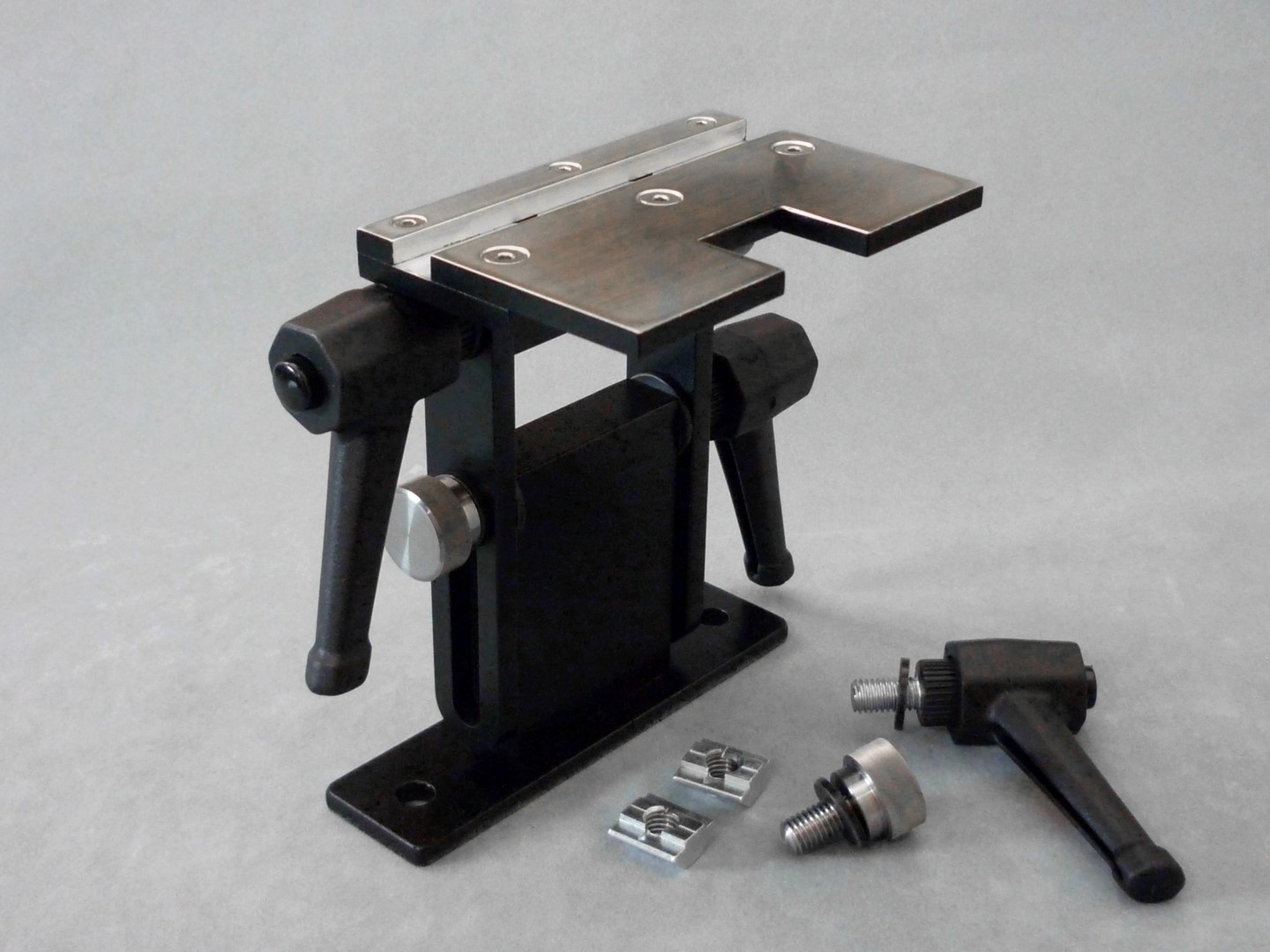

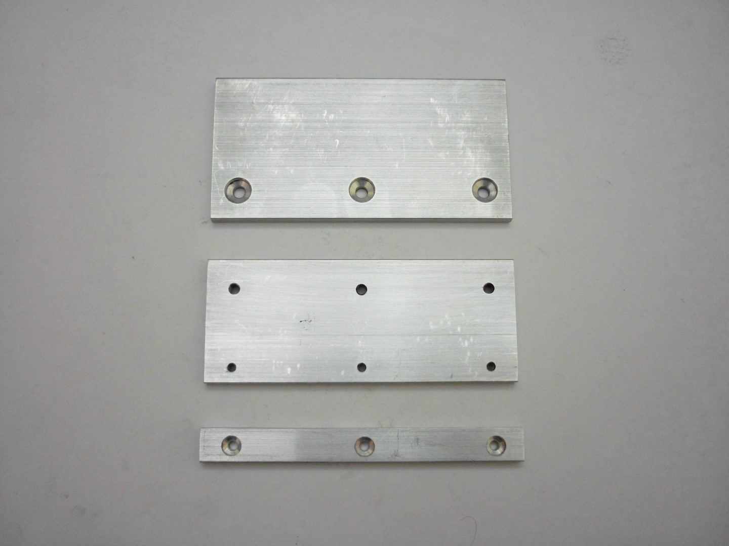

    I would like to share with you one of my favorite projects, the bench grinder tool rest.
    My bench grinder didn’t have tool rests. So, I decided to do something about it; I wanted a tool rest to help me grind accurately HSS and carbide tools. I searched the web and found a few different types; the one that attracted my attention is commercially produced by VERITAS®. So, I tried to make something similar as well as adding a few extra features to make it more versatile.
    You will find three series of pictures showing the construction of the tool rest; each series is followed by a video as well. I hope that you will find it interesting.
    All the best
    Dimitris

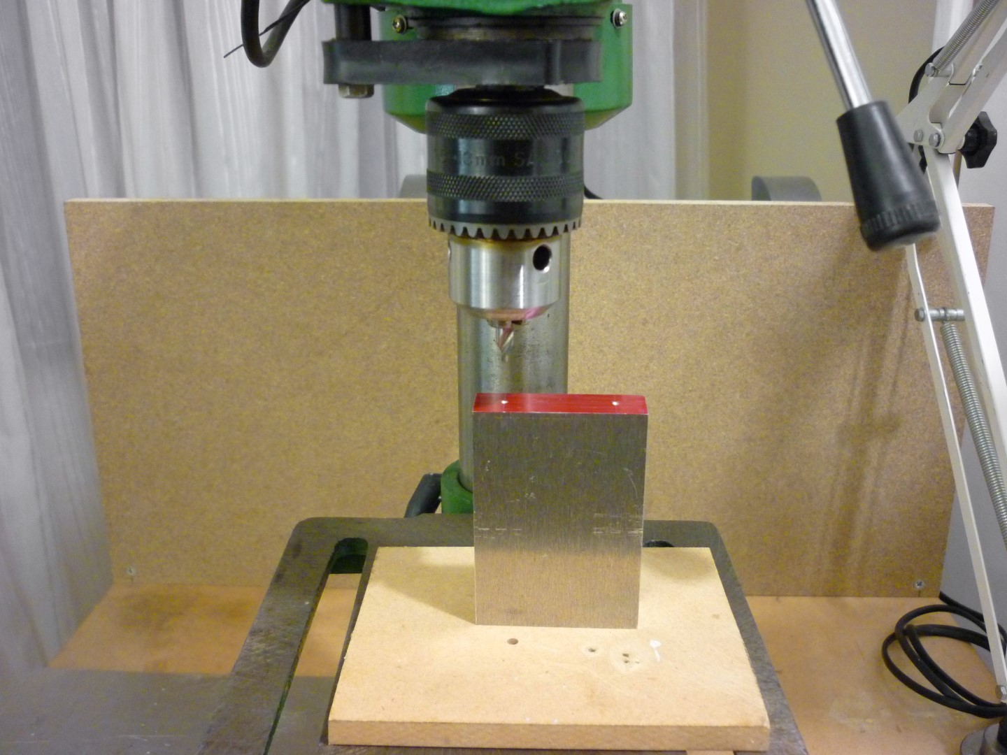

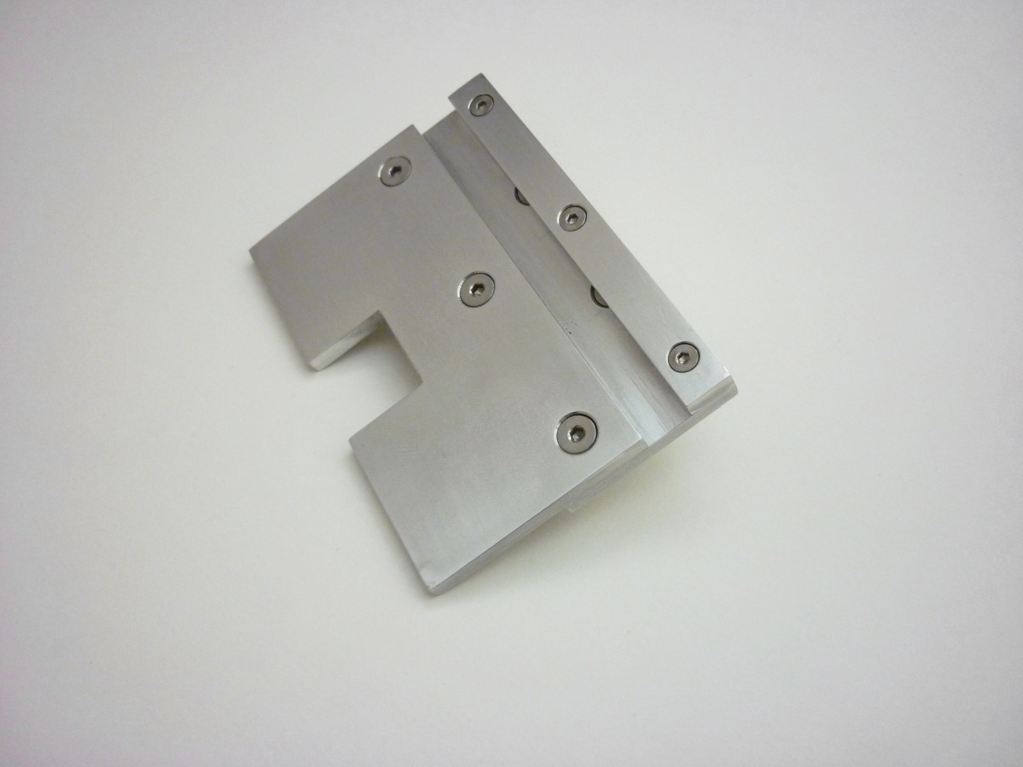

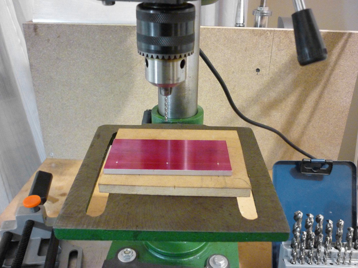

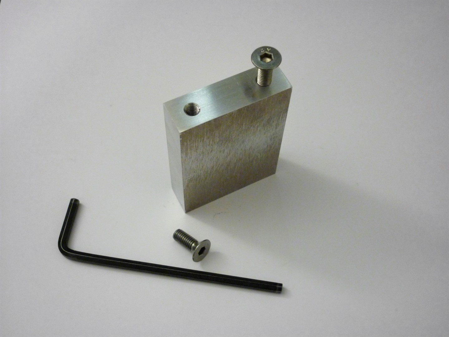

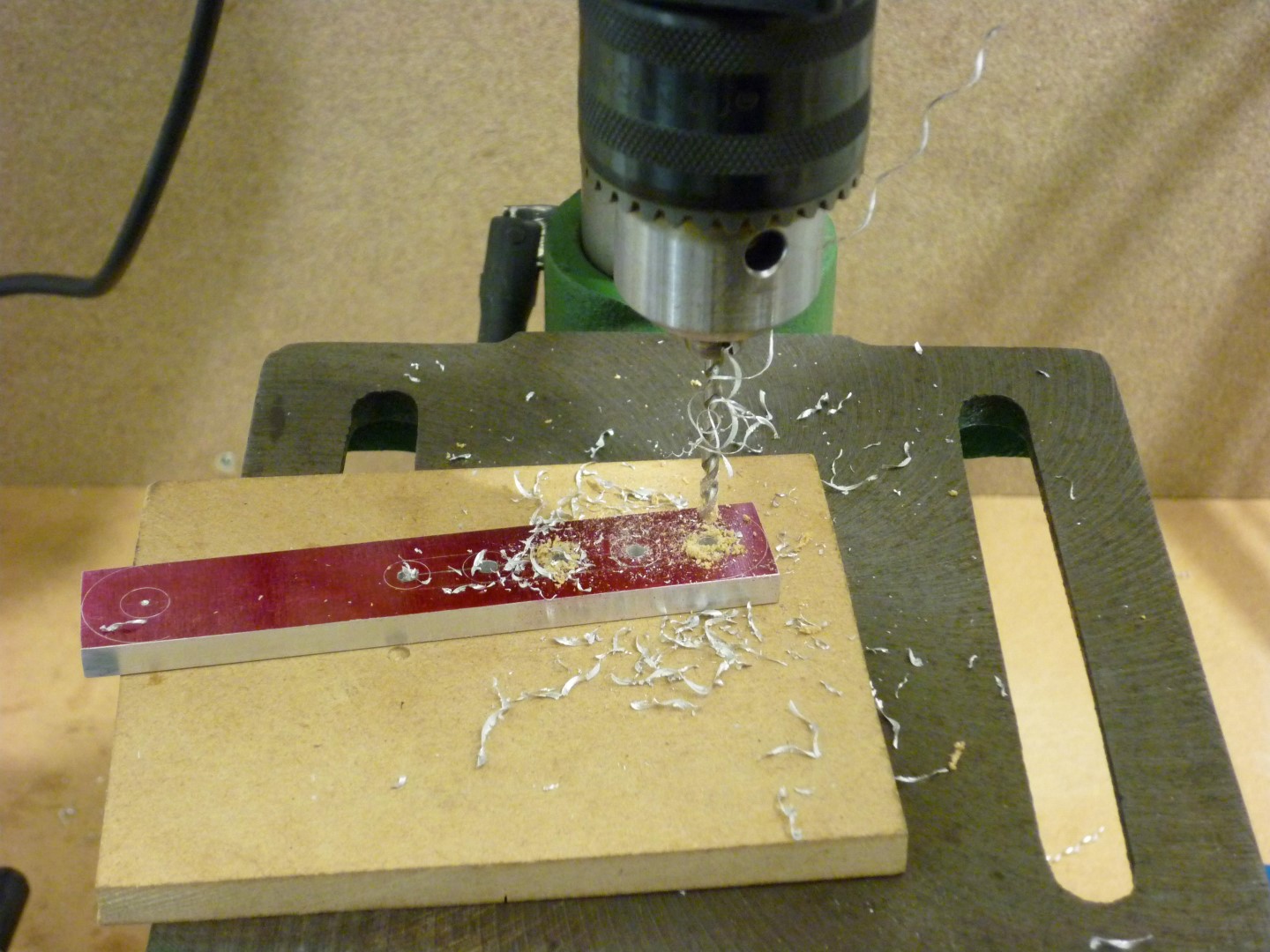

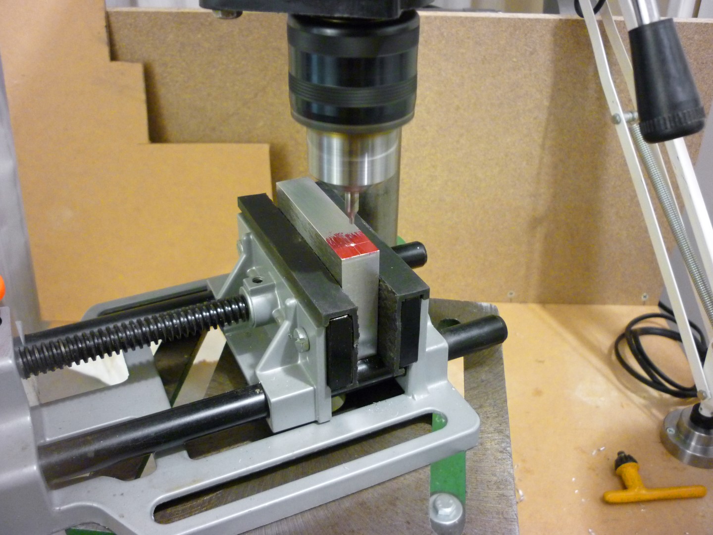

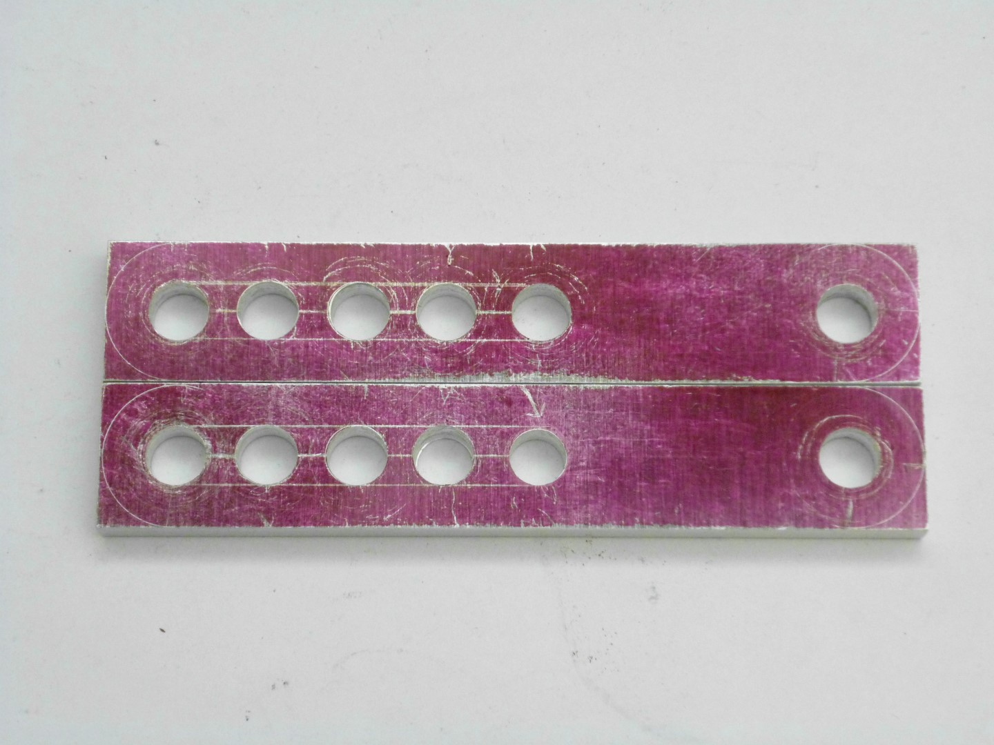

    Making the main body and the arms
    Bench grinder tool rest-1.jpg Bench grinder tool rest-2.jpg Bench grinder tool rest-3.jpg Bench grinder tool rest-4.jpg Bench grinder tool rest-5.jpg Bench grinder tool rest-6.jpg Bench grinder tool rest-7.jpg Bench grinder tool rest-8.jpg Bench grinder tool rest-9.jpg Bench grinder tool rest-10.jpg Bench grinder tool rest-11.jpg Bench grinder tool rest-12.jpg Bench grinder tool rest-13.jpg Bench grinder tool rest-14.jpg Bench grinder tool rest-15.jpg Bench grinder tool rest-16.jpg Bench grinder tool rest-17.jpg Bench grinder tool rest-18.jpg Bench grinder tool rest-19.jpg Bench grinder tool rest-20.jpg Bench grinder tool rest-21.jpg

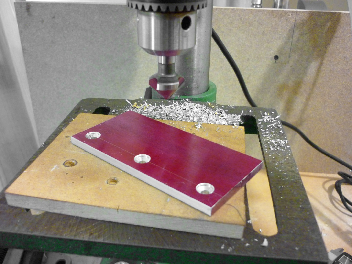

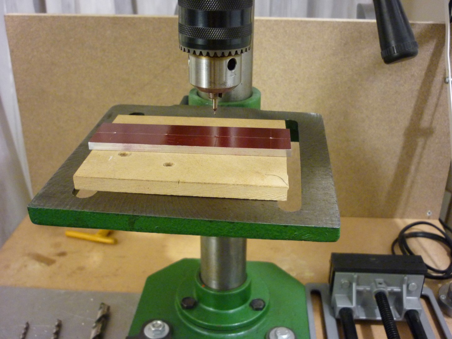

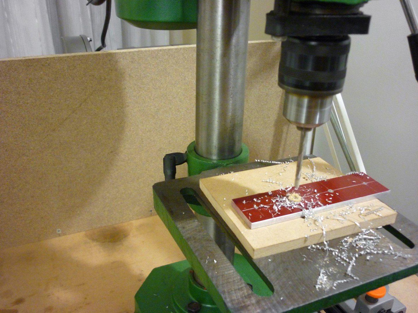

    Making the tool rest plate
    Bench grinder tool rest-22.jpg Bench grinder tool rest-23.jpg Bench grinder tool rest-24.jpg Bench grinder tool rest-25.jpg Bench grinder tool rest-26.jpg Bench grinder tool rest-27.jpg Bench grinder tool rest-28.jpg Bench grinder tool rest-29.jpg Bench grinder tool rest-30.jpg Bench grinder tool rest-31.jpg Bench grinder tool rest-32.jpg Bench grinder tool rest-33.jpg Bench grinder tool rest-34.jpg Bench grinder tool rest-35.jpg Bench grinder tool rest-36.jpg Bench grinder tool rest-37.jpg Bench grinder tool rest-38.jpg Bench grinder tool rest-39.jpg Bench grinder tool rest-40.jpg Bench grinder tool rest-41.jpg Bench grinder tool rest-42.jpg

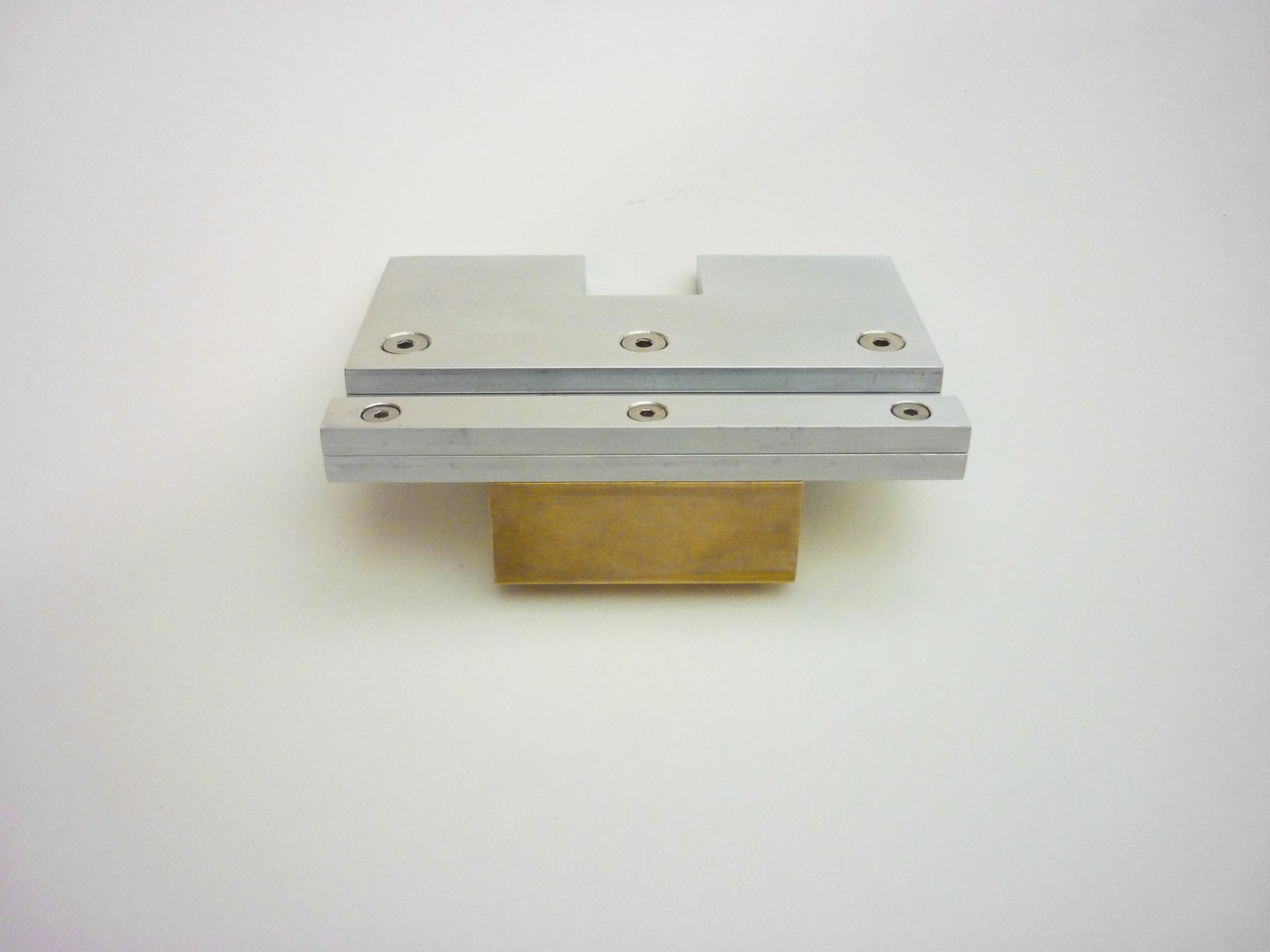

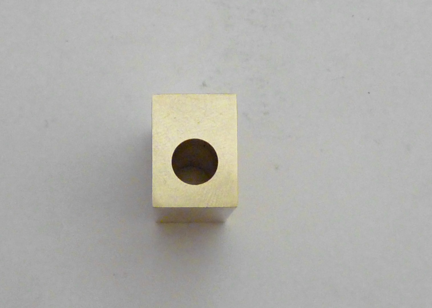

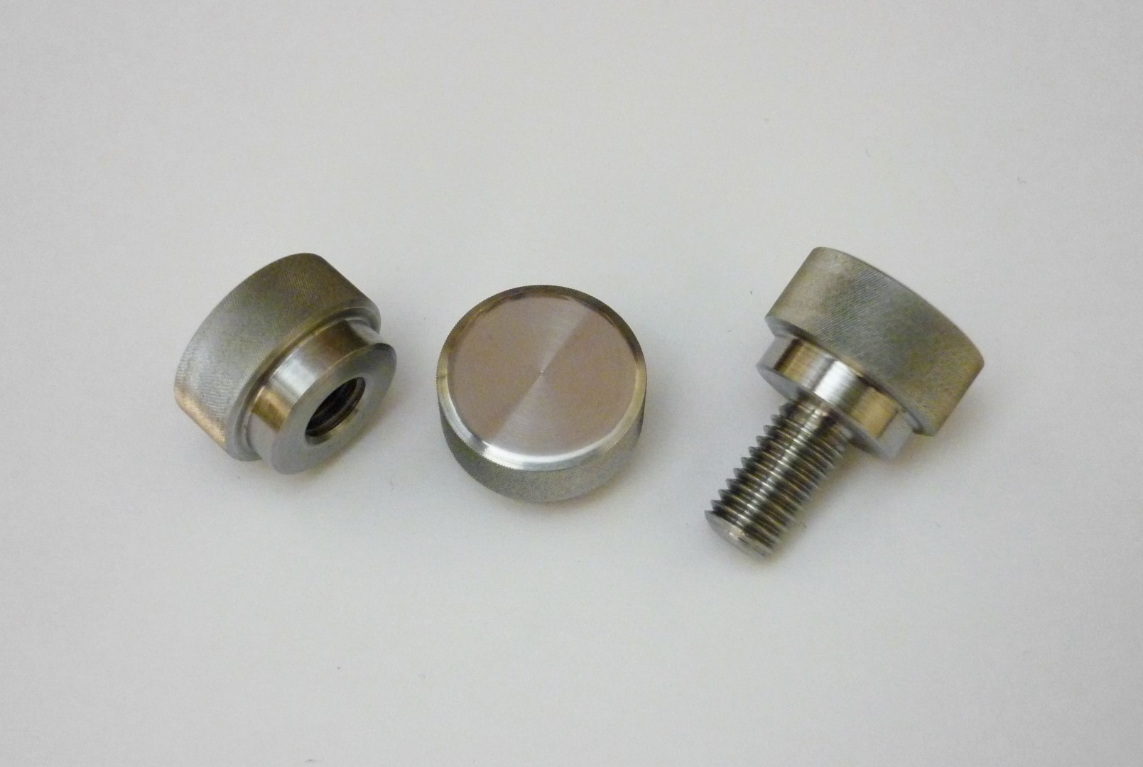

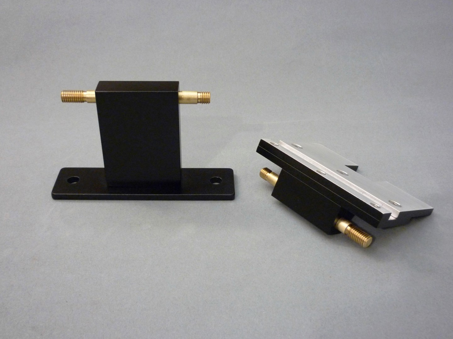

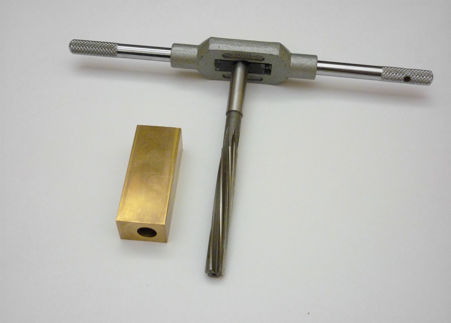

    Making all the small parts and final assembling
    Bench grinder tool rest-43.jpg Bench grinder tool rest-44.jpg Bench grinder tool rest-45.jpg Bench grinder tool rest-46.jpg Bench grinder tool rest-47.jpg Bench grinder tool rest-48.jpg Bench grinder tool rest-49.jpg Bench grinder tool rest-50.jpg Bench grinder tool rest-51.jpg Bench grinder tool rest-52.jpg Bench grinder tool rest-53.jpg Bench grinder tool rest-54.jpg Bench grinder tool rest-55.jpg Bench grinder tool rest-56.jpg Bench grinder tool rest-57.jpg Bench grinder tool rest-58.jpg Bench grinder tool rest-59.jpg

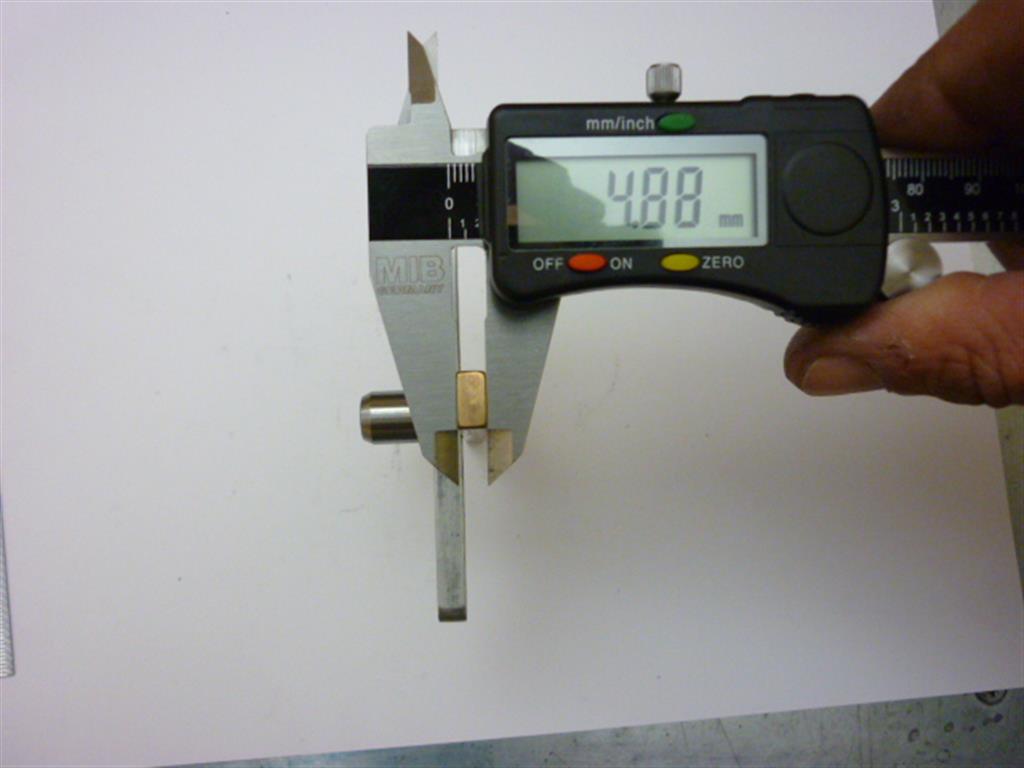

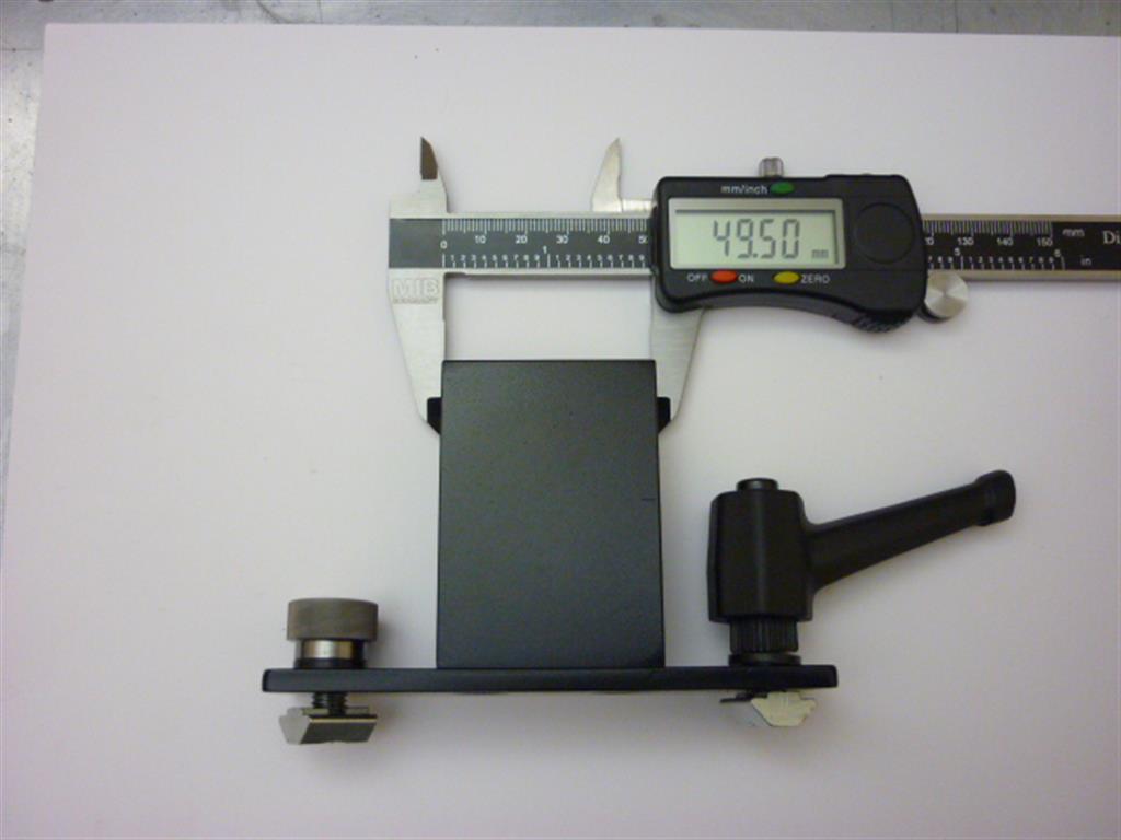

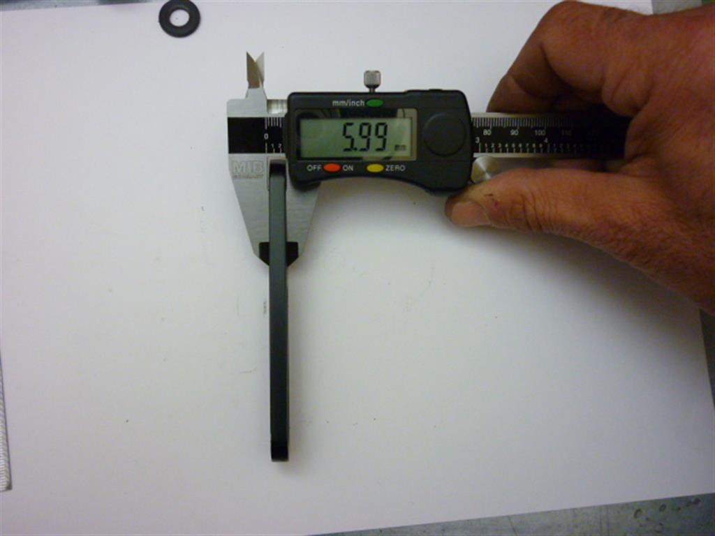

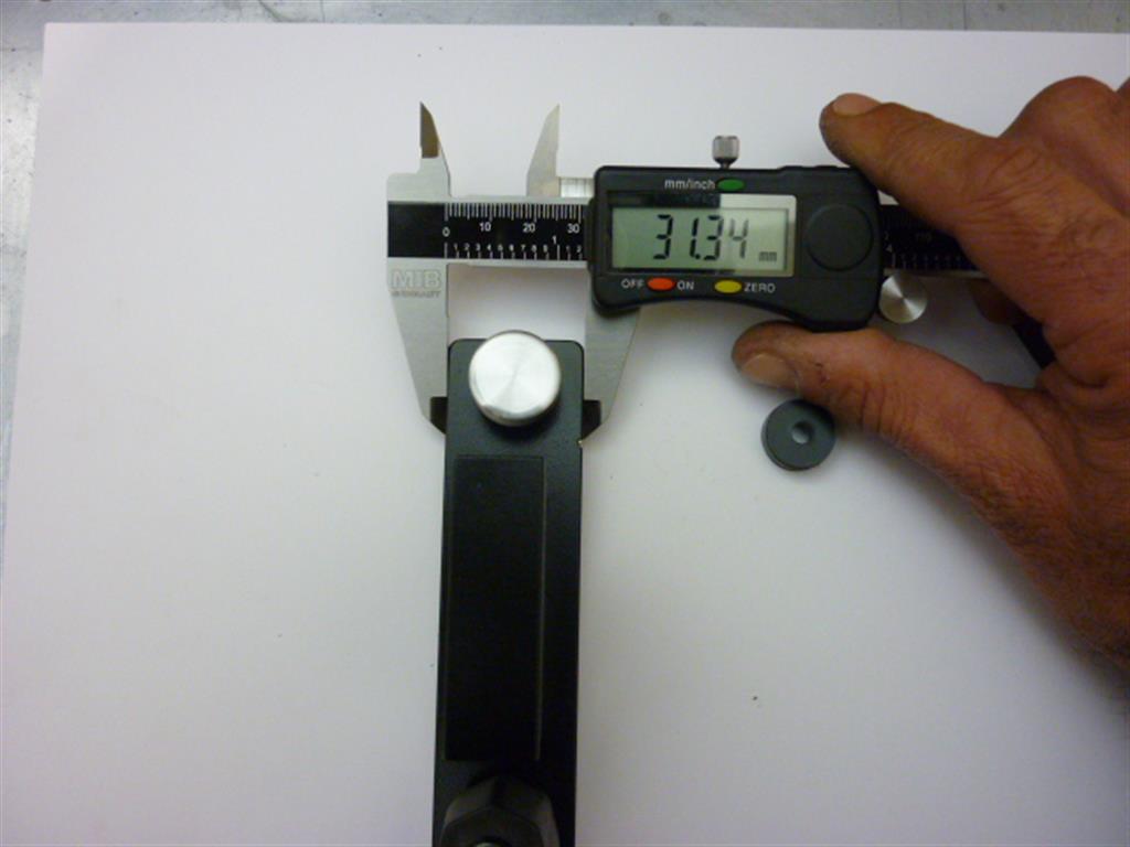

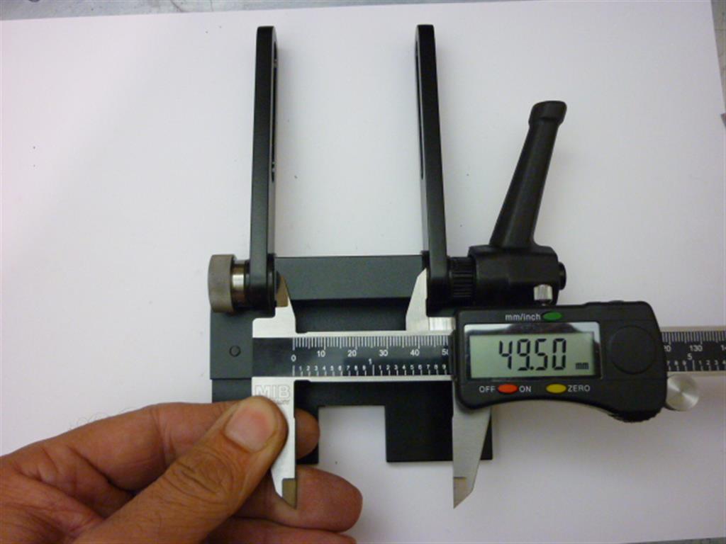

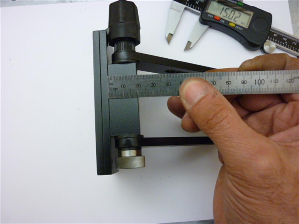

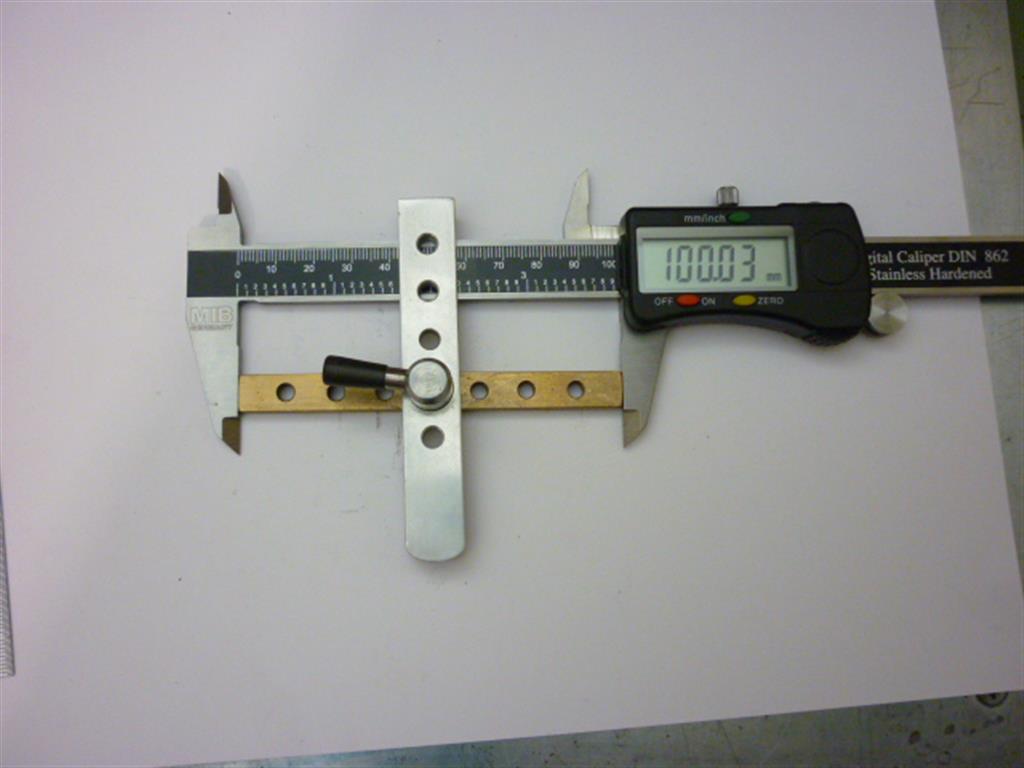

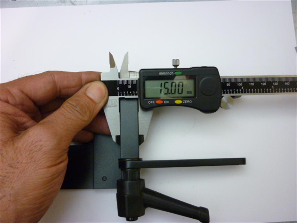

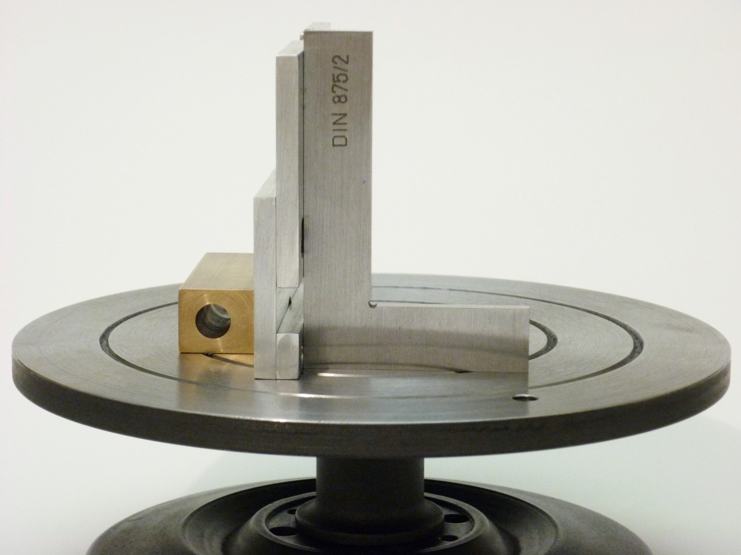

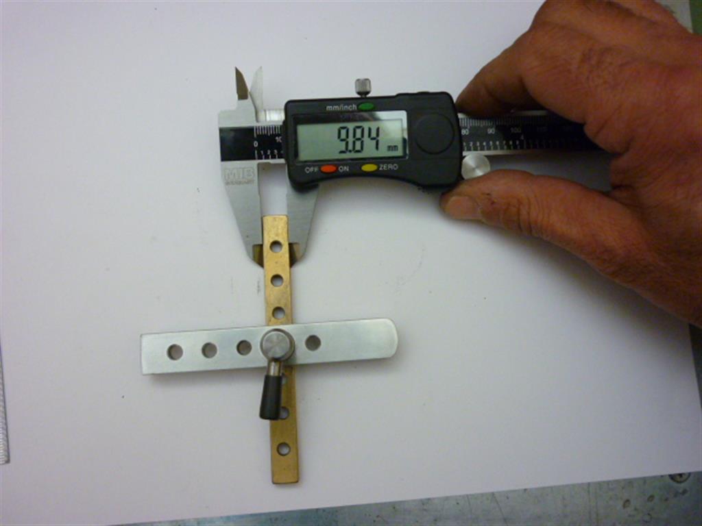

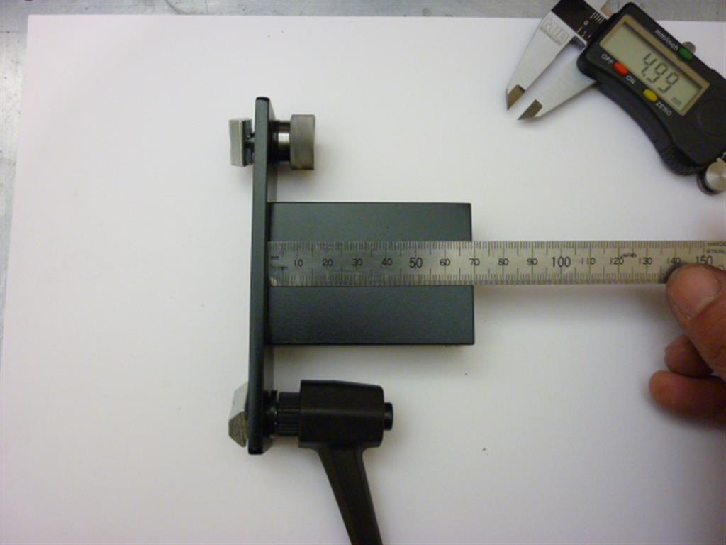

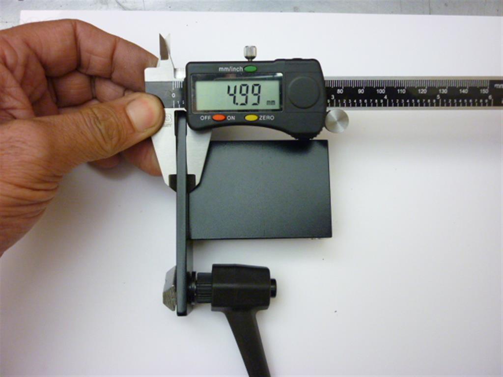

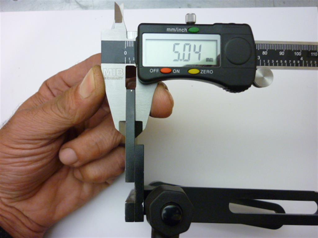

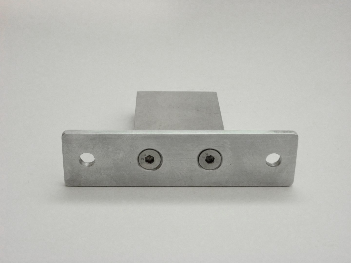

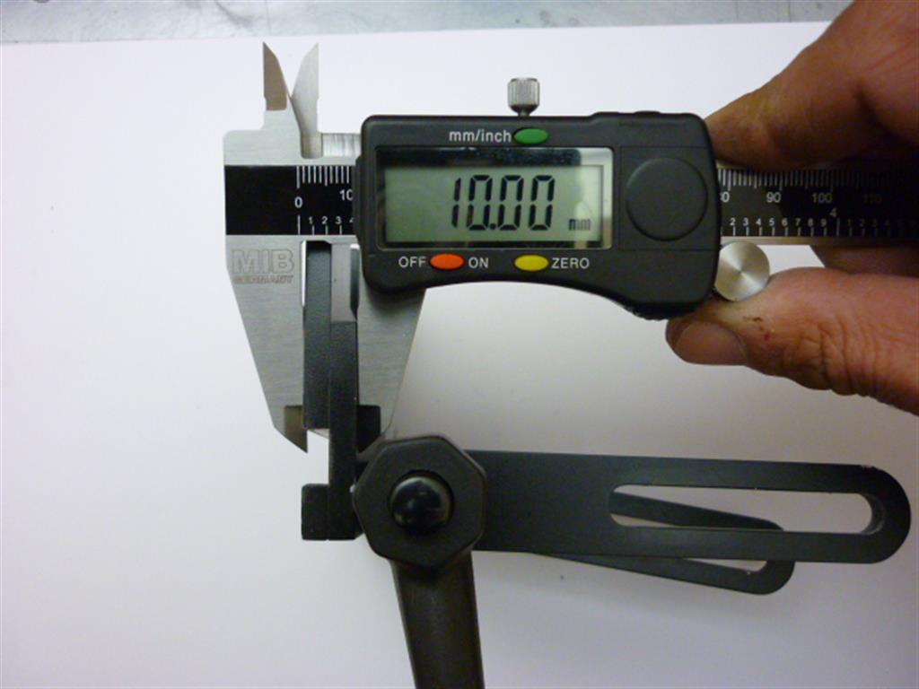

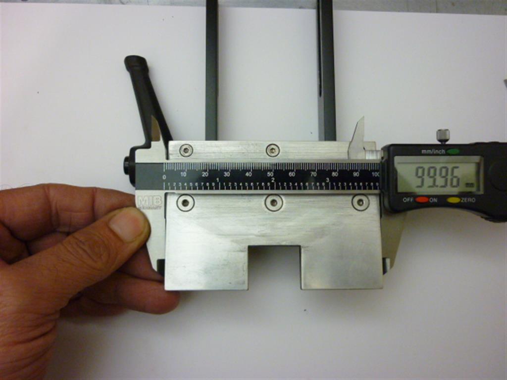

    Now, if anyone wants to make this 'tool rest', here are some pictures with measurements (is in metric system, but you can easily convert it in inches).
    I know that drawings would help a lot; unfortunately I don't have drawings, because I don’t know how to make them.
    Best wishes
    Dimitris
    Bench grinder tool rest-p1030439-medium-.jpg Bench grinder tool rest-p1030440-medium-.jpg Bench grinder tool rest-p1030441-medium-.jpg Bench grinder tool rest-p1030442-medium-.jpg Bench grinder tool rest-p1030443-medium-.jpg Bench grinder tool rest-p1030444-medium-.jpg Bench grinder tool rest-p1030445-medium-.jpg Bench grinder tool rest-p1030446-medium-.jpg Bench grinder tool rest-p1030447-medium-.jpg Bench grinder tool rest-p1030448-medium-.jpg Bench grinder tool rest-p1030449-medium-.jpg Bench grinder tool rest-p1030450-medium-.jpg Bench grinder tool rest-p1030451-medium-.jpg Bench grinder tool rest-p1030452-medium-.jpg Bench grinder tool rest-p1030453-medium-.jpg Bench grinder tool rest-p1030454-medium-.jpg Bench grinder tool rest-p1030455-medium-.jpg Bench grinder tool rest-p1030456-medium-.jpg Bench grinder tool rest-p1030457-medium-.jpg Bench grinder tool rest-p1030458-medium-.jpg
    Download plans for bench grinders.

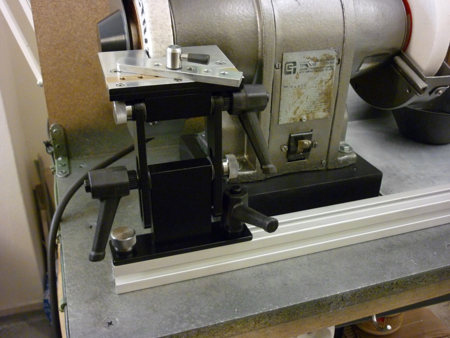

    Very nice! I have that Veritas grinder rest hadn't though of punting it on a track like that!

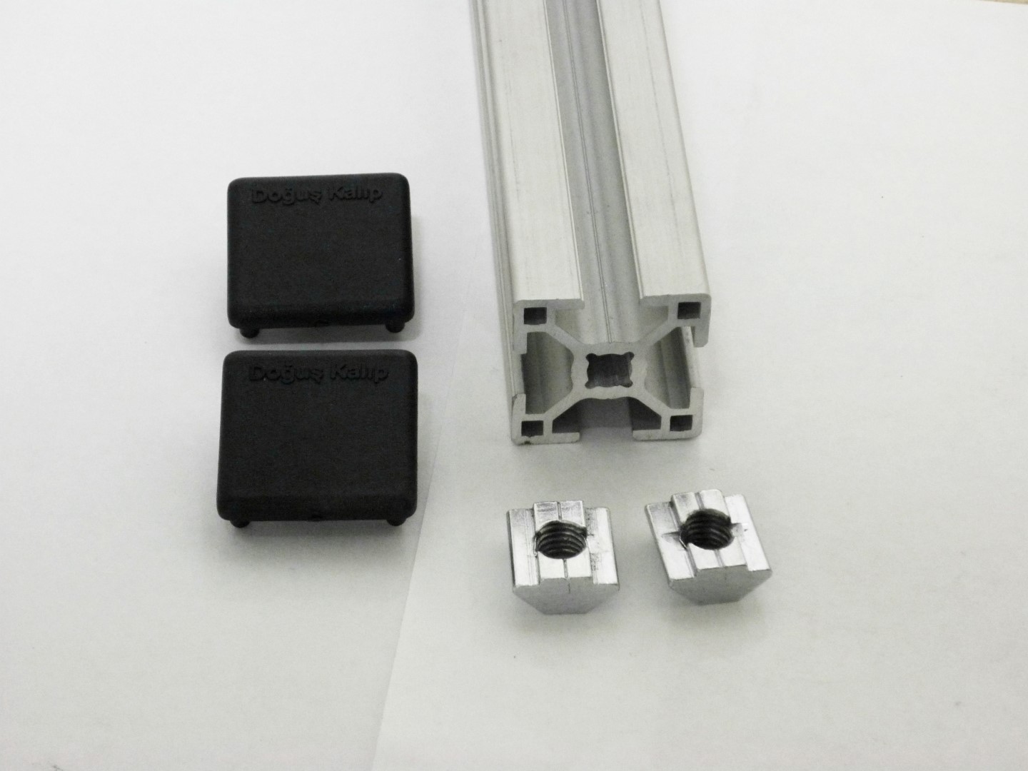

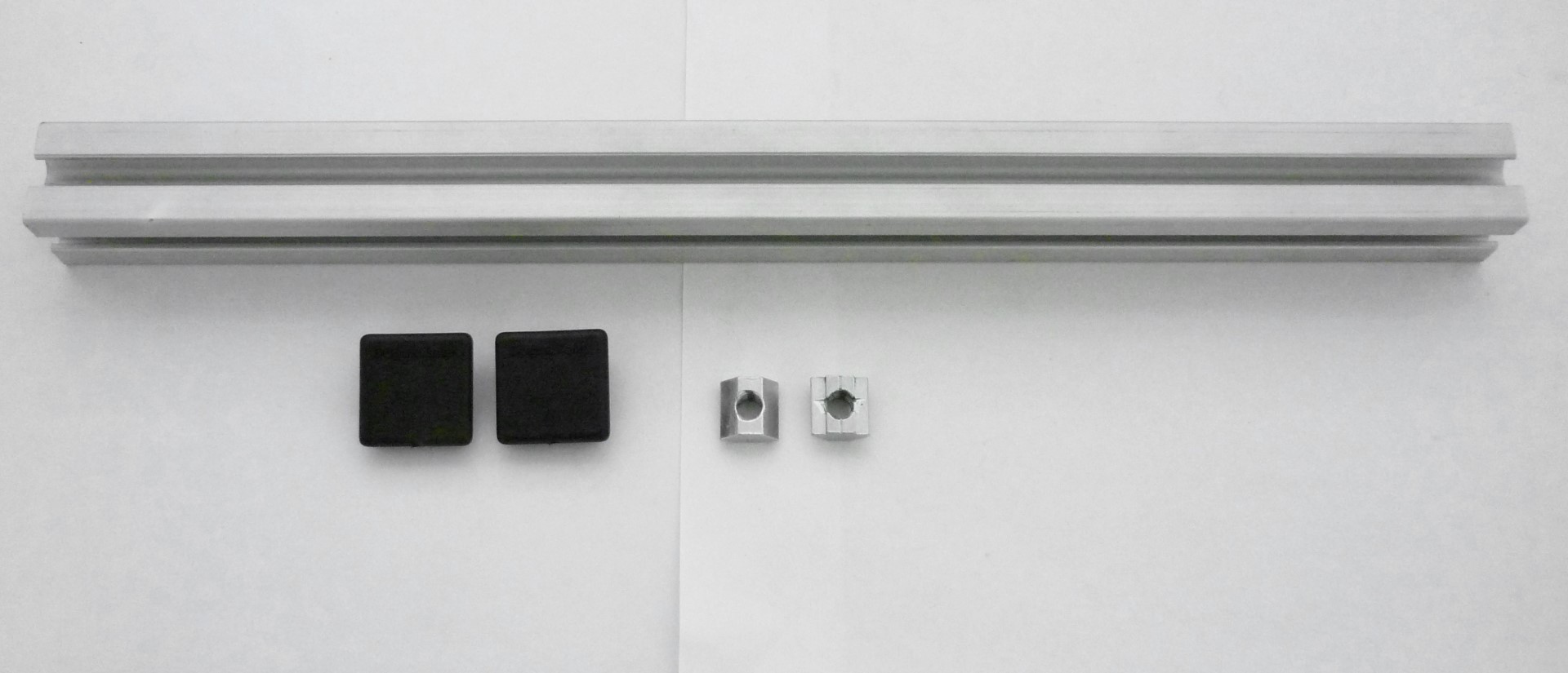

    Thanks Bruce! Initially I wasn't very sure about the aluminum rack and how stable could it be; its stability amazed me when I tested it, plus that I can move the tool rest from wheel to wheel very fast!
    All the best
    Dimitris
