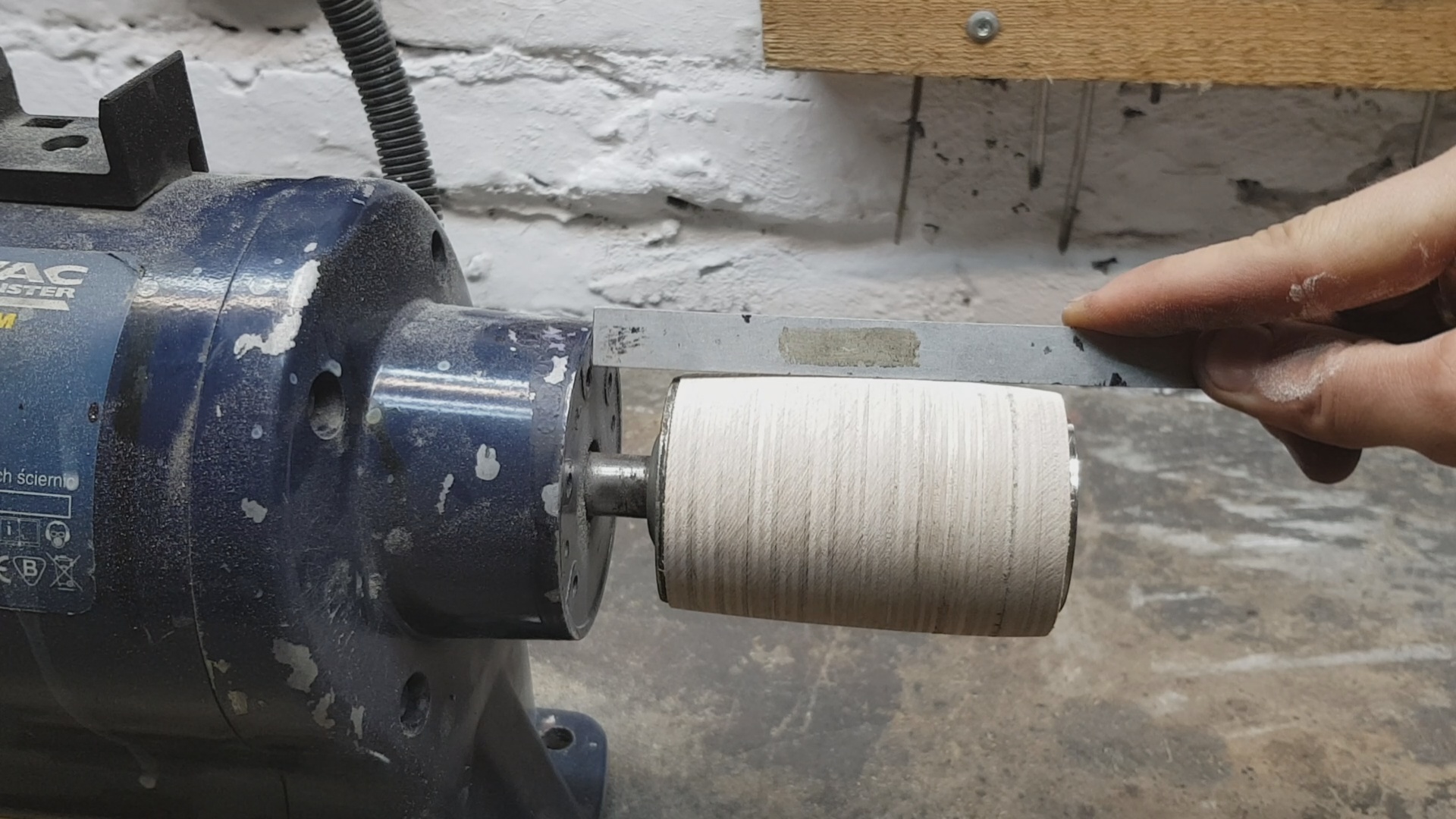

    And here came the idea to make a small belt grinder that I could move from the garage to the basement to grind wobbler bodies on winter evenings.
    For this purpose I used an old table grinder that does not sin with power but for processing small wooden elements it will be just right.

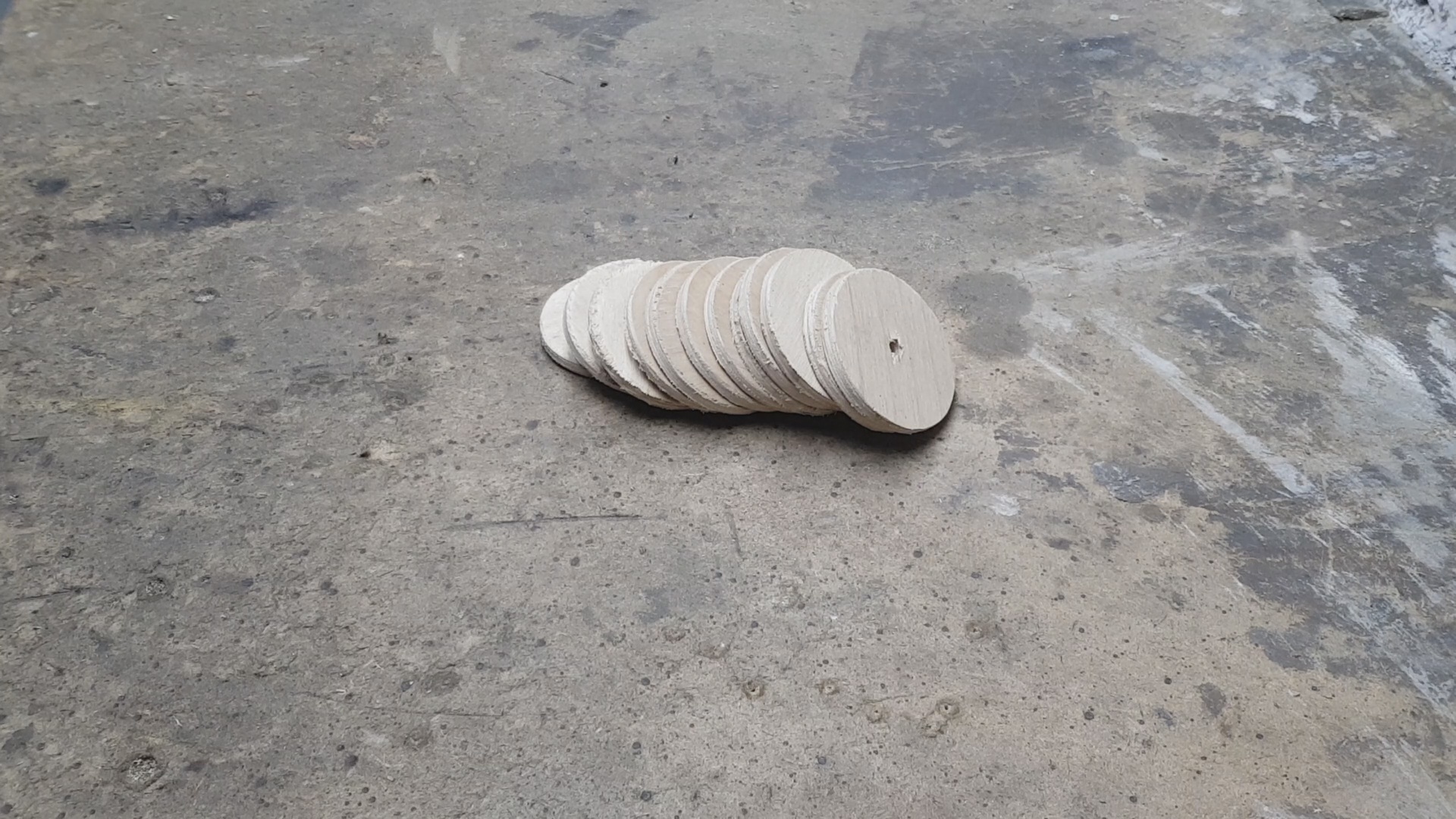

    I made the roller from several plywood wheels which I cut with a hole saw.

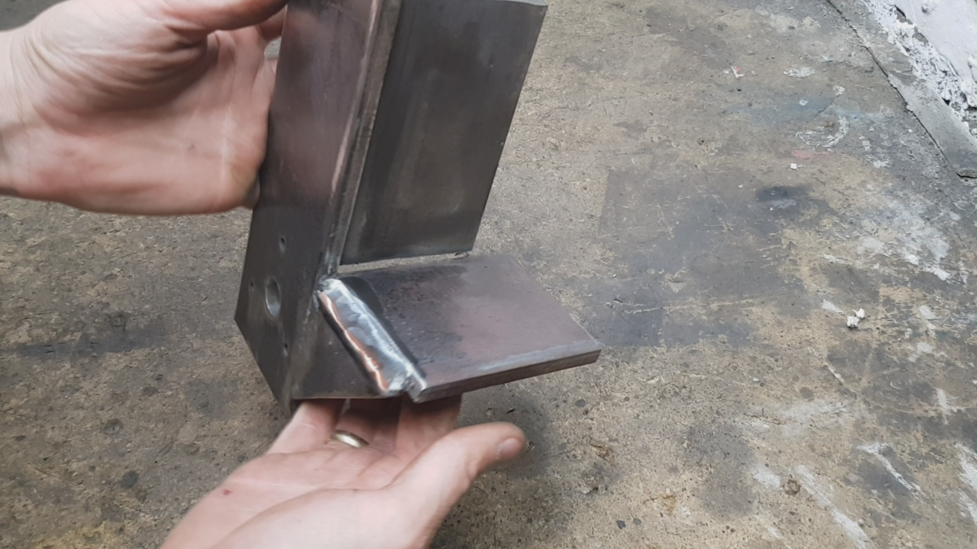

    The whole body was made of a flat bar 8mm thick.

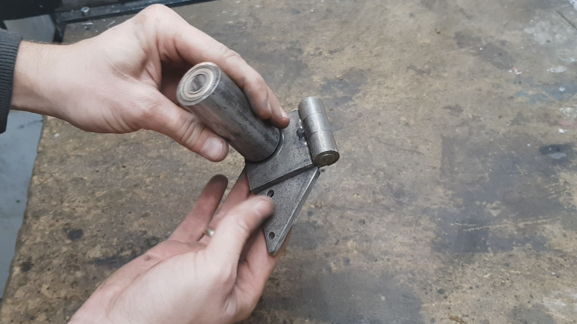

    The steering roller and tensioning belt is a piece of tube with two bearings.

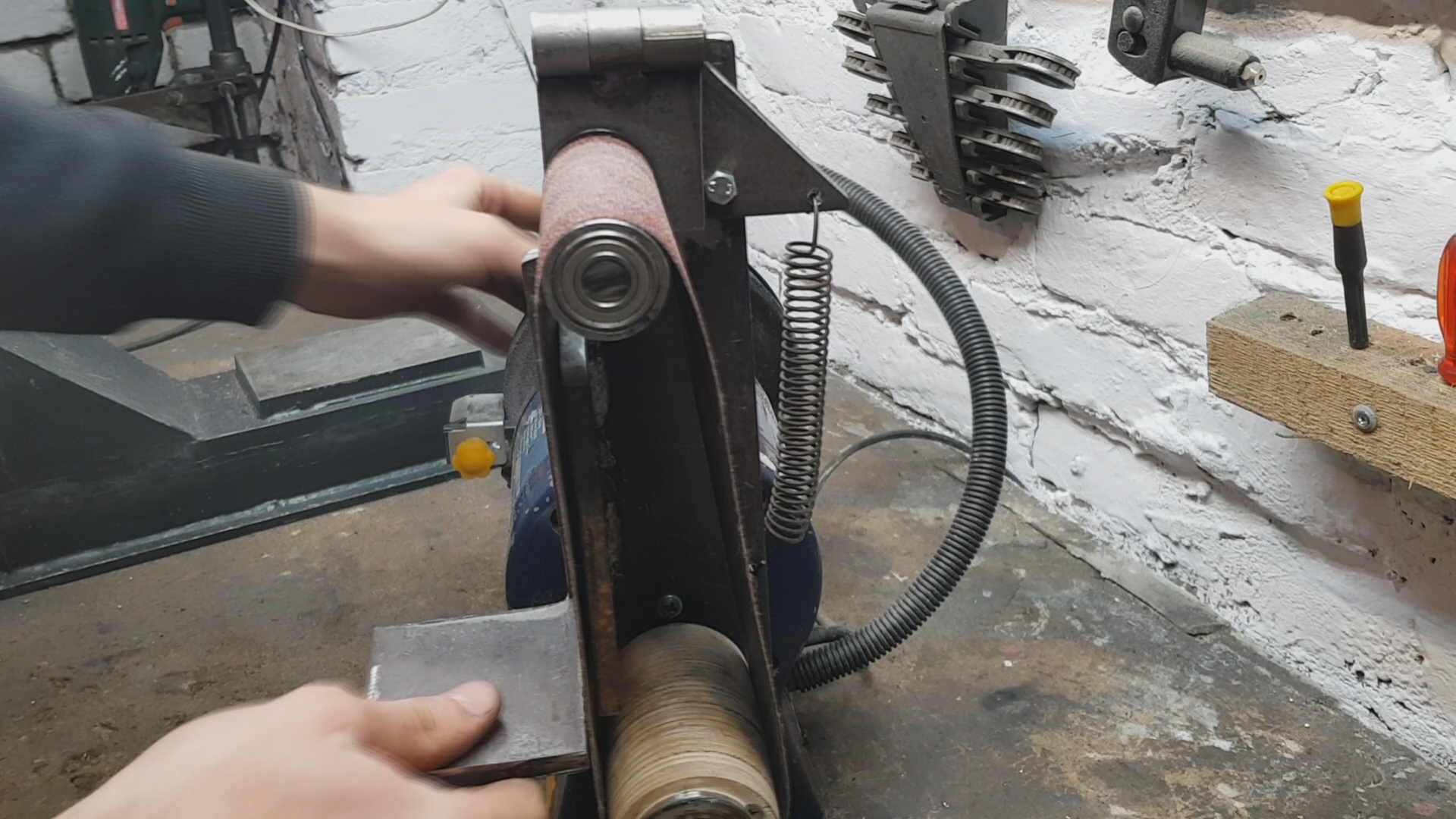

    The tension is a spring of unknown origin.
