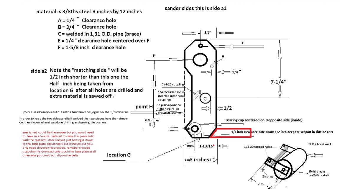

    D.O.M tubing is Drawn Over Mandrel there is no welded seam in it.

    o only covered one tube with rubber and i did that by finding a radiator hose the proper size and pressing it over the DOM tubing worked the bomb. i did not put a solid platen because all i use it for is removing mill scale from my tubes to facilitate good welds. but it would be easy enough to do.

    ok Steve i have sent you updated plans with some "NO Weld " suggestions.

    OK here are the specs. i hope this is clear enough but i will answer any questions as fast as i am able. this particualr copy has some info for those that do not have access to a welder.

    Quote Originally Posted by GlennR View Post
    Hardtail,
    Good job.
    Are the DOM tubes covered with a rubber cushion material or is the belt running on metal tubes? Also is there a solid platen behind the belt? I'm considering building a taller version running a 106" belt for wet sanding glass. It's good to see how you made yours. I like the simple belt adjustment you devised.
    Funny you should mention building taller I have been thinking of building one that accepts 6" by 72"belts as well. shouldn't be too difficult to make a super sized one. Let me know when you do it id love to see the result and i will do the same
