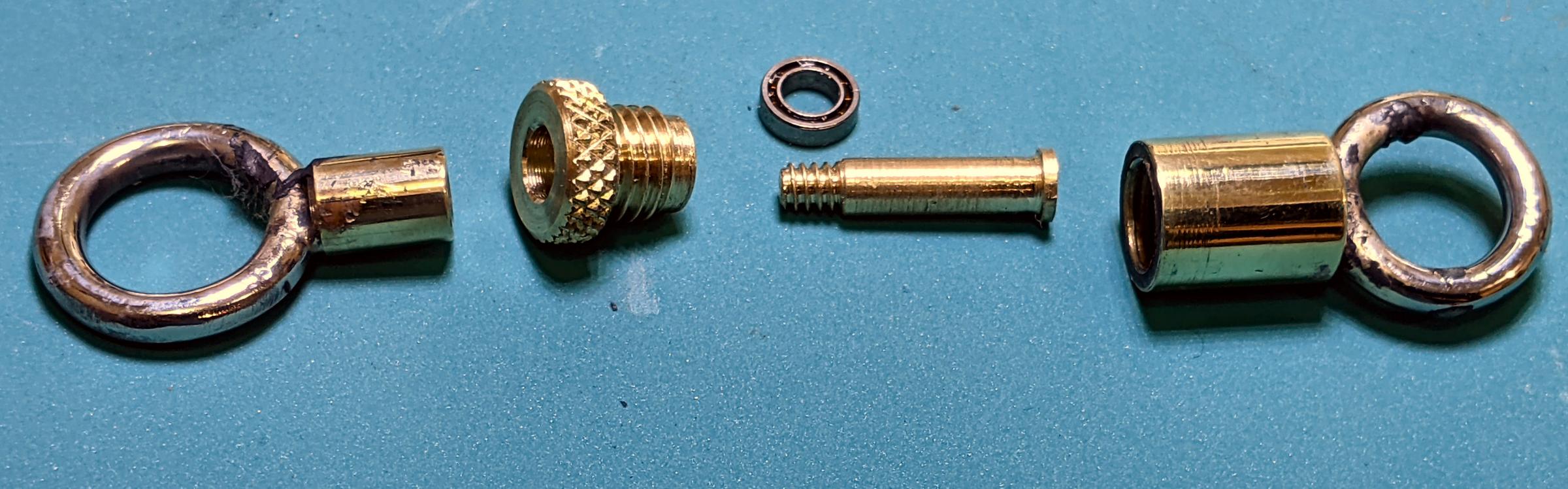

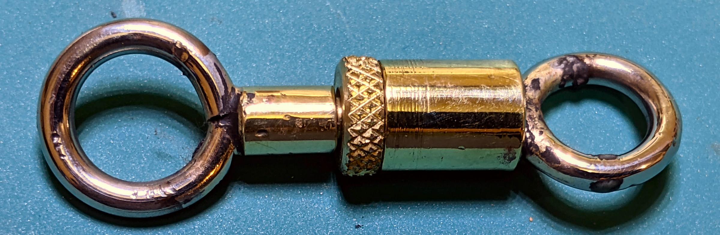

    I’ve added a bottom cross arm support to prevent strong wind from whipping the spinner into the mast, so there are bearings in tension at top and bottom.
    The mildest zephyr is enough to get it going if the bearings are in good condition. As bought, it used fishing swivels at top and bottom. They claim to be ball bearing, but the balls must be the size of ant testicles. They worked OK for a little while but they don’t last long.
    I replaced them with big salt water fishing swivels. Those lasted a little longer but not much. Nobody expects terminal tackle (hooks, sinkers, swivels, leaders, etc) to have longevity.
    I found some stainless steel ball bearings on EBay, 4mm ID x 7mm OD x 2mm high, ten for 12 bux or something like that. I made one brass housing last fall. Made the other today. Need two, one at top and one at bottom.
    The rings on the ends are made of 1/8” dia stainless steel welding rod. There are some tool marks because that stuff is not exactly eagerly compliant for bending. The black stuff is brazing flux that I didn’t get completely removed. I think boiling water would remove it or I could bead blast it off, but It won’t hurt anything.
    If/when the bearings fail, I have 8 more on hand and it’s easy to disassemble the brass housing, replace the bearing and reassemble.
