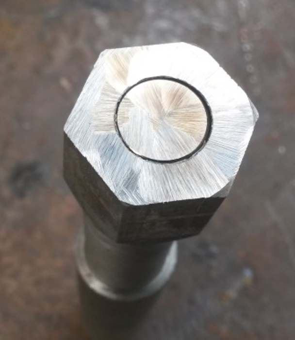

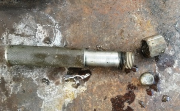

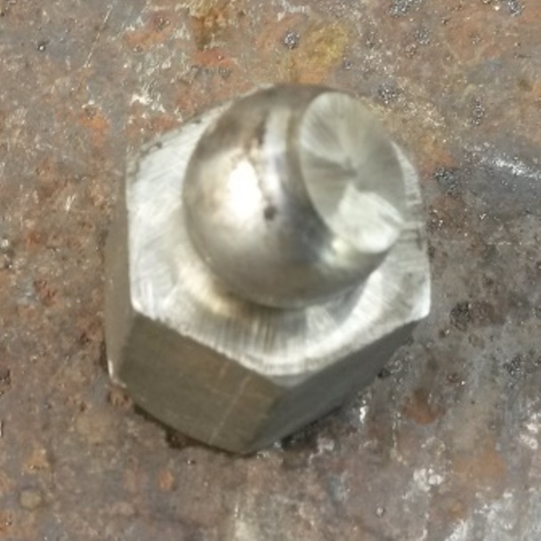

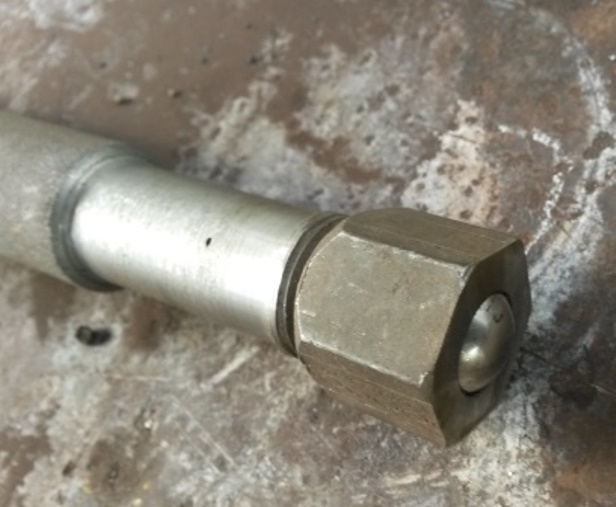

    The other day Toolmaker 51 posted http://www.homemadetools.net/forum/s...lamp-pad-60092
    He mentioned about holding the ball to grind it by what ever means you come up with.. So I thought that is someone was wanting to make one of those tools it would help them to see an easy and safe way to hold the bearing ball.
    I started out with a hydraulic compression fitting and nut. At first I was just going to clamp that in a pair of locking pliers but decided why not make it into a real tool SO I machined off part of the fitting and machined a handle then welded them together But while doing this after I was nearly finished I said to my self this wold have been a whole lot simpler to have counterbored the handle then threaded it to fit the nut DUH!
    bearing ball holder-20170409_165832aa.jpg bearing ball holder-20170409_165031a.jpg bearing ball holder-20170409_165419aa.jpg bearing ball holder-20170409_165647aa.jpg
    bearing ball holder-20170409_165711aa.jpg bearing ball holder-20170409_165508aa.jpg
    I am horrible at knurling but put just a slight knurl on the handle for better grip

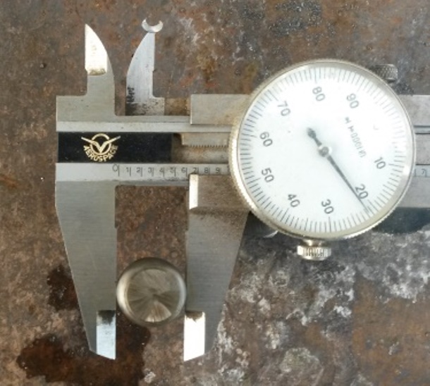

    Why would one want to grind a flat on a bearing ball I,m intested to know.
    Grandpa_Gop
    5,338
    7,048
    Quote Originally Posted by Grandpa_Gop View Post
    Why would one want to grind a flat on a bearing ball...Grandpa_Gop
    is interested and asked;
    Well, Frank S references the http://www.homemadetools.net/forum/s...lamp-pad-60092 I posted a couple days ago. The flat, one of a pair, position themselves to transmit more direct clamping pressure. This was his solution to flat the ball securely in more compact tooling than a collet or standard chuck. Then a disk or belt sander can be used instead of surface grinder.
