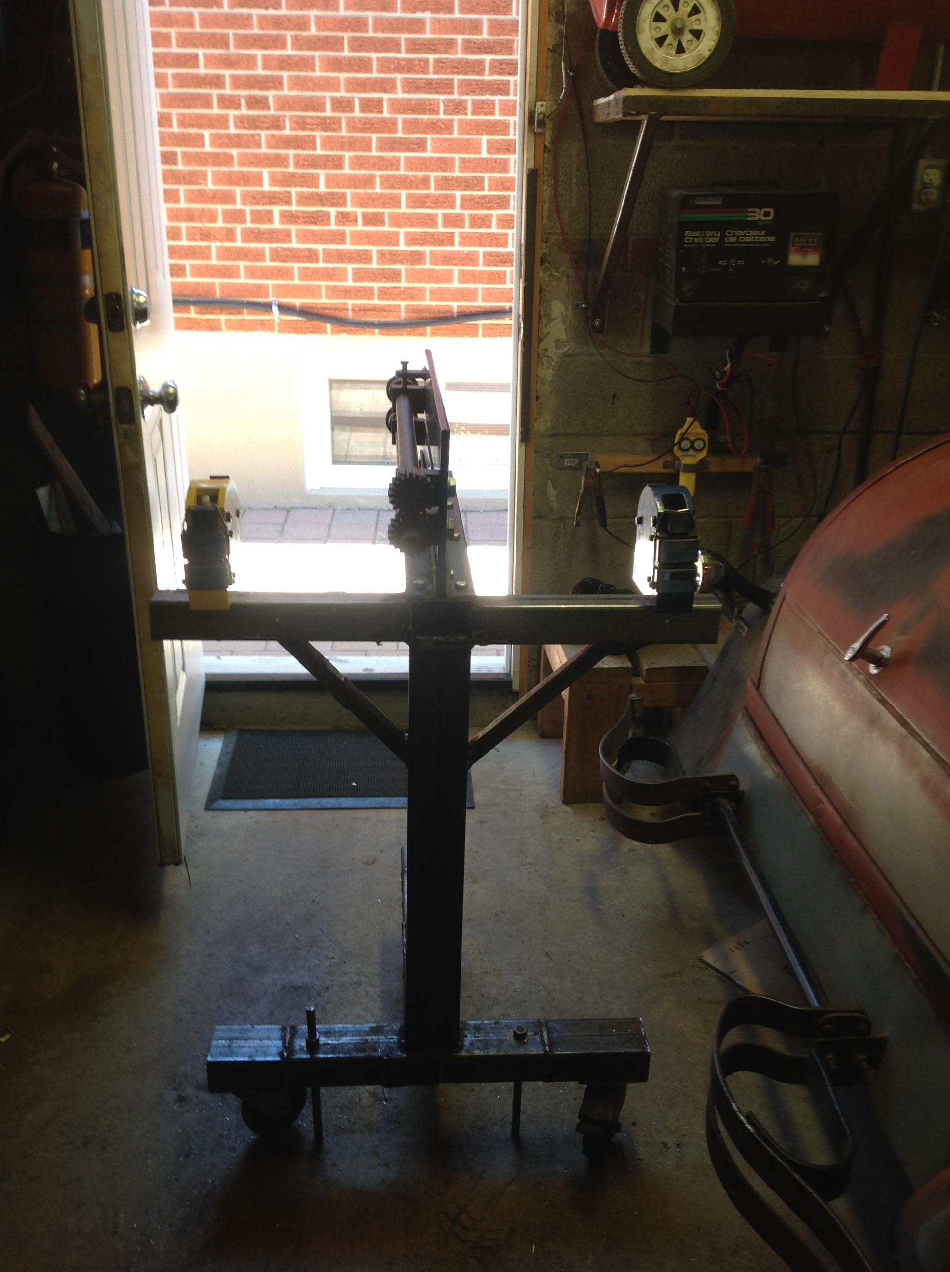

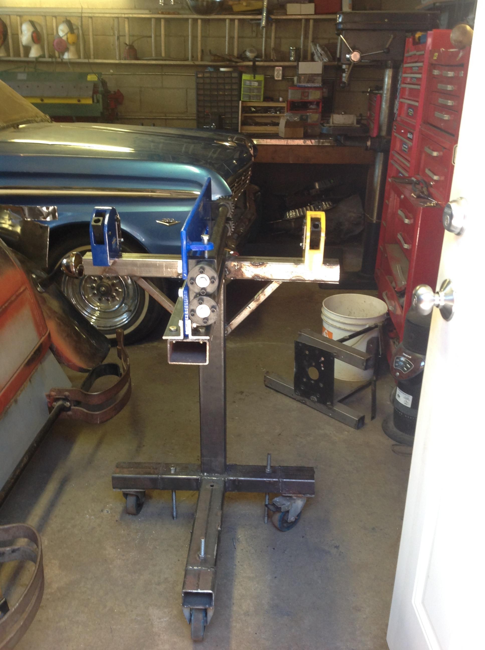

    Hi everyone,
    I am building a bead roller stand and want to motorized it here are a few pictures .
    Dennis

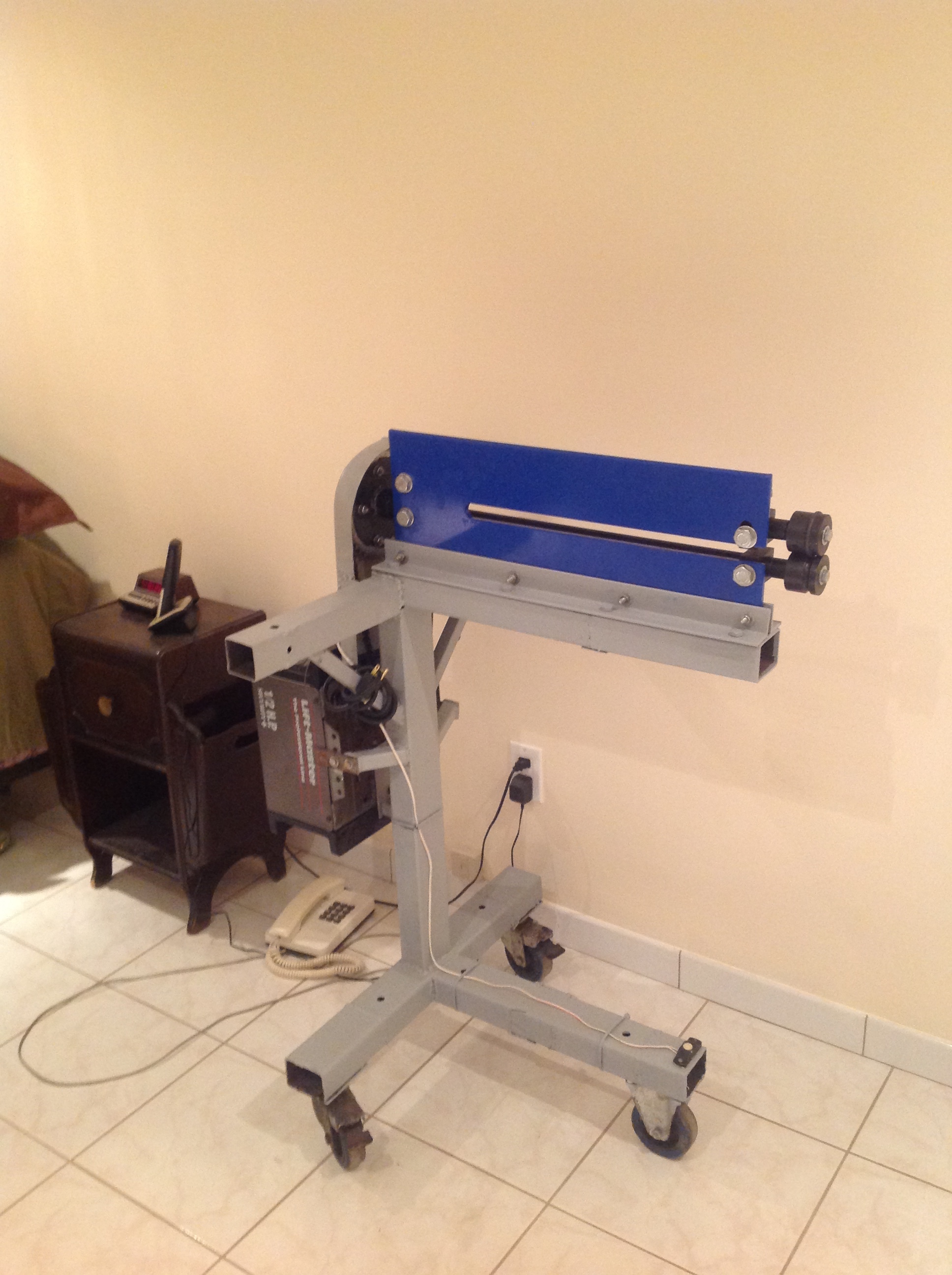

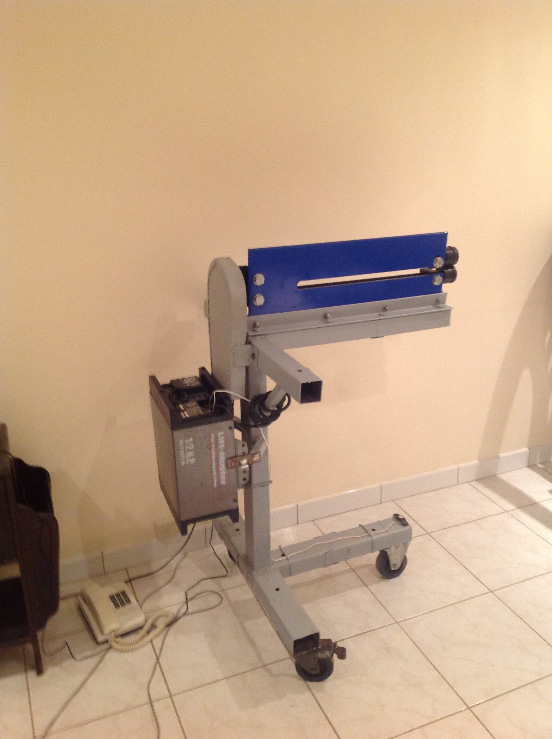

    Motorized bead roller......
    Hi everyone iv'e finished the motorized bead roller stand.
    Useing a garage door opener , and also a bicycle sprocket, as well as a door bell button for the control on my foot.
    Dennis
    Attached Thumbnails Attached Thumbnails Bead roller stand-img_2444.jpg   Bead roller stand-img_2445.jpg

    Sweet design and engineering.

    Really good looking result. Also very handy system in use. I like it.

    I really like a powered bead roller since it turns an otherwise 2 person operation into a 1 person task.
    Having the locking casters on 2 of the wheels also helps to keep the machine in place. Nothing is more aggravating that having to chase a machine all over the shop while trying to use it
    Good job.
