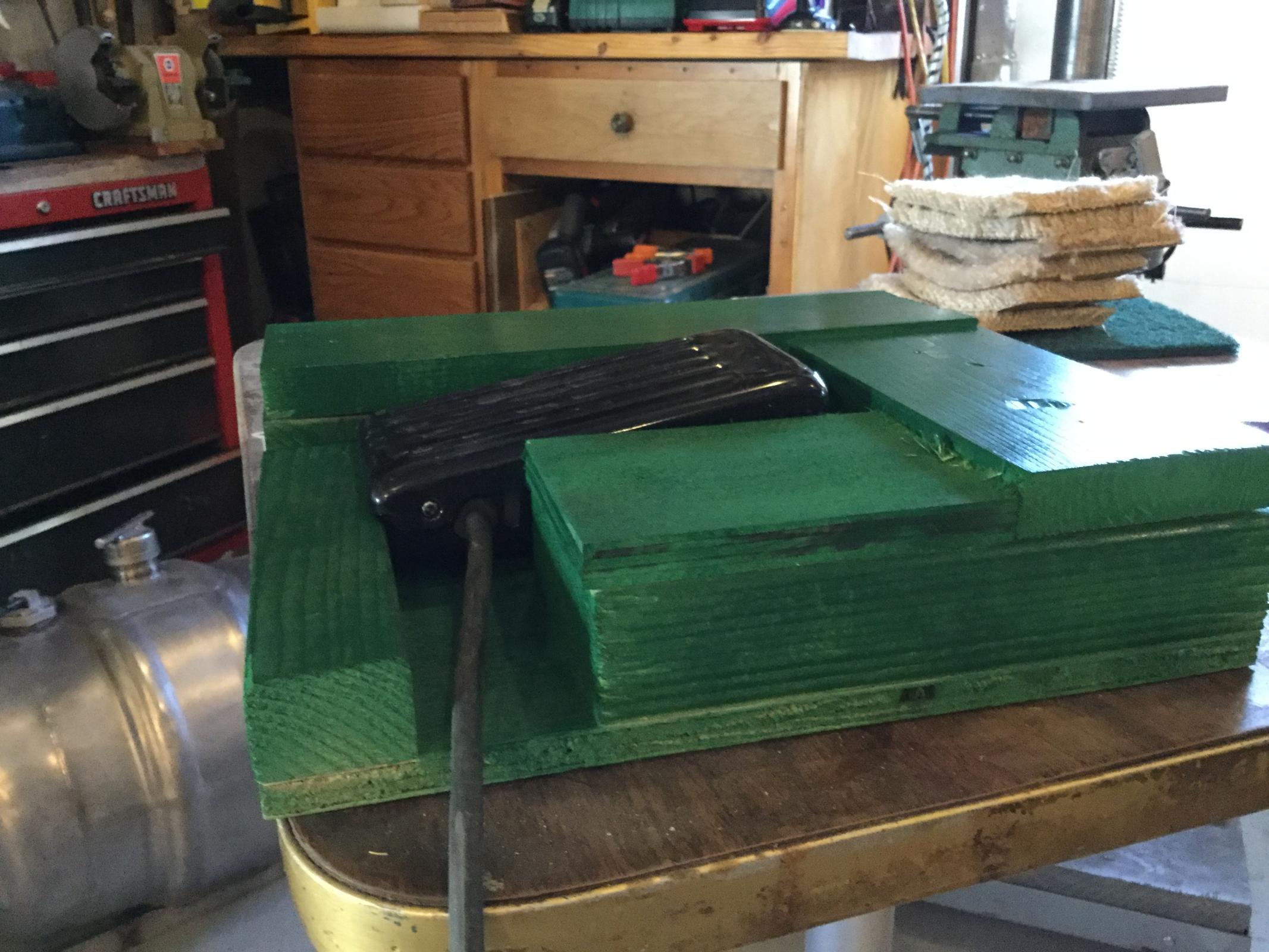

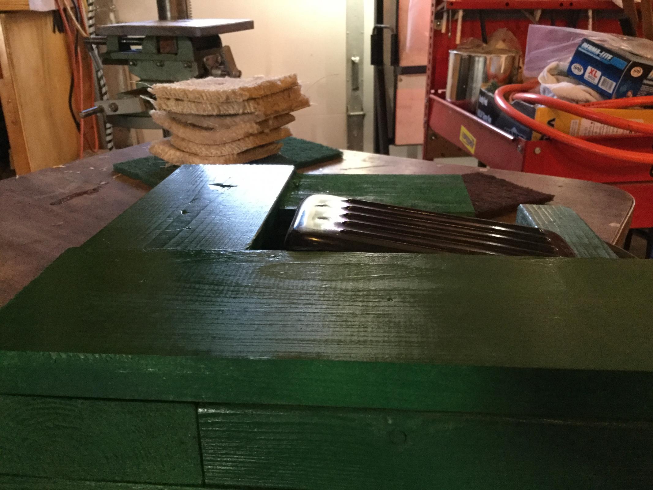

    I have the usual sewing machine foot pedal speed controller for my bead roller. I was unable to accurately control the speed. I built a square plywood pad and mounted the pedal on it. On each side I put varied thickness’s of blocks. Depending on speed needed is where I put my foot
    Bead roller speed controller-183e223c-b043-4ad6-a8f5-396a2b2a7642.jpgClick image for larger version.
    Cheap, simple and it works!

    Old fashioned me would have a stop-screw; fiddly and too-fine adjustments. Curte's solution is far better.

    I like things that I don't have to fiddle with to accomplish what I need done. I wouldn't have thought of a multi tiered wood block solution in a million years

    Very clever. I'm guessing that the guy has a lathe with a rotating, multi-pin carriage stop and it inspired him to this design.
    I've done something similar for production drilling of holes to several depths. Set the drill press depth stop for the deepest hole and make a couple of spacer blocks for the shallower holes. Stick one of the blocks between the stop and its seat when drilling the shallower holes.
    A more elegant form of the "blocks" is cylinders cut to length and a half-diameter slot down the axis, said slot to fit over the threaded rod of the depth stop. Self-orients and stays in place better than a rectangular block. Once made, save the blocks; they can be useful elsewhere.

    Nice simple design for a nonlinear device. To figure the speeds for various operations on a bead roller probably took some time to figure the heights for positions but ultimately brings it to a simple repeatable process. Nicely done, curte!
