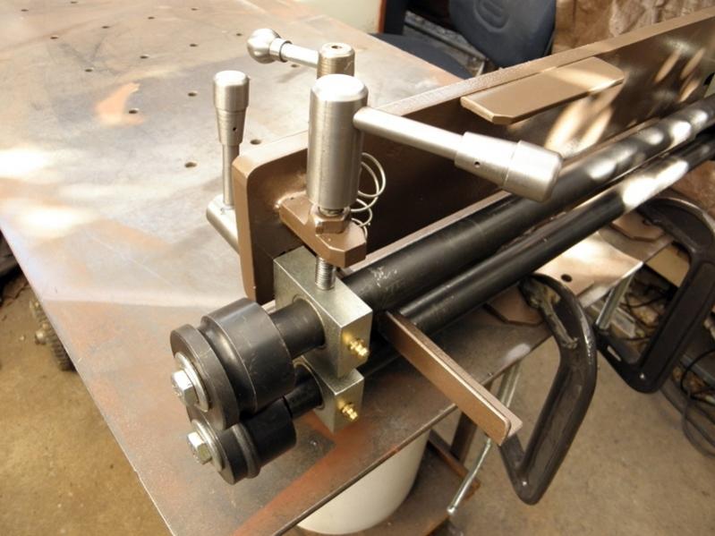

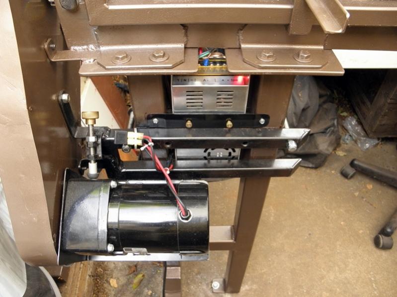

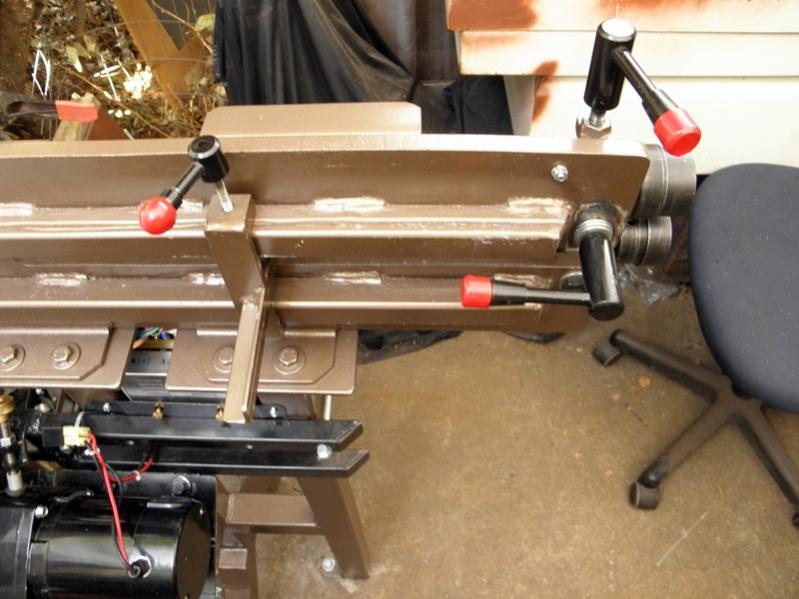

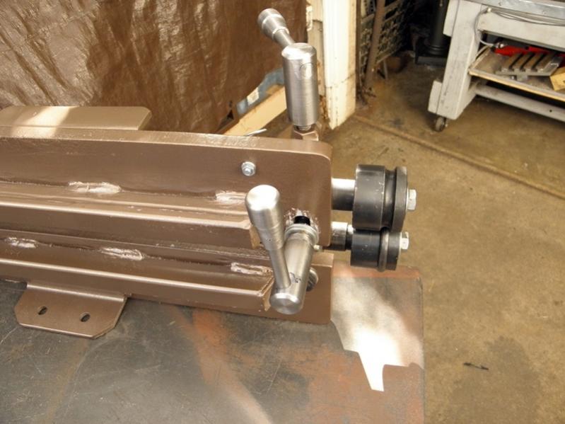

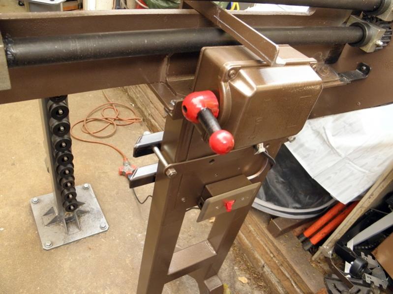

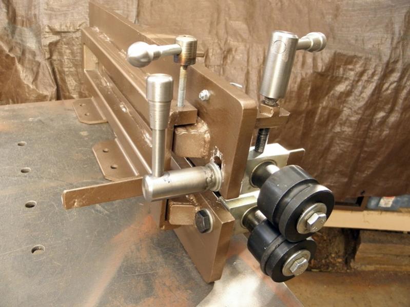

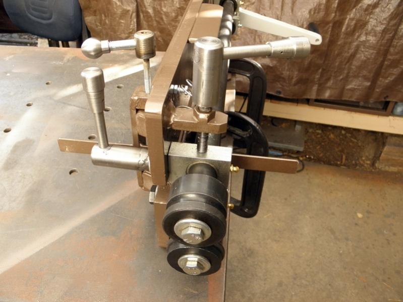

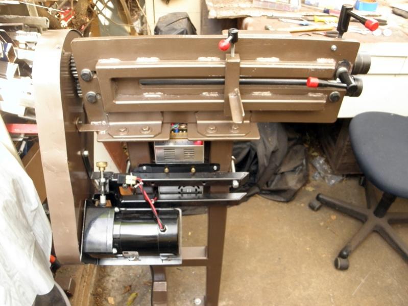

    This is a Woodward Bead Roller that I have Modified to include 1" tubing for support on plate steel body back side,
    Moveable shafts for custom dies, three machined handles, spring return on upper die shaft, angle iron mounting brackets , fence, paint job and upper mount for switches, potentiometer on top which will come in a few weeks after I motorize this unit.

    Wow, that's a rework, not just mods!
