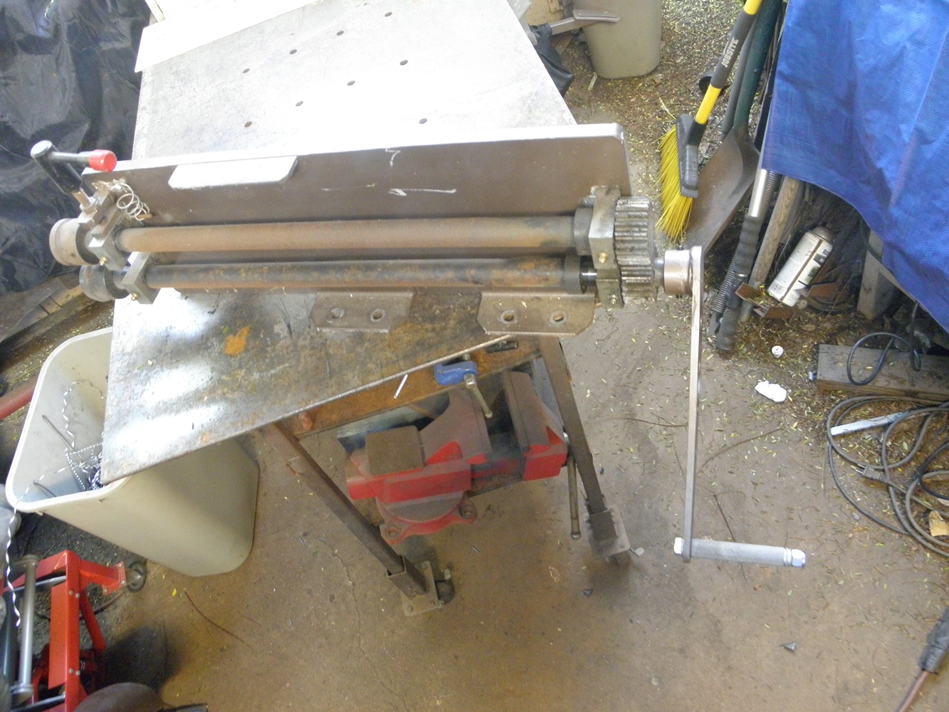

    Bead Roller Handle Replacement

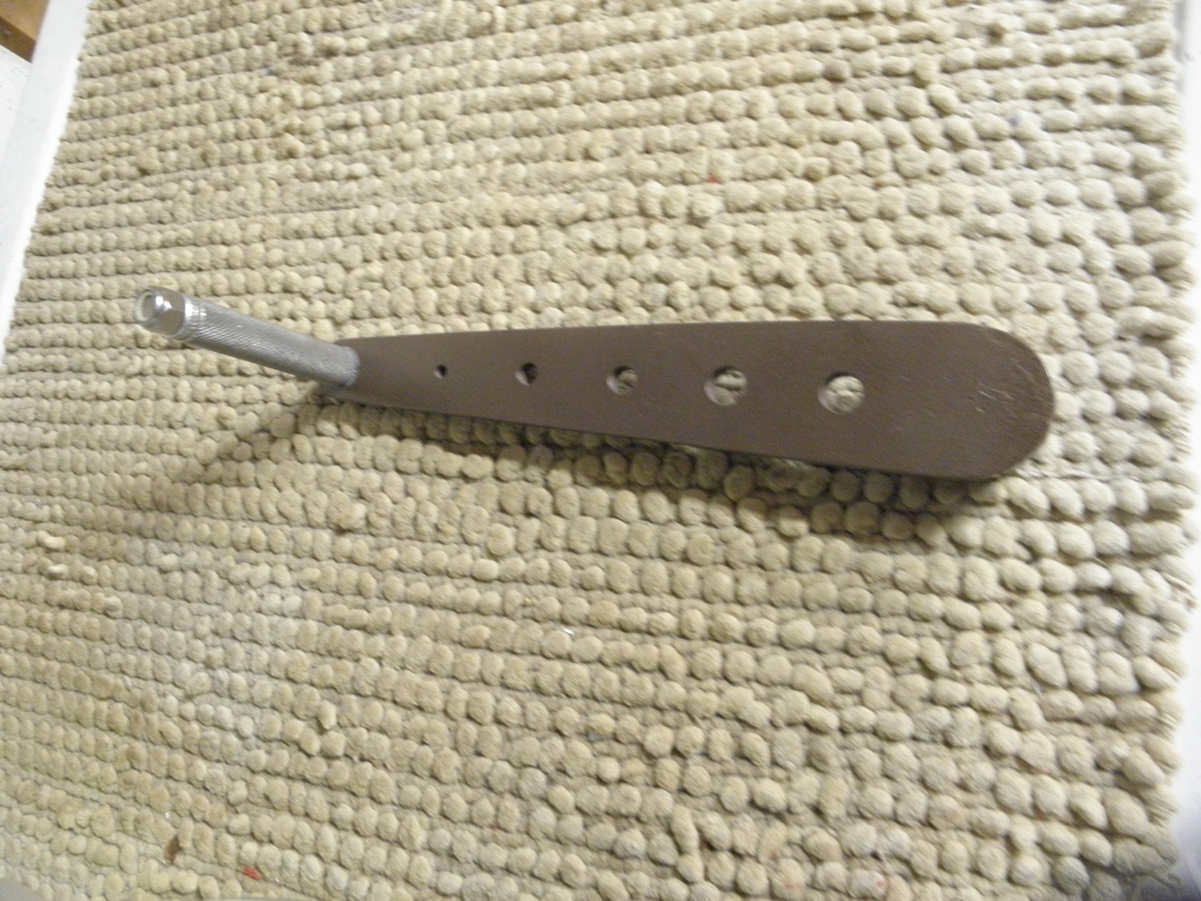

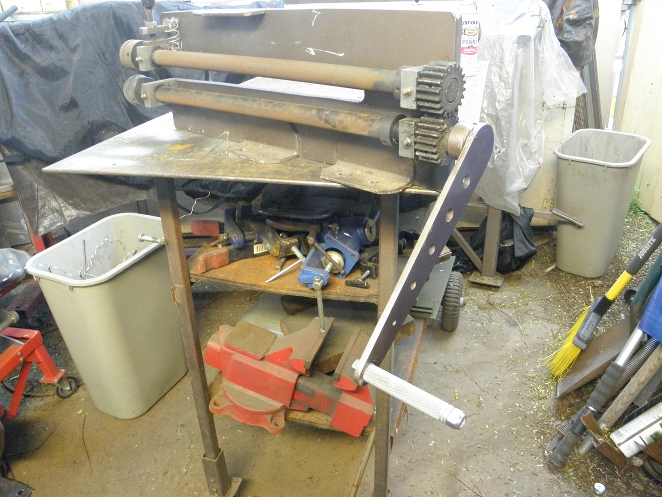

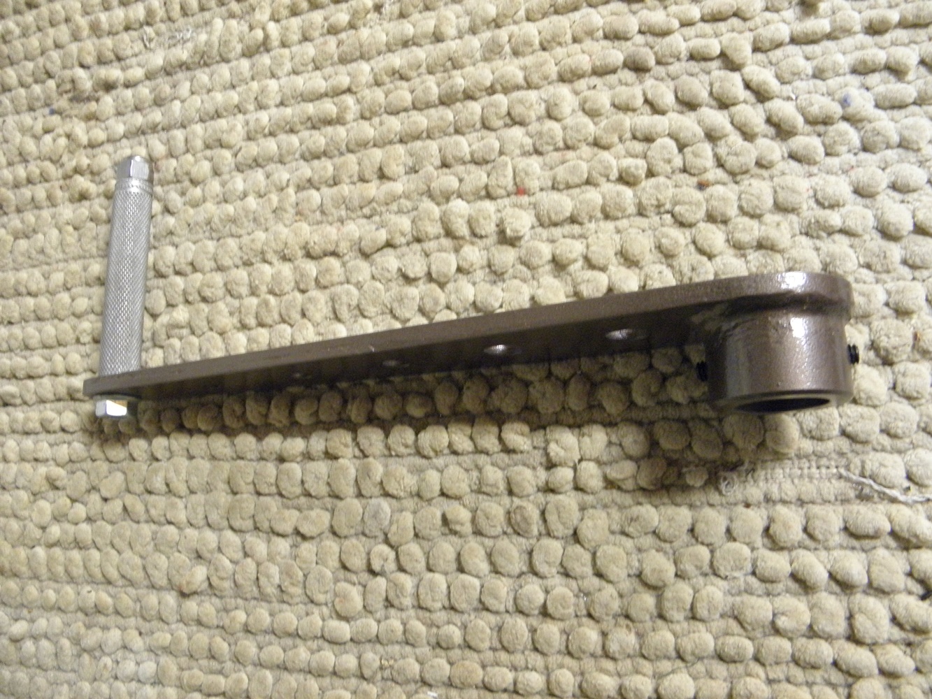

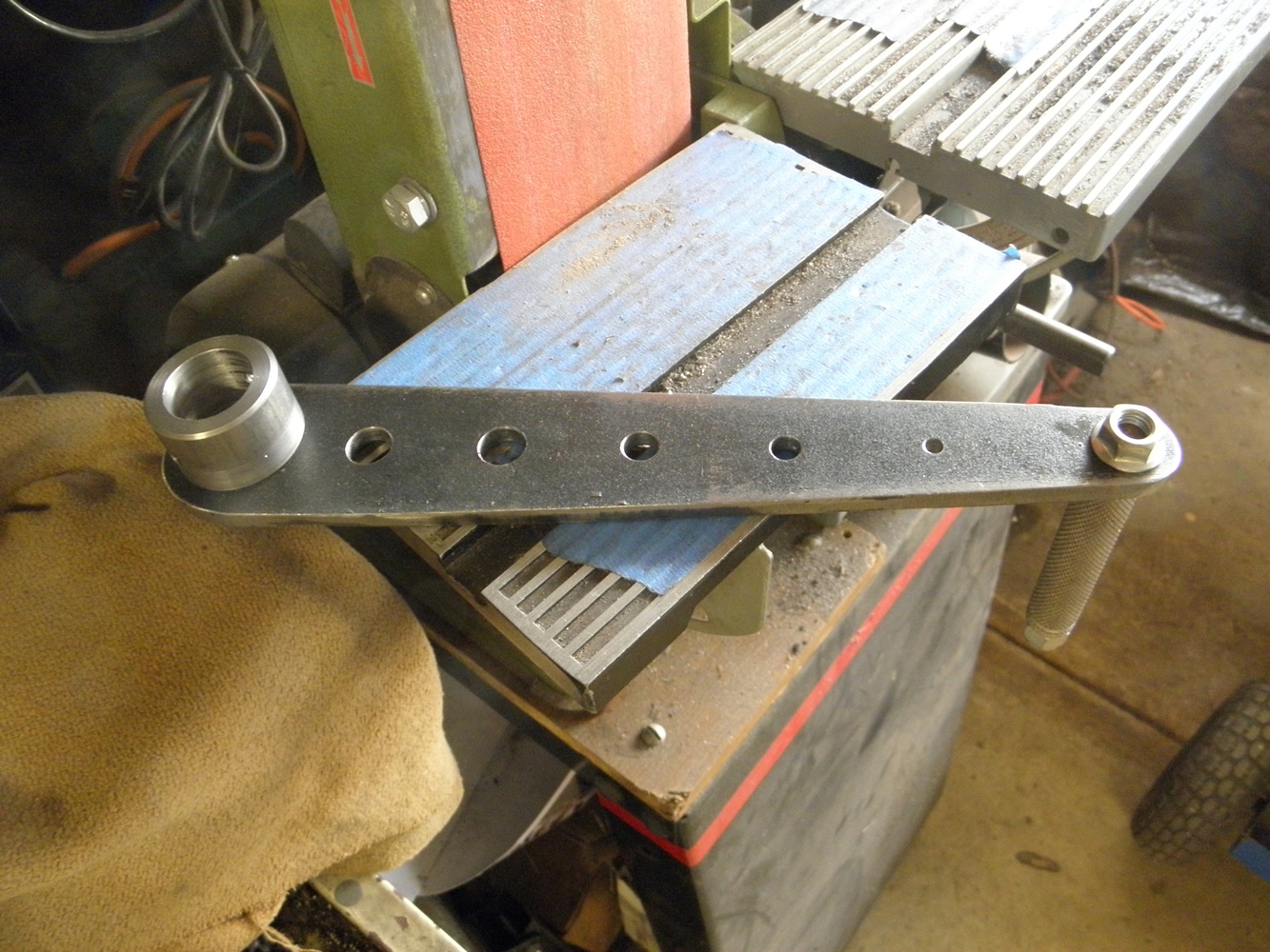

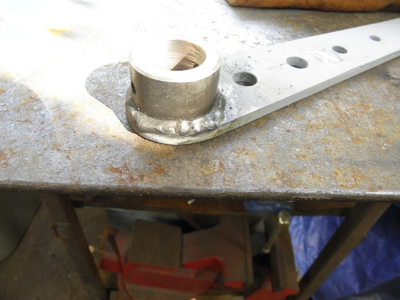

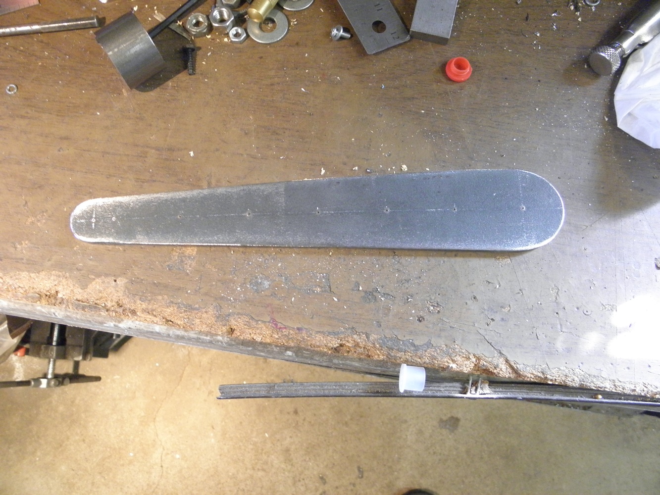

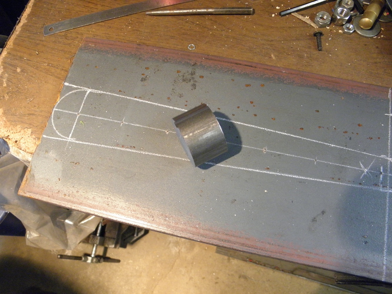

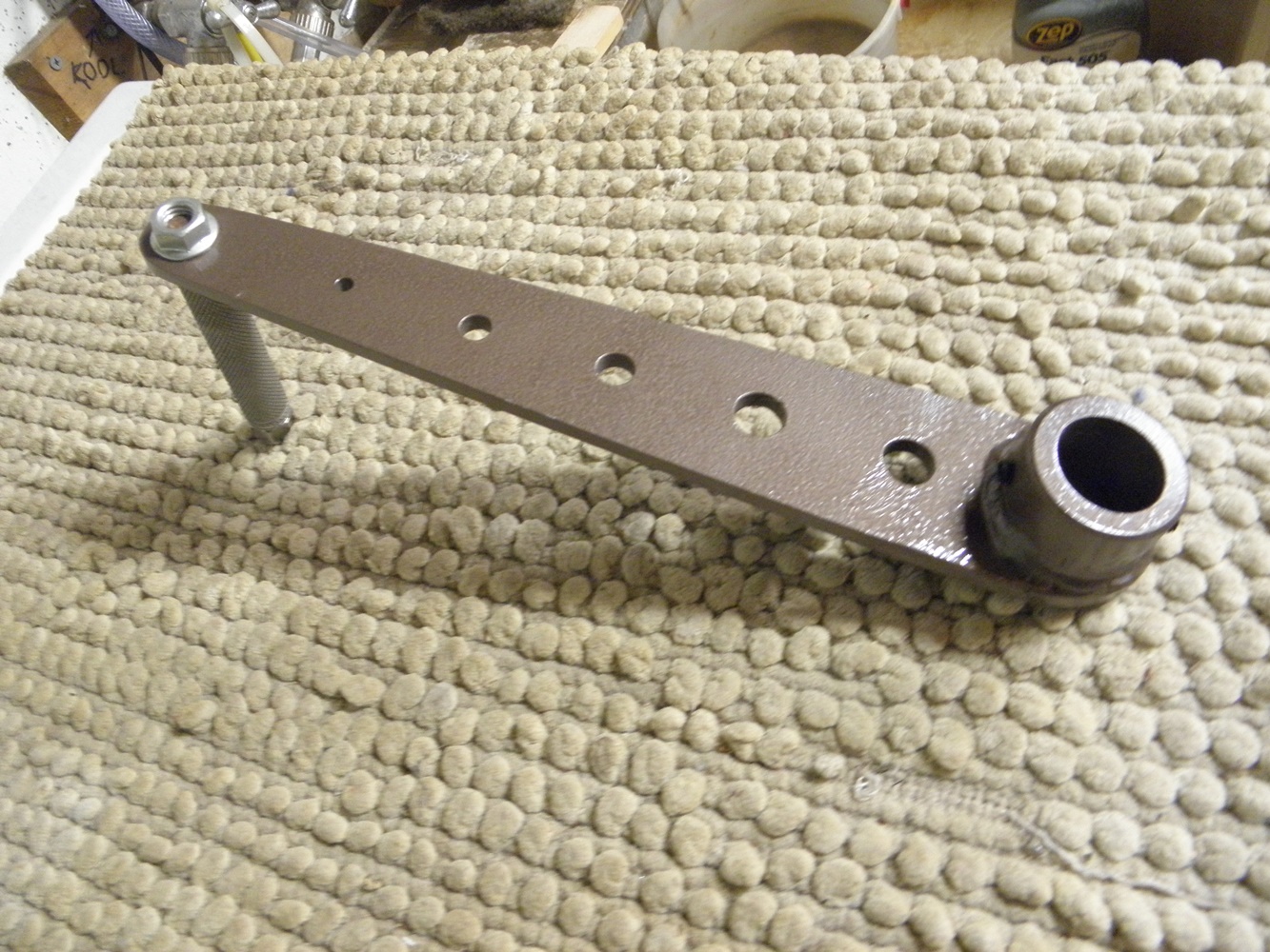

    Bead Roller Handle Replacement. Made from 1/4 inch Steel plate ,1/2" Aluminum round,1 1/2 steel round. bar stock cut with plasma cutter. Yes that's right and I am still vertical FYI. Ha Ha...
