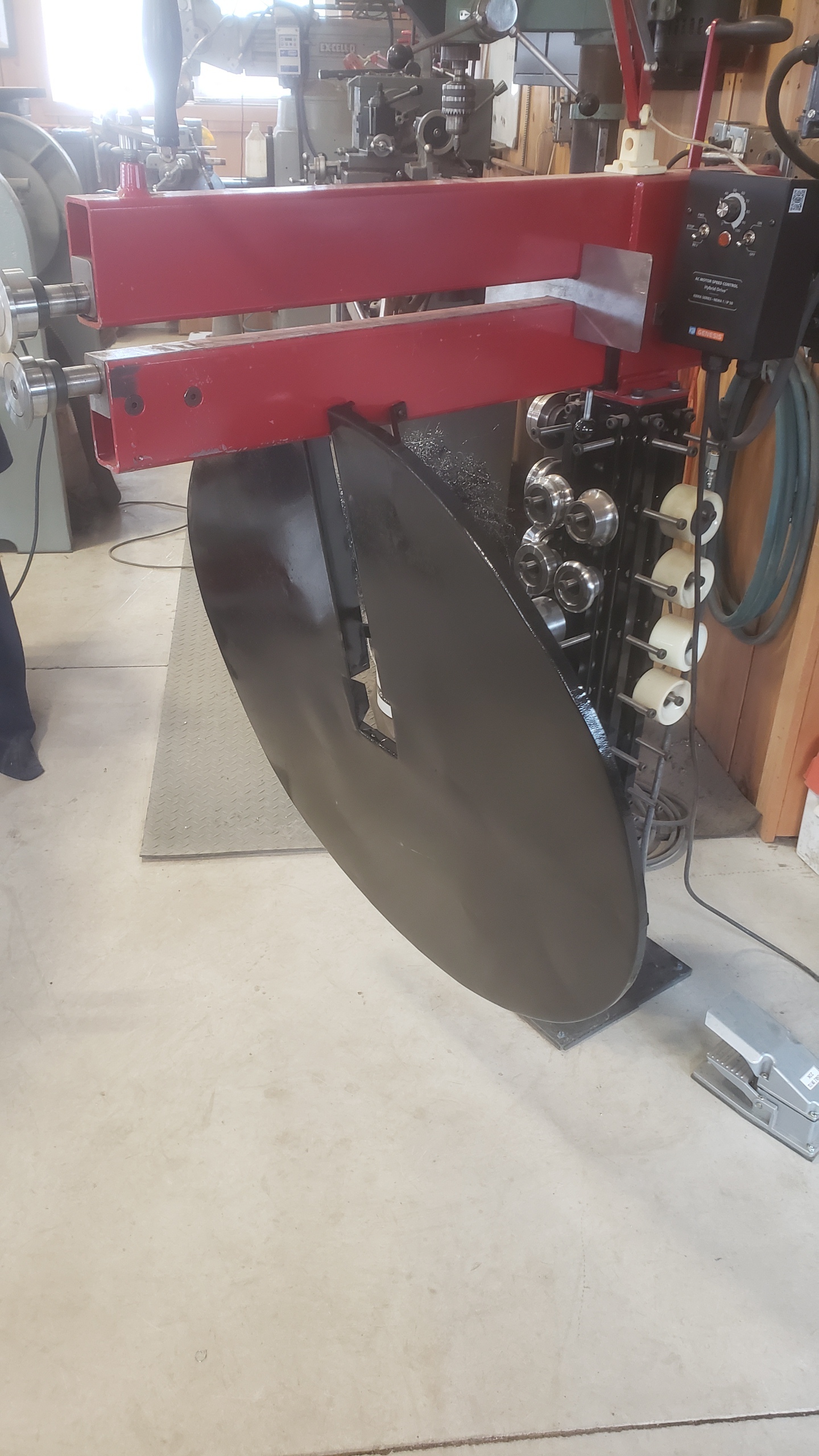

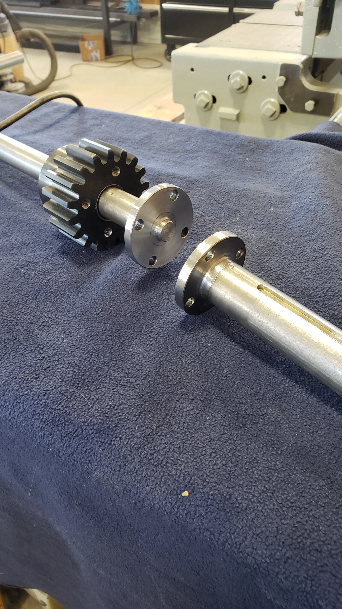

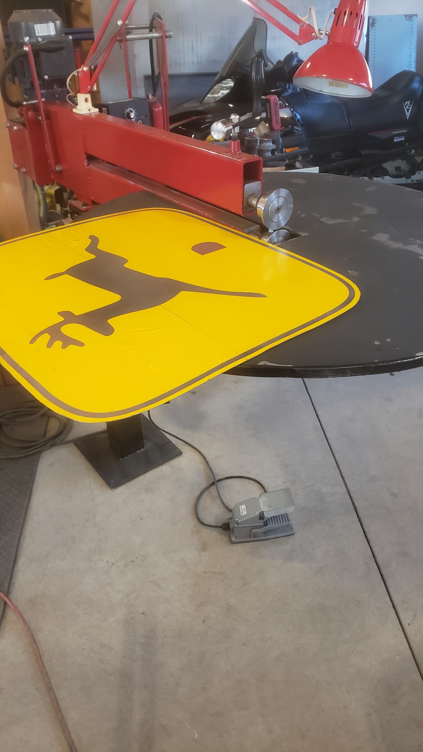

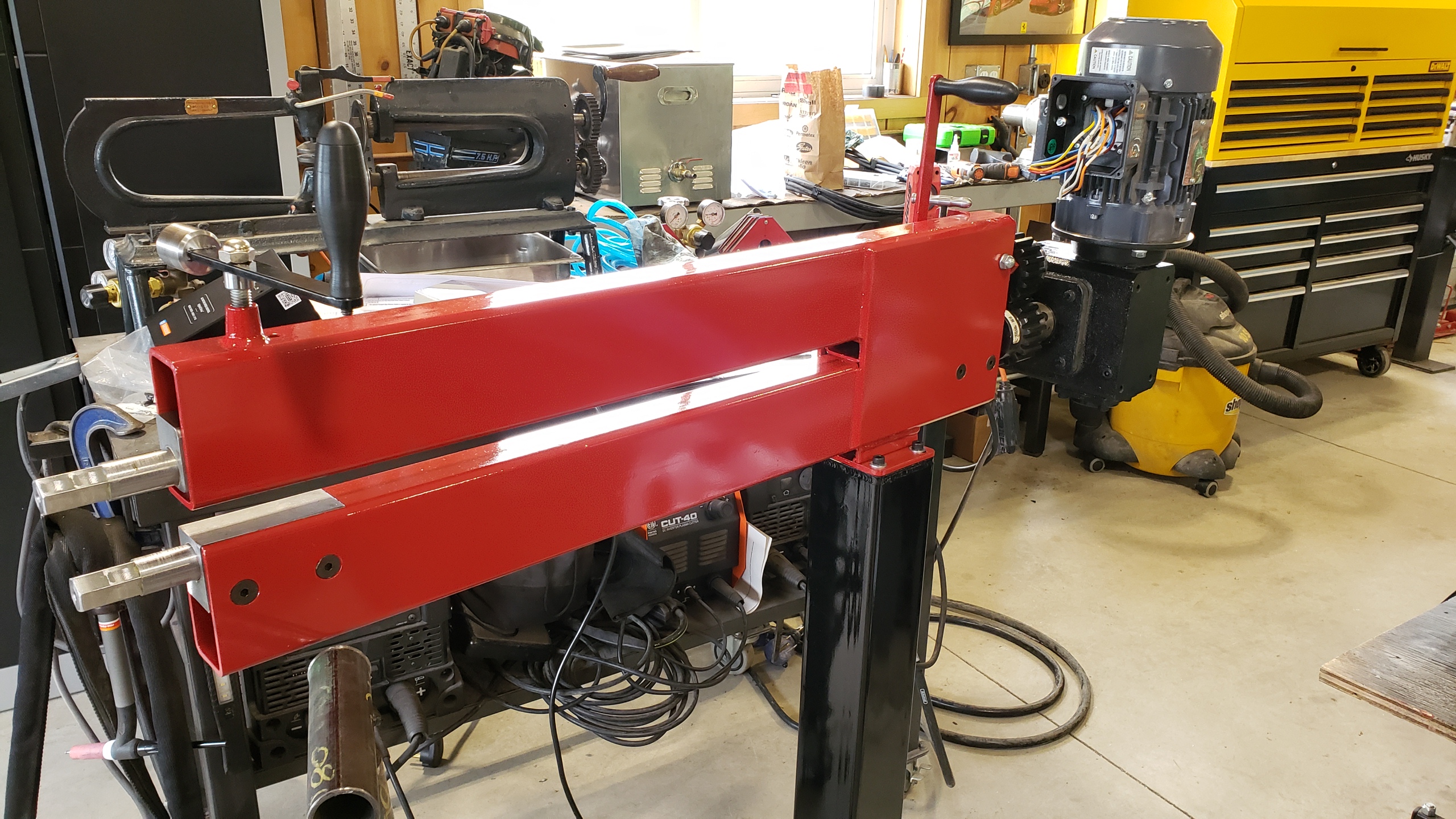

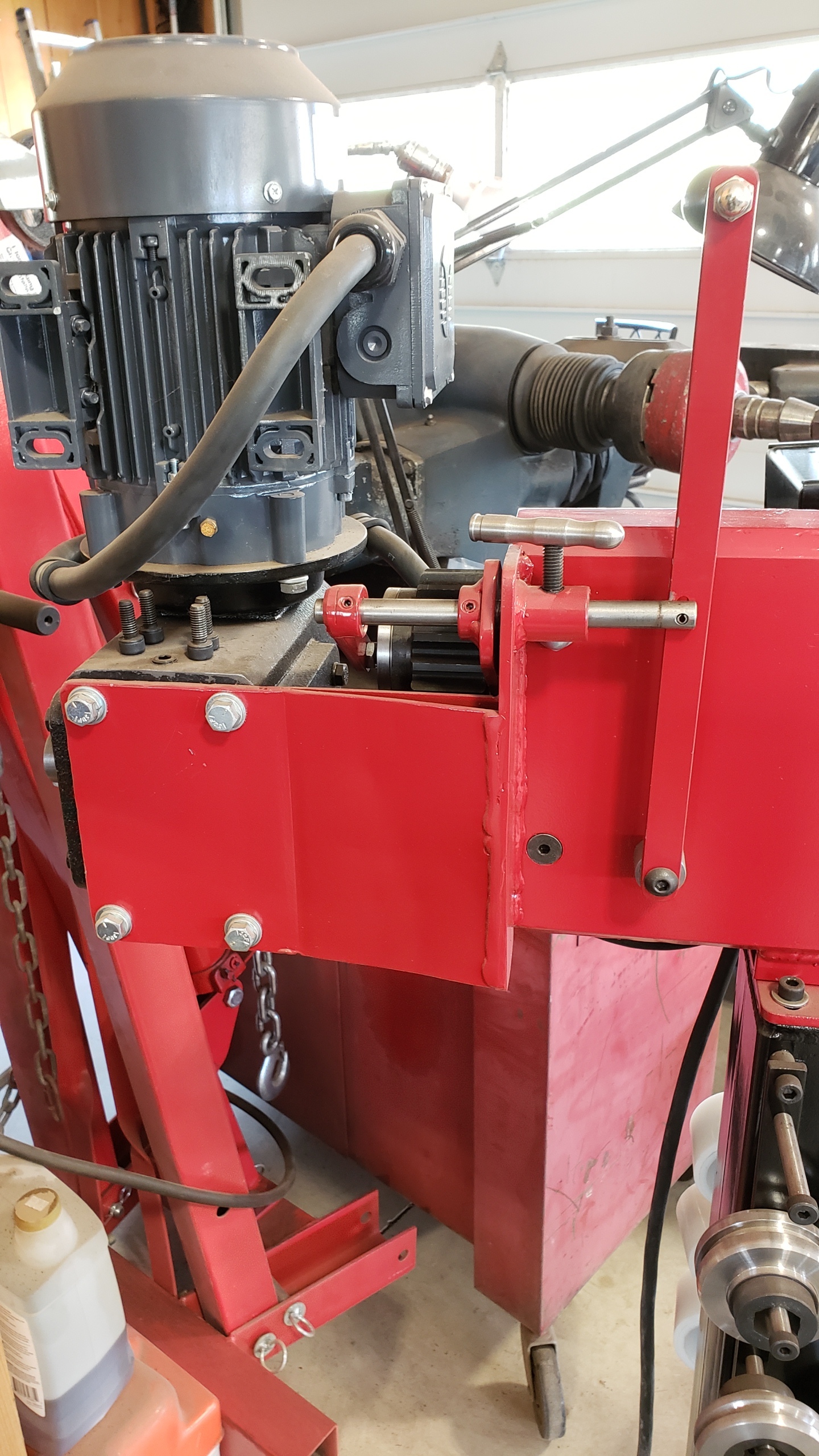

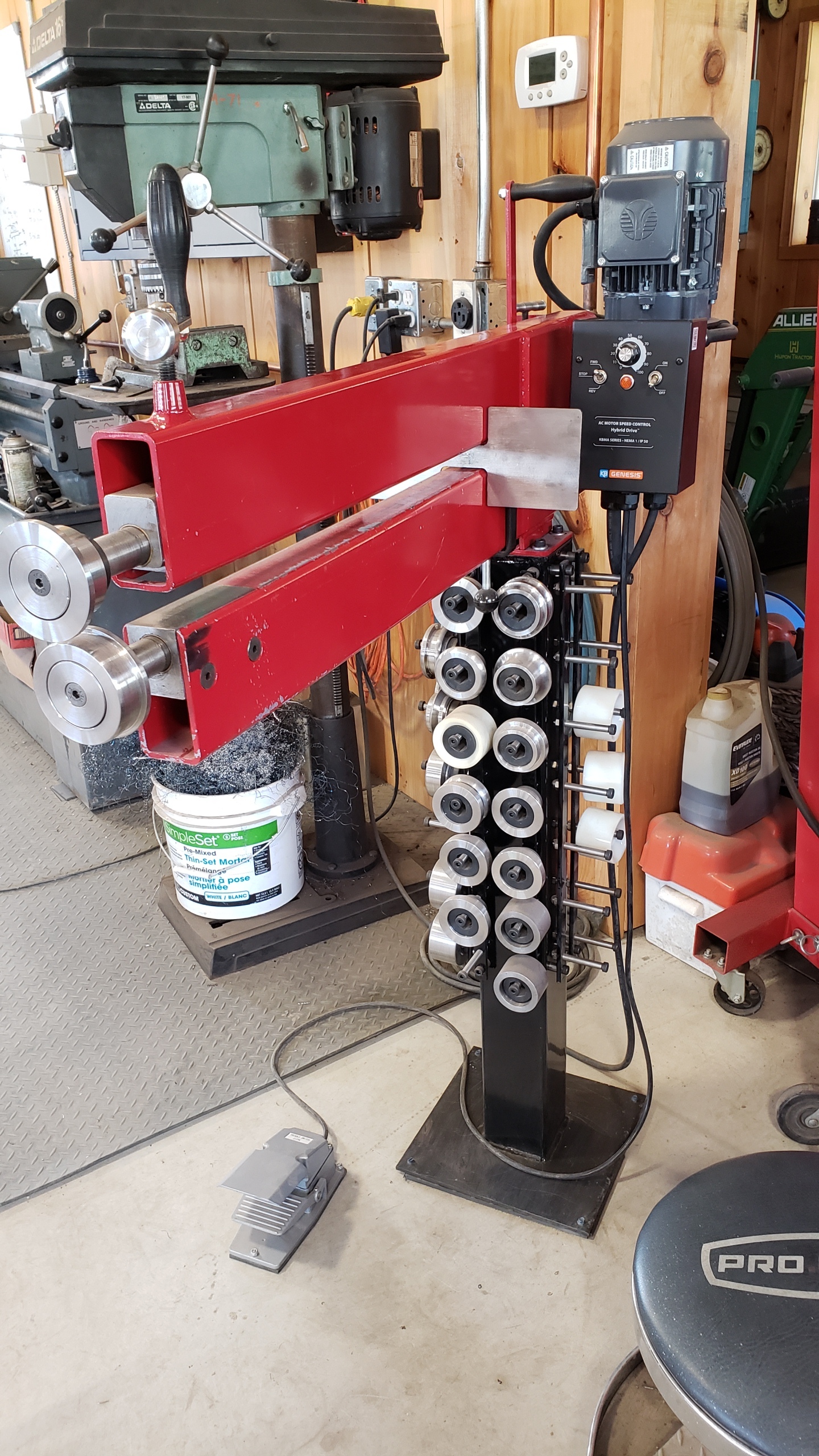

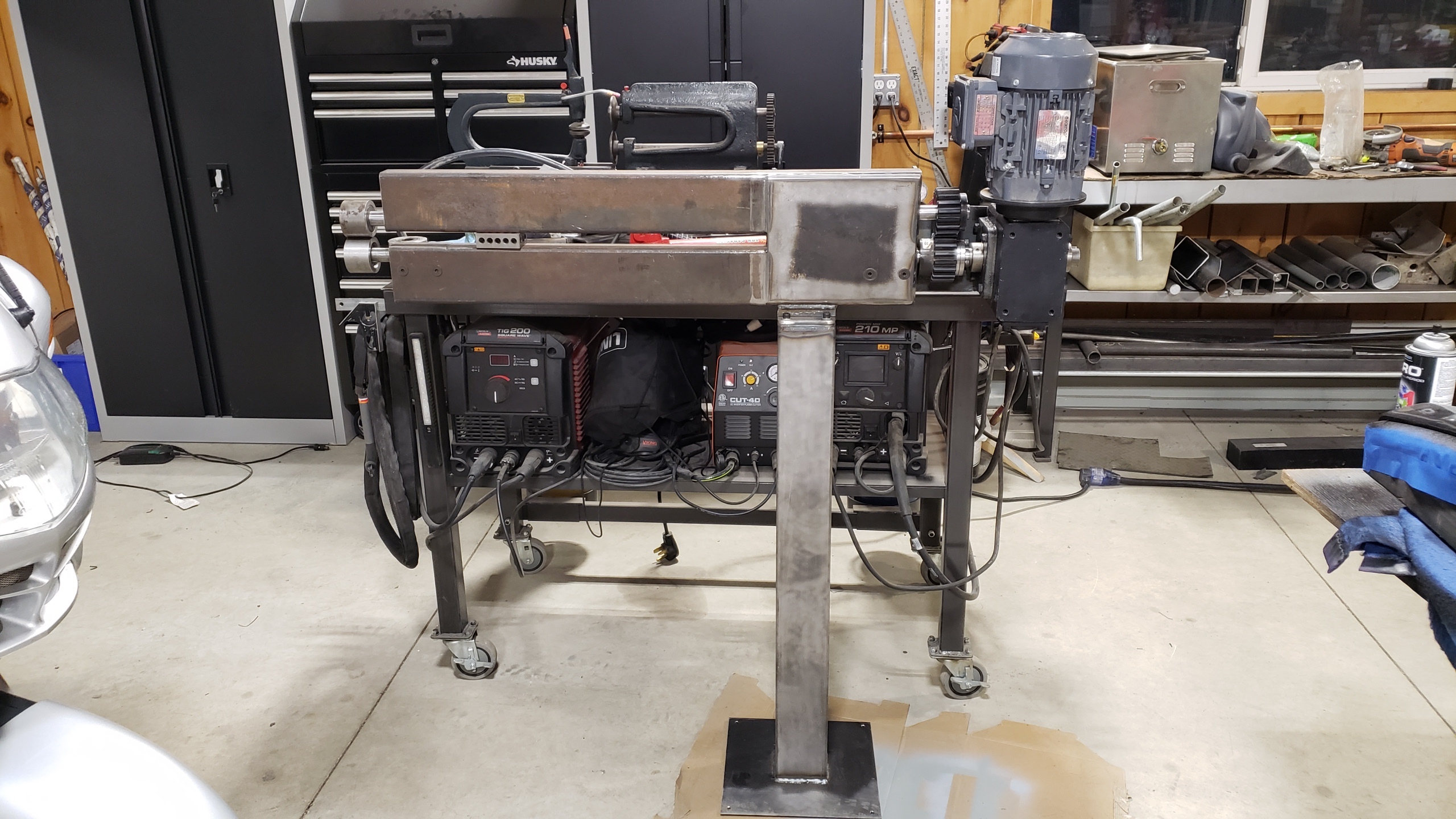

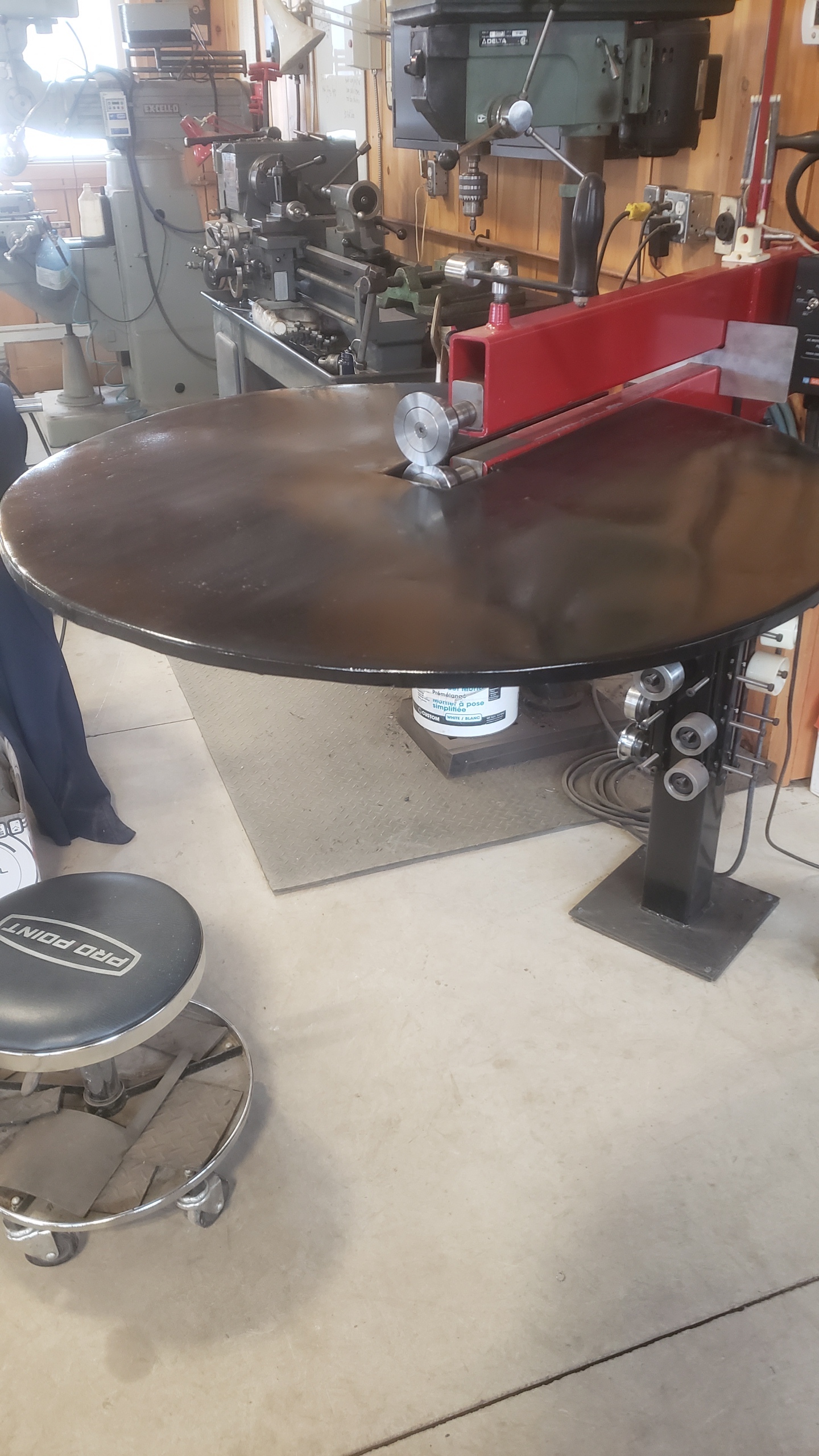

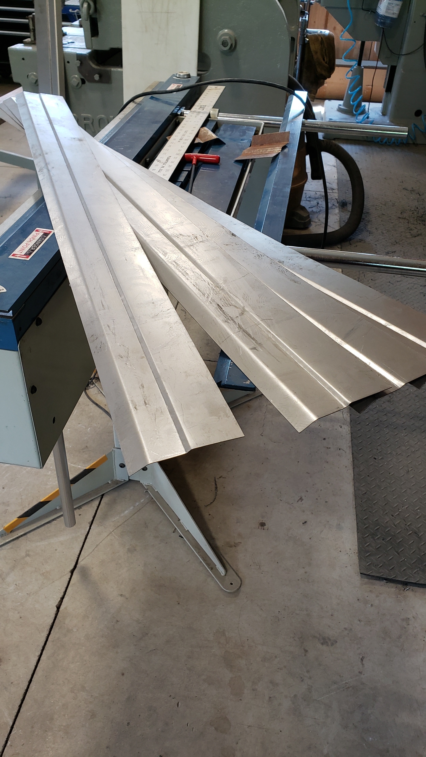

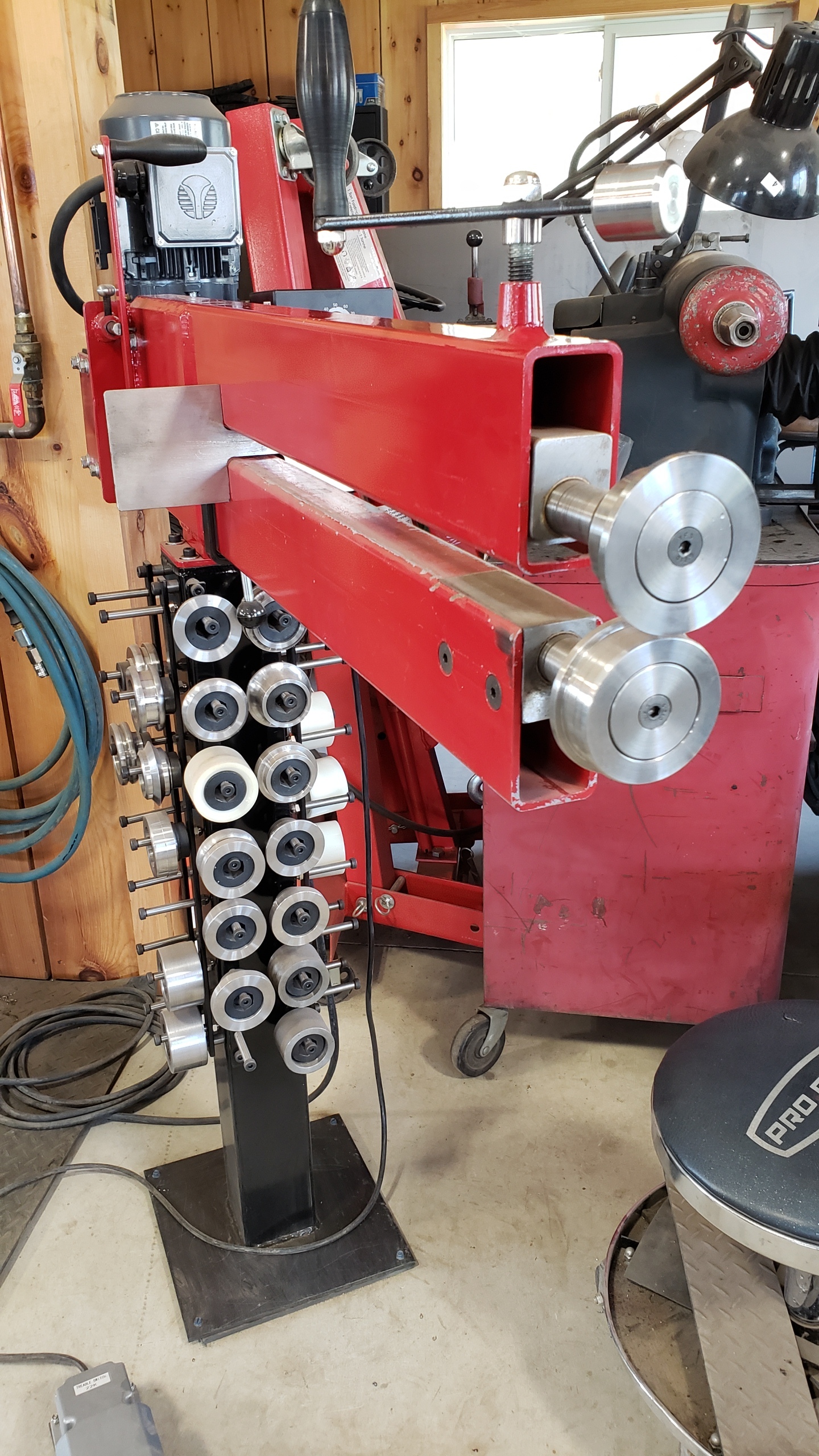

    I built this bead roller a couple of years ago or more. I find that I use it for a variety of projects and I make up new dies as needed. I added the round table after the first year to make it easier to support longer pieces. Two bolts hold it up in place so it`s pretty easy to move it into position or down out of the way. I might change it as some point because I have to lower the table to change the lower die. I`ve used the machine on 20 ga. steel and it doesn`t even flinch at that so I`m sure it would handle 18 ga or heavier if needed. It`s got plenty of grunt!Bead Roller & Dies-20230224_090223.jpgBead Roller & Dies-20210320_171910.jpgBead Roller & Dies-20210412_202757.jpgBead Roller & Dies-20210526_125549.jpgBead Roller & Dies-20210601_130012.jpgBead Roller & Dies-20230221_115009.jpgBead Roller & Dies-20230221_115612.jpgBead Roller & Dies-20220511_150322.jpgBead Roller & Dies-20220511_150304.jpgBead Roller & Dies-20220511_150251.jpg
