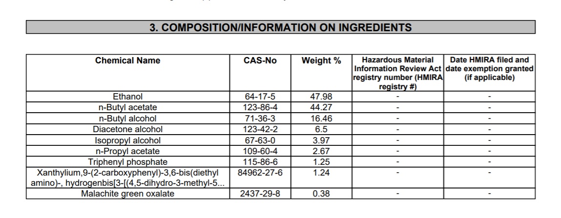

    I'm merely pulling out a few of my acquired DIY tips from 60 deg N (where stuff like layout dye is expensive if found):
    DIY-kem: Starting with any cheap 1/4 Litre can of shellac lacquer/ varnish
    (used for sealing knots in wood from bleeding resin up here),
    adding a teaspoon-ish of (very finely ground) Prussian Blue dry pigment in a smallish bag from an artist's store.
    Dilute with methylated spirits 'til thin enuff to suit your purpose, add more pigment if too thin.
    Sticks to nearly anything w/o manic cleaning. Clean off by rag/ towel with methylated spirit.
    Could even be visible after stick-welding the piece.
    -For the Purist, orthodox DIY-ers, here's the Original's MSDS:
    Battle of the Marking Fluids: Dykem v New Kid on the Block-dykem-msds.jpg
    (-Personally, I think the Butyl Acetate is mainly for the fruity smell, 2ndly for dilution...
    Ability to source and read an MSDS could also be Your Golden Pathway to Cheapness!

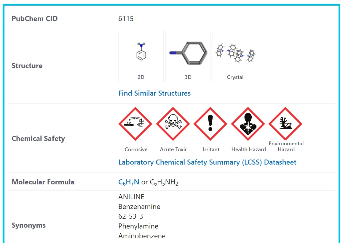

    -Umm - Personally, I'd stay away from aniline due to its well-known acute toxicity,
    where desired poisoning can take place from any (or all) preferred method of these (Caution: Irony!):
    1) Swallowing,
    2) Breathing its vapor/ fumes, or thru
    3) Skin absorption:
    https://en.wikipedia.org/wiki/Anilin...gy_and_testing
    Battle of the Marking Fluids: Dykem v New Kid on the Block-aniline.jpg
    From https://pubchem.ncbi.nlm.nih.gov/compound/Aniline
    Thanks for the recipe, but I'll stick to Prussian Blue dry pigment: Iron(III)ferrocyanide ("not hazardous", even per OSHA),
    but then I guess I'm a wimp for not digging Benzene rings lying around in my home shop.
    https://www.chemblink.com/MSDS/MSDSF...ma-Aldrich.pdf
