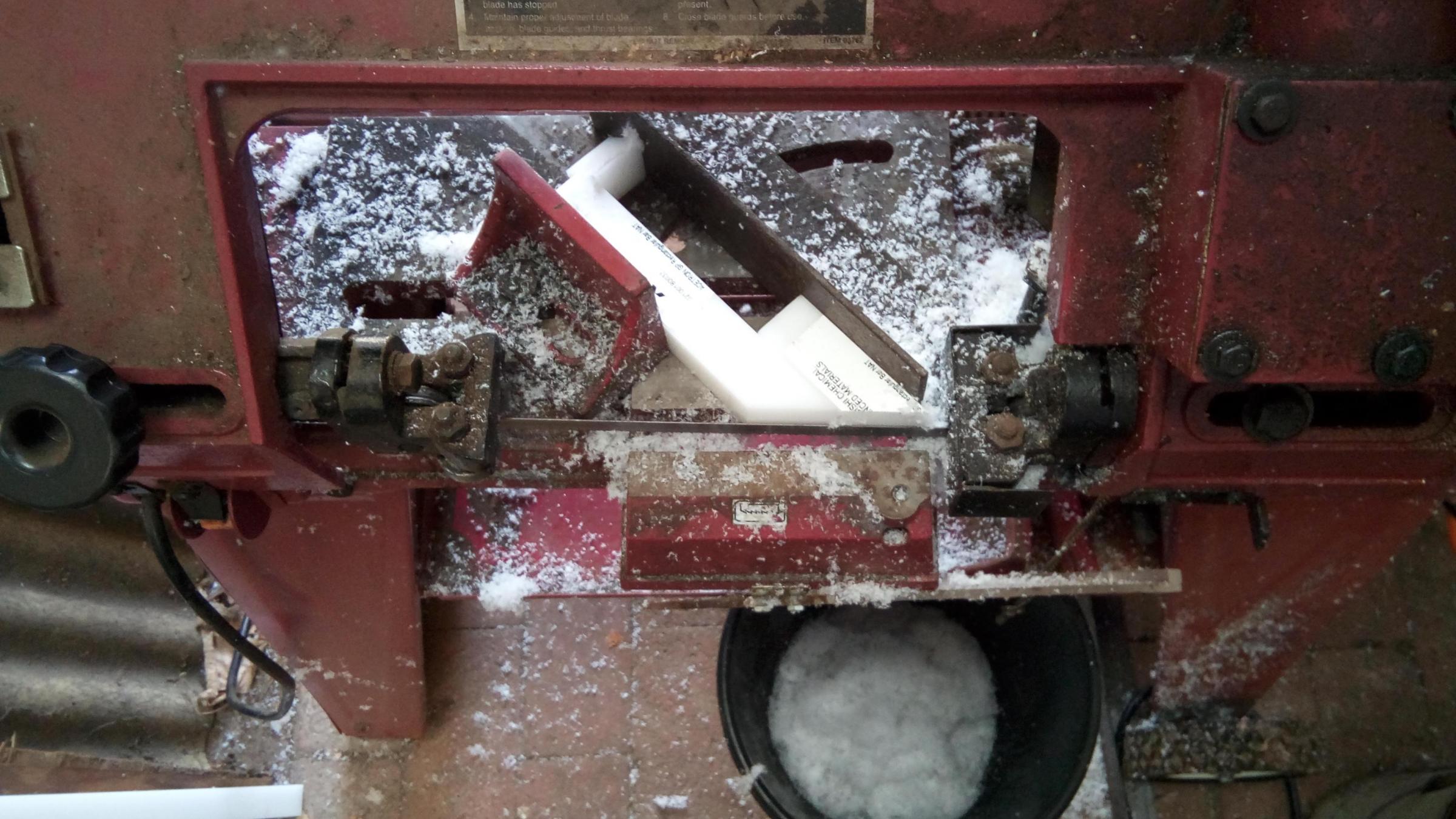

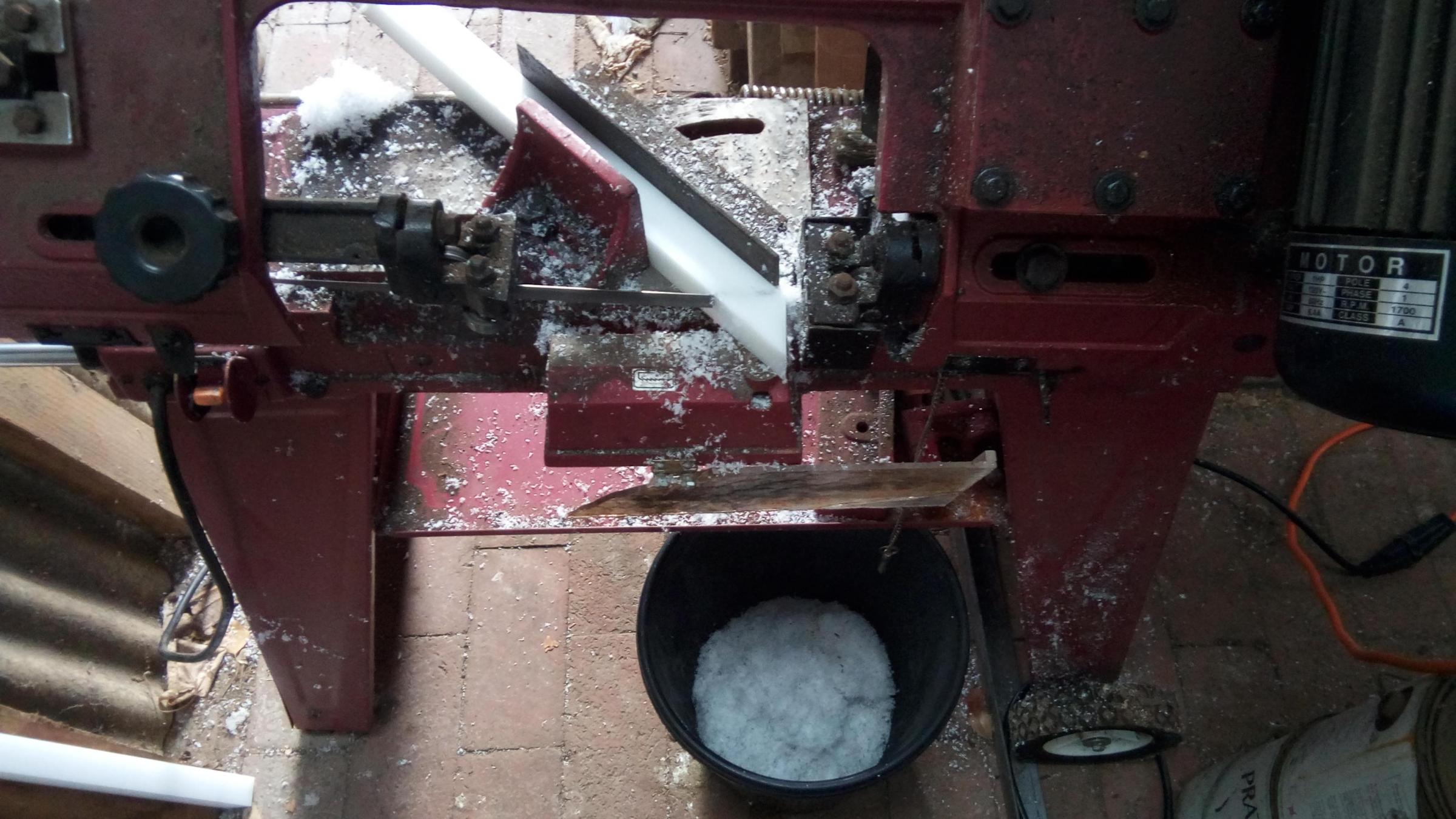

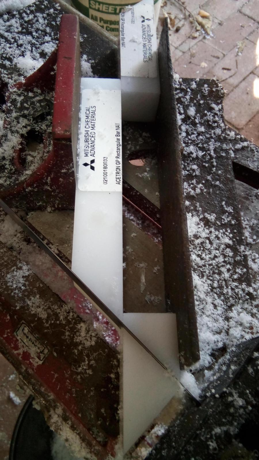

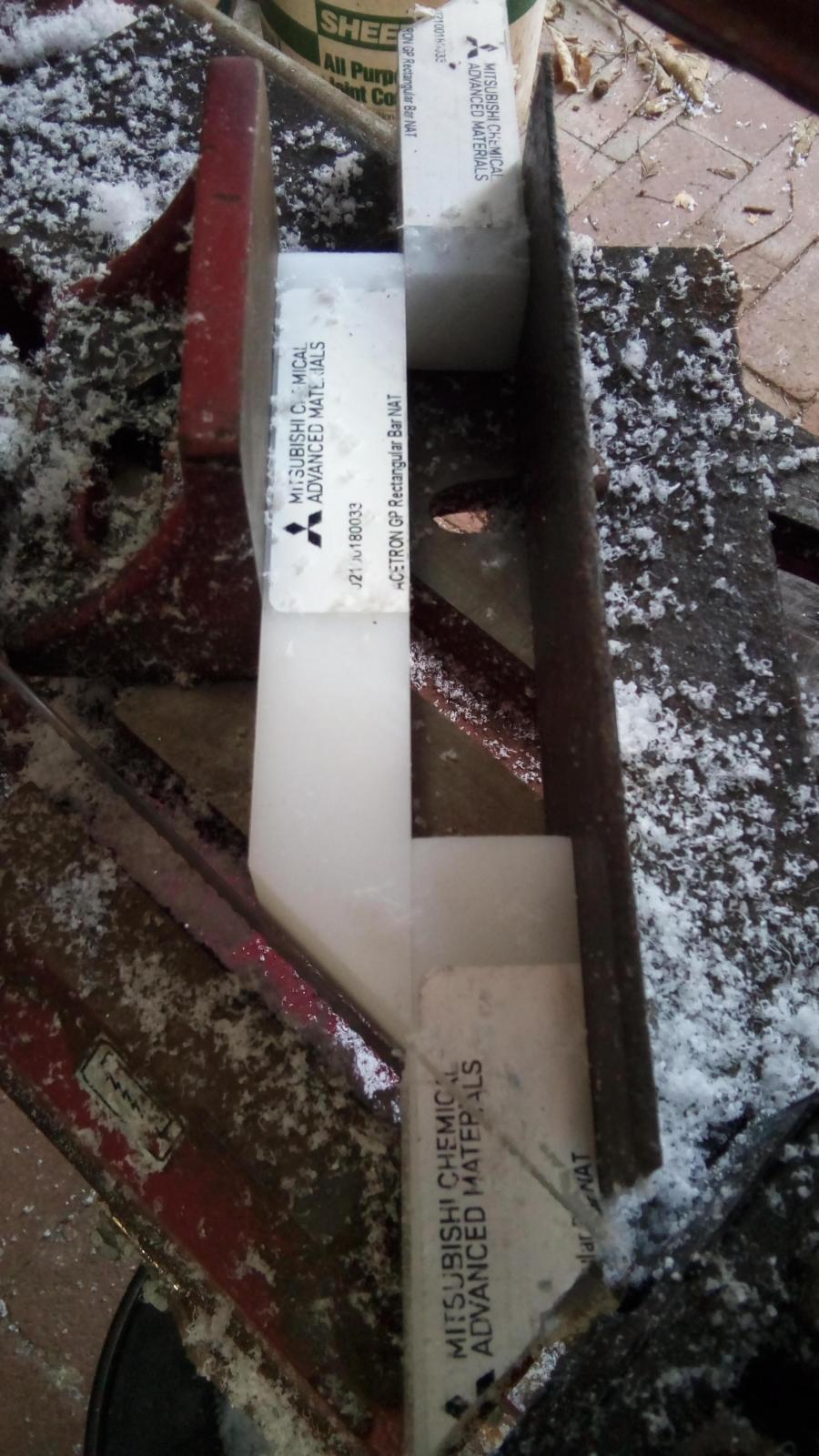

    Nothing earth shattering here, but might help a new person.
    Use a piece of material as a clamp extension so you can cut that last little bit off the expensive POM rod.
    Note: Only use a short piece as a spacer, if you go full length you might be holding the spacer tightly but not the piece you're cutting.
    Also shows Silicon Valley Snow, POM shavings.
