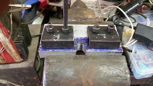

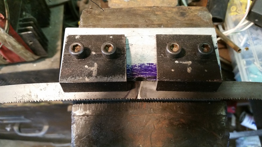

    Bandsaw welding jig from various ideas of other builds, and worked better then I could have imagined. and fun the clamping was always my concern and this is solid as a rockBandsaw welding jig-bladewelder.jpgBandsaw welding jig-bladereadtoweld.jpg. Will test for a while and then may try bulk blade purchase or maybe just buy longer blades that I find cheap

    I like it, I use one very similar also.

    Clever idea using two screws for each clamp instead of one. No swiveling there. Thanks for sharing, Ed.
