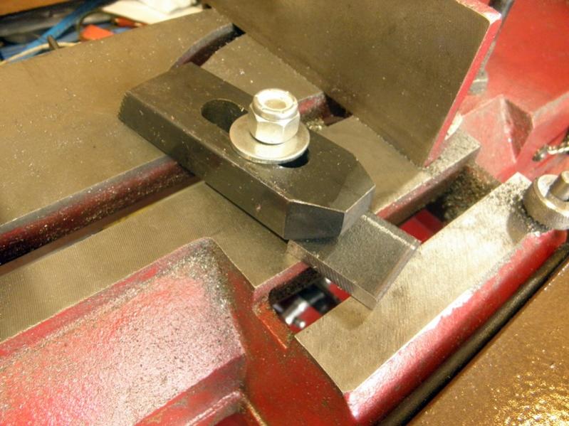

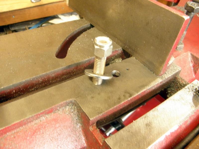

    Band Saw Threaded Holes for Hold Downs.
    Band Saw Threaded Holes for Hold Downs. Drilled and tapped 3/8s holes.
    Band Saw Threaded Holes for Hold Downs.-023.jpgBand Saw Threaded Holes for Hold Downs.-022.jpg

    Captain,
    Great idea and it is on my list to try. Also, what do you use the small cylinder and post for? These are the parts just showing in the upper right corner of the second photo.

    Hay Paul, that is a screw vise for a stop so I can do multi cuts the same.
